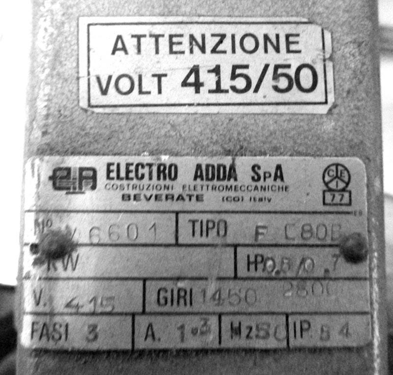

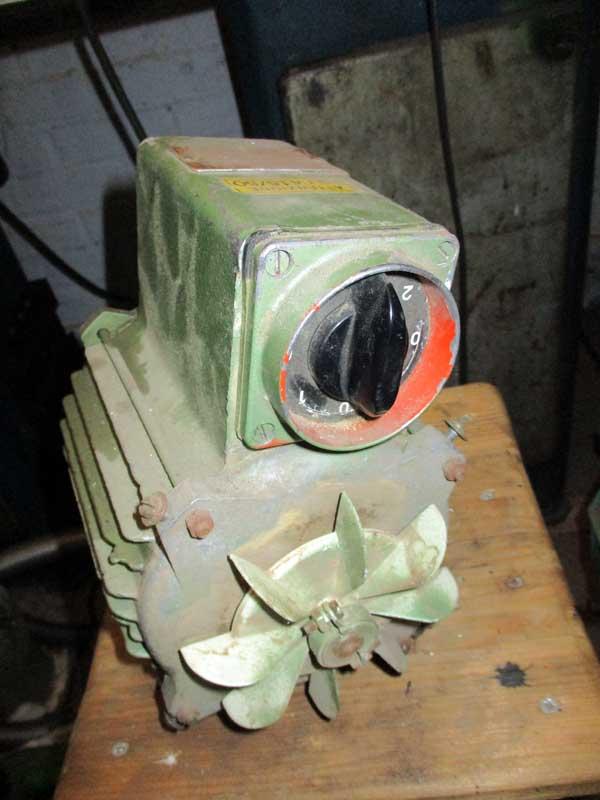

I have a 3 phase 2 speed motor that I am considering fitting to my Raglan lathe. Rather than using a stepped pulley would it be possible to use an inverter with a speed controller to give me a useable range of speeds?

Can post a pic of the motor terminals. It's possible that the motor (even though it's a two speed motor) can be configured to run from 220-250VAC..  Depends on what's behind that cover plate...

The motor has a built in speed switch with a off position between each speed so I imagine that it would be simple to wire it up to a VFD, as Rob suggested, without any problem.

A 2 speed motor's winding is a compromise to be able to split the poles in half to achieve the 2 different speeds. Usually the best winding is the low speed one. Connect this winding to the VFD and it will run ok.

Short answer is no because one set of windings needs 440v, can't be delta'd as it uses two sets on winding in delta for the other  speed.
To use this you need either a Transwave, a rotary converter or one of those shitty inverters that have been bodged to output 440v

You DO have to have 415V (not440) 3 phase power coming out of the VFD. The options are to buy a VFD from arceurotrade.co.uk if you don't have 415V in your shed. Put a nice label on your switch that says "Do NOT switch while motor is spinning" and put a stop button wired to the stop control terminals of the VFD right NEXT to it - maybe in the same housing - just so you or a visitor don't get tempted.
Sometimes its worth having a two speed motor. This motor may well give you 5600rpm in the high speed range and plenty of torque at 300rpm  in the low speed range. You don't need to rewire anything in the motor. These are 'Dahlander' wound Delta/double-Y motors. And in delta they still need 415V because they connect two coils in series in each of the delta legs (and in parallel in Y, making it 'double-Y).
