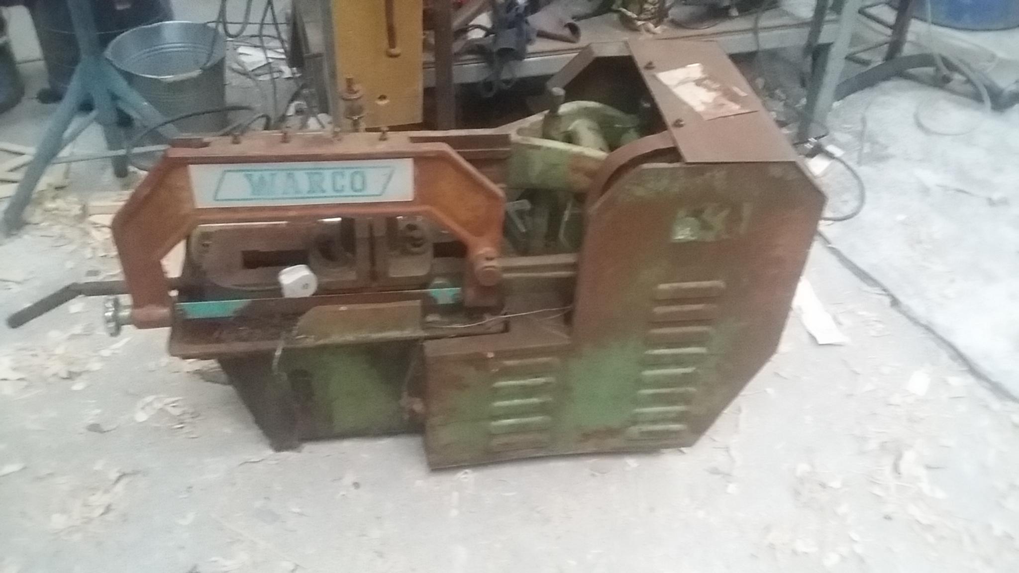

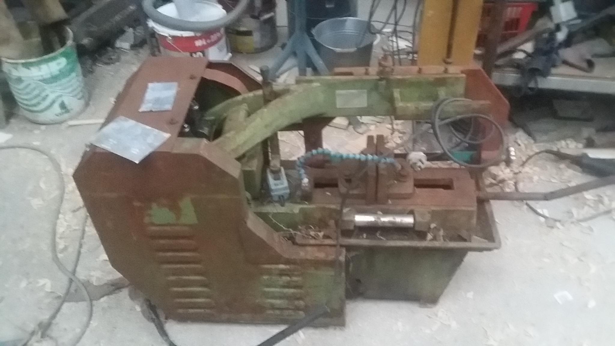

Between Christmas and the new year, my son, my two grandsons and I made a visit to Andrew Mawson, this was the third annual visit for my son and I. It's fun to visit other madmodders, put a face to a name and see some of the things that have been the subject of forum threads! All three generations enjoyed themselves and I was followed home by the thirty five year old Warco mechanical hacksaw Andrew had offered it to me last year, but I was on my motorbike, so getting it back across the channel would have been a little tricky!. The aforementioned saw had spent the last seven years outside. I finally was able to get it out of the van and into my workshop. The light failed me so I wasn't able to get many photos. Nothing was seized, and the drive belt wasn't even cracked, amazing! It looks as though the original threads on this thirty five year old Taiwanese knock off are Unified, Andrew said that he had bought it from a blacksmith when it was about ten years old, so that might have been when it picked up the Whitworth replacements for the UNC bolts!  I'm not going to restore it, just make it work. I found a switch for $6 from Hongkong and ten replacement blades on eBay for 25€, so far, I can't see anything else apart from the plug and the oil to replace!
I see that the pics are too big, I'll get it right on the next ones!

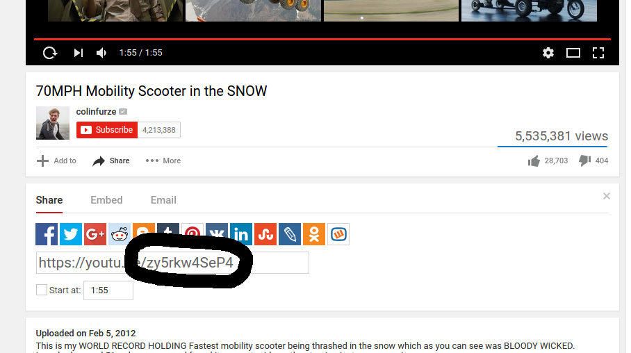

Hi Matt,
When you're writing your post, have a look at the 2 rows of icons above the smileys - the first one on the left, on the second row (underneath the "B") is a Youtube link. Just press that to get:
Code: [Select]
[you tube][/you tube](note: I've added spaces so it shows up properly in this post...)
Now all you need to do is paste your video's unique code between the two tags, and you're golden! The code appears in the URL (address bar in your browser), just click on it and it should show up in full. Or, once the video has finished playing, copy the code out of the "share" box (see attached picture).
e.g. if your Youtube URL looks like this:
Code: [Select]
https://www.youtube.com/watch?v=zy5rkw4SeP4
Take everything after the "v=", i.e. zy5rkw4SeP4, and paste it between the two tags:
Code: [Select]
[youtube]zy5rkw4SeP4[/youtube]
And you end up with this:
HTH!

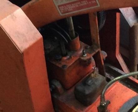

Matthew, I vaguely looked into this about 15 !years ago - I saw a very similar Taiwanese saw in a used tool dealer, and there was a knurled knob on the end of a shaft emerging from the hole in the top plate that you used as a jig for drilling
I suspect that there was a ball valve similar to yours, but with something pressing on the ball to give a controlled leak. If you think about it, if your ball valve is perfect, the blade will never descend ! The little cylinder just transfers enough oil into the bigger one to lift the blade off the cut on the return stroke, but re-admits in on the forward stroke controlled by the timing of the cam.
Happy experimenting

That is what I'd thought, but, there were no traces of anything in and around the hole, no threads, no signs of anything! The one thing that is certain, a ball valve is required to allow the oil in. The small piston rises and falls, pressurising the large chamber raising the blade. The cam then allows the blade to lower, by venting partially the large cylinder through the port in the small cylinder. that much is clear, the thing that is not clear for me, which may have to do with the nob is lowering the blade down to the working position!
The photo is not very clear! I just found this!
Re: Titivating a Warco Mechanical hacksaw!

Good progress Matthew  :thumbup:
In the good old days, motor cycle oil pressure relief valves were just a ball bearing pressed by a spring against a cast iron bored hole. The received wisdom (written into maintenance handbooks) was to put a bronze drift against the ball, and give it a firm clout with a hammer, thus deforming the seat to the sphericallity of the ball. Those of us without bronze drifts used a steel rod, then replaced the ball bearing with another identical one, and it seemed to work splendidly. (no lapping allowed as the oil galleries would become contaminated)
« Reply #43 on: March 29, 2017, 05:33:34 PM »
Well, I wasn't sure whether it was the seat or the walls of the valve hanging things up, this way I was able to cove both!
More adventures to come!
regards, Matthew
« Reply #44 on: August 24, 2017, 04:59:22 PM »
Here is a short video on making a gasket for the Warco hacksaw, more to come on getting the saw going. it's kind od an oldtimers trick!
  • Posts: 9051
« Reply #45 on: August 25, 2017, 07:57:22 AM »
Well illustrated and explained Matthew. That method got me out of trouble many times when I used to run motorcycles on a shoestring budget in my youth  :thumbup:
So how's the self lifting mechanism working now?
« Reply #46 on: August 25, 2017, 03:15:04 PM »
I'm getting to the self lifting mechanism! It's working and I use the saw whenever I can. Very pleased!!
