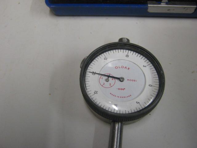

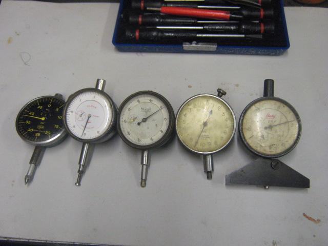

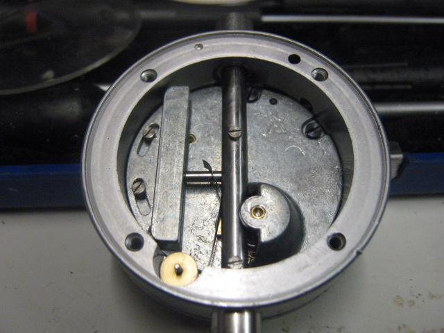

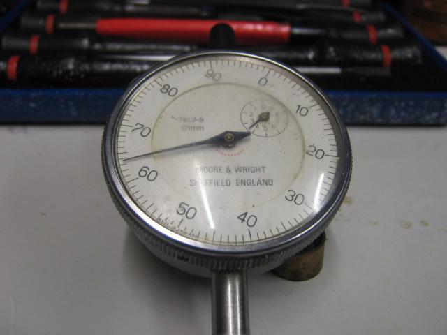

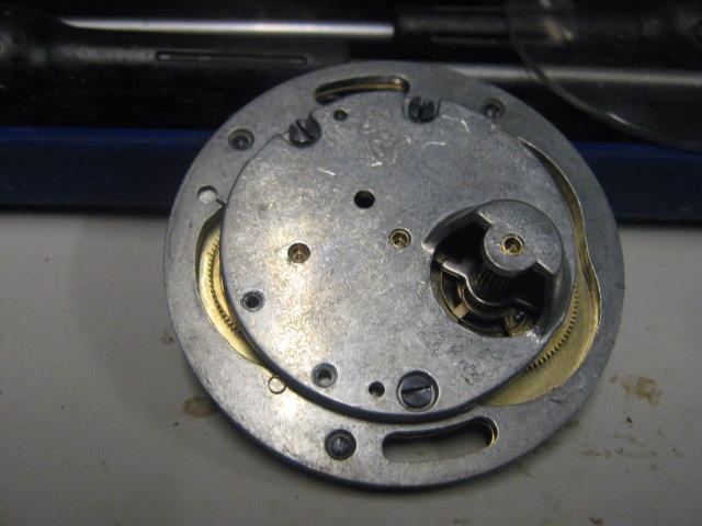

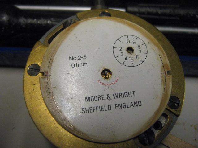

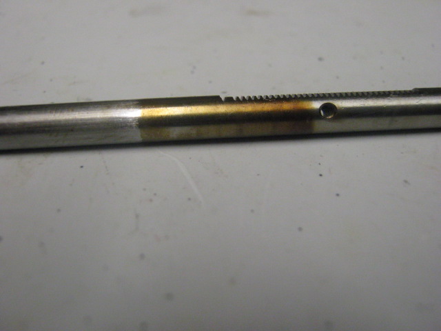

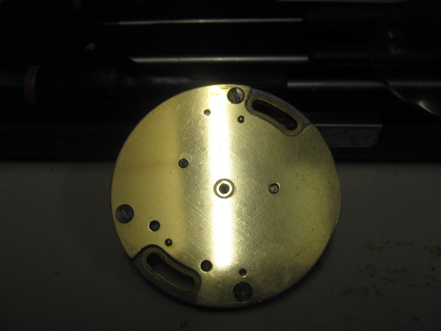

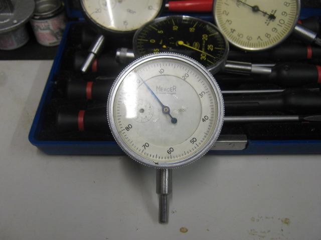

hi all I got sum D.T.I's sent to me from rick o shea 1 he wonts back the rest will be finding new homes with john and his Sunday night give a way

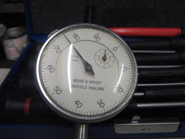

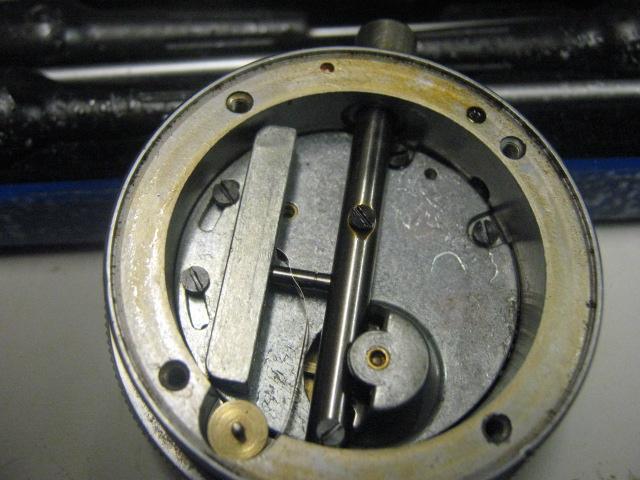

I never sell any of the D.T.I's that I get given sum end up as bin sper parts that's the ones that's well beyond fixing the rest find new homes  any way back to the D.T.I that mike wonts back its a moor and wright in all its in good order nothing broken the problem with it was muck on the rack witch was jamming in the mane body striped it dawn gave it a bath put it back together made a mistake no putting it back together see if you can see the mistake if any of you have old D.T.I's that you don't wont post them to john right pics

OK  Krv whats the before and after - do we scan down the page?
Also give up - what was the deliberate mistake? :bow:

Re: rick o shea D.T.I. refit
« Reply #2 on: December 29, 2016, 02:59:34 PM »
hi well the top pics is the before the bottom pics is after not put the finish pics on yet  their is a problem between pic 1 and pic 2 spot the problem
Offline howsitwork?
  • Posts: 360
« Reply #3 on: December 29, 2016, 03:29:12 PM »
seems top be no bezel fitted to photo 2?
Offline howsitwork?
  • Posts: 360
« Reply #4 on: December 29, 2016, 03:32:20 PM »
also spring clip in pic 1 seems to be retained on the shaft whereas in photo 2 it's free of the shaft?
« Reply #5 on: December 29, 2016, 03:57:02 PM »
Different screws fitted to shaft and the two on the lhs? On the 2nd photo the two lh screws don't appear to clamp the plate.
« Reply #6 on: December 29, 2016, 05:28:28 PM »
philf wins

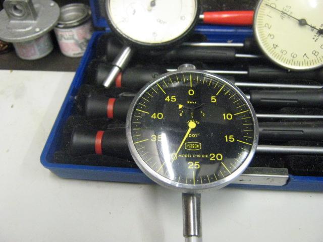

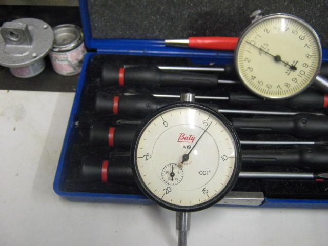

hi all hear is the pics of them all dun
Offline howsitwork?
  • Posts: 360
« Reply #9 on: December 31, 2016, 06:32:52 PM »
very nice .  :clap:
HAPPY NEW YEAR
Ian
« Reply #10 on: December 31, 2016, 06:57:45 PM »
Well done ,Bob  :clap: :clap:
That black and yellow Metron looks very distinctive,never seen one like that before.....OZ.
Offline ieezitin
  • Posts: 662
« Reply #11 on: December 31, 2016, 07:15:33 PM »
Well done Bob very nice work indeed.
I too like the Metron never seen the sweeping needle showing .100 graduates. I would like one..
Anthony.
« Reply #12 on: January 01, 2017, 01:50:10 PM »
well you will get the chance of wining it in john's Sunday night cap giveaway I never sell any of the d.t.i's that im given they all ways get past on to sum one that wants one

May I put on record here the fantastic job that Bob has done on my DTI . Not only has Bob done a superb job  in making the device work, but the dial and the crystal look fantastic, not only that, but the  DTI now has its own beautiful box. What can I say  :mmr:
Thanks Bob you are a star.
