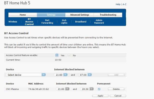

I have a PC running Windows 7 driving my plasma cutter table. At the moment it is 'stand alone' ie NOT on my local network as I don't want external interference from the likes of Microsoft poking up dates at it. However I DO want to communicate with it from other PCs on my local network.
As the Plasma PC uses Ethernet to talk to it's various drivers and torch height controller, it is set up currently as 192.168.10.154 so is on a different 'sub net' from the rest of my local network which is 192.168.1.XXX
The plasma PC has only one Ethernet card as do my other PC's.
Is it possible to run two subnets on one ethernet card so that the 192.168.10.XXX CANNOT access the outside world and the 192.168.1.XXX CAN ?
Any help appreciated

Which actual router do you have? are you with Virgin, BT, or some other ISP. Either way the answer is in the child safety or parental control set up. You can put restrictions in the outside access on routers to stop children getting 'out' while still allowing them to get to the local music and picture server. Look at the 'filters' section used for port forwarding which normally has controls based on the PC MAC address.
Re: Stopping a PC accessing the Internet ?
« Reply #17 on: December 11, 2016, 06:03:53 PM »
It's a BT Home Hub and it has the parental controls, but the hardware on the (Russian) torch height controller is forcing it to use 192.168.10.xxx whereas my network is the conventional 192.168.1.xxx
As previously mentioned, I can't experiment until this PC gets finally fixed into the Plasma Table, which won't happen for a week or two, BUT I have got myself a USB - WiFi dongle that hopefully will let this PC exist on both subnets, then I can use the parental control trick perhaps.

However this allowed it to show up on the Router 'Parental Control' table, and I've been able to stop it having access to the internet that way. But even that wasn't entirely straight forwards  :bang:
The router allows me to block access with start times and end times in half hour increments. But this meant that there is no way to stop at least one half hour slot of access, however once the time is set up, you THEN have access to another box to tick for permanent blocking  :scratch:

May just be an awful user interface on the router - but doesn't ticking 'permanent' block access all the time, regardless of time settings?
« Reply #31 on: February 27, 2017, 06:56:36 AM »
Yes Dave, which is exactly what I wanted  :thumbup:
But the programmer neglected to bring the tick box up on the screen until the other time setting boxes had been completed and applied - so as you rightly say, an awful user interface.
It never ceases to amaze me how some programmers don't think about these things. I've been using 'Inkscape' a lot recently, so have got used to one idiosyncrasy it has - you kick the program off by double clicking it's screen icon, then ABSOLUTELY NOTHING happens for what seems ages as it loads itself up BUT PUTS NOTHING ON THE SCREEN to tell you it's loading. The delay is quite long enough for you to think perhaps you failed to click properly so do it again, then you get two instances of it running  :bang: :bang:
How hard is it just to pop a 'loading' message up as a first action  :scratch:
