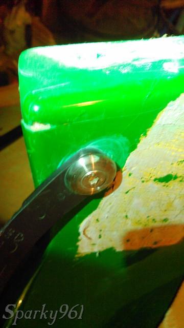

Most kayaks have a seat "pan" with side posts.  These posts have holes through which bolts attach a back band.  The back band takes a significant amount of pressure when you're paddling and rolling like you mean it.

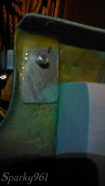

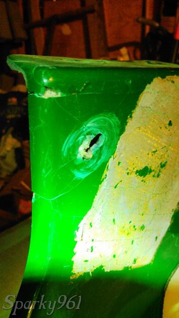

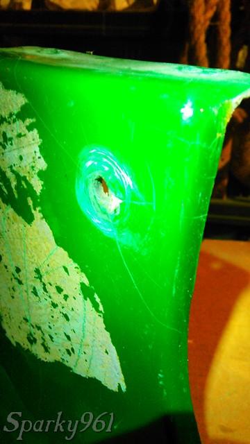

On my boat I've always had issues with the pivot points of the backband.  It started out with the nuts coming loose and "sawing" their way through the fiberglass, making an elongated hole.  I fixed this by adding two nylock nuts on the back side - not a typical use, but they never came loose after that.  The shear load continued to destroy the hole though, so I added stainless steel reinforcing plates on the back side with 5-minute epoxy.  It worked well for a while, then one side came loose and the damage continued.
My plan is to fix the damage using glass and resin, completely filling in the existing holes and generally reinforcing the seat pan structure where I see stress cracks.  This will involve grinding down the damage and rebuilding it from there.  It will also require more gel coating, which I have developed a dislike for, even though the results I've obtained have been quite satisfactory.
My question is this: How can I redesign this attachment point to pivot easily and accept a considerable shear load without sustaining damage over time?  I think the key is going to be to spread the load over a larger surface area, and I have some ideas that might work, but I'd rather something that's been tried and well tested already.
Some details:
- The fastener through the hole is stainless, probably around M6 or M8
- The load in shear is at least the amount you can apply to your lower back with your legs almost fully extended, feet on a firm surface.  So, quite a bit if you've got big leg muscles.
- Since this is used in water, everything must be corrosion proof
- Since I sit next to it, nothing can be sharp

Could you embed the plate within the layers of fibreglass? I guess that might be difficult, now that the boat is complete...
How about having a second plate on the outside of the hull, and rivet the two together (as well as epoxying them)? With eveything rigid, and the rivets helping to hold the epoxy, it should last much longer. The only question in my mind is- would the aluminium rivets suffer galvanic corrosion against the s/s spreader plate? If rivets are no good, a selection of small S/S bolts & nyloc nuts perhaps, cut or made to length so they don't stick into you...

Sparky --  In the aerospace industries it is common to "lay-up in" various bushings and nutplates to take critical shear loads in "fiberglass lay-ups.  These are (usually) 400 series CRES (read: stainless steel) components heat treated to (at least) Rc45.  If a through bolt is your desire, then merely a T-Bushing set should do the trick.  The main thing to remember is that you want to maximize the OD and thickness of your T-bushings.

Thanks for all the ideas. Initially I had been thinking about embedding a SS plate in the layup. But I have great concerns about water migrating in between the materials over time and causing damage that won't be detected before it is extensive. The different thermal expansion rates also cause me to worry about burying a plate in there.
Lew may have hit on one of my own candidate ideas, if I understand properly what a T-Bushing would be.
I'm thinking to create a pocket on the back side, in which the bushing would sit with some play. On the other side a washer would complete the sandwich arrangement and allow it ro pivot.

Sparky -- The T-Bushings I am familiar with have a knurled cylinder for the thickness of the lay-ip, a T-head on one side (call it 2.5X the diameter of the knurled body), and a light slip fit to a washer on the other side.  The knurled body is a very lighy finger-press to the hole.  The knurls are coated with epoxy for installation.  Does this help?

You can buy a thing called a "big head" fasteners, it's basically a bit of perforated stainless with a nut welded to it, bond this to the existing grip with epoxy, then laminate over it creating a captive nut.
Alternatively, bond on a piece of tufnol, whale or 10G40 would be my grade of choice here, the drill and tap it once the adhesive has set. Tufnol will give a better bond to epoxy than s/so, and is non conducting, so no galvanic corrosion

It's an old thread but no one mentioned Rawl-Nuts anywhere in it, they are very useful for fixing to materials which have adequate strength but which tend to wear away, Rawl Nuts are very good for fixing wings to fibreglass bodyshells on kit cars where vibration would cause other fasteners to expand the holes.
