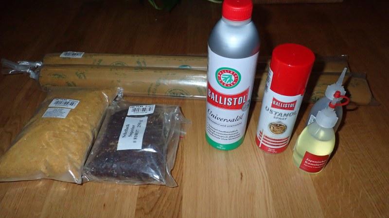

Thank you for the warning. I did bump into it when I was trying to get the facts right in my head and the synthetic form of the oil of wintergreen caught my eye. Essentially same thing on toxicology.
Many of the natural products are one way or another poisonous. I usually avoid skin contact, but after reading some of the facts I am pretty content that in my application (pun not intended) risk of harmfull dose trough skin contact is pretty remote.
I'm not saying that oil of wintergreen is totaly harmless:
https://www.newscientist.com/article/dn12040-muscle-rub-blamed-for-athletes-death/
https://toxnet.nlm.nih.gov/cgi-bin/sis/search/a?dbs+hsdb:@term+@DOCNO+1935
But in this context, with some basic sense and precautions should be pretty safe as an "classic" rust prrevention oiling for precision instrumets.
Anyway I got two rolls of VCI paper, Japanese Camelia oil and Ballistol
https://www.dictum.com/en/sharpening/sharpening-accessories/rust-removers-rust-protection
I ordered these, because I was ordering some carnauba wax and shellac as well. Awaiting my aromatherary oils :lol:

I have got camphor oil and oil of wintergreen. About of 100 ml of each. Good amout for testin and use.
I tried the Lew oil recipe and it seems to work. Also it got seal of approval from domestic authorities. Mu daugter described the smell of it "fresh".
It makes an odd looking suspension, but it is nice to work with. Solvent aids cleaning and thins it. Oil should prevent tools from rusting and winter green gives a nice scent.
