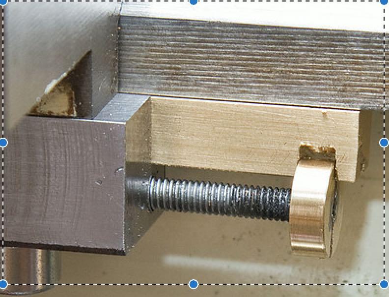

I have the slightly bigger Sieg C3, the super model with brushless motor...
I have added a qctp to mine (Arceurotrade sell a suitable one)
I changed the gibs from the rough steel ones to nice shiny brass ones.Same for the saddle retainers...
I have made an extra crosslide from a billet if cast iron with tee slots across for holding stuff....
Changed the plasticy handwheels and gears for more blingy polished ally ones...
Mine has the camlock for the tails stock, but I converted an early C3 tailstock to the same design..easy peasy... :dremel:
Made a saddle lock that utilises the holes for the trav steady.
Did have a saddle stop but gave it away with the C3 I repaired...
Cant think of anymore for the moment, but welcome to the forum  :thumbup:

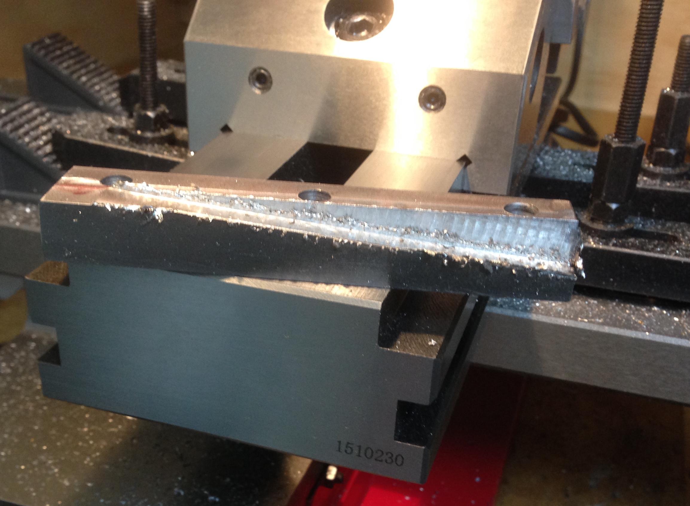

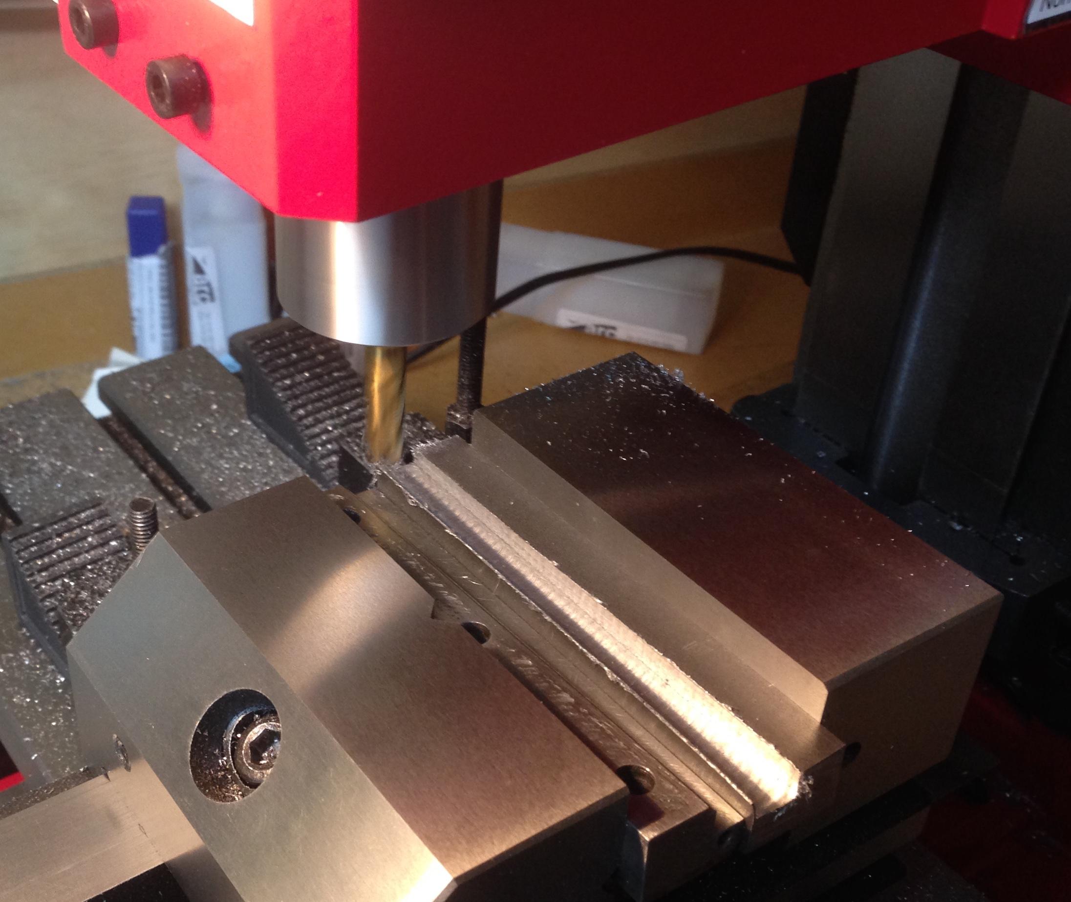

Buell -- #1) Line up and "fix" your tailstock (tapered) bore to be concentric and aligned your spindle.  #2) Change your tailstock over to a "cam-lock" clamp to your bed.  #3) QCTP.  Others will occur to you as things progress, but this is (from my view of the universe) the places to begin.  In terms of item #1, my spindle was out of concentricity by (nearly) .015 in and out of alignment by (about) .005/inch of tail bore travel.  In terms of item #2, I cannot tell you how much time is saved each day because I do not have to "find" the wrench to tighten things.  In terms of item #3, think about it...
Here's a "How To" document.

I've had a Sieg C3 for over 10 years.  This is what I've changed, more or less in order of  importance or effectiveness...
1/  Change spindle bearings to taper roller bearings
2/  Change carriage gibs from the waste of space originals to taper gibs
3/  Make a REALLY rigid post and clamp-on style QCTP
4/  Change cross and compound slide gibs to brass
5/  My original drip tray and chip shield were painted black, awful light sucking finish.  I cleaned, rubbed them down and repainted them white, vast improvement!!
6/  Made a more effective half nut retaining strip, from flat bar, rather than the original two washers
This lot should keep you busy!!

Lew's document was interesting...I think I could follow intent and procedure pretty well. Only in the end it was a little unclear how the tail stock part was installed over the alignment rod. I think that one peg on the steady rest is made loose and rod has been removed from the chucked weldon holder, then the tail stock upper part dropped into it's place (on epoxy) and finally the rod pushed trough, tightened and collets put finaly to allign the tail stock?
Essentially, yes.  The main difference is that I used my (vertical height) indicator set-up to verify that my rod was not deformed as the tailstock and epoxy stack-up was aligned.  My tailstock and chuck/collet now align within .0001 inch TIR.

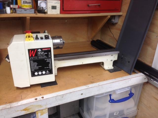

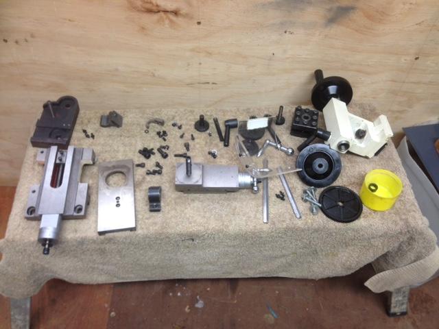

Taper bearings for headstock
Offline Buell
  • Posts: 77
Re: Top 10 mods for Mini lathe please ?
« Reply #20 on: December 02, 2016, 03:05:39 PM »
Ok so it's completely in Bits now....just the way I like it.
Step 1.. Tapered bearings...Any preference...Fag...Skf..Timken etc ?  Do I have to modify anything else as dimension slightly different ?
Step 2 .. Brass taper Gibs with screws adjustment
Step 3.. Polish ways and clean as best as Poss..
Step 4 Tail stock quick clamp
Step 5.. Slides sort out all adjustments etc..
Eat Xmas dinner
If you don't succeed ...try try try again...you can't fail trying.

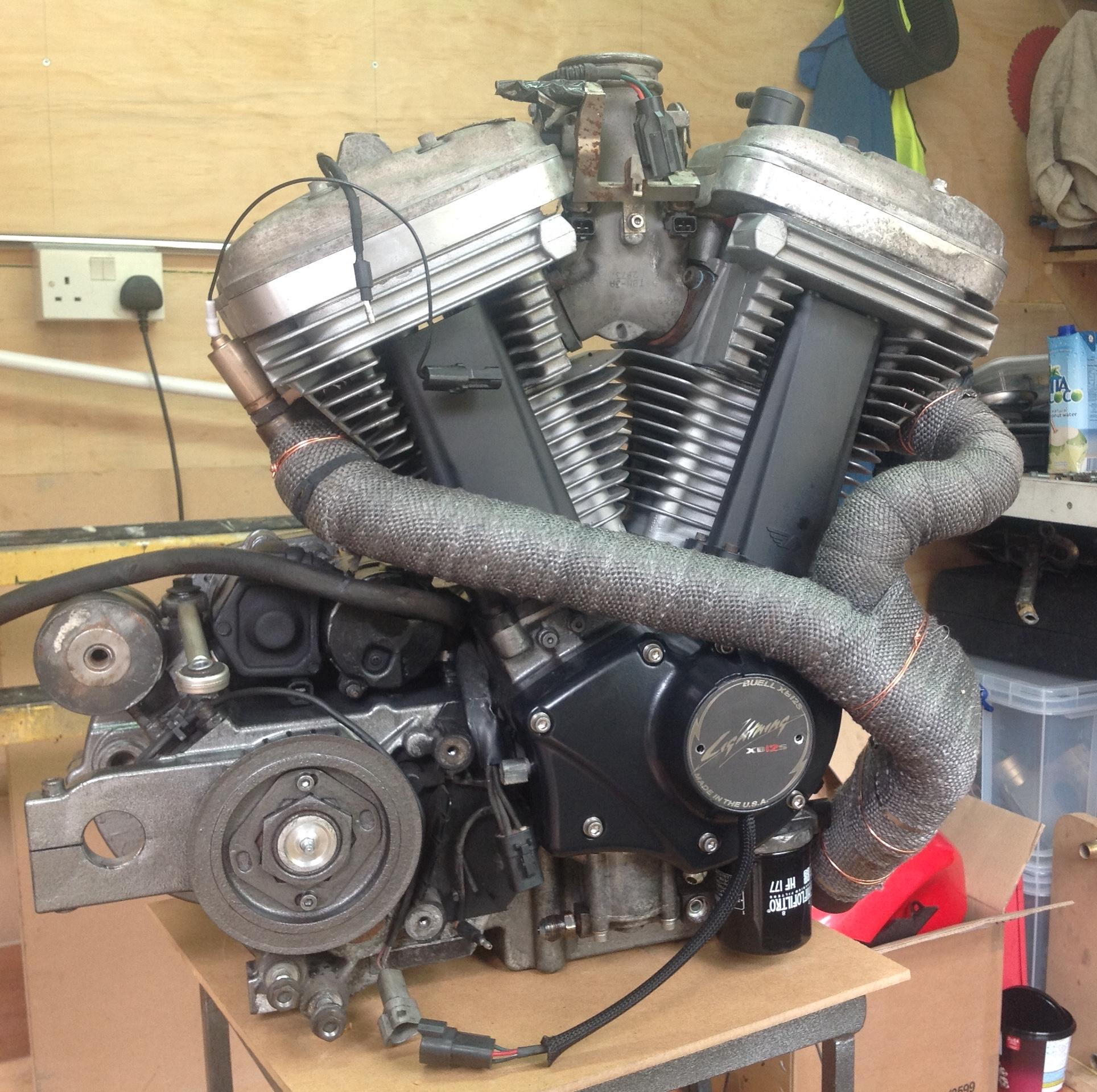

BTW, you riding a Buell?

Yes Buell Xb1200 and Husqvarna Supermoto.

As its Xmas ...I get some time to play with My first mill. Having never used one before, the learning curve was somewhat steep. Today I spent some time Try to make the Gib brackets.. Go easy as everything here is my first attempt at working with Machining steel. Any comments welcome. I still have the gibs in bras to do which i feel will be even harder. The first pic is the Mistake..best to get that out of my system..just the wrong angle i choose  whoops !  :bugeye:

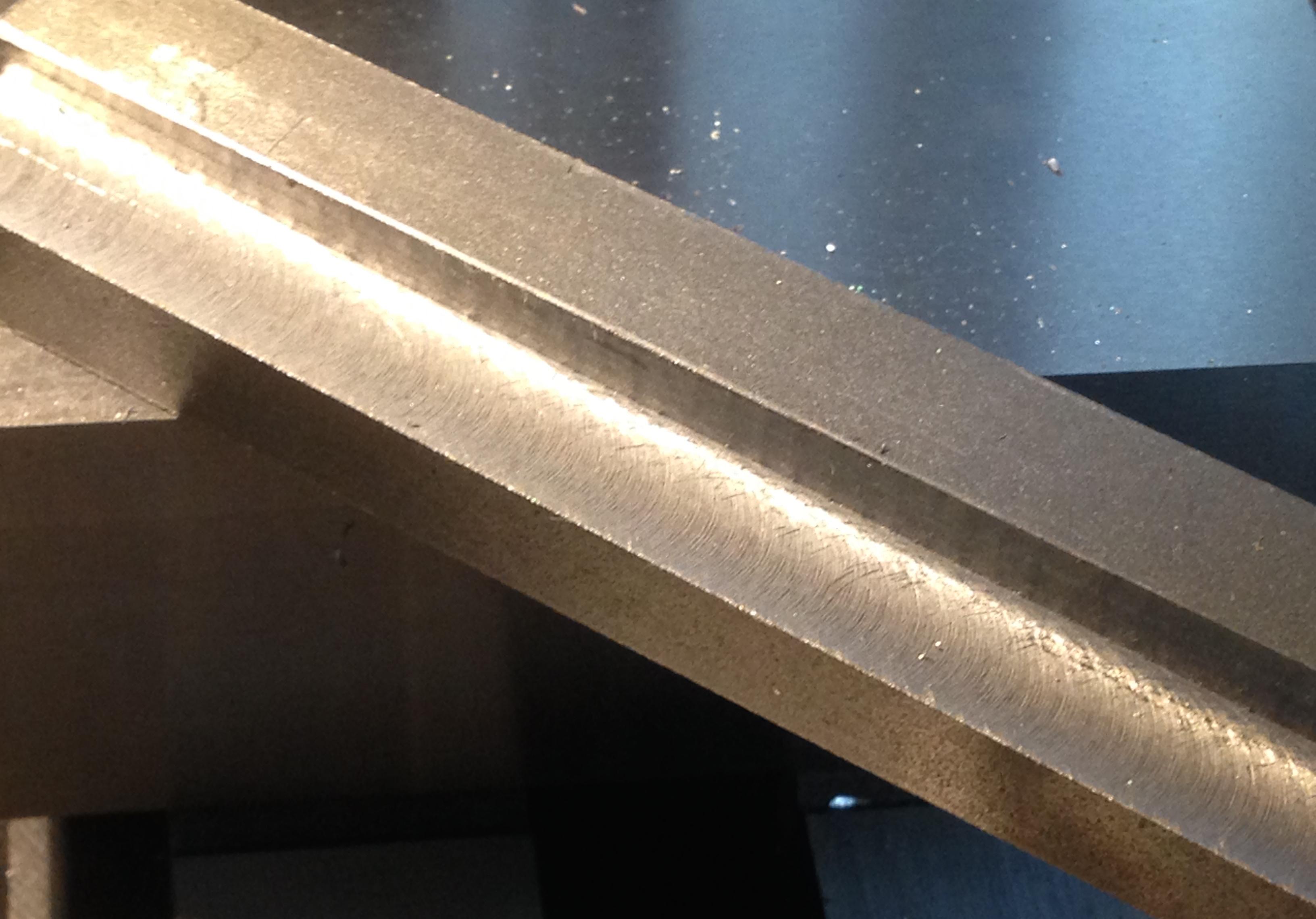

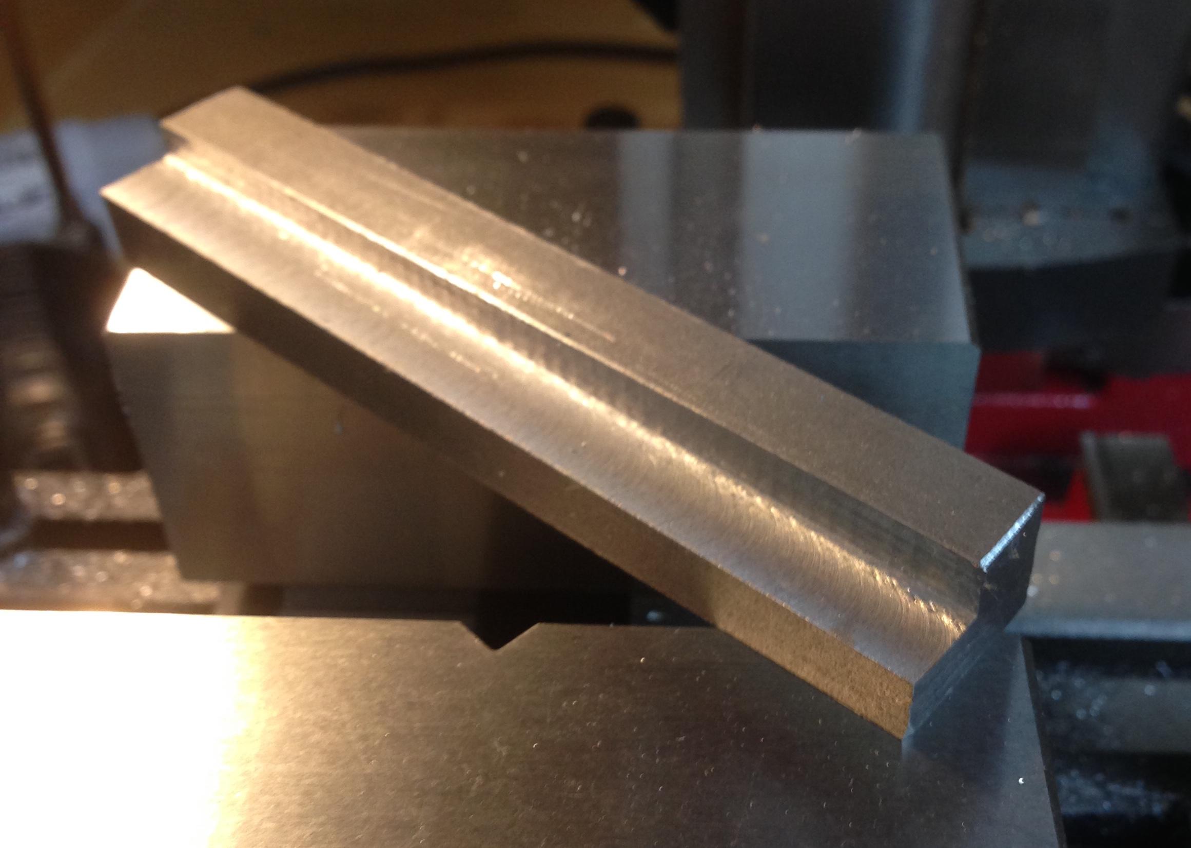

I have finally got the brass gib strips done and the Brackets..But i have a question to all that have done this. Do the Adjustment screws tend to loosen as there is nothing to stop them unwinding ? My thought was to drill and tap a locking grub screw to lock the adjusting screw.. or is this Not needed ?
will post pics soon...If i don't mess it up at the end ! Still learning.

The gib strip adjusting screws should have lock nuts on them......thats what mine was like before and after modding...

Sorry my mistake didn't make it clear... The adjustment screw here....do you think it needs a locking grub screw underneath on the Bracket  to stop it vibrating loose ?
