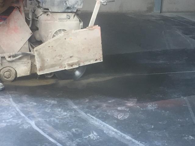

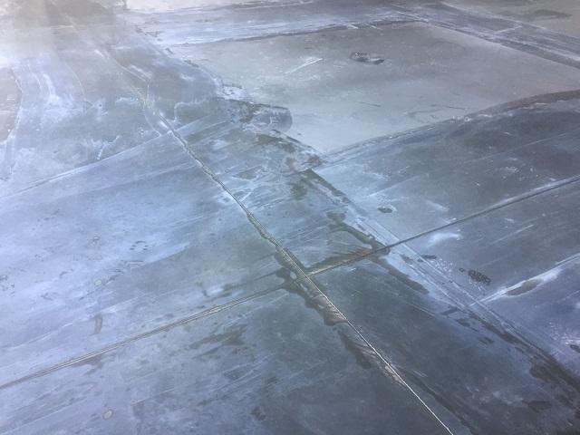

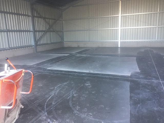

Do the 'preferential crack slots' sever the rebar?
I've just got to know - what did you do with all that concrete in the dumper truck?!?

Pete, the crack inducing slots are I believe about 50 mm deep so should miss the re-bar by quite a way. The surplus concrete was spread out thinly over the pile of crushed concrete so it can easily be reduced to crush when needed !

Nope, they use a much wider blade than average which even if it hit the rebar would take an age to cut through it, especially on the typically lower powered saw they would use.
I've cut hundreds of meters of crack-inducer cuts. Don't like doing it because there's no margin for error - any slight wobble in the cut line stands out a mile. The bigger/better saws actually have a bias adjustment on the rear axle so you can put a bit of 'turn' on the saw to counteract the tendency to turn when pushing the blade mounted on one side. It's handy if you do a lot of roadway work where the blade is always on the same side but if you do work where you have to swap sides like we do you set it to track straight and counter-steer manually by leaning hard on the handle otherwise it's harder to cope with when you swap sides on the blade and the bias is working the wrong way.

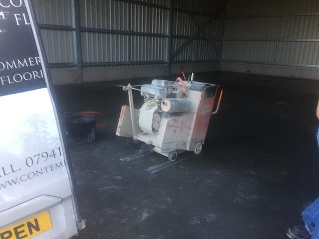

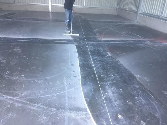

So 07:30 brought another team to saw up the floor to form the preferential cracking positions. This time led by the boss of the company. It didn't take long to saw it up and swab it with a curing compound and they then disappeared over the horizon for breakfast.

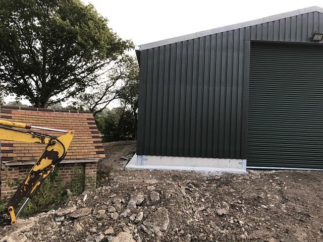

The concrete extends to the outside of the building but because of the radius of the blade and the overhang of the machine the cuts must end short of the wall inside, is that a serious issue?

Remember the slots are to promote crack direction - they go close to the edges but obviously not all the way, but that produces a stress riser that will I'm sure propagate to the true edge.

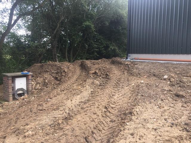

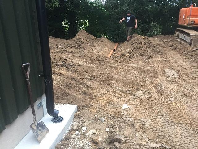

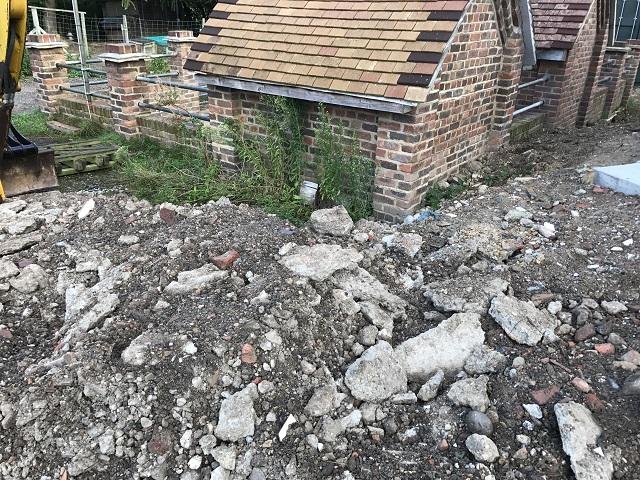

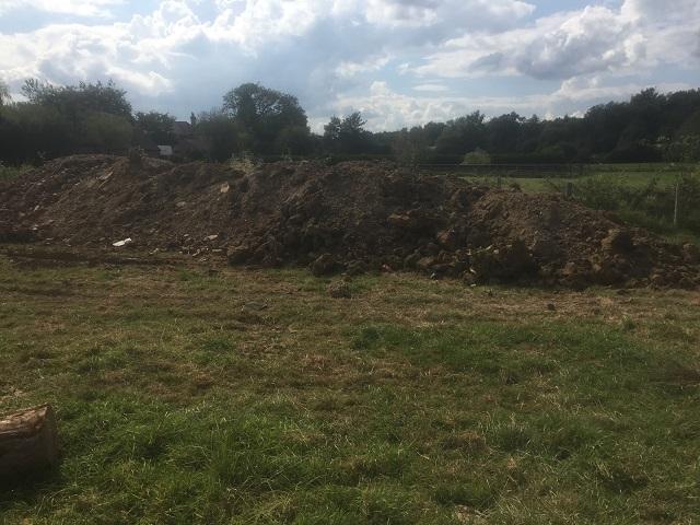

« Reply #285 on: September 07, 2017, 02:42:17 PM »

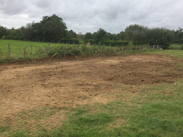

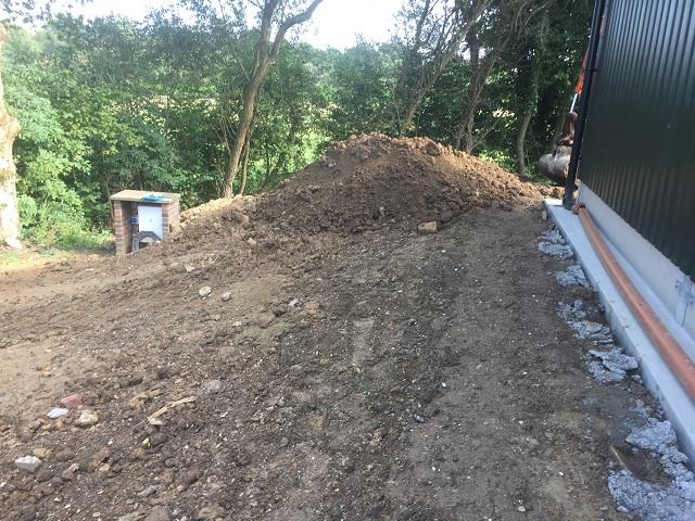

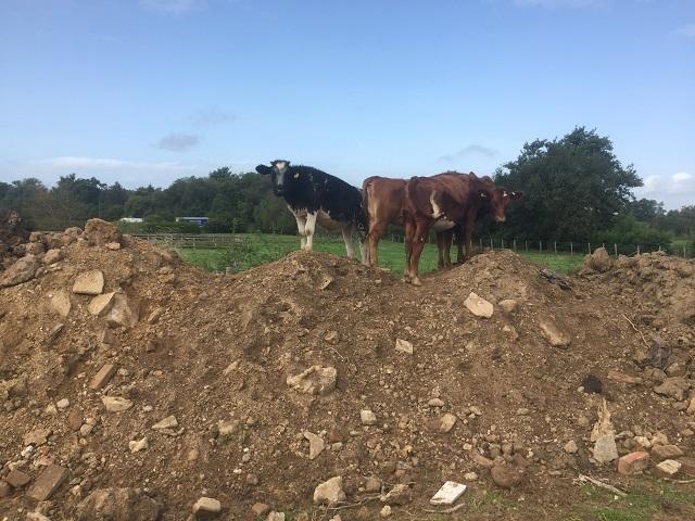

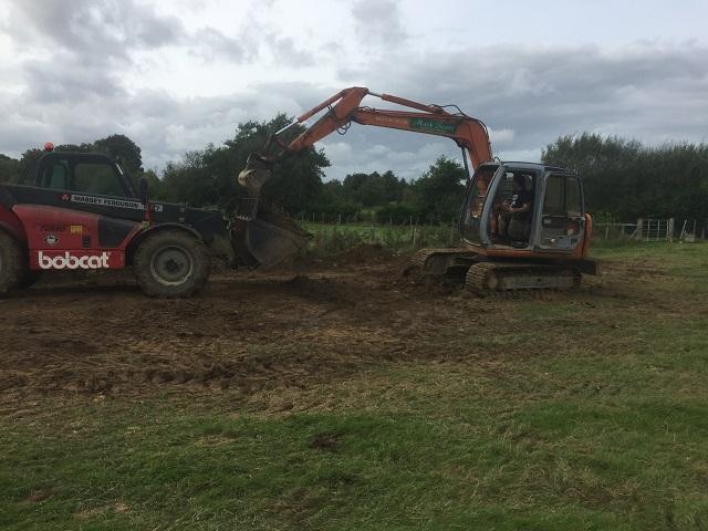

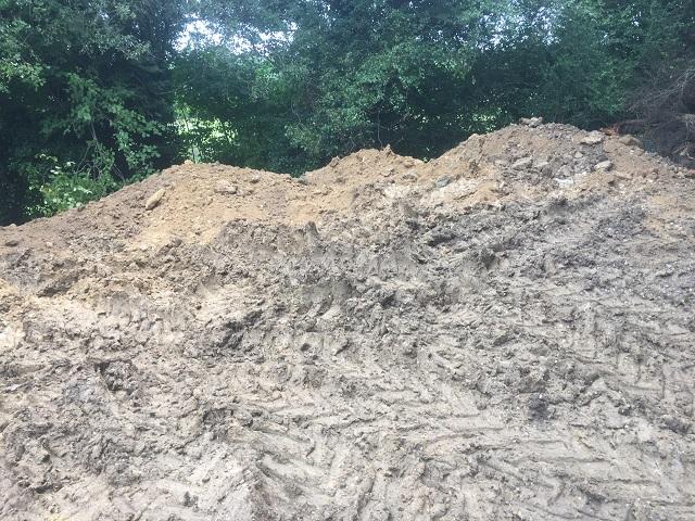

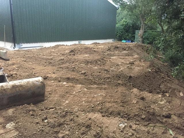

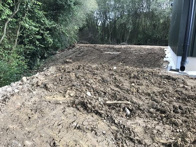

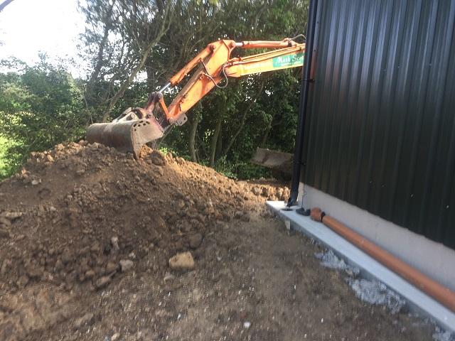

At last things dried up enough to resume earth shifting. First problem, move the cattle off the heap before they leap over the fence  :bugeye:
Fairly monotonous back and forth with the Telehandler until eventually the entire pile was re-located  round the back of the shed and levelled off. Then we trenched and put in the drains for the roof run off.
Loads of not hugely interesting pictures of piles of earth, bull calves and drains follow :  :clap:
Been told that the roller shutter and Pedestrian Door will be fitted Tuesday or Wednesday next week  :thumbup:

Hopefully that's it for importing earth 'fill' - a total of 38 eight wheeler lorry loads  :bugeye:

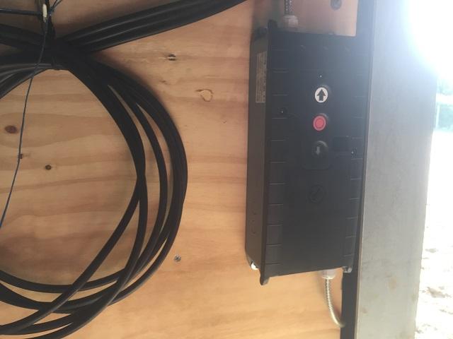

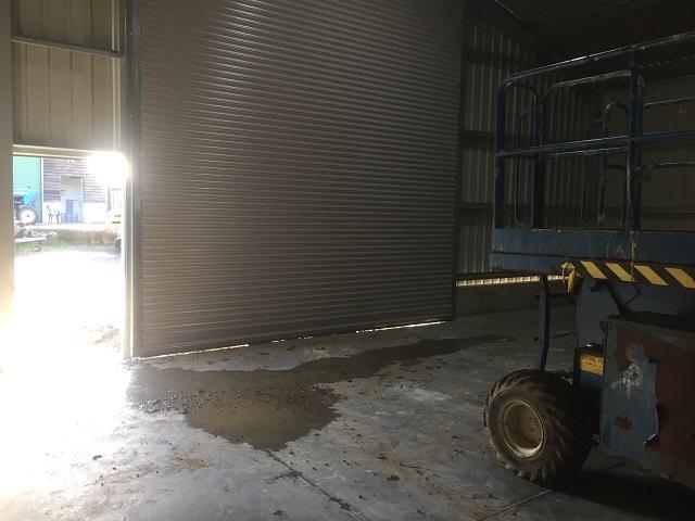

Got a surprise this morning - Darren in early and doing things with his scissor lift. Turns out that the Roller Shutter was due to come in early (noon today) and he had a hydraulic hose to fix first.
I was due to go over to my commercial butcher in Horam to collect some pigs that he'd been dismantling for me, and by the time I'd returned, unpacked, and set curing six sides of bacon and six legs and packed away the rest of the meat in various freezers the door was up and working, albeit on their temporary 3 phase genny.

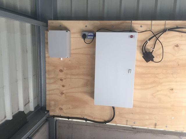

So few actual pictures and I set to this afternoon living up the 3 phase distribution board and wiring a single 13 amp double socket as a temporary source of single phase power.

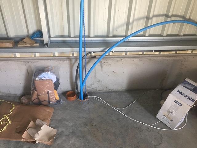

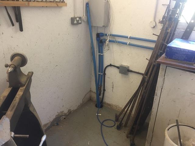

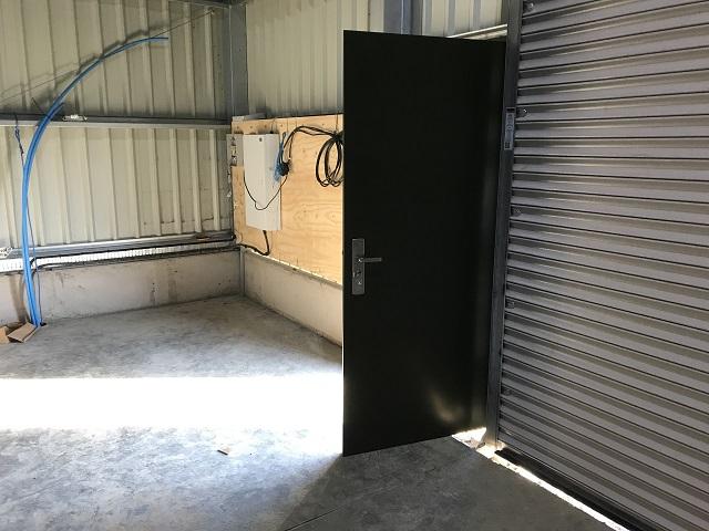

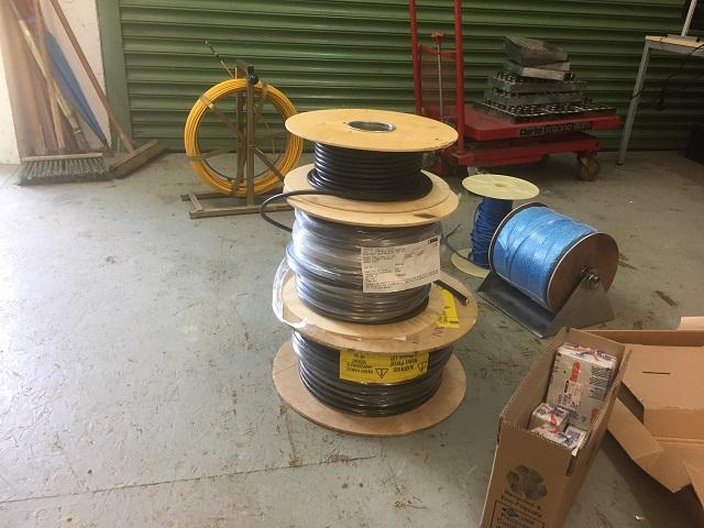

Nice bright dry day but no Darren so far (15:15)  :bang: So I've gone ahead and started pulling pipes and cables through from the Woodwork Shop where I'm sourcing electrical power, compressed air, telephone connections, and my local intranet.
So this morning I got two 25 mm MDPE pipes (water and compressed air), a 6 pair telephone cable, and two Cat5e cables pulled into the duct alongside the three phase 415v cable I pulled through a while back - I also left a heavy 'draw rope' in there for future expansion.
This afternoon I went out and collected yet another drum of rather expensive 3 core x 2.5 mm CSA 'Hi-Tuff' cable to wire up more 13 amp double sockets around the periphery of the shed, but I'm held up awaiting a couple of lengths of 4" cable tray as I've decided that the 'girder clips' I'd planned to use are not holding the incoming three phase cable securely enough.
I can't really progress much further until the handedness of the pedestrian door is decided (to place light switches) and the external flood light goes up (to finalise cable runs.

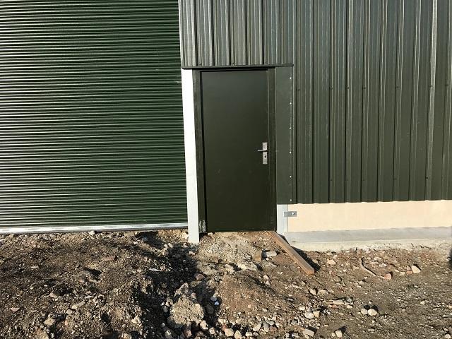

I gave Darren a bit of a nag today and he turned up a little after lunch to start fitting the pedestrian door.
Before that I spent a frustrating couple of hours connecting up the telephone (6 pair) and two Cat5e cables to the wall box I'd previously prepared. The telephone cable being terminated on genuine Krone blocks was no issue - however the Cat5E onto a Chinese 12 way patch panel was a nightmare. Connected it up using it's 'punch down' connections easily enough, but when I came to test it I got very intermittent results. Sometimes good continuity, other times nothing. In desperation I put a pair of standard CAT5e sockets on the cable for testing and had no problems what so ever. Conclusion - this patch panel is pants  :bugeye:
Now I've used 11 of these patch panels elsewhere satisfactorily, but this one is definitely for the bin  !

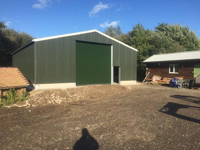

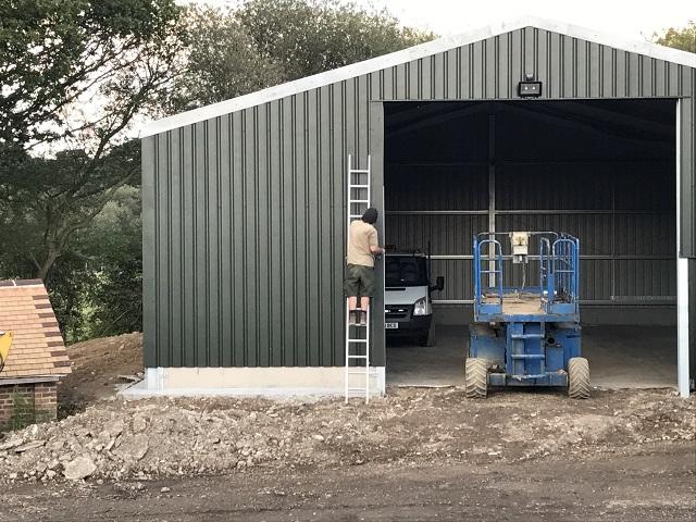

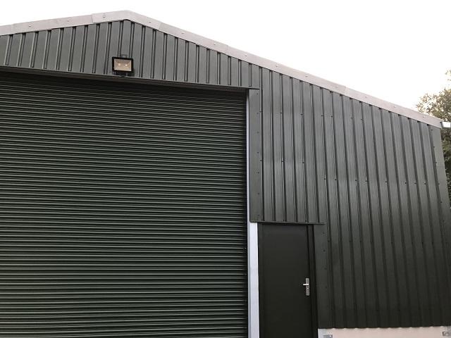

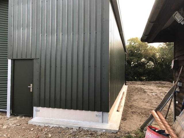

So yesterday (Friday) Darren came in the afternoon and finished adjusting the pedestrian door, fitted my new swanky 100 W LED outside floodlight (with remote control  :ddb: ) and fitted the corner cappings and cappings round the doors.
Mounting the floodlight was slightly problematic and involved making up some brackets so the the weight is taken by internal steel work rather than the flimsy outer cladding - confoundedly odd remote control but I think I now have the hang of it !

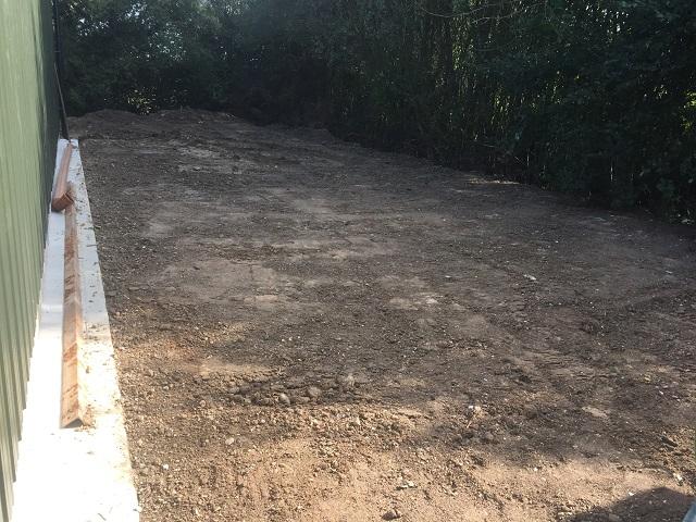

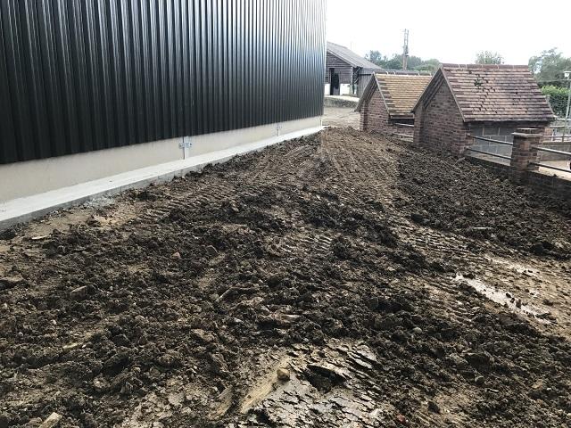

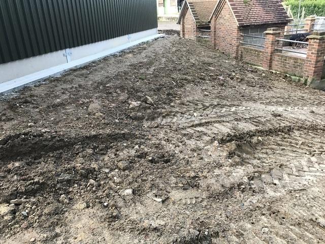

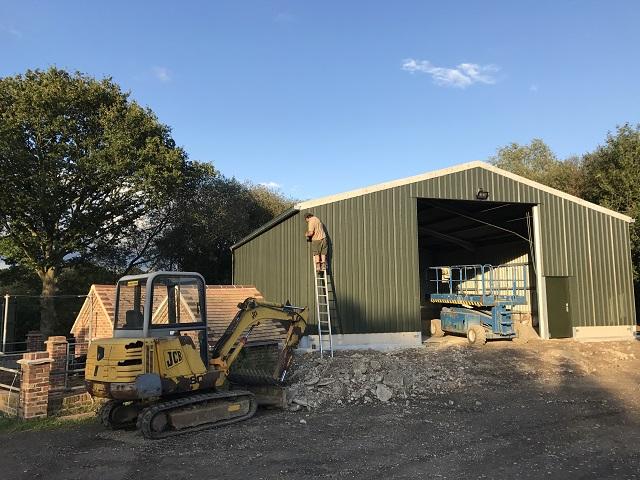

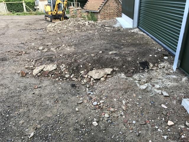

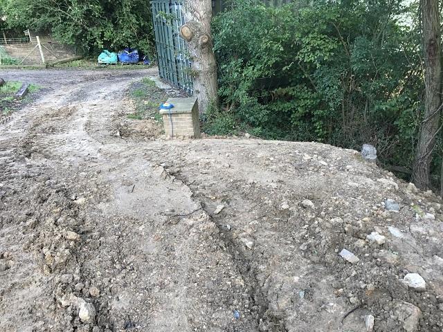

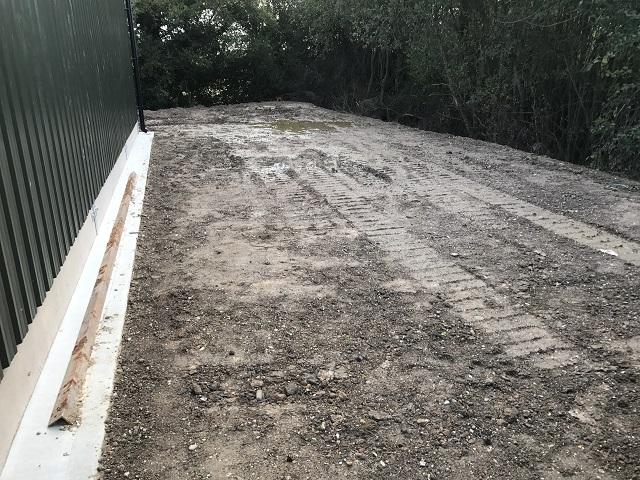

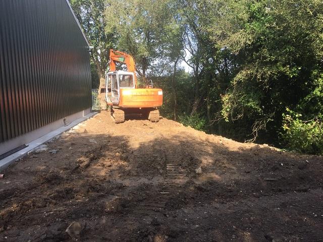

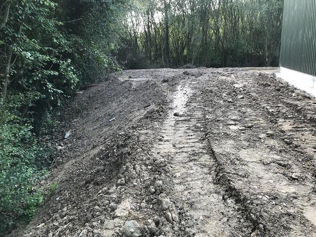

Now on departing yesterday he declared the intention of returning this morning (Saturday) to finish off shifting / grading the surrounding earth and forming the grades around the front so we can visualise how the entry ramp will interface with the yard and decide where to put the Aco flood drains in.

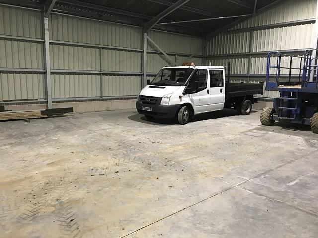

To this end I took a series of 'before' pictures this morning for later comparison:
Meanwhile the chap who rents a container from me was desperate to park a newly acquired small tipper lorry so it seems the shed in now in use !

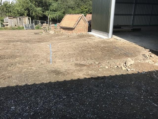

So Darren arrived and shaped in crushed concrete the form of the ramp that will gain access to the building to give us an idea of the overall form things will take. Then he pushed a load of earth around with his 6 ton digger and then 'landscape raked' it with my 3 ton JCB 803. The ground is just a bit too damp to get a decent tilth, but the weather doesn't look too bad for the next few days so play resumes on Monday.
While he was doing that I removed the temporary wiring for the internal and external lighting and then installed the permanent wiring even with the luxury of a light switch next to the door (contrasting with the temporary 13a plug / socket !)

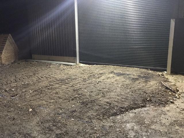

Here you go Matthew - Flood Light lit
