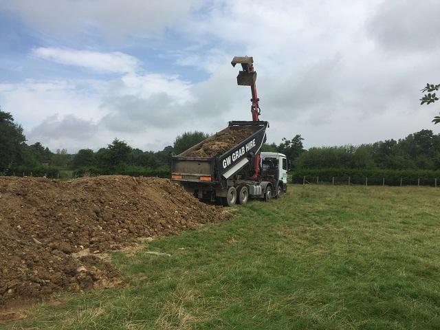

Today was officially A GOOD DAY. A/ Weather forecast was rotten - drizzle all day, but they were wrong  :thumbup: Rain held off until about four in the afternoon. B/ While Darren was doing his stuff I hunted out and found an elusive hydraulic oil leak on the JCB803 which was far easier to cure than I'd expected. A slow drip onto the left hand track - one pipe from the main pump distinctly damp. I'd previously tightened it's fitting. It wasn't until I projected the rear of the machine over the edge of my loading dock and could look up at the area clearly it was obvious that the leak was dripping down the pipe from a pressure test point that wasn't tightened ! A quick couple of turns with a gloved hand and leak cured - things are rarely that simple  :thumbup:
So early on Gary brought in yet another load of variegated soil - I think this is at least the twentieth but I've lost count - hopefully the last

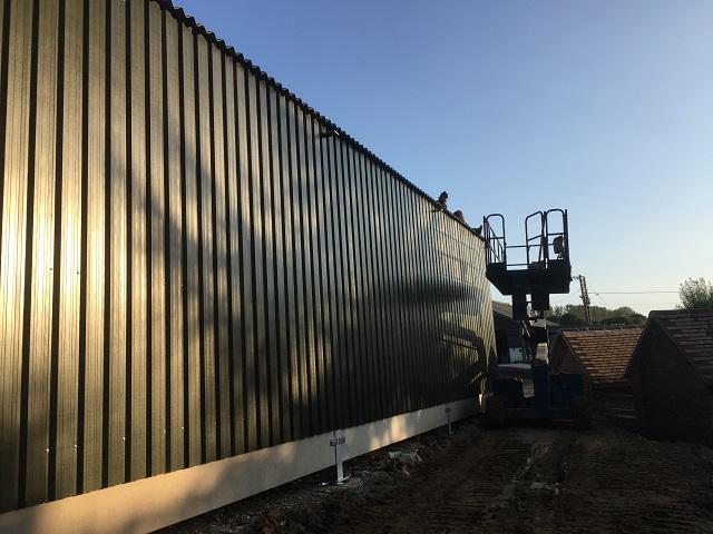

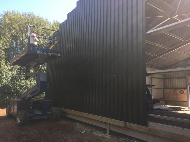

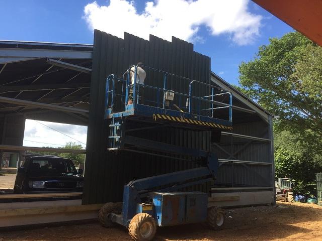

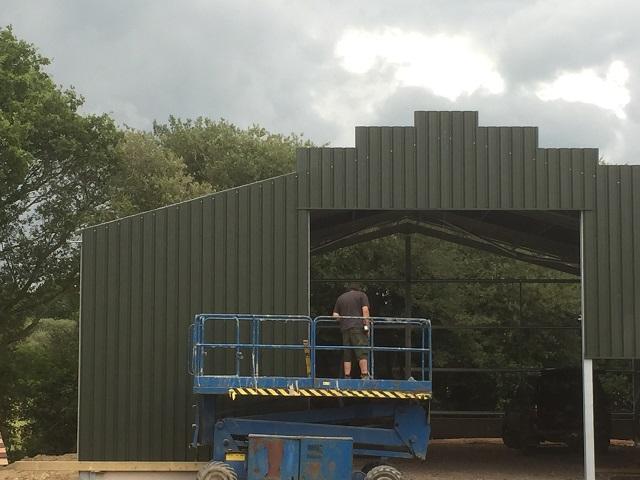

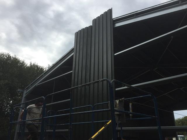

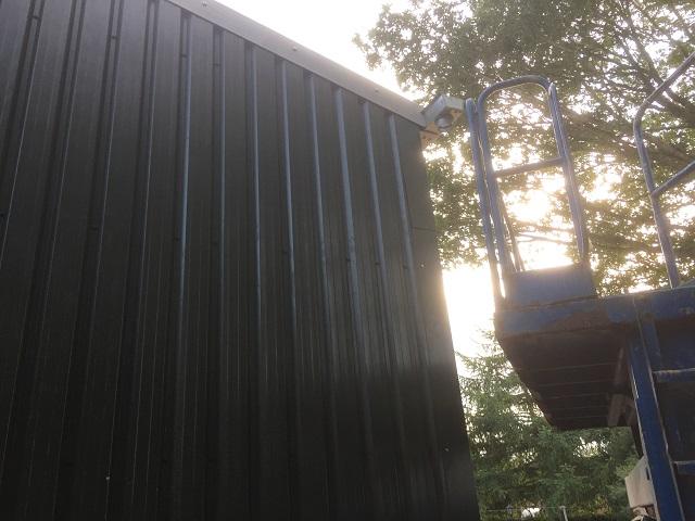

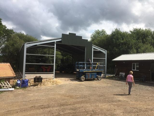

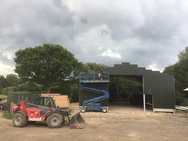

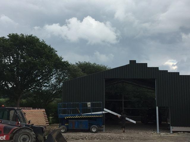

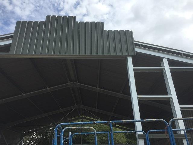

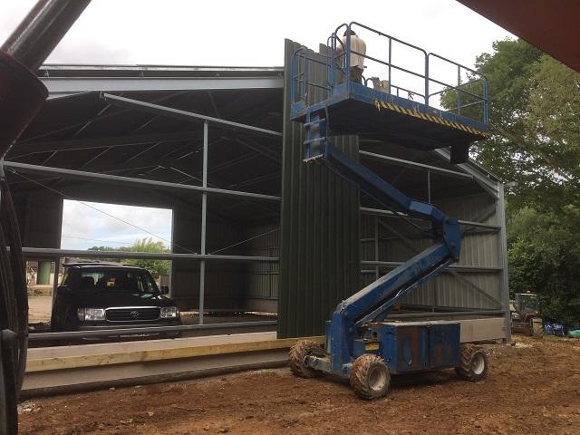

Darren soldiered on fixing the front sheets - this is the most complex side as it has not only the sloping roof but also the piercings of the two doors to work round.

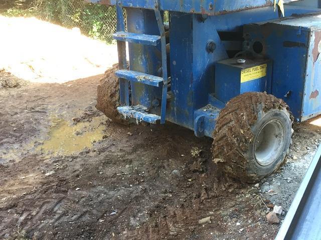

To get at the left hand side he had to create a hardcore platform for his access device to roll on  - once the sheets were in place he could trim back to the roof line with an angle grinder ready for the verge
Re: New Tractor Shed
« Reply #226 on: August 08, 2017, 02:20:38 PM »

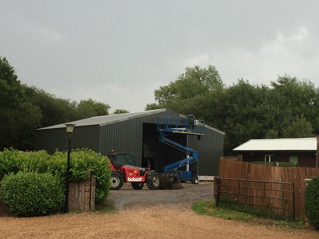

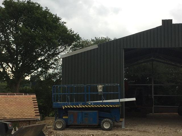

So then for the verge. At this point the heavens opened, and Darren stoically just climbed into his tank suite and carried on  :thumbup:
The verge and capping piece went on fairly easily and then it was just a case of a bit of a tidy up, and leave site. He has other commitments Wednesday and Thursday so play resumes Friday.
Another 'event' today was the appearance of the Roller Shutter Door fitters to take final measurements before they make the roller and personnel doors - all the way down the country from Bolton in Lancashire  :bugeye: :bugeye:
Door will take a few weeks to be fitted, and needs to be in place before the floor concrete goes down. This morning I bent up brackets to mount the 100 Watt LED Floodlights and gave them a coat of cold galvanising - we'll need lights when concreting if the weather is against us and the door has to be closed

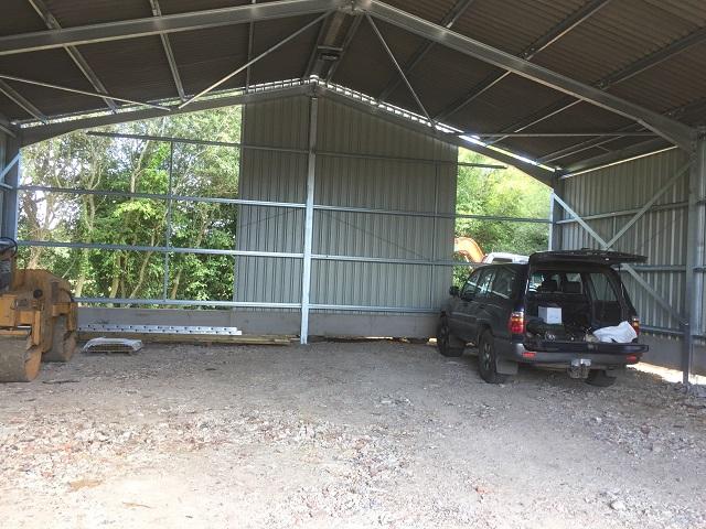

Pete, this is a variation on a standard design for a "Grain Store", where keeping rodents out is considered desirable !
Usually the concrete sides would be considerably taller, and also normally the building would be much larger - this is only 1800 square foot which s small for an agricultural building.
Yes it's designed as a "whole kit" in order that it can be gone over by a structural engineer and granted "CE Approval" that the demi-gods in Brussels demand these days.
I think to trim the sheets before delivery would be pushing their luck, as things move, and aren't necessarily as square as the designers drawing board.
Had full planning permission been needed they would / could provide full drawings, but this has been built under a "28 day Notice" which allows me to build up to 5000 square foot each year if I want so long as the building falls under certain usage and construction requirements.
All I had to do was provide a site and location plan, along with a description of the materials used and external appearance on the application form.

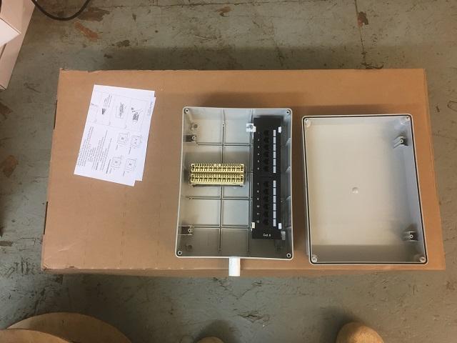

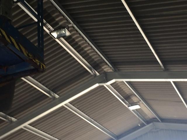

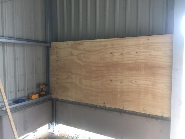

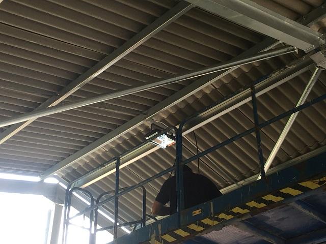

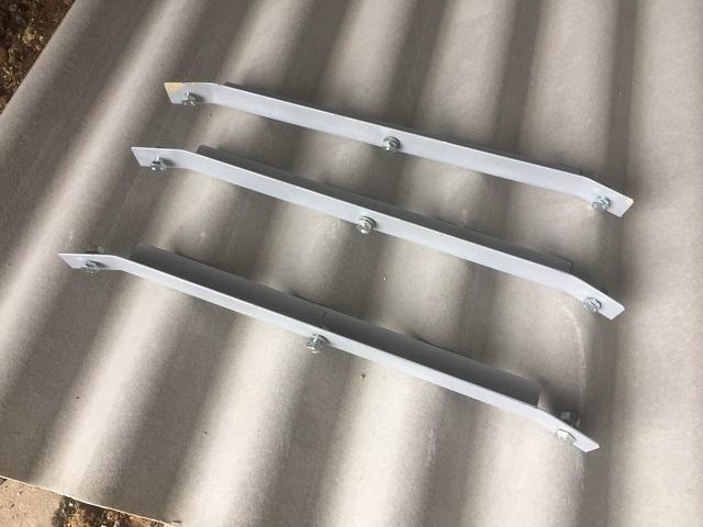

First a photo of the brackets I made yesterday to mount the LED Floodlights - they span the two highest Z Purlins
Got a couple of minor things done today on the T / S :

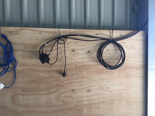

a/ Mounted the 8x4 of 18 mm 'Water and Boil Proof' plywood onto the Z Purlins ready to take the main electrical distribution box, the CAT5 & Telephone termination box, and also the Roller Shutter Door control box. I stiffened it first with four vertical bits of 4x2 on the reverse.
From the way the Z Purlins lie the top had to be secured with 'sheeting screws' as the back wasn't accessible, but the bottom is held by 6 mm coach bolts and nuts as I can get my hand round the purlin for the nuts!
b/ Made up the Termination Box for the CAT5 and Telephone cables ready to mount on the above board.
I'll not actually mount anything on the board yet until the concreting is done, as it's bound to get pretty messy when that starts - lights and roller shutter will be fed temporarily by wander leads

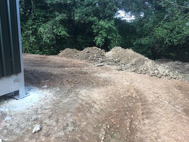

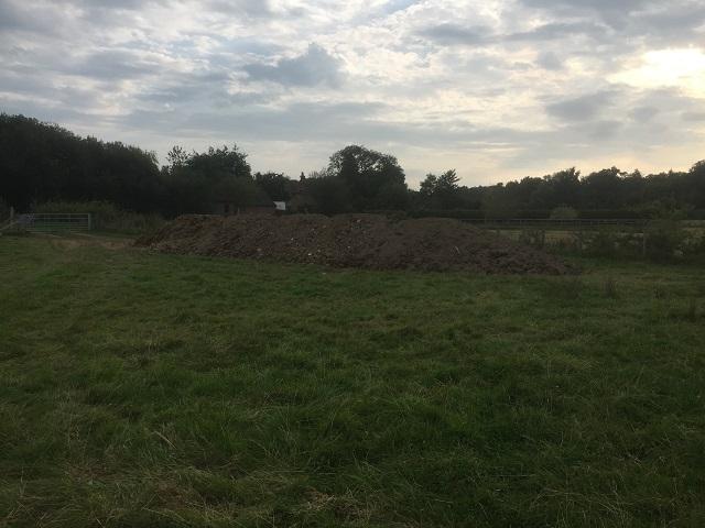

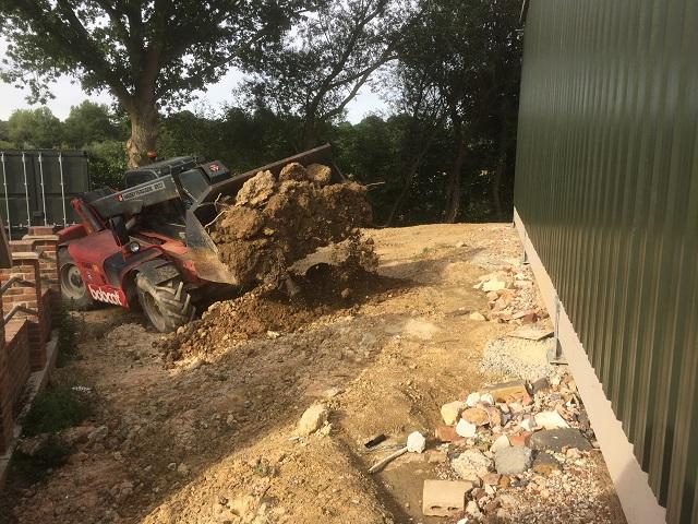

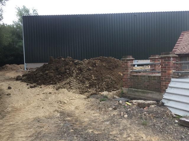

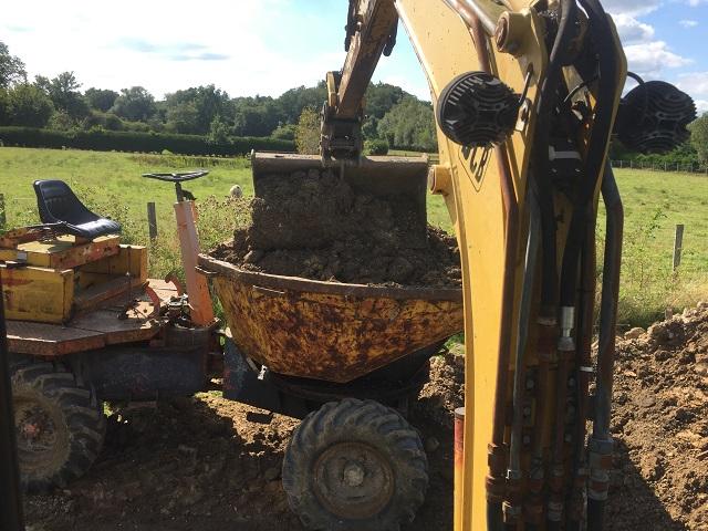

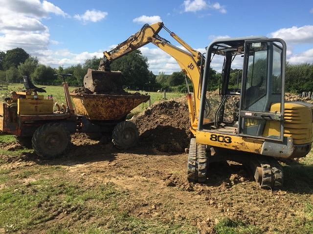

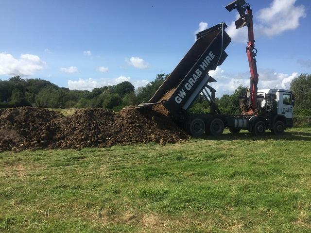

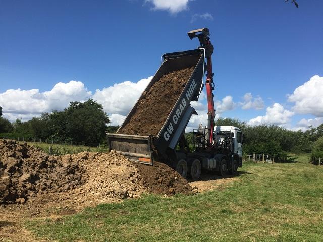

I decided to start moving that huge 100 ton pile of earth from the field to round the back of the shed where it's needed - my kit is a lot smaller than Darren's - I've moved one entire 8 wheeler load, which took 11 of my Thwaites 2 cylinder dumper loads. That approximately equates, as it's a 2 ton dumper and an 8 wheeler load is about 20 tons.
It looks a particularly unimpressive heap in the pictures, and the remaining 'hole' seems flattened by the camera, but in reality they are large 'objects' If the weather holds and I can escape family commitments I'll see if I can 'rinse and repeat' tomorrow (Sunday)
« Reply #231 on: August 13, 2017, 08:50:24 AM »
As I'd hoped, I moved another 20 tons this morning. No pictures, not a lot of point, one pile has shrunk and the other grown  :lol:

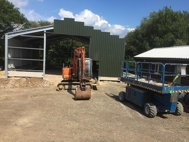

So at 5 pm today Darren re-emerged from hibernation  :lol:
(In fairness he'd been doing urgent repairs to a grain store door)

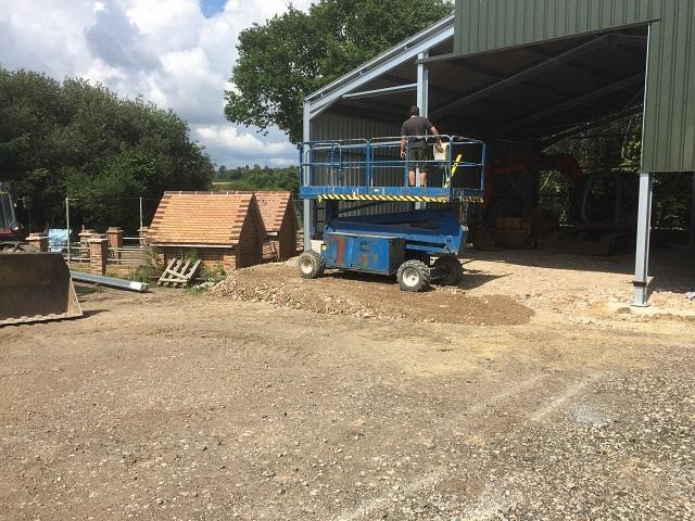

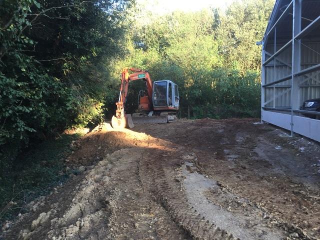

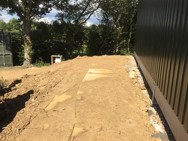

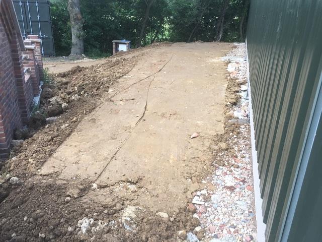

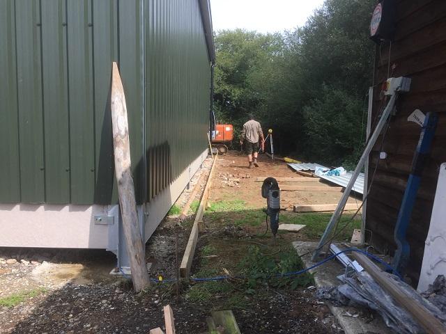

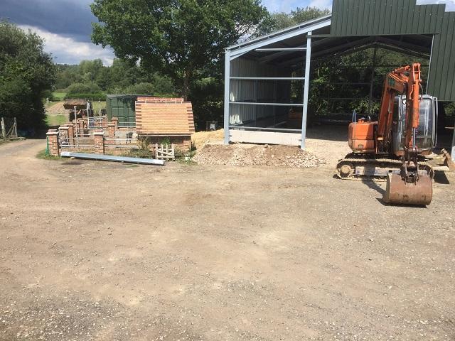

He started building an earth platform on the side of the shed where the 'Pig Palaces' are in order that he can run his motorised access lift there to fit the heavy galvanised steel guttering, and more easily finish off screwing down the roof sheeting.
Hopefully he returns tomorrow .......  :med:

A very wet night with loads of rain made the platform that Darren formed yesterday a soggy mess  :bang:

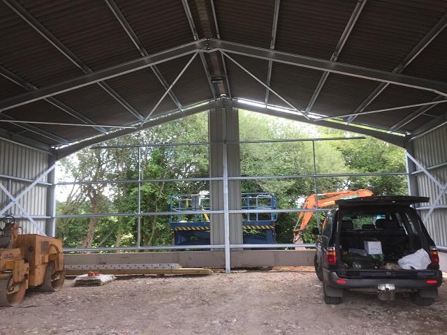

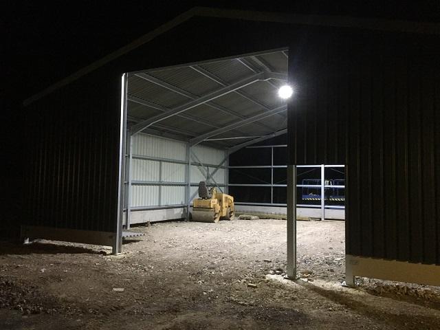

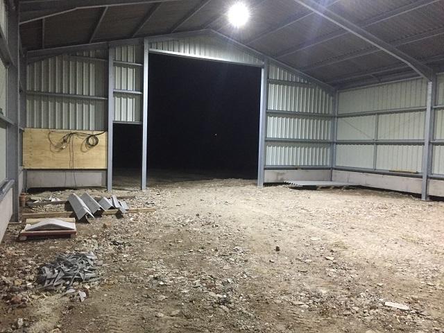

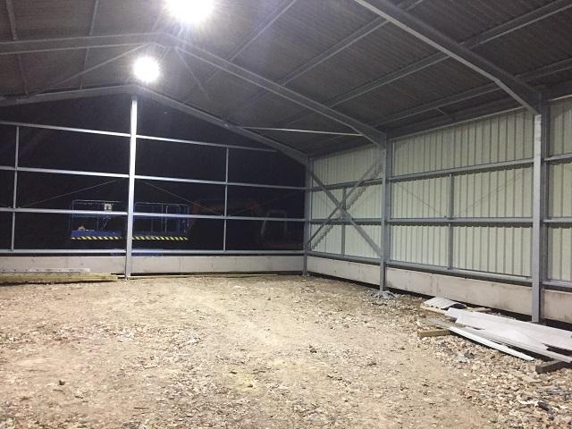

While things were drying off we put the flood lights up and I've wired them temporarily to a plug and socket as I can't be sure where the final switches can go until the people installing the roller and personnel doors have done their stuff

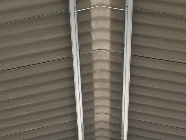

After that Darren went back up on the roof and did the final screwing down of the corrugated fibre cement roofing sheets
« Reply #235 on: August 15, 2017, 05:08:31 PM »

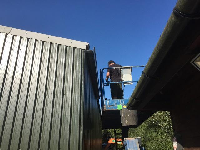

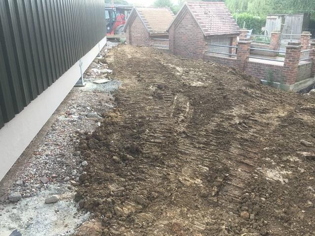

Then to dry up that platform Darren scooped up some of the earth that I shifted at the weekend and overspread in on the platform as it was still quite dry below the surface.

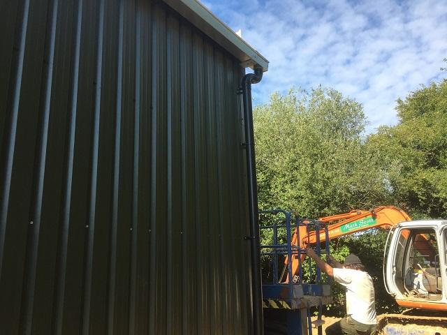

This let him get his motorised lift round to start putting up the galvanised gutters.

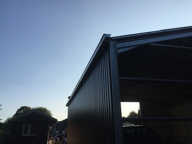

It was pretty dark by the time he left, and I couldn't resist going back out and trying the flood lights to see how effective they are: Answer - Very  :ddb:

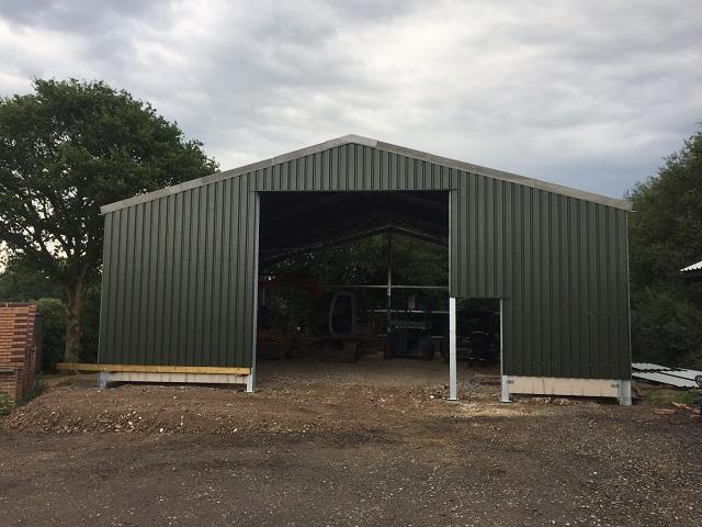

 :scratch: I assume you are not putting the back on the shed until the doors go in to avoid the wind pulling the loose sheets about.
It is looking a very useful space but I am not sure if the front door is tall enough to take a Traction engine chimney :(

It should he OK, traction engine chimneys are made dis-mountable for that reason!!
Cheers, Matthew
« Reply #239 on: August 16, 2017, 07:09:26 AM »
Give me the Traction Engine Jo and I'll see if I can squeeze it in  :lol:
Back sheets going on as I type - photos later. He left the back off until the roof sheets were fully screwed down, as the door opening faces the prevailing wind (roughly West) and there's every possibility of flying sheets with strong gusts.

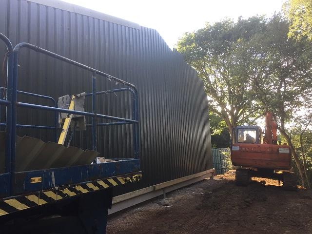

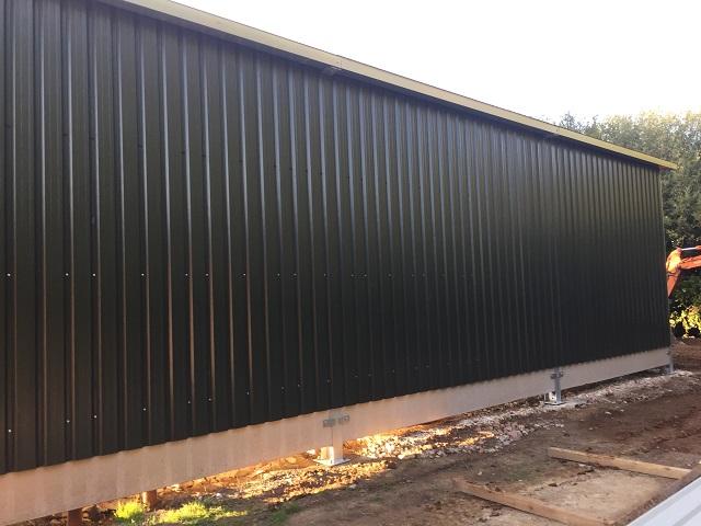

So as promised a few pictures of the rear wall cladding going on. Rather repetitive I'm afraid but at least it's now done  :thumbup:
« Reply #243 on: August 16, 2017, 04:10:53 PM »

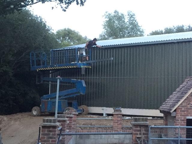

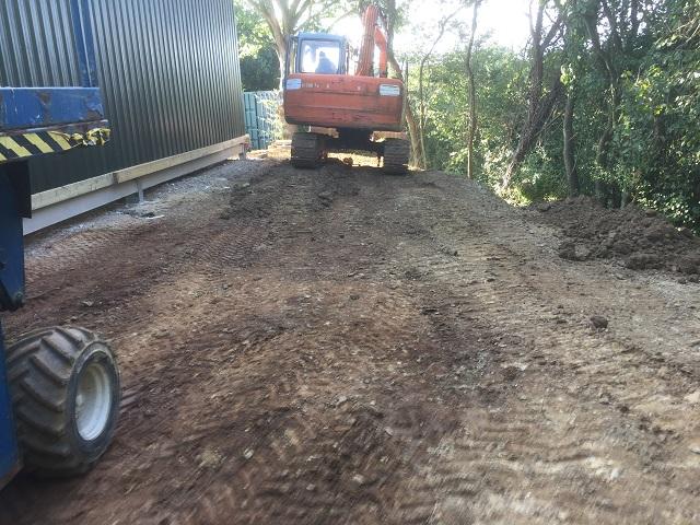

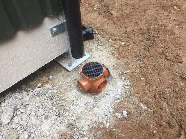

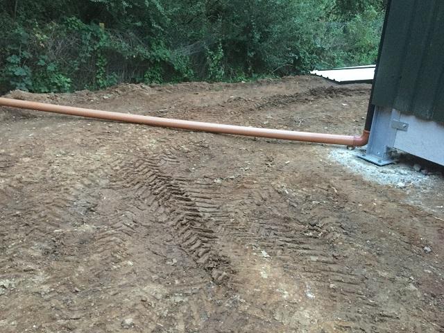

Having clad the rear wall we were able to get the downspouts fitted, and as rain is forecast overnight we have fitted temporary 90 degree bends and pipe leading away from the building. Eventually there will be roddable traps where the 90 degree bends currently are.
Then we need to add a fair amount of height to bring ground level behind the shed up to meet the concrete floor. To this end I've ordered yet more lorry loads of earth - another four eight wheeler loads  :bugeye:

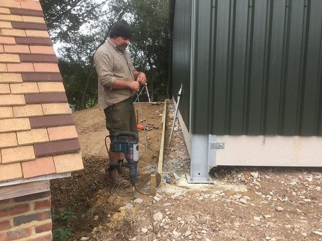

Darren chipped away at the corner concrete stanchion footings to correctly set the height of the roof drain and then started on making the form-work to define the outer edge of the floor slab,

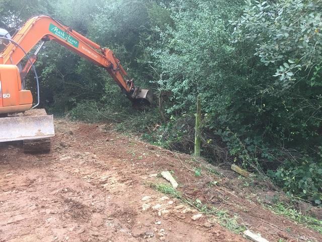

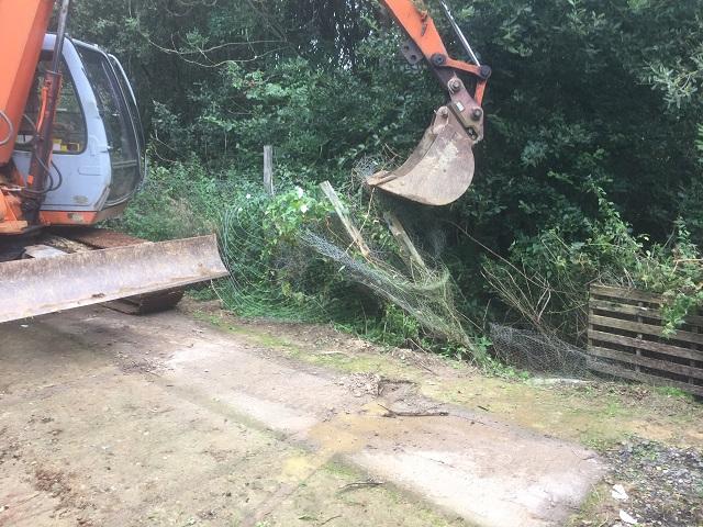

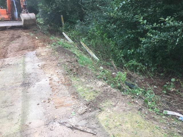

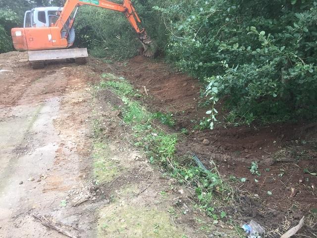

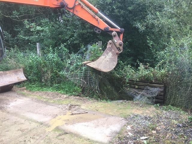

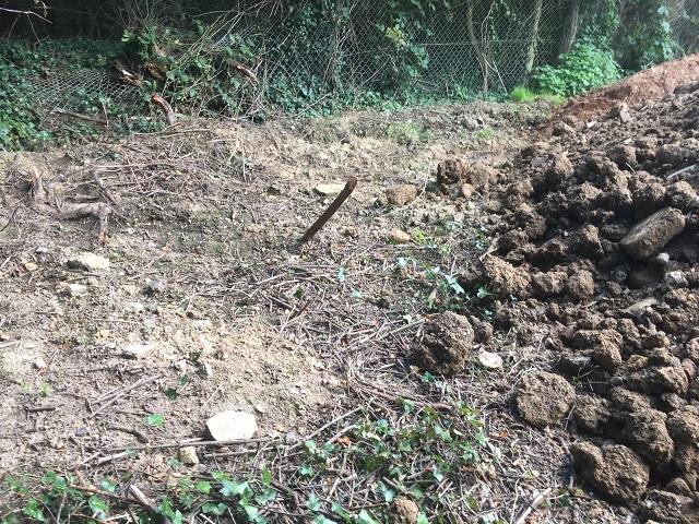

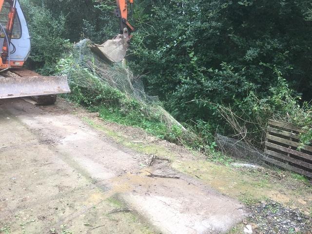

I then got him to pull out an old chainlink & concrete post fence that was well beyond it's sell by date that ran down the side of the shed. The idea being that the earth buildup can extend to the boundary with the new stock fence planted on top rather than at the bottom of a slope. This increases the useful area and makes the fencing easier.
The fence we pulled out had been 'repaired' in many places with every sort of wire mesh and tat that you can imagine
