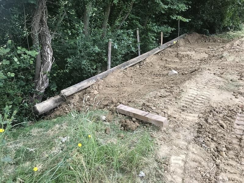

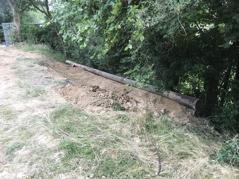

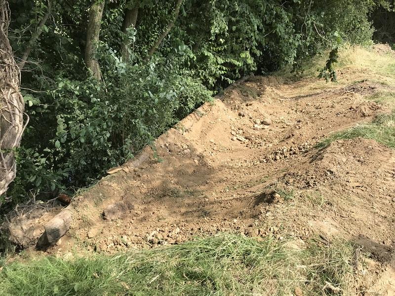

I decided the time was right to start reinforcing the bank behind the tractor shed and building the bank up to straighten the run for the fencing. I'd hoped to get Darren back to do it, but he's far too busy hay making and I want to shift the earth before the weather breaks.
As he had left it, the bank behind the shed had a curve to it which would make getting a decently taut fence in neigh on impossible. There are convenient large trees at the stream edge, and I'd obtained four massive electricity poles that had been replaced on our field. The plan being to rest them against the trees as retainers, and compact earth behind them, bringing the bank up so that the top was reasonably straight.
Obviously over time the electricity poles will rot, but by that time the Hazel and Willow saplings that I will plant will have rooted and hold it all together.

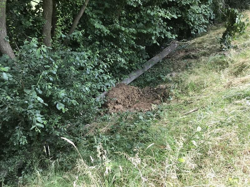

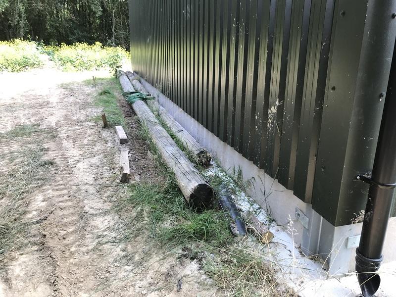

First job - extend one of the roof drain pipe by 1 metre so it terminates beyond the new barrier. Then carefully roll a pole down the bank - this one was great fun as it had to be slotted under the roof drain - these poles are over 35 foot long and weigh something just over a ton - great fun with just me and the JCB803 - oh for a banksman !
Then I moved 20 tons of earth from the field where I've had it stock piled for some time, and back filled behind the pole.

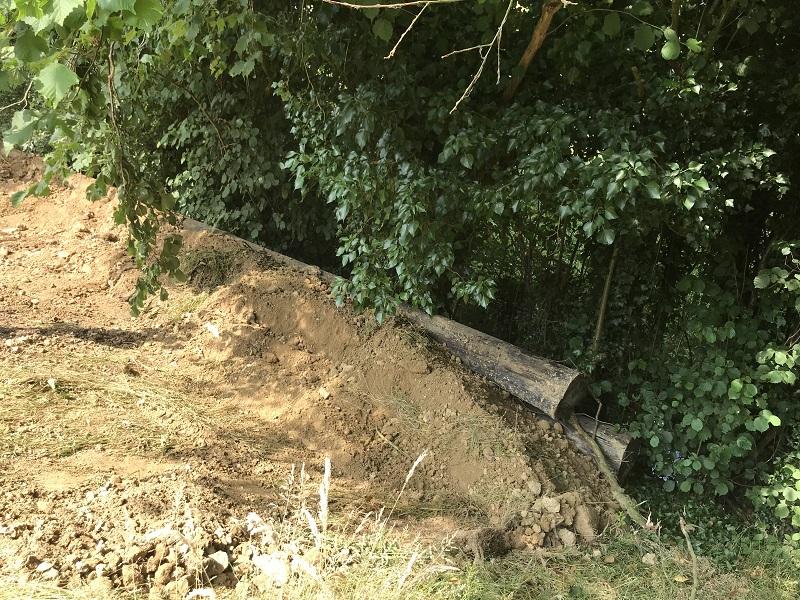

Second pole was easy by comparison, just roll it into place, poke it with the digger to final location, and start back filling. I've two more poles to do, and about 120 tons of earth to ram behind them, but that's a job for tomorrow as the pigs want feeding

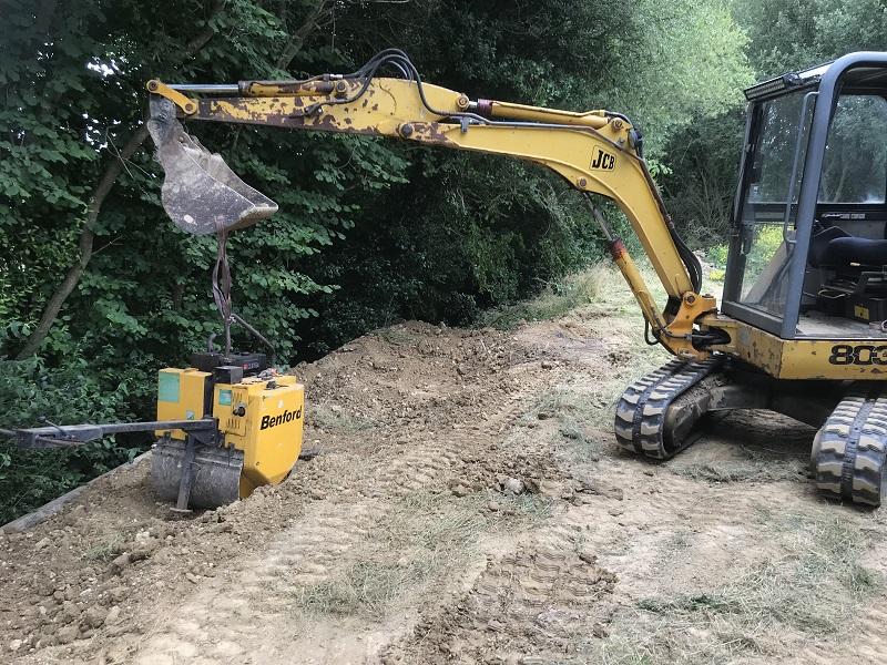

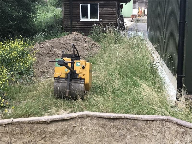

It's important that this build up of earth is well compacted, so I decided to try and get the Benford vibrating roller on it. First question - will it self propel up the 1 in 4 slope up behind the tractor shed - YES amazingly  :ddb:
So now to lower it down onto the level I've so far built up to - JCB 803 took it in it's stride.
Roll third pole into place - poke it in with the digger bucket
Then I brought another 20 tons of earth up in the dumper truck, spread it about and again used the vibrating roller to bed it in well.
The fourth pole has 'run out of tree' to rest it against, so I've sunk some fencing posts in front of the other three poles, and it will have to sit forwards a pole width - no great issue.

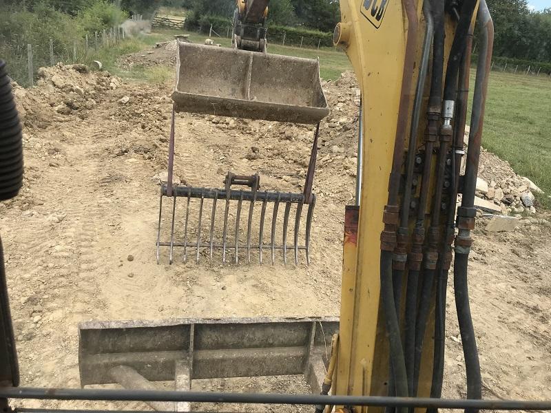

Then I needed to shift more earth, but what's left is rather full of rubble - so I started separating it using the pronged 'land rake' on the JCB.
It was as I did a rotate in the cab I noticed the oil slick  :bang:
Oil pouring out of the rear seal of the main three section hydraulic pump, so work has had to stop until a replacement arrives.

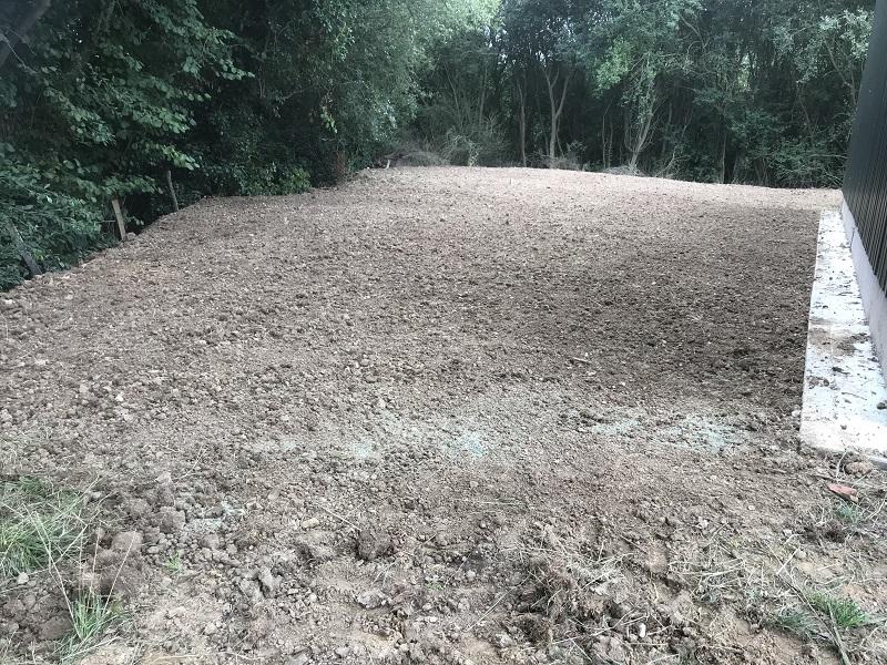

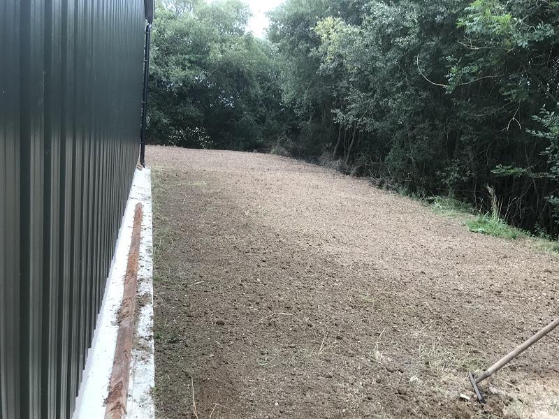

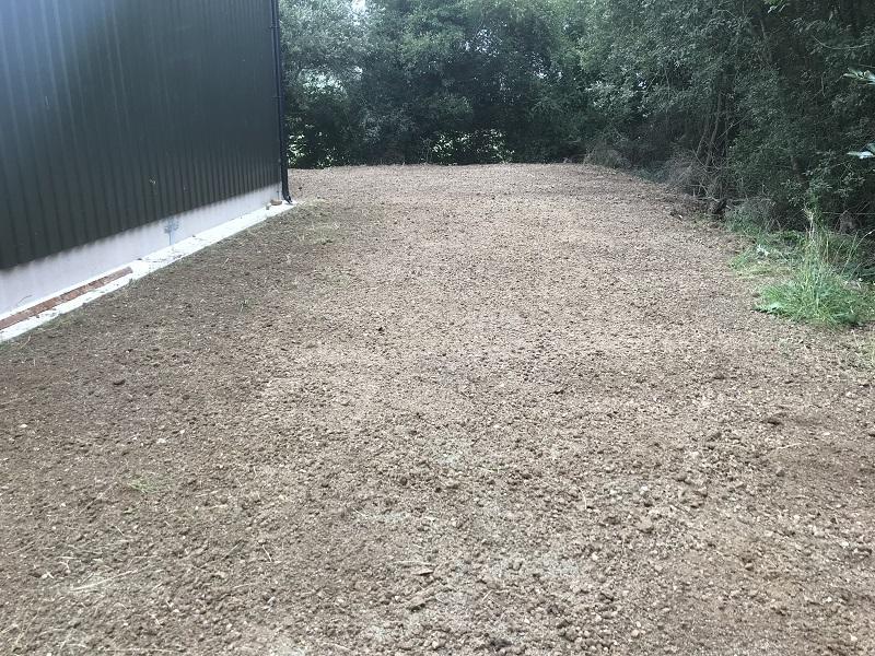

At long last I've managed to spread and level the 120 tons of 'top soil' - well slightly better than the sub-soil that I used for the build up ! And on Thurday raked it to a tilth, seeded it, and raked it again.
The weather was kind to me - the piles of quasi top soil had dried nicely in the recent very hot dry spell, so spread reasonably well,  and just as I was finishing the second raking - raking in the hand sown seed - it started to drizzle, which developed into a reasonably heavy prolonged bit of rain - 7 mm in four hours - absolutely ideal for the seed.
Now my arms are aching from the raking and (oddly) somewhat more from the hand broadcasting of 27.5 kG of grass seed - approximately a domestic dustbin full at 70 grams to the square metre. Why a dust bin - well I had three types of seed that needed mixing and it was slightly more than would fit in the bin!
It now needs to 'establish' and will probably be cut a few times this season, but I will leave it to probably early summer next year before I fence it to give the made up ground time to settle a bit.

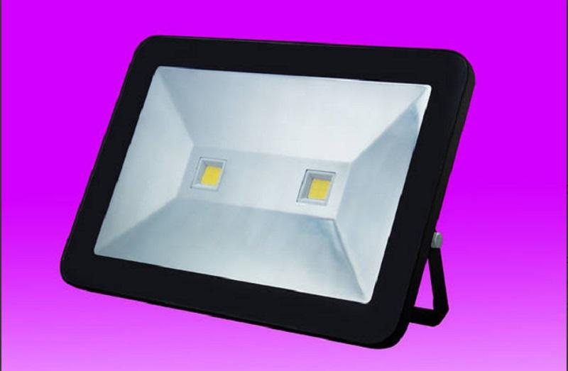

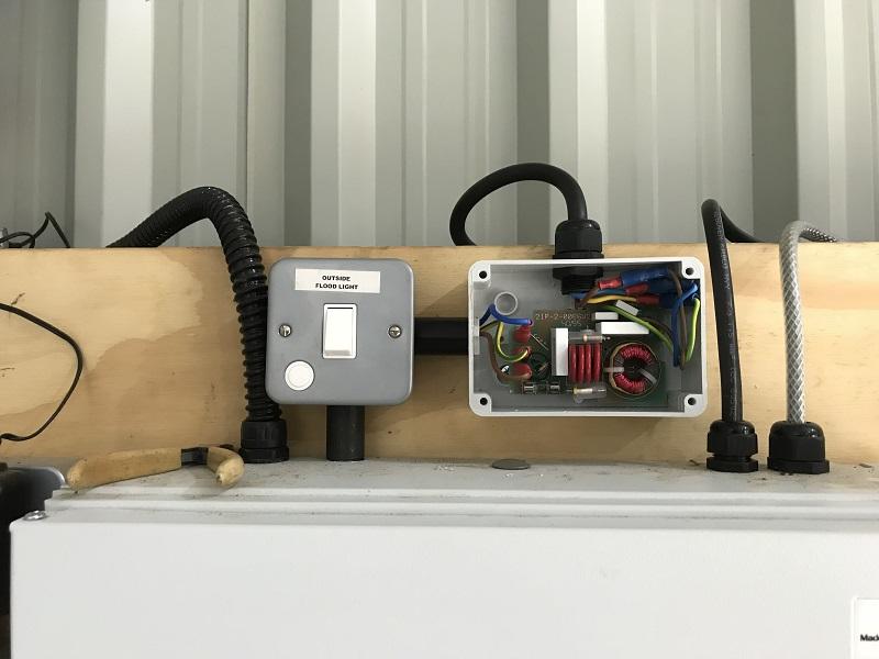

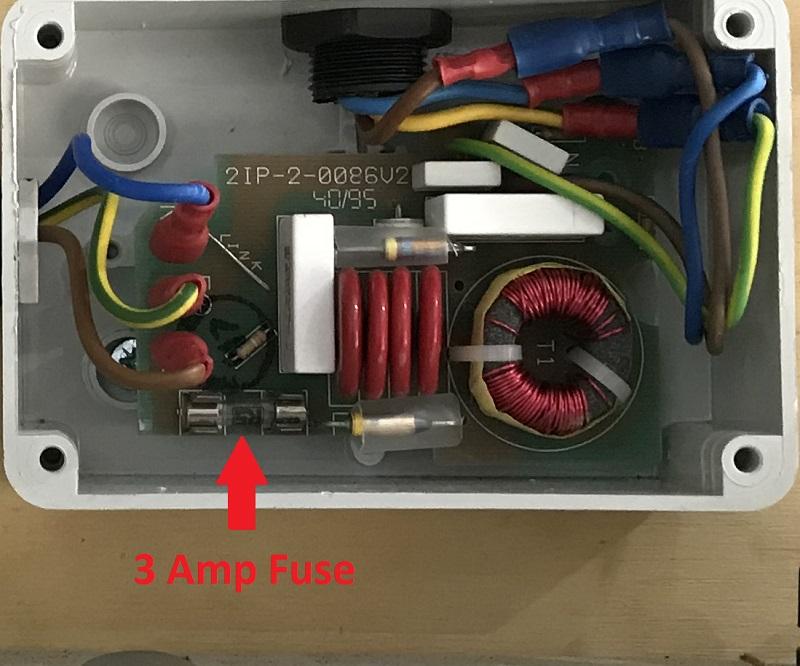

The 100 watt LED Flood Light on the gable end of the tractor shed over the roller shutter door has given problems ever since installation back in August 2017. It has a PIR built in to a flat glass fronted unit. So far five have failed and been replaced but I'm getting fed up having to keep climbing the long ladder to change them. One failed permanently 'on' but the others just failed, no life, nothing.
TLC who supplied the original light have been very good, bringing out a replacement usually the day I report the fault, but they are getting no feed back from the maker as to what the failure mode is. I have a further three identical units without the PIR built in, in the roof of the tractor shed, and, touch wood, all are working just fine.
Now our voltage now a days is pretty well in the middle of the specification at 235 and doesn't vary much, my only thought was that perhaps the PIR inside the unit is susceptible to voltage spikes. Now this lighting circuit is on quite a different feed from the consumer unit than the big loads of motors and welders in the workshop, but never the less just maybe something is getting though. A kind contact on the UK DIY newsgroup sent me a pair of surge arrestors removed from some equipment that he has been working on, so today I mounted one in a box and wired it up.
. . .time only will tell if it makes any difference  :med:

You most likely know that he MOV:s has tendency to take a certain amount of hit and then die to short circuit, therefore they should have some sort of fuse attached at front or it thermal fuse tied up with MOV. Most of the commercial units have been tested and build accordingly. Those burn hot.
https://en.wikipedia.org/wiki/Varistor
  • Posts: 9148
Re: New Tractor Shed
« Reply #365 on: September 30, 2018, 03:39:58 PM »
Thanks for the heads up Pekka, but yes the unit is fused at 3 amps

having had a bad experience with glass mains fuses
either  exploding or continuing to conduct due to the copper film on the inside of the glass tube
I would use a  3A   1" HRC fuse  ( as used in UK 13A plugs)
  • Posts: 9148
« Reply #367 on: October 01, 2018, 07:07:26 AM »
John,
It's fed via a 5 amp MCB that is solely for this circuit with the one lamp on it, and the entire 3 phase distribution box in which the MCB lives is protected by a 30 mA RCD, so I don't think that there's too much to worry about.
But as I said to Pekka, thanks for the 'heads up'
