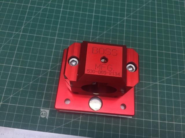

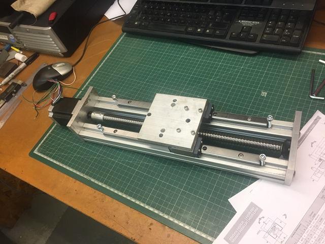

Since I first got this machine I've not been overly happy with the Z Axis. It's main mounting plate had been bent at one time, and both the normal Z movement and also the 'floating Z Axis' used for material sensing only ran on single  linear rails, resulting in a bit of side to side wobble and tilt. Don't get me wrong - it works - but it's not overly robust in it's design and there were features that I wanted to incorporate - namely:
A/ Dual parallel rails for the main Z and the floating Z movements
B/ A Magnetic Breakaway Torch Mount
C/ Emergency Stop to be asserted if the Magnetic Breakaway is triggered
Now this is all very well, but I didn't want to strip down the existing Z axis and hence stop me using the machine, while building the new one. So I decided to start from scratch and make a modular Z axis that would be on plugs and sockets and fit existing mounts on the machine.
I procrastinated for a long time, looking at economical ways of getting the linear ways, ball screw and nut, bearings etc until eventually a 'Prototype Z Axis' turned up on eBay. It had been put together but obviously never used, and would need re-making, but it had the linear rails, ball screw and nut, bearings, stepper etc just as I wanted, but for far less than the total of buying the separate items  :clap:

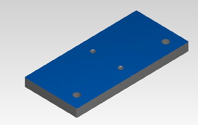

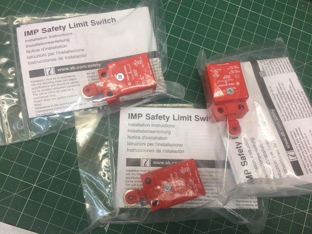

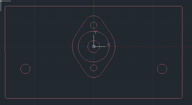

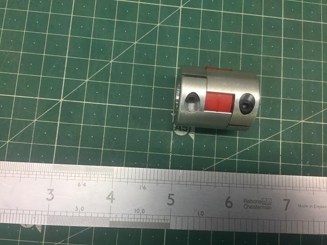

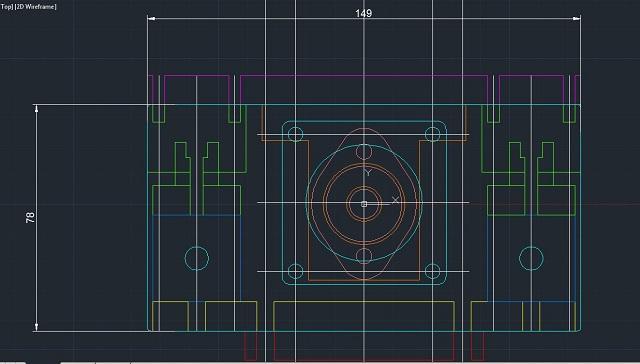

The end mounting plates will need re-making to spread the rails further to suite the existing machine mounts, the coupling between the stepper motor and ball screw was rigid, and I'll have to mount a new floating Z axis on it with suitable magnetic breakaway torch holder and limit switches.
So - buy an Oldham coupling and bore it to the correct sizes - simple (and done  :ddb:)

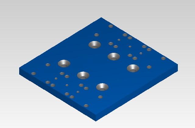

Draw up a CAD drawing to show how all the components potentially interfere with each other, to make sure that the new upper and lower plates will work - done  :ddb:
Buy a handful of limit switches - done  :ddb:

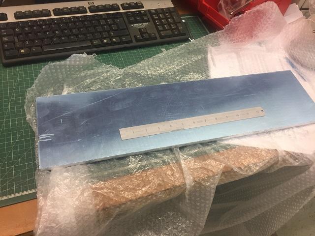

Buy a big slab of 10 mm thick aluminium alloy ground tooling plate to make the bits - done  :ddb:

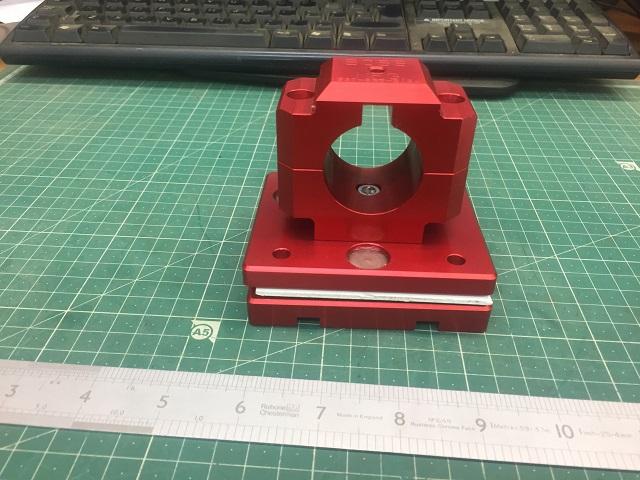

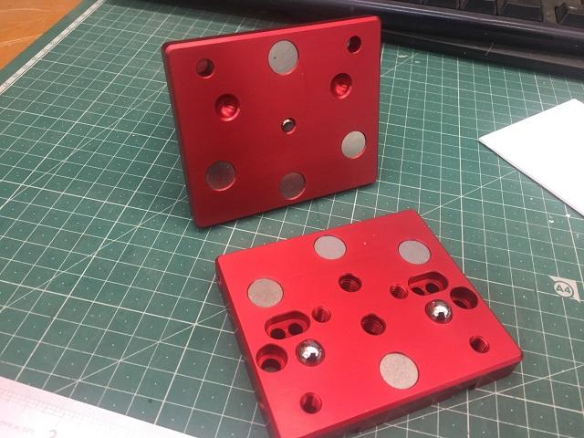

Source a (VASTLY EXPENSIVE  :bugeye: ) Magnetic Breakaway Torch Holder - done and customs duties paid  :ddb:
(I had intended to make my own, and even drew it out in CAD and bought the magnets, then I realised that the 'real ones' had been carefully developed to hold on in normal situations, and let got if the torch catches the plate and the amount of magnetic force needed was a great imponderable, and with torches about £600 each I didn't want to carry out tests !)

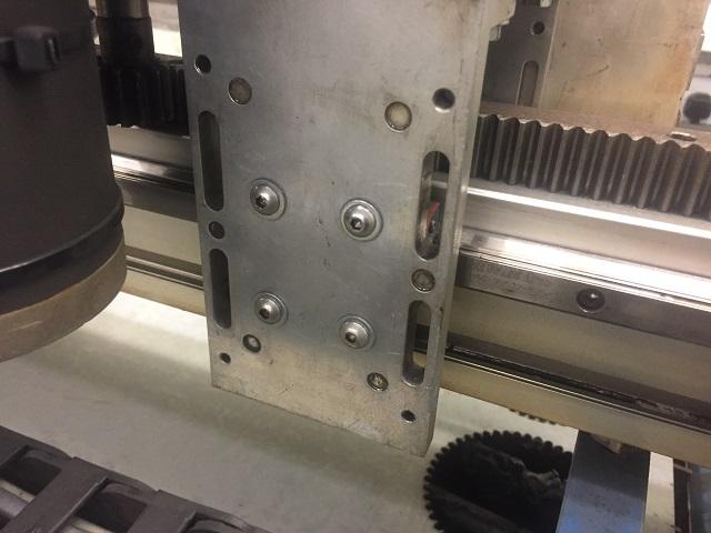

Incidentally, the pre-existing mounting slots that I previously referred to are these:

« Reply #155 on: March 19, 2017, 05:46:36 PM »

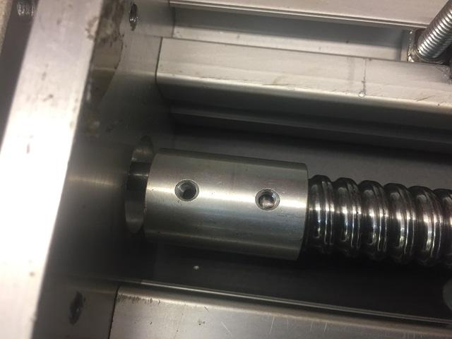

So - buy an Oldham coupling and bore it to the correct sizes - simple (and done).
Andrew,
I'm not usually a pedant but that coupling is a Lovejoy type coupling and not an Oldham!
An Oldham coupling wouldn't work in that application because they have no lateral stiffness and would need a bearing to support the screw.
http://www.oepcouplings.com/assets/ocanimationsmall.gif
The Lovejoy type couplings allow angular misalignment only and no (or very little) axial misalignment.
Cheers.
Re: Titivating A CNC Plasma Table
« Reply #156 on: March 19, 2017, 05:53:06 PM »
I bow to your knowledge Phil  :bow:
The vendor referred to it as a Plum coupling  :scratch:

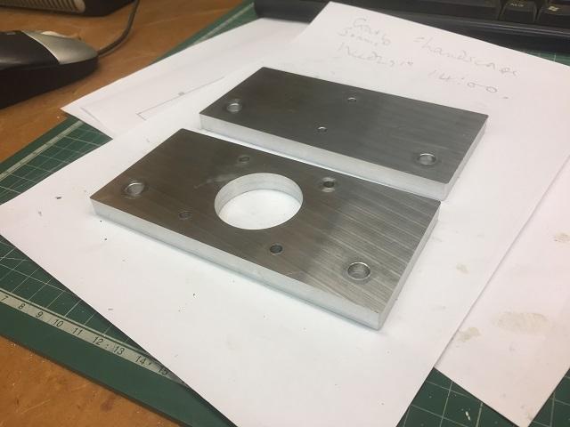

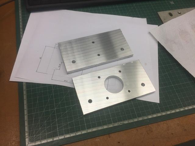

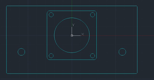

Well the upper and lower plates are 'VIRTUALLY' done but no time yet for the real things, also need to resolve the usual fixturing issues  :scratch:
(I marginally altered these from the CAD drawing above, reducing them to 145 x 68 to take a bit of weight out of the assembly and also give a bigger  'waste' for the milling, as the source plate is only rough sawn at a nominal 150 mm wide.)
« Reply #158 on: March 21, 2017, 11:58:42 AM »

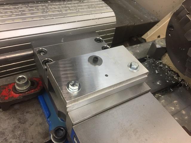

I got time today to finish the upper and lower plates for the Z axis.
Each was a two stage process - boring and drilling the holes, then making a profiling fixture and profiling their periphery giving the corners a 3 mm radius.

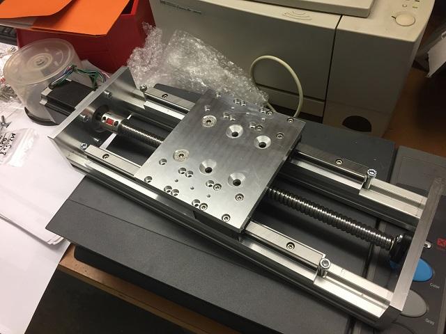

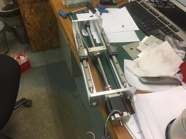

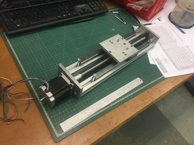

This has allowed me to get to 'first trial assembly' so that I can better decide what layout to use for the travelling stage that mounts the 'floating Z axis' and the actual torch holder
« Reply #160 on: March 23, 2017, 10:16:29 AM »
A bit tied up this morning collecting and distributing 'self assembly lamb kits' (ready for the freezer) but I did manage to do a bit of drawing up the 'front plate' that will hold the 'floating Z axis slider'.
This is a bit of reserved design, in that I am undecided on exactly how I will locate both the HSR-15 sliders and the ball nut location, so each have three alternative positions - being CAD then CAM it's as easy to let the machine do all three alternatives and I can pick and match as it evolves - then if I'm REALLY keen I'll make another with just the selected holes in it.

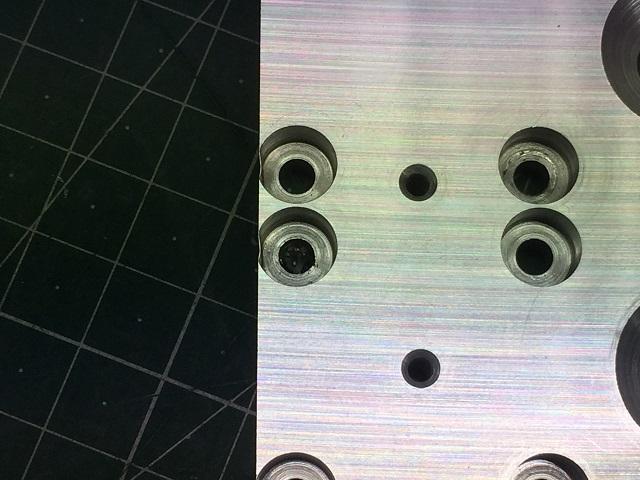

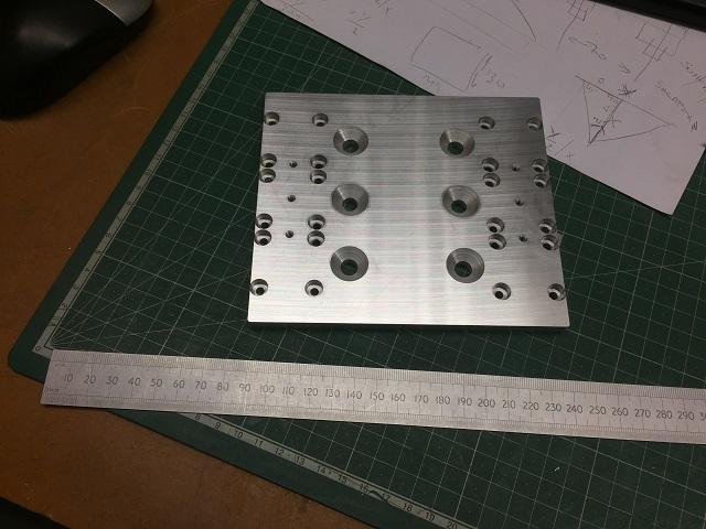

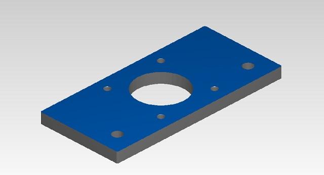

At long last I've found a bit of time to go from a rendered model of the front plate to making a physical prototype. This will allow me to develop the Floating Z bit, and finally decide on which alternative mounting positions to use for the rail slides and the ball nut mount.
Fairly obviously the final version needs to be a tad wider to accommodate the counter bores for the M4 cap screws fixing the rail sliders, but with this mounted I can develop my ideas a bit further

Nah, just open then couterbore out with a slot drill, mechanically it will fine and look the part.

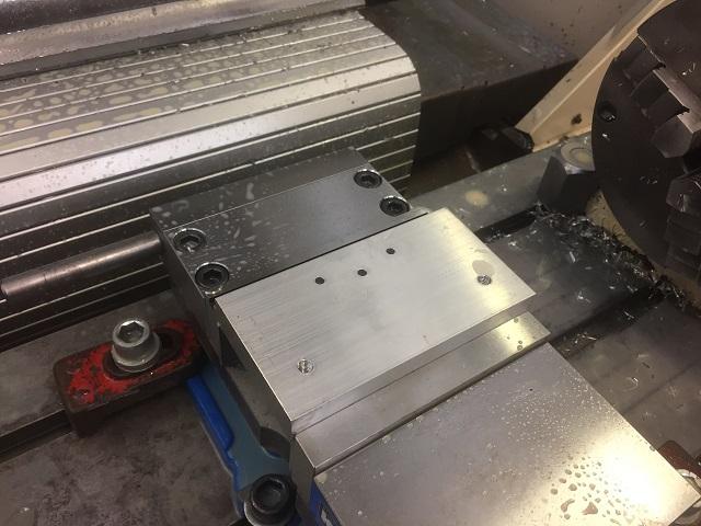

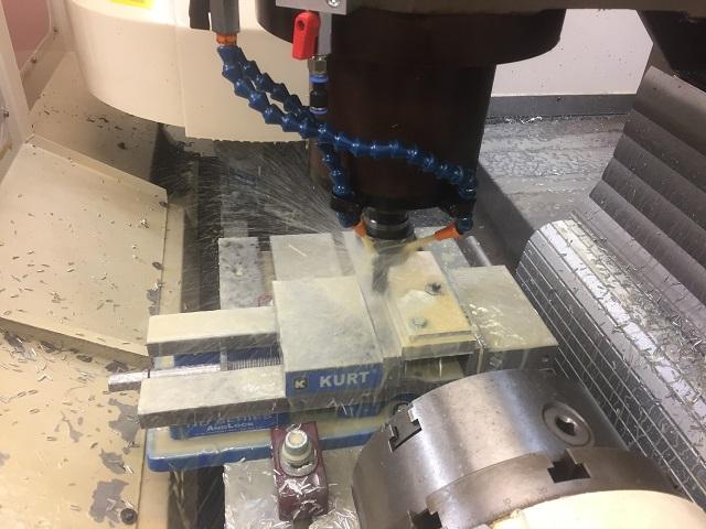

... talking of secondary sliders - I'd got the hole spacing wrong on the THK-10RM rails and drilled and tapped at 20 mm centres rather than the 25 mm they should be  :bang:
However as it was all made on an alignment fixture I've been able to return the prototype to the CNC Mill in exactly the same place as before, and run a little diddy program to spot face, drill and tap the relevant four holes (and also modify the Autocad drawing accordingly !)
So my Faux Pas is recovered from without raising a sweat  :lol:
I do love making things on fixtures - this particular one just clamps in the Kurt vice, and I've bored an accurate 20 mm hole dead on centre which becomes my datum point. If I need to remove the fixture and replace it all I have  to do is lower my Heidenhain touch probe into the hole and tell it to find the centre - fast and accurate. The various parts bolt to this fixture using holes that are part of the workings.
It also means in this case that the various parts are held about 10 mm higher than the vice jaws, allowing profiling of the edges without risking cutters and jaws.

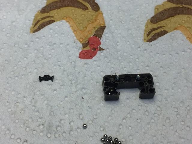

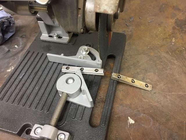

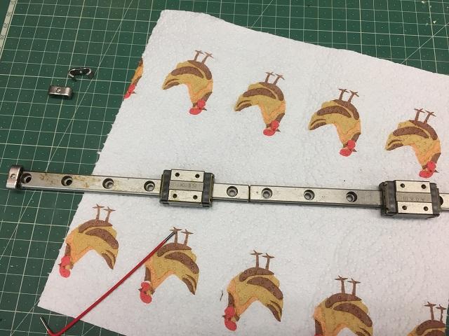

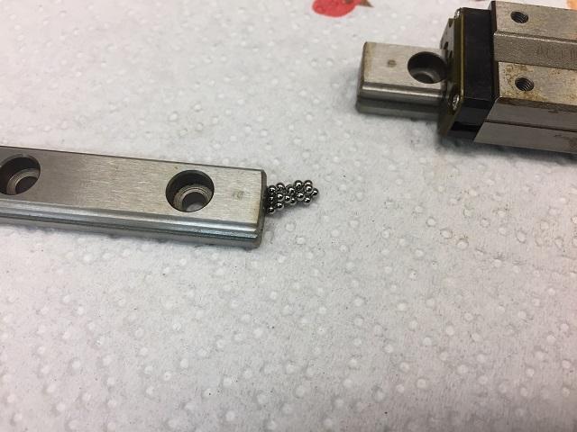

So, next thing to do is cut one of the THK-10RM rails in half, as I only need a very short movement. So - first transfer the slider off one rail onto the other one so that it can be cut without contaminating the bearing.
Now received wisdom is that this size of slider will fall apart shedding ball bearings unless the rails are pressed well together end to end, and the bearing pushed over the join carefully
Well I've news for you - they shed bearings anyway  :bang: Hundreds of them, and they're tiny  :bang: And in my case they are magnetic and stick all over the place  :bang:
Now in the last picture that minute bit of black plastic is in fact one of the track guides that reverse the balls so that they circulate. Even with tiny tweezers it was very reluctant to go back into it's recess in the end cap.
« Reply #174 on: March 30, 2017, 02:12:10 PM »
So now the slider is in bits I decided that I might as well go ahead and cut the rail, so in the unlikely event that I can re-assemble the bearings at least it can be done on the rail it will eventually occupy.
Cut with a 1 mm abrasive disk on a 115 mm angle grinder held in a 'chop saw stand' (Thanks Spurry for the suggestion :thumbup:) I then tidied the ends up on the Clarkson T&C grinder
