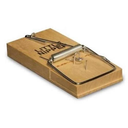

 I bought a few "little nipper " mouse traps from Rapid Hardware in liverpool
day 1 the mice didn't like the Chedder cheese
day 2 used peanuts and little bu..ers took the nuts without tripping the trap  :doh:
day 3 hot glued peanuts to trigger - success , three corpses and no more mice
so you glueing the bait to the trigger makes sence to me -
just don't catch your fingers in that rat trap - a mouse trap is bad enough

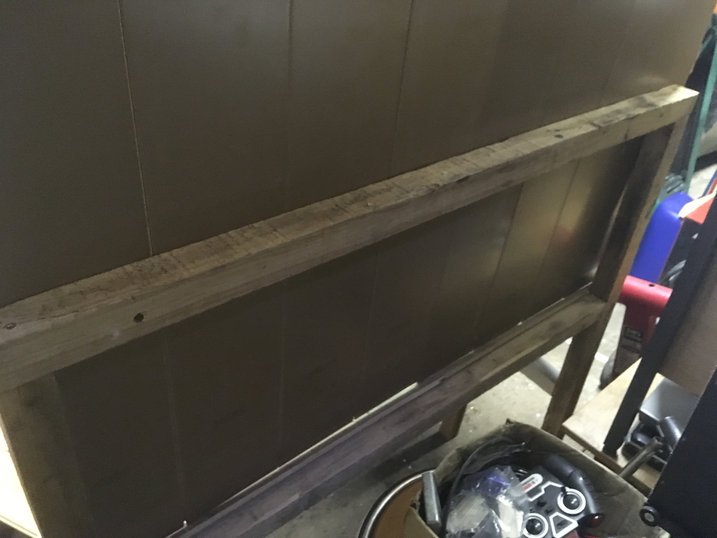

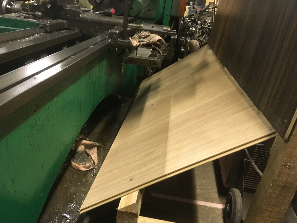

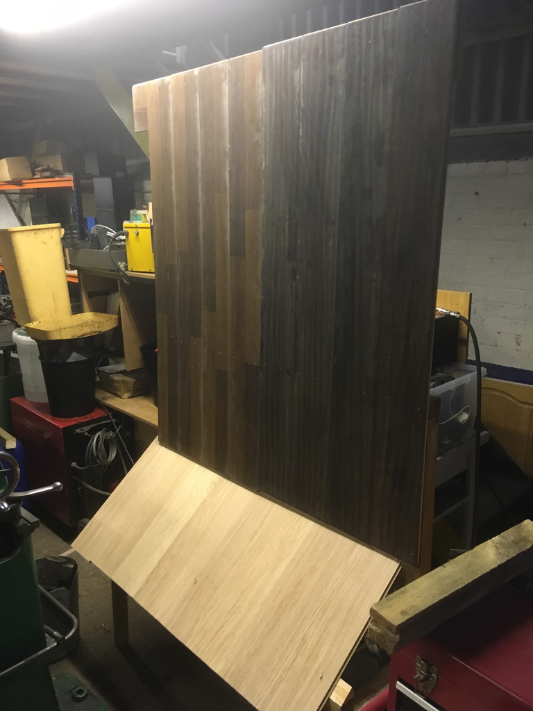

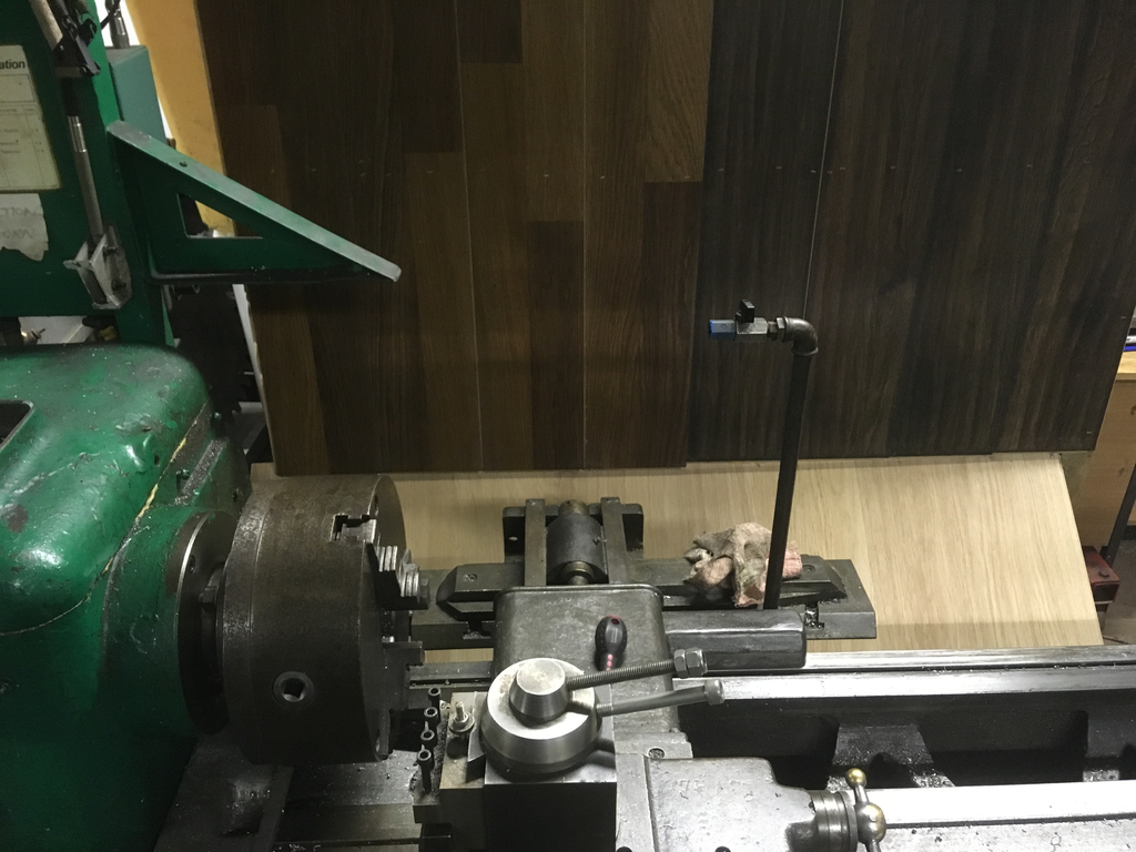

More by luck than judgement, the lathe has actually ended up in a position where it can be used - unlike all the other machines which are hemmed in by engines, compressors, cars, benches, desks, barrels and various other junk which I seem to have accumulated.... However, whereas I previously had the lathe against a wall, this time there's stuff behind it which I really don't want soaking in cutting oil...
Hence today's little project, to fabricate up a chip guard/oil spray arrestor...
Now, I've seen some superb work done on these forums where people have made exquisitely crafted backs to their lathes, carefully made to an exact fit and painted to match the rest of the machine. This, I'm afraid, is not one of those. For starters, I was on the clock - I can only use the workshop from around 5.30pm to 8pm during the week, and by the time I've finished nattering to the various other reprobates on site, it's usually nearer 6pm than 5.30.... so what can we throw together in 2 hours?
Behold the magnificence.....
The frame is a load of junk 2x2 timber, cut to size. The "tray" and back are some surplus laminate flooring panels, nailed to the timber frame. The whole thing free-stands behind the lathe, with the lip of the tray positioned "just so" to clear the top of the existing chip tray. The funny shape is due to the necessity of clearing the taper turning attachment which overhangs the back of the bed by a good 8". Measurements were all taken with a ruler marked only in feet, so there's a little bit of +/- going on :D
Still, it should be functional, and at least this time there won't be a streak of oil left up the wall behind the chuck! I might even put a lid on it and hang a light there... although the weight of the light might cause the whole contraption to overbalance and fall on the operator when least expected...
Some pictures for your amusement are attached below.
