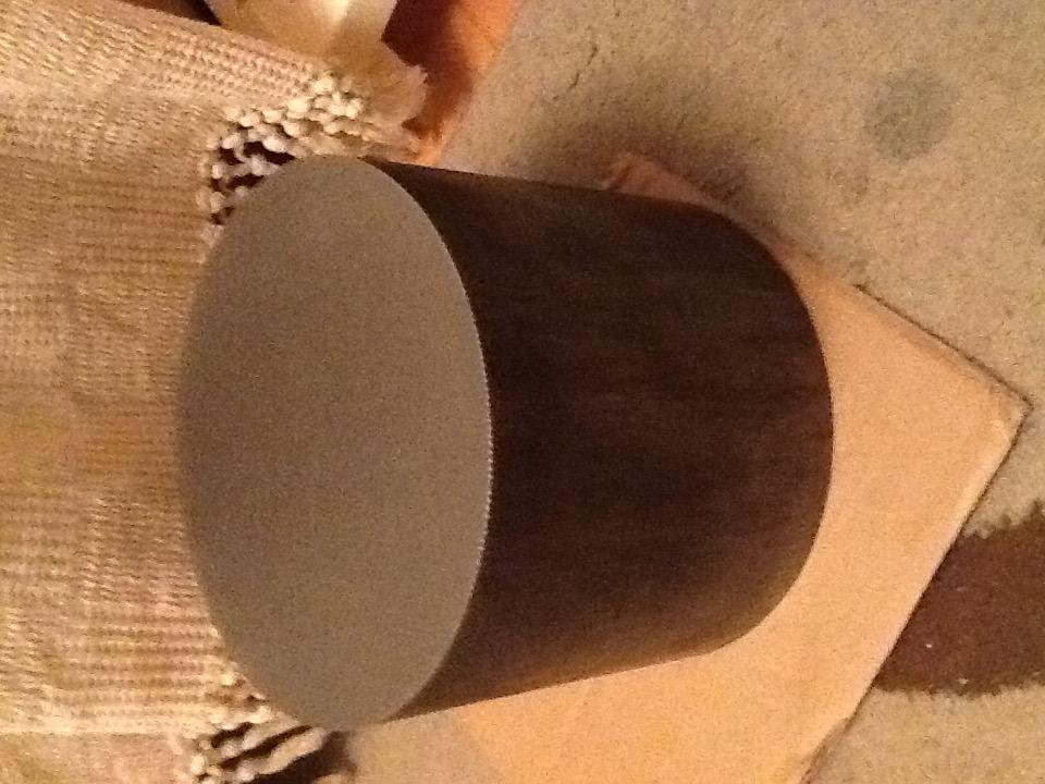

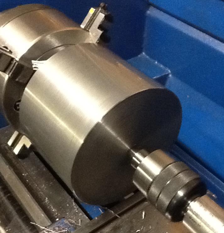

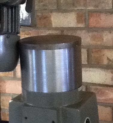

The 6" round bar arrived today for the riser upgrade on my mill...... :dremel:
It is some weight I can tell you!
Hopefully I can fit it in the lathe but how I'm going to hold it is yet to be decided.....! :coffee:
Meanwhile here's a picture of the lump! :clap:

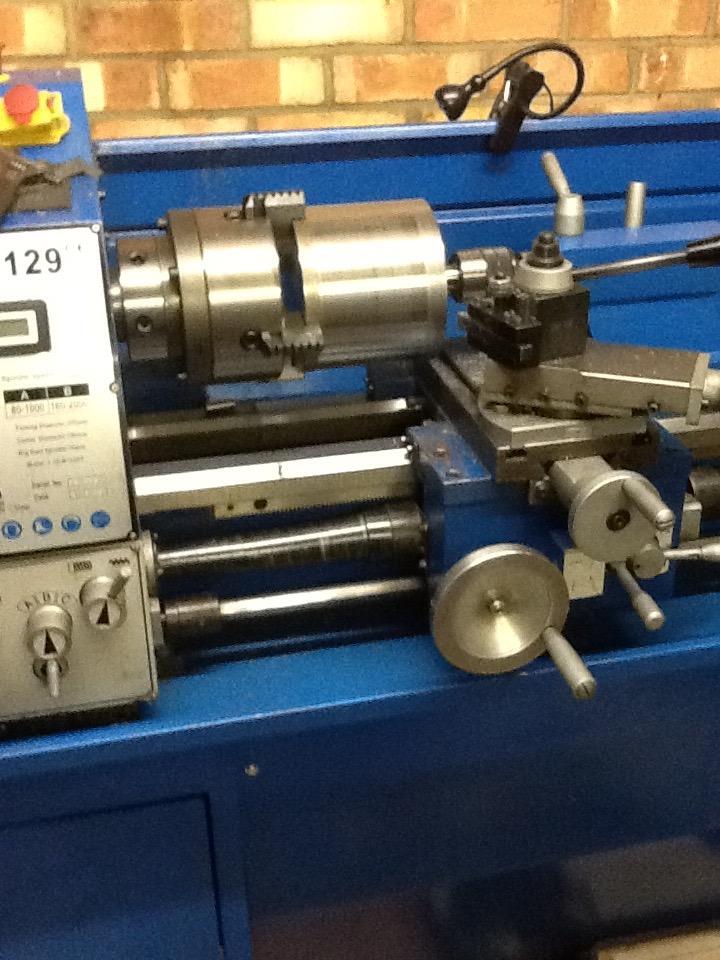

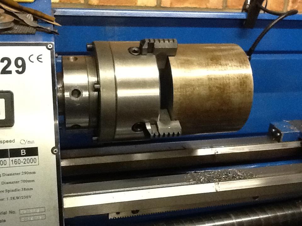

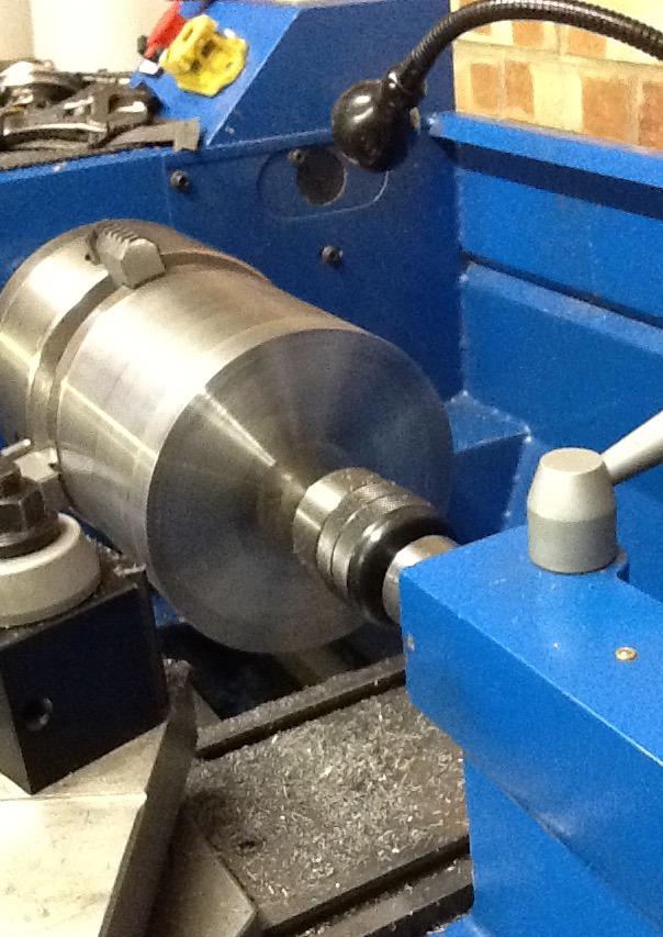

So now back home and in the shop.....
I swapped out the 3 jaw for the 4 jaw indi chuck on my lathe....
The 160 mm chuck is more than man enough for holding this big piece of round bar... :thumbup:
So tried clocking it up, the outer surface is a bit rough, I managed to get it within 5 thou at the free end.....but the  chuck end....ooh man its well out of true....
So do I leave as is and true up the diameter as far as I can get to the chuck end or should I clock it at the chuck end and then machine the diameter?
Never done this before so any advice appreciated.... :bow: :bow:

John,
Unless you've lots of material to spare on the diameter I'd get the bar fairly parallel to the axis of your lathe and then carefully face  off and take a minimal skim off the od just enough to clean up and clear the depth of the chuck jaws. I'd then turn it end over end so the nicely faced off end fits snugly against the chuck and the chuck jaws will have a nice perpendicular surface to clamp on. If your piece of bar is sawn it's quite possible the ends may be quite a bit off-square.

« Reply #18 on: November 15, 2016, 12:13:02 PM »
John, I know that you say your chuck is more than man enough to hold it, but I'd be nervous with that amount of overhang with such a weight  :bugeye:
I reckon your earlier idea of tapping and bolting from the rear of a face plate would be safer - it only needs a tiny dig in with your boring operation to totally spoil your day  :scratch:

« Reply #24 on: November 15, 2016, 02:36:50 PM »
Of all things you have to do with that chunk, the o/d is the least important. When I made one for my little machine, I just got it running sort-of true by eye, then centre drilled the outer end. Held it in place with a running centre, then faced off the outer end as much as possible, with a little skim up the outside to sit in the jaws.
Flip it over in the chuck, and repeat.
On the second facing op, the piece should hopefully be sitting at the rear of the jaws, so depending how much out, the second facing cut is, depends whether you risk removing the supporting centre.
Stick it in the mill, drill/tap to correct pcd.
As you cannot fit it on the faceplate directly, go with the adapter plate suggestion.
This should get you in the ball-park of two parallel faces.....the world is then your oyster.  :wave:

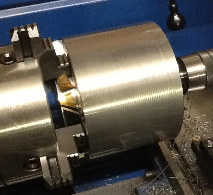

« Reply #26 on: November 18, 2016, 09:50:54 AM »

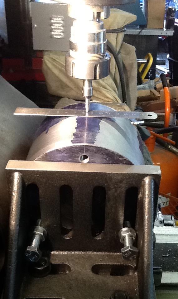

Well after the first cut across the free face, I took the block out of the lathe and put it on a flat face....
The mill table....I ran a clock across the face and theres was less than 2 thou across in various directions, so I guess thats flat enough for re chucking in the lathe....
I also put my 6" square across each face to see how tapered the block was along its length...sure enough the taper was as much as it was running out at the opposite end of the chuck...
So back in the chuck, faced end first, reclocked it to within 2 thou at the chuck end and proceeded to turn to diameter, enough just to true it up, faced the other end and its looking good   :thumbup:
Need to think about what the next step is.... :coffee:

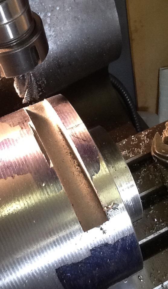

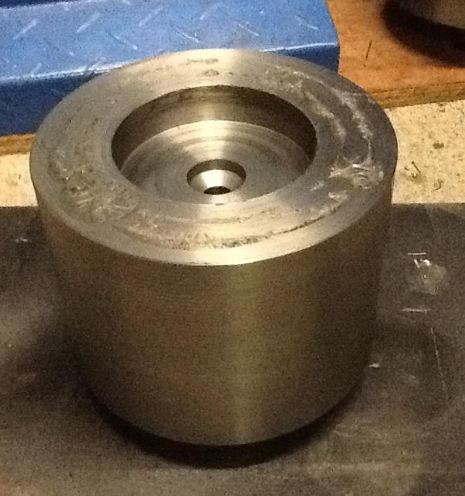

So the drawing calls for some holes to be drilled tapped or clear holes...at either end of the block
I'm thinking it best to remove the workpiece from the chuck and mark out where the holes need to be before moving on to boring the recess and forming the spigot at the other end...
Does this approach make sense?

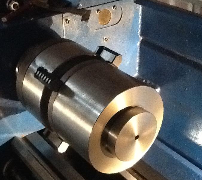

« Reply #28 on: November 19, 2016, 10:04:32 AM »
Well no advice offered so I went alone as opposed to going it alone...... :)
As the lump was now well centred in the lathe, I decided to plod on with the spigot....
Now a well known machinist of these parts and film producer of Sunday Night Cap said to me to check the diameters as the drawing may be incorrect.....

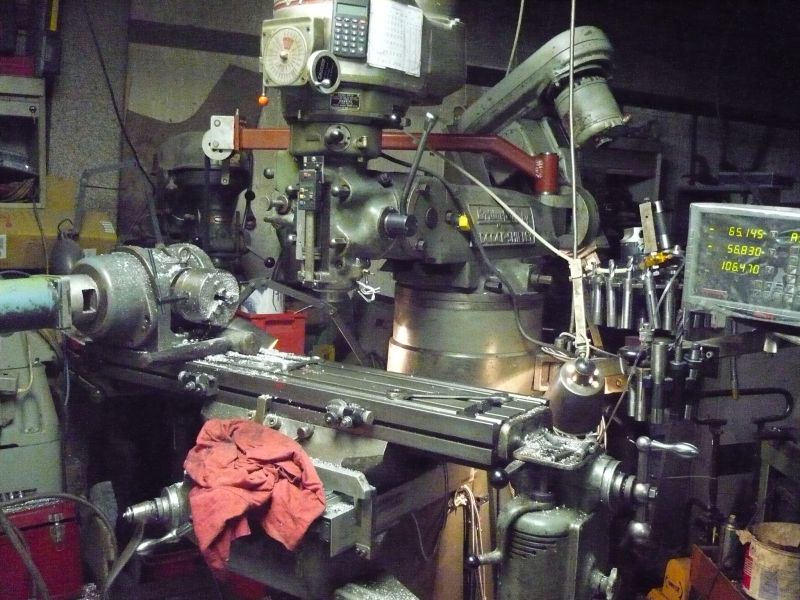

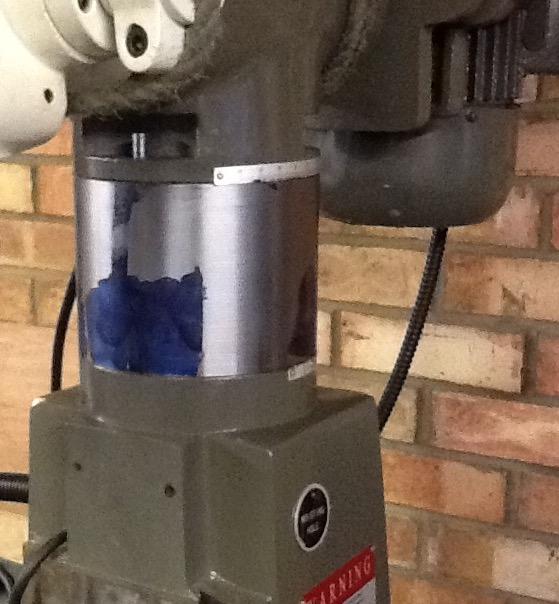

So following the venerable sages's advice, I took to removing the topworks off the mill.....sure enough, the spigot on my machine was bigger....cut once measure twice eh? You cant stick it back on....( unless you can weld like Rob or DB....     :bow: :bow: ... Mine looks like pigeon ****...)
Anyway after several measurements, I settled on 3.307 or 84 mm thereabouts....Imperial is a bit more precise...
After a swarf making session this morning and over lunch I got this far......

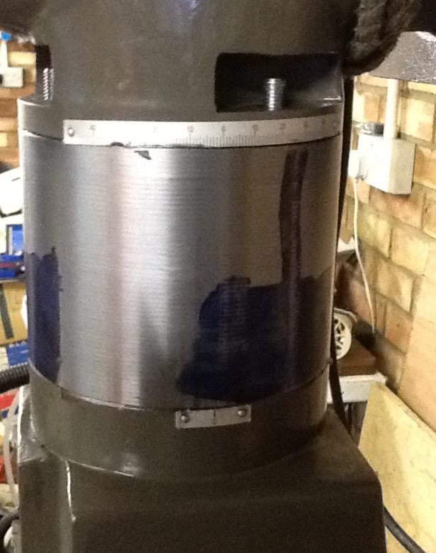

  • Posts: 2540
Re: 626 mill riser block
« Reply #29 on: November 19, 2016, 10:14:30 AM »
Trouble is if I remove it from the lathe and it doesn't fit because its too tight, I'll have it to cock I mean clock up again..... :Doh:
Measure, measure, measure.....I convinced myself that the diameter was going to be ok.....I measured with my trusty caliper, 3.307 inches, measured the spigot on the mill head again, yep 3.307 inches....its got to be right....?  Ok, checked with some outside calipers, hmmm...feels good....
So on removing from the chuck, I inched up the mill head, moved it aside and offered up the block....
Oohhh....its gonna be tight...
Well it fit like a glove, if anything its a tad tight, I think there may be some high spots inside the socket,where the spigot fits...well, its in now. I'm happy with the result. All the measuring and careful machining paid off....
I just need to remove it now to tidy up the chucked end, machine a socket in it and add all the tapped or clear holes and the nut pockets.....

I know the orig plan called for a block of steel 5-3/4 long....I bought a 5" piece, so I've only lost 3/4" no big deal really.
Hopefully do some more tomorrow..l :dremel:

« Reply #32 on: November 20, 2016, 10:21:52 AM »
Well the lump came out off the mill relatively easier than anticipated.....of course I was ably assisted by the delectable "Er-indoors" .....so a big thank you for lending a hand... :thumbup:
So, 4 jaw or 3 jaw....thinking I could just relocate the block in the jaws, I was hoping to grip it on its outside diameter, but neither chuck was having it....the freshly machined spigot was fouling the jaws further in the check centre. This meant gripping the od with very litle...Not enough..not good, bad things might happen... :Doh:
So I stuck with the 4 jaw, turned the jaws around and gripped on the spigot.....some strips from a Strongbow can provided the softness to prevent marking rhe surface, and the liquid contents provided much needed refrehment....( suffice to say, I do not use machinery under the influence!
Now with block in chuck, time to redial it.....my clock gauge has divisions at 0.0001 so it is quite accurate, but within a thou is near enough for farmwork.....ready for skimming off the previously chucked end....

And after a few minutes of turning and polishing we have this.....ready for boring the socket for the mill head to locate into.....
Now, do I machine the socket in situ held in the 4 jaw or use a boring head in the mill?
Answers on the back of a fag packet please or alternative suggestions.....,
  • Posts: 2540
« Reply #34 on: November 21, 2016, 01:47:24 PM »
More done tonight....
Got the socket end machined and without issue.....  :clap:
Bored out to 3.310 -ish to give a bit of clearance for the matching spigot on the mill head so I'm not wrestling with it on re-assembly....
So far so good.....
Just have to mark out the holes and the nut pockets need machining..... :dremel:

After cleaning down the lathe ans bagging up all the swarf....("Er-indoors " complains if I just sweep and put it all in the bin..... :Doh: ) time to turn attention to marking out for the 3 new bolt holes in the top.....
Now for anyone contemplating making one of these, dont use the dimensions on the drawing from the Yahoo groups website....they are not suited to the Chester 626 mill...
  • Posts: 2540
« Reply #37 on: November 22, 2016, 10:32:38 AM »
 :update:
In order to make the 3 bolt holes on a pcd, I measured many times......the drawing said 112 mm....but as I said previously, dont take the drawing as gospel.....
I ended up making a cardboard donut to slip over the spigot on the mill head to determine the approx location and then used some male intuition.....( we are allowed aren't we.....)
I reckoned on a pcd of 116mm and thats what I went with....
Spent the rest of the morning laboriously marking out, drilling, tapping and cutting.....I bought some 70mm ht bolts for the top end, even they were too long....Nonetheless better than being too short!
Here's the latest shots....
« Last Edit: November 22, 2016, 11:04:12 AM by John Rudd »

So got the block mounted on the mill, easier than I thought! The bolt holes were in the perfect place for bolting to my angle plate......
All line up ready for first cuttings....
  • Posts: 2540
« Reply #46 on: November 23, 2016, 07:23:10 AM »
Feckin'idjit...
I've milled the first pocket all wrong!!, :Doh: :Doh: :Doh: and  :Doh:
A weeks work ruined.....
I'm going to take up knitting or summat else......

Sorry, what is wrong with it ?
John,
In stead of making a pocket for the nut recess, I machine a slot right across..... :Doh:
Fortunately it isnt too deep....I pressed on realising the error. I'll use some metal filler to give the efect of a pocket...( I'll bodge with some stuff to make it look good.... :lol:)...
I s'pose it could be welded and I remachine it but there's nowhere round here that could do it... :dremel:
Anyways when its all painted nice who will know??
Just completed the second pocket and its looking pretty good.... Coffee time.. :coffee:

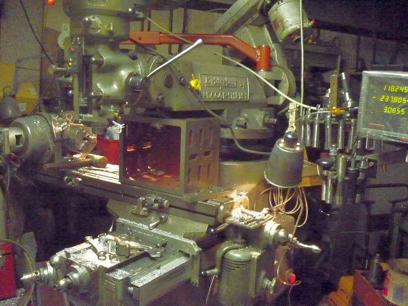

After another full days graft at it....here it is all finished with a coat of paint....
I couldn't get an exact match....so went for what I thought was closest...
Doesnt look too bad, better than leaving it 'naked' to have the elements attack it....
Overall I have around 420mm (16") between spindle and table with Z wound down....
