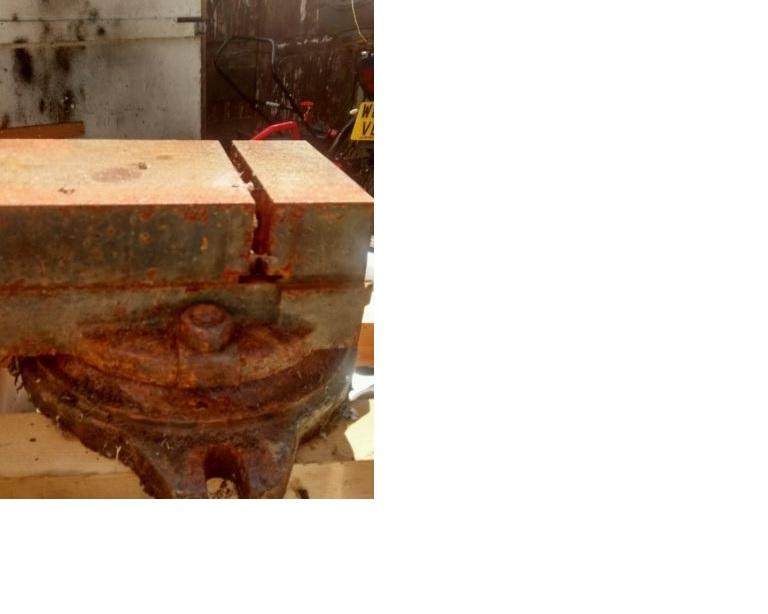

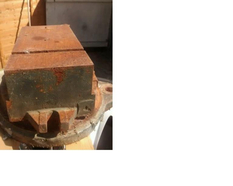

I've used both citric acid and vinegar. They both seem equally effective and, if you leave the item for a long period, it doesn't have any noticeable effect on the base metal. My preference is vinegar and I've just cleaned a very rusty machine vice using it. I bought 5 litres of 99% acetic acid, from a supplier I've used before on eBay, and that should do me for a long time. It's certainly much more cost effective as it's typically diluted to around 5%.
Hi Seadog,
How long did you have that vice base in the acid? Was the mixture warm or cold?
I ask as I have some exceedingly rusty cast iron drain covers I'd like to de-rust, and a nice long bath in either citric or acetic acid seems to be a popular and low-cost method of doing that.

« Reply #12 on: October 13, 2016, 03:00:33 PM »
I left it for a couple of hours by which time it could be easily rubbed off with some wire wool. The solution was cold. I left the sliding jaw in solution for a couple of weeks while I was on holiday. It came out a treat.

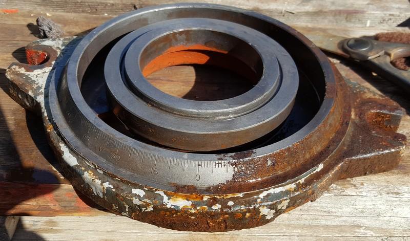

Ok, returning to the titular subject of this thread..... how much citric acid monohydrate should I be putting in about 1/2 a bath full of water, to have any meaningful effect on a pair of heavy cast iron drain covers?
I reckon I troweled in about 5kg of the stuff... and so far (3 days) all that's happened is the acid has turned a greenish colour... As far as I can tell it's all dissolved, so it's nowhere near a concentrated solution...
Should I add more? Like the whole 25kg bag?

Have you taken a cover from the solution to see just what effect it has had? You may be expecting it to dissolve the rust off when, in fact, it usually stays apparently untouched until you attack it with a brush or wire wool.

I'm pretty sure they're cast iron, judging by the weight and the fact one of them snapped when being extracted from under years of grime and roots...
I've scraped it with the trowel... haven't tried to get a wire brush in there. I'm not sure what concentration I've got so I didn't want to stick my hand in it....
Volume wise, I reckon there must be 100 litres? Bath is a standard 6ft thing, filled maybe 4" deep. And yes, it's c-c-c-cold.... (probably around 6-7 degrees C just now).
Time I have plenty of, they can sit there for months if necessary...  :thumbup:

Pulled the drain covers out of the bath today... and it's definitely working, there's new metal visible, and much of the rust and crud has dropped away. Still a fair way to go, so I refreshed the acid & threw them back in - all 5 of them this time, instead of the 2 I was trying before.
I haven't taken an "after" shot yet, but here's what they looked like before I put them in the bath (they have been pre-jetwashed, but much of the crud is encrusted & wouldn't shift with just water...
(click for a bigger view)
Re: Citric Acid Concentration?
« Reply #35 on: November 12, 2016, 07:46:41 PM »
Wow, those are nasty!  Much worse than what I was dealing with.
Glad to hear things are working though.

« Reply #40 on: November 13, 2016, 02:24:30 PM »
Seems to be working  :)
