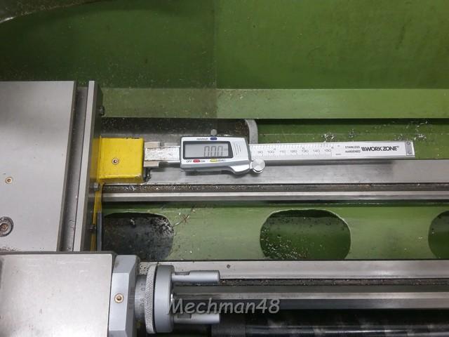

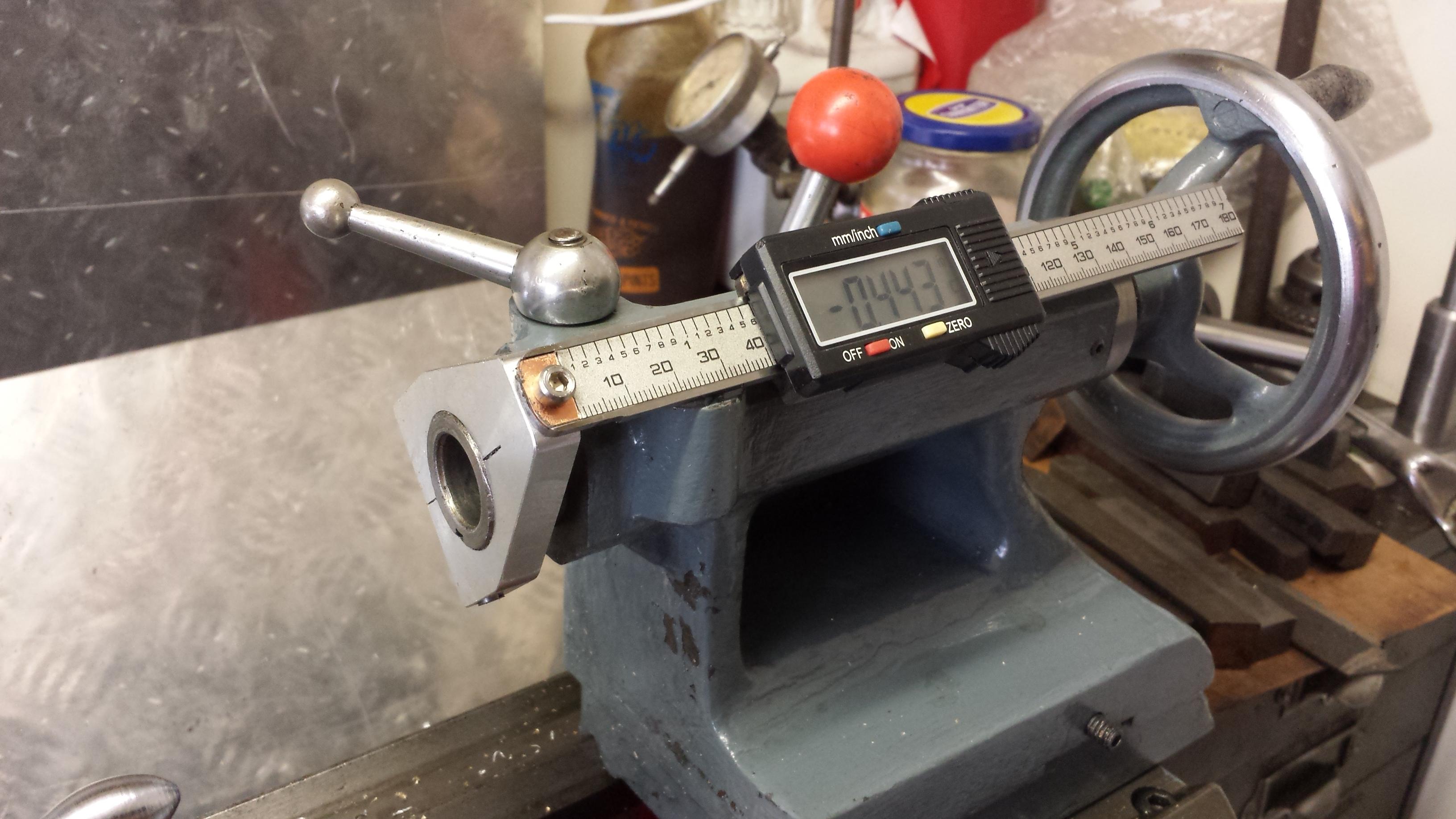

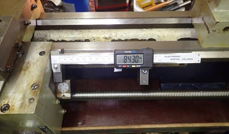

I'm pretty sure more people have build these. I have seen some applications of test dial indicator or tyre thread gauge used on cross slide. On my wish list possibility to set diameter display to known (measured diameter would be high on my list. I haven't been able to come up meaningfull solution that would be much better than test dial indicator (or tire thread gauge!).
I figured that much easier application would be to use digital caliper to measure carriage travel lengthvise. Dial gauge travel is often short, caliper is short too, but often enough.
Hardest part was to drill hole on jaw, three drlls later I took solid carbide drill and pu oversize hole. Most important was to have caliper body parallel to lathe ways.

I've seen other applications where a caliper is used like this, but most used a clamp to hold the caliper in some type of a pocket.  Probably just to avoid having to drill through the caliper.
Re: Digital caliper mounted on lathe
« Reply #3 on: October 06, 2016, 11:58:56 AM »
Good move,Pekka. I have seen similar ones mounted on the tailstock to register the quill movement....OZ

Thank you all.
Hardest part was to design the general shape that could be build out of 14*22 mm standard key stock (pretty free cutting material), would have display angled for easy viewing and could be easily taken out and put back. Should also clear tail stock.
It worked out pretty well.
Things to learn:
* Often stuff comes a little oversize and wobbly, this come out pretty tight, maybe few file stokes would help?
* I paid attention to ease of dismounting, therefore locking bolt must be come undone. Should not have been a smart ass and cram it that close to scale plastic cover - it's used to make bolt captive...works too well.
* I choose magnet to the other end (tapped hole for bolt would have come uncomfortably close lathe carriage lock). This would also break free if moved too far out. Success.
* The locking plate under the scale has a load bearing face on 45 degree angle - the other end has a 6 mm silver steel rod to take that load. Made it pretty tight fit. If it gets a little loose then it's perfect, now it is uncomfortably tight to turn sideways and to take off the slack, but locks up tight as a carriage stop. Amusing, but probably not the best solution here.
* Found out that the whole system has to very straight, there is very little play on the system, minor tilt would cause side load, measured it and got it right, but had to make one "special" thickness plastic washer that provided enough adjustment when squashed with a scale on the lathe carriage end. Found sweet spot easy and now it looks like very accurate.
* The lathe carriage end is a little overkill, but I was not sure if I could get away without bolt. I got better idea, I might try on MK II model if I ever need to build one.

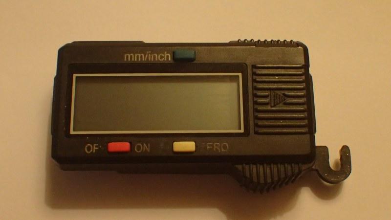

Inside is probably very much like this:
http://www.grant-trebbin.com/2014/04/digital-calliper-teardown-and-repair.html
Before taking one completely apart: How do wire a LCD display that is designed for zebra?
Much of the other stuff looks doable.

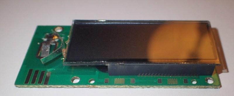

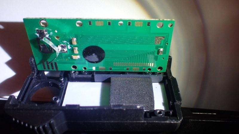

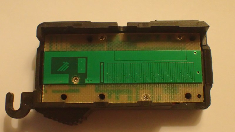

« Reply #15 on: October 09, 2016, 06:13:40 AM »

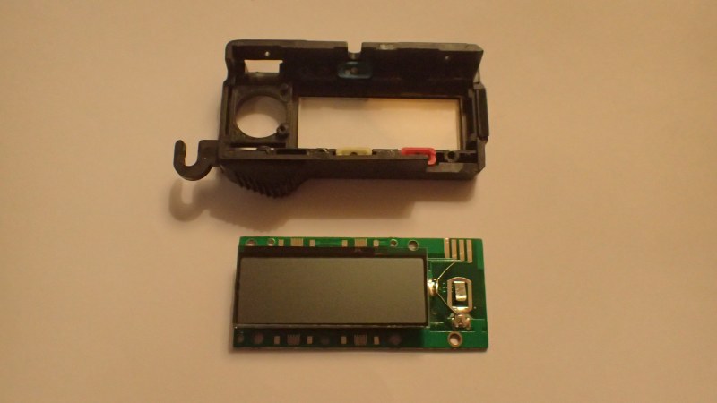

I had another identical lying around. Now I have a better caliper, I took it appart to se the innards.
Now: How to extend the zebra connection to LCD?

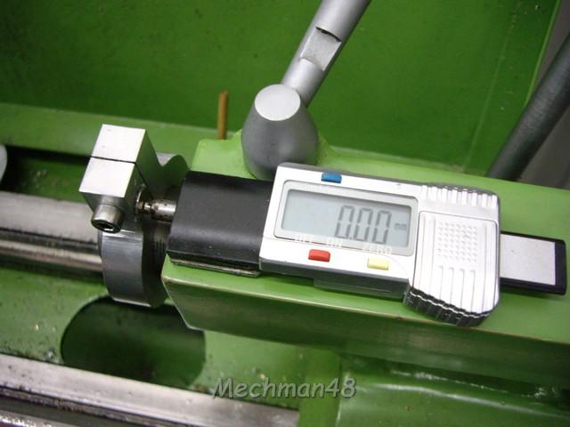

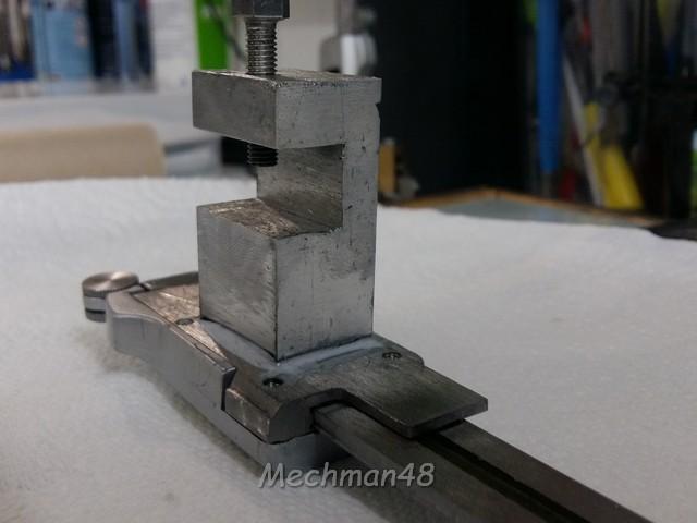

« Reply #17 on: November 04, 2016, 02:45:10 PM »

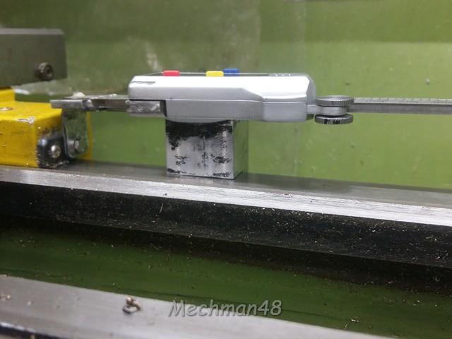

I have used similar digi callipers on my machine... not cosmetically perfect, but  does the job... :thumbup:
George.

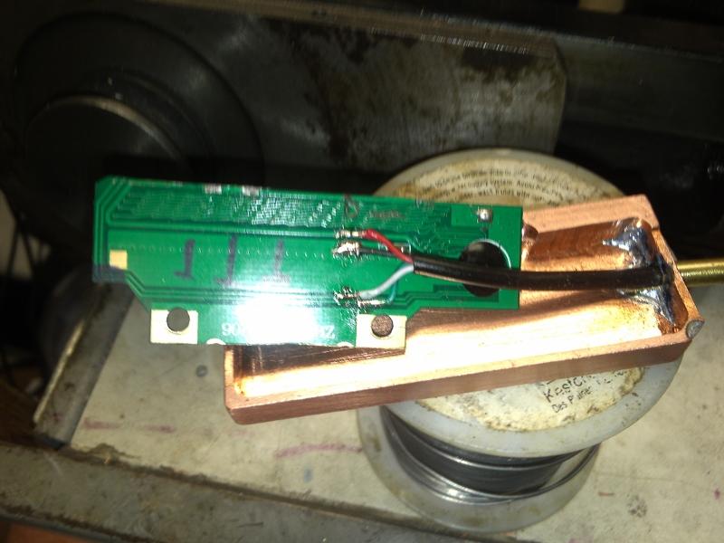

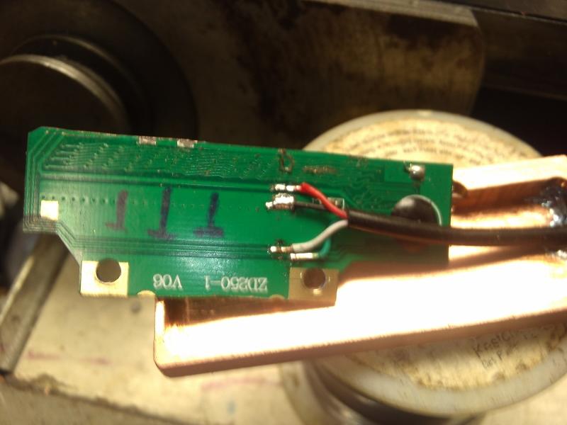

Ran across an old thread...

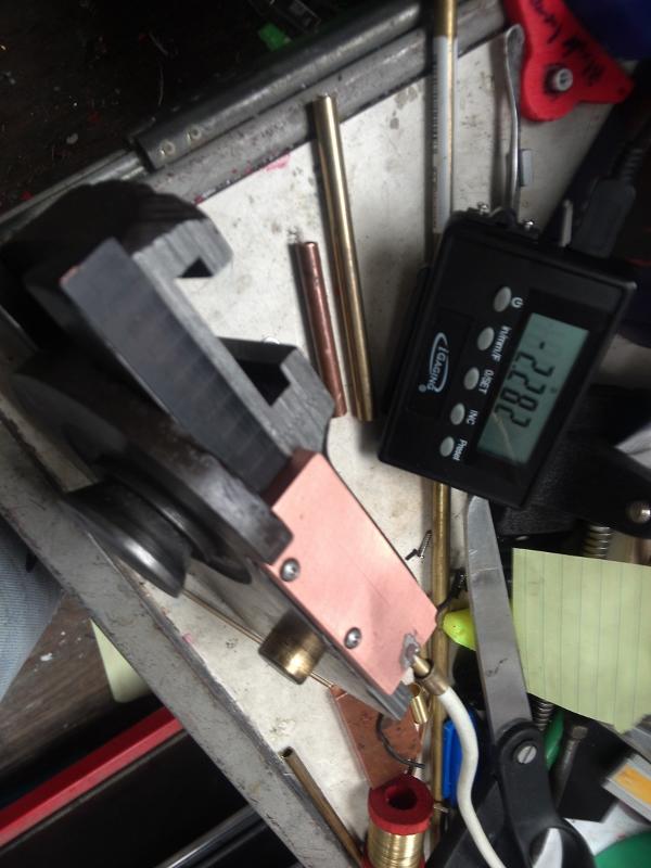

It's pretty easy to peel the circuit board off of the aluminum spar.  I did up a cross slide read out by gluing the board to the base and sculpting the reader onto the moving bits.  It there's interest I can dig out pictures.  Please be warned, cross slides were machined :-0

Yesh. Tape is easy to remove from the caliper. Problem is how to move display (LCD) 15 cm away from the read head? yhere are some commercial units with "remote" display, byt they are pretty thick = Warning - your cross slide is about to have some serious cavities!

« Reply #23 on: September 10, 2018, 02:29:36 PM »

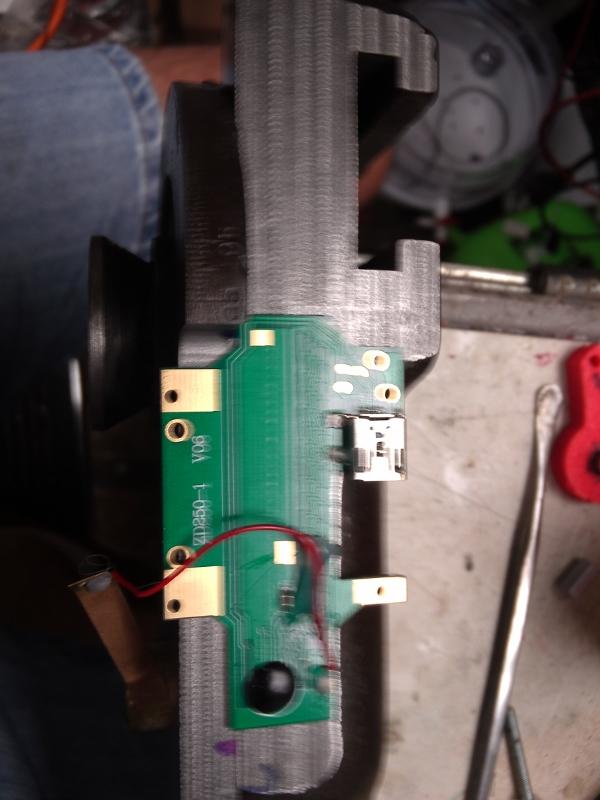

Here's some pictures from my build!  I used a remote display model for mine, and did some surgery on the board too.

« Reply #24 on: September 10, 2018, 03:14:38 PM »
Thank you.
How thin it is?
Mine standard caliper looked very different inside.

« Reply #25 on: September 10, 2018, 04:11:08 PM »
I don't have that lathe anymore.  The scale was thinner than the reader PCB.  The reader was under 1mm (plus components)
