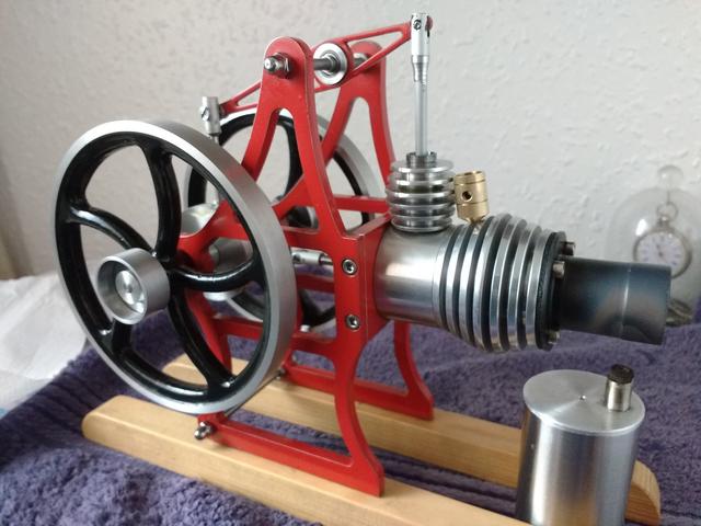

So..... While thinking what to do, about the detached flange. I set to, making the cooling fins.
Around 4"/100mm diameter.
Started with, square, 5mm thick blanks. And, one off at 8mm thick, to screw to the bulkhead.
Using 3 stops, on the mill table. Means I can locate/ relocate all blanks, accurately. Every time......
Making it easy, to mill off the corners. Instead of sawing......
Also, to drill a central, 6mm hole.......
A piece of 4" dia steel, in the chuck. Faced with wide insulation tape. Plus a lump of spare nylon......
Friction turned the remaining corners away........
Giving, a handful of discs, all the same diameter.
Moved onto the mill.......
Removed the centre areas. Just undersize, to the hot cap o/d of 47mm......
Parted off, Five, 63mm dia blanks. From bar stock, and removed the centres, too.......
After finish boring, on the lathe. A quick mock up......
I think that looks ok.....  :thumbup:
Thanks for looking in......

I eventually, got my head around the hot cap, sealing/ retaining problem.
Finding a piece of correct diameter, tube. (It just happened to be bronze). I silver soldered a ring, to replace the original flange.....
Recessed, the new holding flange.......
The cylinder/ spigot, protrudes through, by "a couple of thou'". To make a positive location/ seal, against the bulkhead.......
Held on, by three, neater than original, screws........
Secure......
Thanks for looking in!

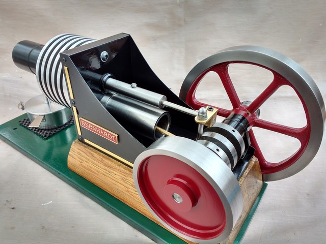

New, improved, crankshaft location.....
The two uprights, are made from 6mm thick angle iron. Cleaned up, square, on the mill. Dowelled and screwed in place, from underneath the base plate. Allowing removal, and accurate replacement, when necessary.....
The two, outer bearing housings, are a sliding fit, in the uprights. Held in place with slidelock........
The inner bearing housings, slide over the smaller diameter.......
Butting against the upright. Also, held with sleevelock.......
Should be much more effective than the wobbly, original assembly.

The crank assembly, is finished....
It cycles nicely. No tight spots.......
The flywheel, is next. At 7" dia. It's a little on the large side, for a mini lathe......
The original bore was unsuitable. So, I drilled out, oversize, and plugged with a piece of m/s. Held in with the ever faithful sleevelock.
The rear boss, held in the chuck jaws, has been machined nicely true to the rim. Allowing me to set the rim running, within a thou'.
Now, I'm starting to open up to a 10mm dia bore. Hopefully. Perfectly true to the rim......
We'll see......

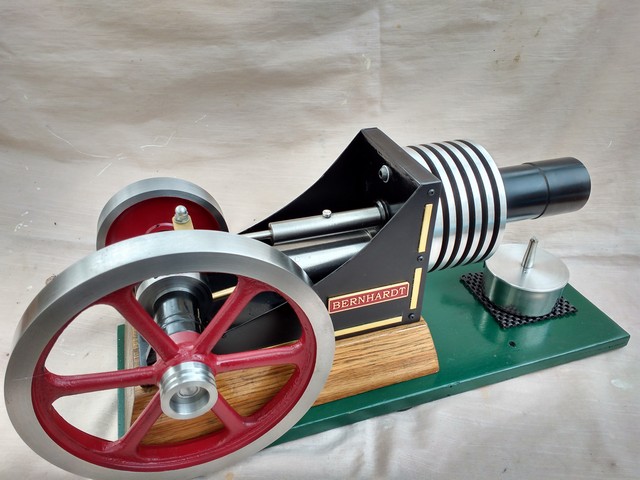

It's been a while. As I often say.
After some 60hrs running. I'm calling this job, finished. Finally!
And.... The final video. Filmed, while setting up my table at Papplewick, last Saturday......

Nah! Not until it starts to sulk, as they all do, in time.
The Maiwald.......
Ran for around 100hrs, before it decided, it didn't like it's brass piston. So, I made a steel one. It's happy again now.
