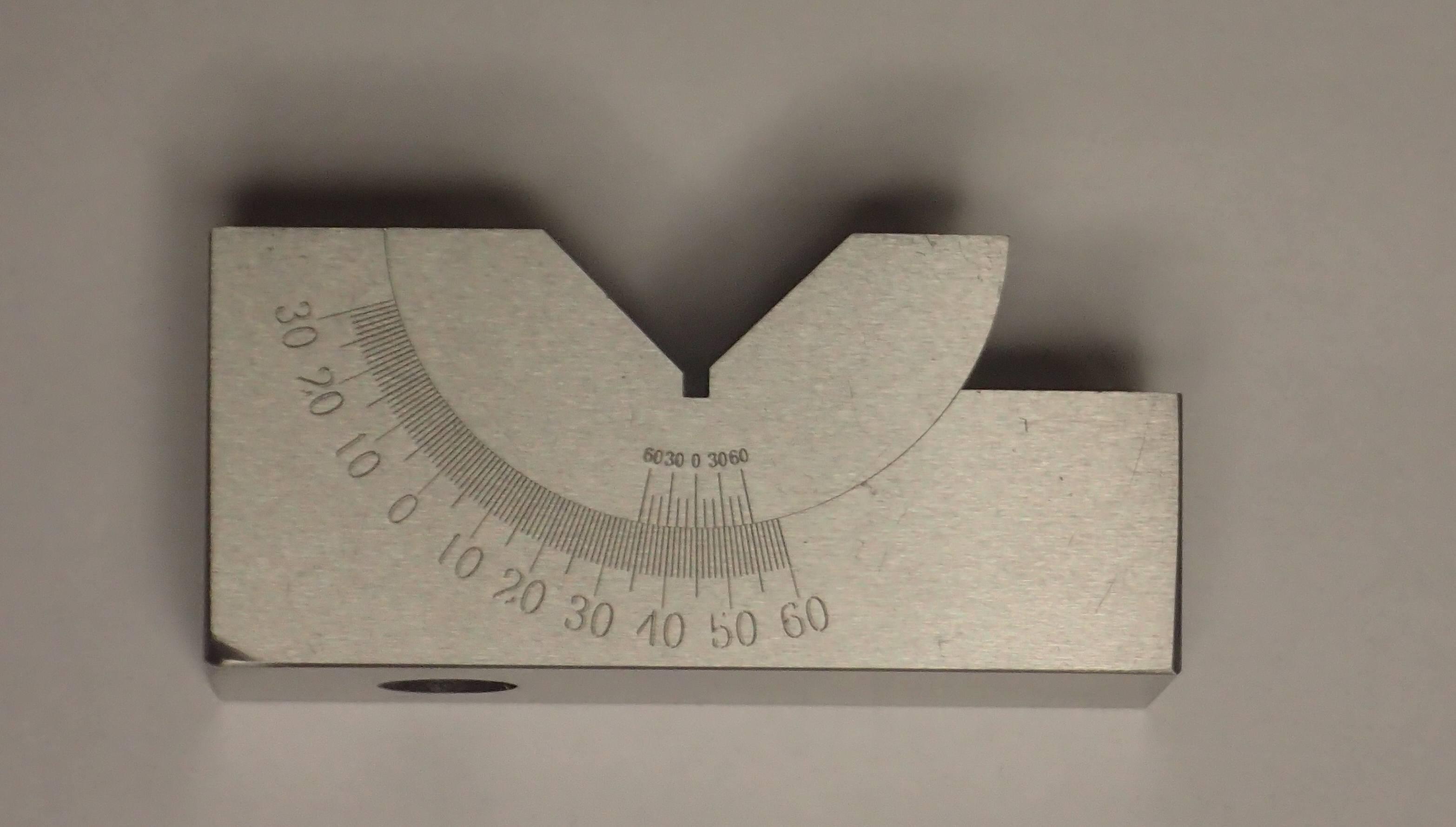

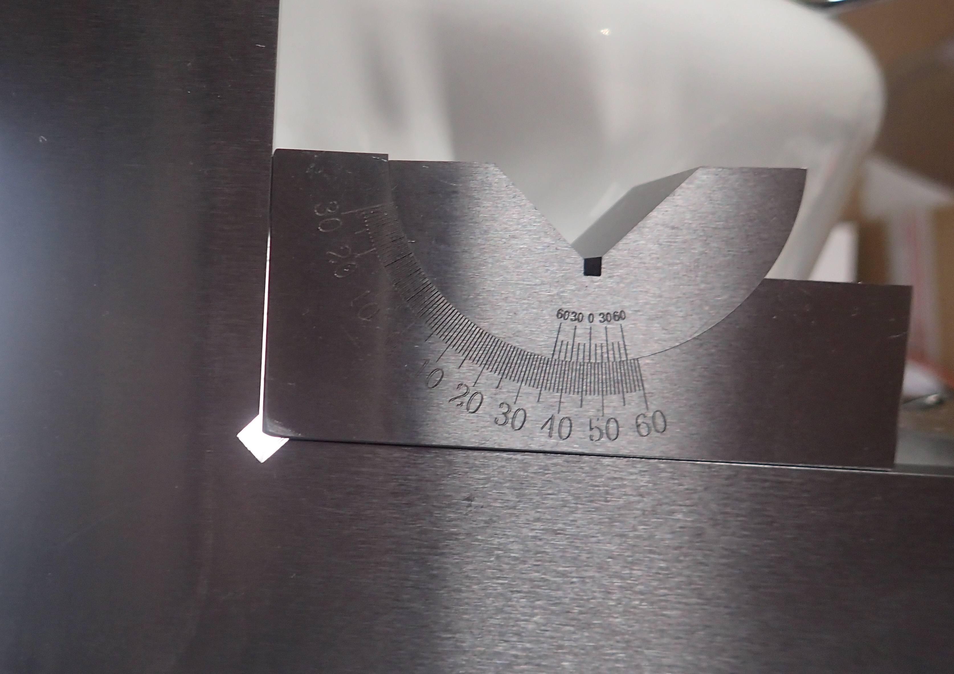

Reason is that I bought this one:
http://www.banggood.com/Toolmaker-Precision-Micro-Adjustable-Angle-Block-Milling-Setup-p-1057240.html
Dent, ok it is annoying, but not functional...I don't care too much, but it is annoying because the piece had a dent (or it was sliced from bar and it was at very end....) and ground after it.
More serious to me is that the shor end is not straight in either plane. Error is about 0,1 mm.
I haven't checked it all around, height looks about fine and least zero angle fiducial line is at zero.
But if general description lets you know that the angle block is finished within 0,01 mm, is 0,1 mm reasonable at other direction?
Basically I'm asking for the price am I expecting too much?

I would ask for a refund. The Chinese auction sites are usually very good about refunding your money if you show clear photographic evidence that the product is defective.
Re: What kind of quality to expect for chinese "Precision" tools and stuff
« Reply #2 on: September 22, 2016, 08:05:37 PM »
So, this may be counter intuitive, but is it reasonable to expect that surface to be accurately perpendicular to the other?  Is it part of the specification?  Of course, you do expect that, as would I, but it doesn't necessarily make for an unusable or even "defective" tool.  I suppose if you wanted to clamp it on the small end, it wouldn't work well.  But it is much more likely that you're using the bottom as a reference.  And don't even begin to think about using the scale for any kind of accurate work.  You'd need to set the angle with something more precise anyway.
It makes me think of 1-2-3 blocks.  I'm not sure how square the high quality ones are, but they aren't really meant to be.  They are most often very accurate in size and parallelism, which is exactly as they should be.  But I could probably get something more square by eye than by using a 1-2-3 block.  Go for it, check out your cheap set...
It wouldn't take much on a surface grinder, if you had access to one, to finish off the Chinese "kit" tool and grind the surfaces in properly.
Think like a machinist, not a simple consumer.

Thank you for the answers.
That is part of the problem. How do you read description (spesification) that is not very good:
Toolmaker Precision Micro Adjustable Angle Block Milling Setup
Specification:
Material: steel, surface hardened to HRC58-62 °, nickel plated.
Dimensions (LxWxH) 75x25x32 MM
Angular Precision 10 'On Readable Nonius
Micro Adjustable 0 ° To 60 ° With Stop Scr
Uses: In the milling machine, planer, drill press with adjustable angle grinder and regulations on the knife, crossed with other fixtures or clamping the workpiece after the workpiece processing, such as processing slope, slant-hole drilling and the like.
Nickel plated, rust parallelism and verticality precision grinding of each working face to 0.01mm.
It can be a cursor indicates stepless tilt adjustment angle, and then be secured with screws, used to create a variety of fixed angle processing, testing of workpieces.
I'm tempted to claim that "rust is not parallel to verticality to 0,01 mm". :lol:
The example of 1-2-3 block is good. They would be completely useless if parallelism would be bad. And pretty near useless if they were not square.
With this V-bloc, the V- must be very true to all working planes and bottom surface. That is the must and I should have a look at it, but it looks fine.
However I don't think it would be reasonable to expect external working surfaces to be accurate to stated number (0,01 mm) unless otherwise mentioned. Bit like parallels....their opposite surfaces has to be parallel to great degree, ends have very little consequence, but you don't expect beaver bites there either.
My analogy would be here try square. What about if you think that you buy a flat square and one side is beveled unevenly? I'm not talking here hair line, but the case that other side of the square is square and other not.
Re. scales...I feel that scales must have more than entertaining values. There are bunch of DIN standards that pretty much states what accuracy scales should be each type of tool and accuracy glass. Here no DIN number were mentioned, but there is this statement "Angular Precision 10 'On Readable Nonius". I agree, it is not for measurement, but that should help the set up.

Pekka, I think an email to them with photos is well within your rights. Whether you ask for a refund or replacement would be a matter of choice.
     Interestingly, I toddled off to fleabay and found many there ranging from $20 to $96 AUD and they all seem to be using the same product description claiming 10' accuracy. If my thinking and rusty math is correct (probably not) that is 0.166deg accuracy.
    The tool also is supposed to be "precision", surely that implies a lack of dings, dents and poor workmanship so ask them to rectify.
    As has been said, you could make it useful if milled flat and square to remove the dent, assuming there is enough material to do so. Refund plus a usable tool with a bit of work?
Back to my search, the $96 AUD one claims 10" accuracy so price and accuracy works there. Plus, it comes in a box. See link.

Now I have mailed them three times explaining best I can. Their stand is "About the item, the manufacturer said that it is acceptable, it is not the quality problem, and still good for using to the measuring job. Hope your kindly understanding. Thank you. "
I feel pretty stongly that it is very much quality problem. I'm not saying it is useless, I'm saying it has a defect.
I'm thinking of ordering a new one from CTC or somewhere else and avoid buying from them.

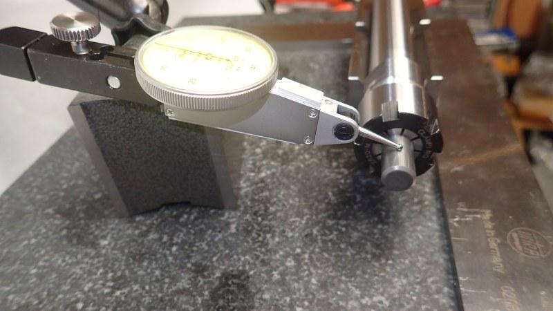

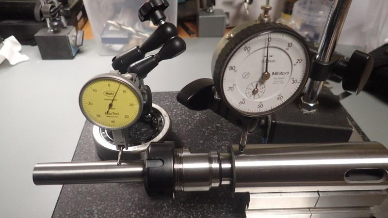

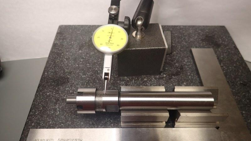

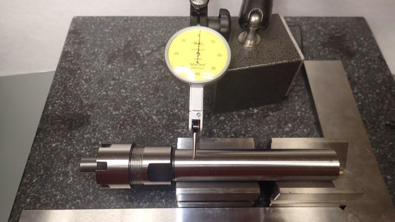

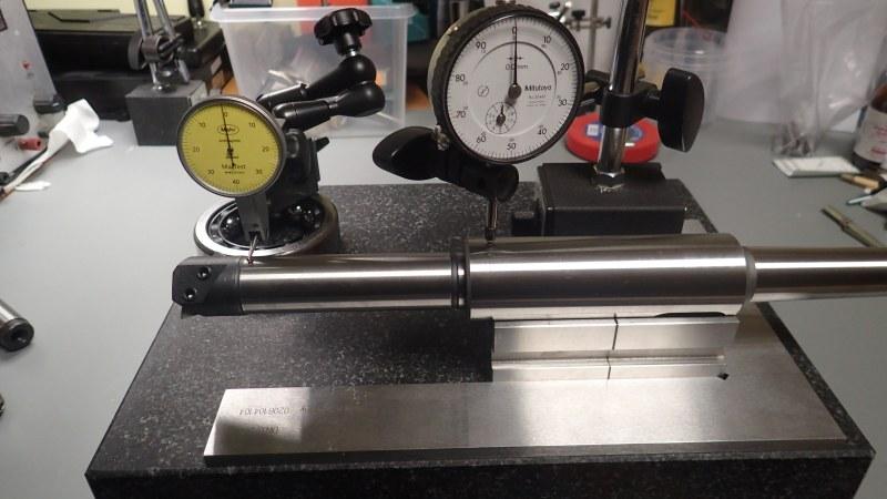

I'm measuring some ER shanks and collets. CTC stuff seems to have TIR allways between 0,01 - 0,02 mm range. I have never measured worse and not regualary better. These I measure just cleaning parts and putting them together.
On the other had eBay/banggood seems to be at it's best (after much fiddling) close to 0,02 mm and worst so far 0,08 mm!
I'm including the pictures of the method that provides most accurate and repeatable results, I could come up with. I tonly works well on cylindrical shanks.
Shanks seem to be often a little under size, tapering a little (about 0,01 mm /100 mm) and one was slightly trilobular!
Most challenging to measure was my latest ER20/20 mm parallel shank and three collets I got.
8 mm collet, best 0,02 mm TIR
10 mm collet regularry 0,04 mm TIR
12 mm collet 0,06 -0,08 TIR
Included Nut key did not fit into the nut!

So what the Fedex brought in. Spent 10*more on ARC than on latest china shopping. I expect clearly better value.
Not surpricing the almost identical ER chuck was whole lot nices, I don't care much of the looks, but finish on the mating surfaces must be good enoug. Still it is not quite up to DIN stndard, but miles closer than the Bangood one.

I would recommend checking if the ARC nut, on its own, is enough to sort out your ER collet problem. I had something similar - disappointing ER collet accuracy, replaced nut with a better one (ARC, not a real posh'un), same socket, same collet, problems went away. I have formed the impression that ER is sensitive to a bad nut.
I have a slight suspicion some categories (not all) on Banggood are the "seconds" that didn't go to named importers... even if you get the same item there are higher odds it's iffy. Other things are absolutely fine. Definitely not consistent.

I got friday two same items: ER25/MT3 shanks, cleaned them up and assembled with a good collet and mesured silder steel rod. Put them on surface plate and measured: Other was 0,06 mm and the other 0,8 mm TIR. Paid 12€ per piece....so, other one is usefull for drilling and other uses I got it.
Other one is a plastic bucket of "trash tools" waiting insipration to check further or used for something that accuracy is on the list.
To the booring head: I would chance allso all screws and specially the set screw. Had one breaking in the hole and it was a proverbial to move.

Soo...turned better ER25/MT3 shoulder down (because my mill has a slot at the end of spindle for dog. OK. for normal spiral drills.
But sometimes you'll get a nice surprice. Years ago I bought one long single tip MT3 boring bar from ARC. It seems to unbelievably straight for such a tool. 0,02 mm TIR near tip! In a pinch I could use it as a MT test bar. I never used it first while waiting for it I rushed to work with a boring head and later didn't have faith in that bit, but it is standard 8*8mm bit. Should get one.
My setup for MT taper shanks, I found one MT/MT adapter that has female taper very concentric with outer shell.
