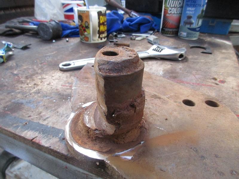

This was dropped of this week by   a local farmer asking if I could weld it up and make it round  :bang:

Hi Smiffy,
Is (was!) that peg a support for a rear roller  :scratch:

« Reply #2 on: September 18, 2016, 04:56:30 PM »
Yes should have said that in the post ,its off a 8 foot cut flail mower .
The other end is as bad, plus the bearings are retained by circlips which are missing  and someone in the past has tack welded the bearings into the roller    :bang: so all in all a right mess

By god Smiffy that is in see state, you must be keen, it looks like its been sculpted out of wet clay like a potters art piece.

I reckon cut the stub off and weld a new one on is about the only approach (unless you have a vast hoard of suitable rods to build it up with !)

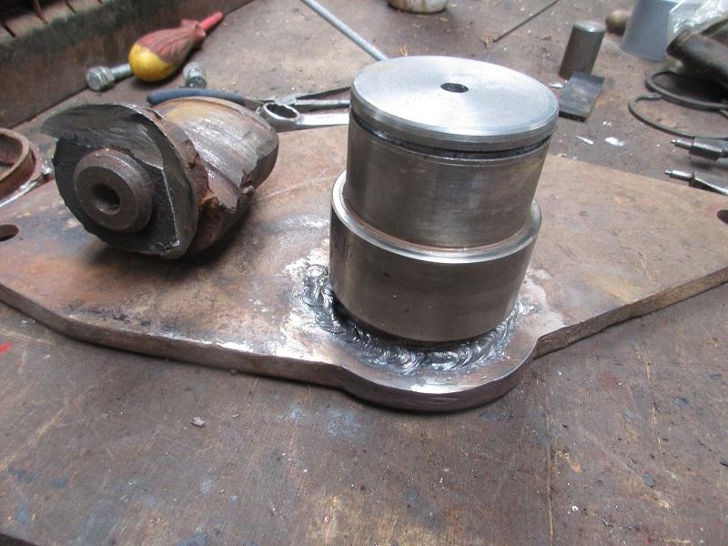

New pin machined and welded in and fitted to machine
These type of jobs are  quite common , I seem to get my fair share ,it keeps me off the streets and provides spending power for more workshop goodies

Measuring is not a problem as the shaft needs to fit a new bearing and seal  . The biggest problem is having a suitable supply of large diameter steel  . I  keep a large stock of EN8  up to about 50 mm ,bigger than that means a trip to a steel stockholder which is time consuming . I often mange to get damaged piston rods from hydraulic rams  which are usually EN8 and excellent for making excavator bucket pins etc
 That piece started at  80 mm dia  and as its will get used I brought a 1 meter length. Cost wise is a bit difficult as not many people want to do this type of work as it can be time consuming
