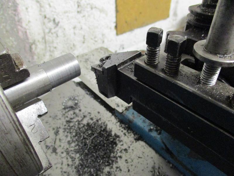

This is a story of a mod., with a bit of knowledge and a lot to learn. Unfortunately I didn't take any photos of my progress as my camera was broken, but now that I have a new one there will be a shot of the finished item.
I bought a tool holder at an Autojumble (my first, I'll definitely go again). It had a 25mm square shank, my lathe tool holder only takes 16mm. No problem, just pop it in my homemade milling vice on my homemade milling machine. Using a 12mm HSS end mill I tried my first cut ( Huh, I need to get on and finish my Quorn!) I placed an order for a Carbide end mill, this was positive, I live in a holiday area and the seller has a caravan just down the road, so the cutter was delivered next day. I popped it in the mill and off I went. What a difference! Needle sharp splinters of steel were sprayed in all directions. I pushed it further, red hot splinters flew everywhere. Then it stopped, no warning no smoke, no nothing. It just stopped. I was quite worried, the wiring of this machine had stretched me to the limit. Trouble shooting was possibly going to be a step too far.
Next morning I switched it on and joy oh joy, it worked. It must have been an overload in the speed controller. Although it was now working I was finding that the rate of metal removal was quite slow and I was worried that I would ruin the carbide end mill. Then I had a revelation, I ordered some 1mm thick cutting discs for my angle grinder. They arrived after 2 days, 30 minutes work had the tool holder roughed out and another 30 minutes in the mill had it machined nice and square. Phew, what a palaver! At least next time I will be able to do it more quickly.
I tried it out on a piece of mild steel, rotten finish, it is too late now I'll sort it out in the morning.

In my experience, a tool holder responsible for poor finish suffers from one (or more) defects.  (1) The foundation for the insert is not flat (usually from being hemstitched with a ball mill).  (2) The periphery locator os a poor fit.  or (3) the clamping arrangement does not hold properly.  I have reached the point where I made the foundation from a piece of CRS bar stock and silver solder the periphery locator in place (usually "sacrificing" an insert to assure alignment).  I have no photos, but I have been making insert toolholders this way since the late-1960's.

Wind your rpm up and take healthy cuts, see if the finish improves.
Re: Carbide tool holder
« Reply #3 on: September 08, 2016, 01:59:33 AM »
Is that a cutting incert or the anvill ? I have never seen a TN incert with a flat top like that before .
« Reply #4 on: September 08, 2016, 02:58:18 AM »
Norman, as chipenter says, it certainly looks as though you have no insert in the holder, and are cutting with the carbide seat that the insert should locate on.
« Reply #5 on: September 08, 2016, 03:52:38 AM »
I think it looks like a very cheap,TCMT insert.....the sort bought at car boots for about 50p.....
As said, try winding up the speed, it is cutting on centre height yes?

« Reply #6 on: September 08, 2016, 05:37:58 AM »
That was the insert that it came with. I have got some others with chip breaking grooves in them I'll try them tomorrow, I've got a load of cooking to do today.
I tried it on the fastest speed and yes, it is a centre height.
It does indeed look very much like there is no actual cutting insert and just the shim/anvil present in the photo....OZ.

« Reply #8 on: September 08, 2016, 06:22:56 AM »
Norman, does the screw that locates what your are using as an insert have a centrally drilled and tapped co-axial hole? If so your are cutting with a carbide seat, and the cutting insert is not fitted ! It would be located by a second screw into that hole.
Usually the insert top surface is pretty well level with the top of the holder which is another clue that the insert is not fitted.

« Reply #9 on: September 08, 2016, 08:27:31 AM »
 :doh:
I've never seen a carbide tool holder up close before. It certainly is as mentioned by others.
I've been wasting my time with this holder, with it in its lowest position the support piece is exactly on centre height. I need to take another 3-4mm off the height of the holder.
Where can I buy the fixing screw to hold the cutter? I don't have any screws that fit.

The numbers if any on the side of the tool will give the type and size inserts used , it looks to have a forward slope so a negative insert in neaded ,

As I see it you are definitely cutting with the carbide anvil; there should be an insert in there that would bring it level with the top of the holder.
