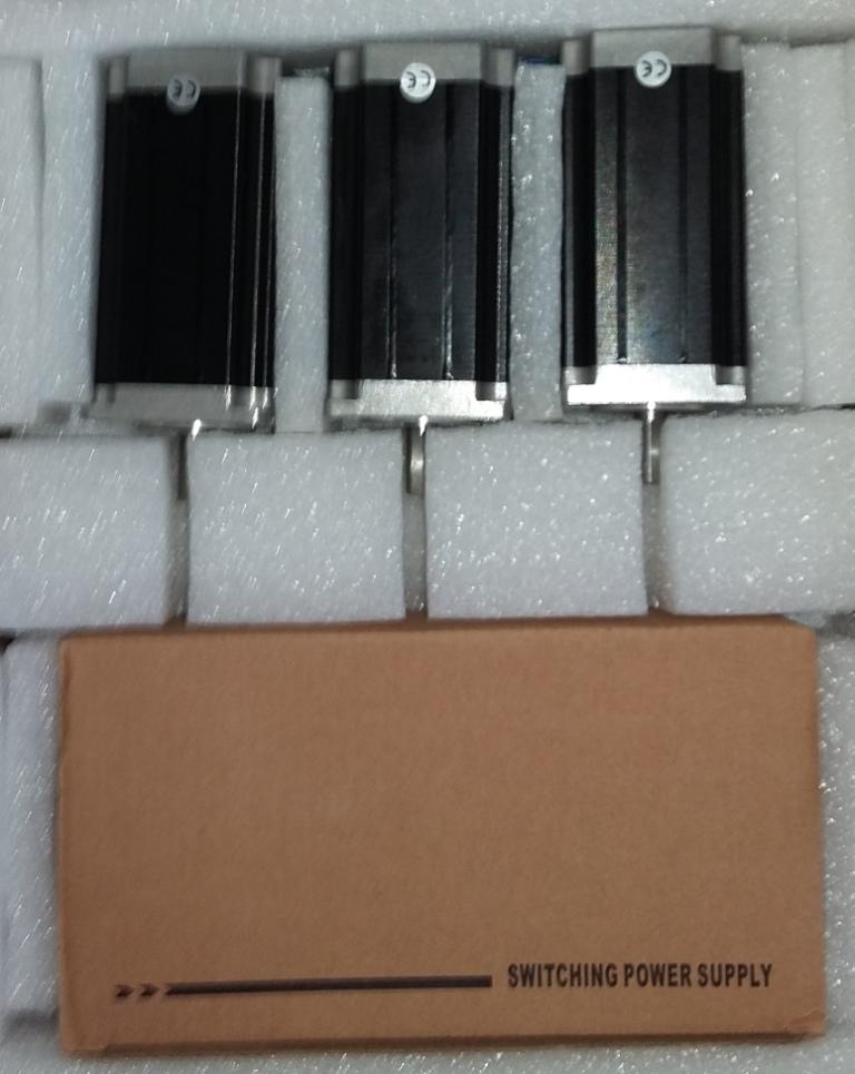

I got these from:
http://www.ebay.ie/itm/3-Axis-CNC-Kit-425oz-in-Nema-23-Stepper-Motor-Driver-CNC-Mill-Router-Lathe-/121787136378?hash=item1c5b14397a
Sorry I missed the bit about using low torque steppers.

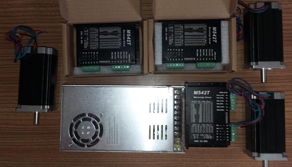

So the motors I understand, 2 coils, 4 wires. But what about the stepper driver controllers?
These are M542T units and have 8 dip switches!
Sw1..3 are current limiters [1.5, 2.0, 2.4, 2.8 Amps] This limits the max current to a coil (understood I think)
Sw 4 is the Mode Table [Full or half mode] (not underswtood!!)
Sw 5..8 are for the step angle (understood i.e a pulse will move the rotor by this amount) BUT what should I select (and assume I must tell the cnc controller)

Not a bad set of parts Will, you are still in the low power stepper region (NEMA23)
identify your coils (Black, Green and Red, Blue)  Your driver is labelled A- A+  B- B+  they are your stepper pairs  i.e Black to A- Green to A+ etc  swap over one pair AA or BB to reverse motor direction, but don't connect AB BA  the music is awful.    :lol:
Full current, half current usually refers to the holding power when a stepper is powered but at rest between moves.  If you can get away with half current the motors will run alot cooler, but if any axis can be  back driven, you would need full current at rest.  It kind of contradicts the bit they say about auto current control at idle, especially if you don't use the enable line.
If you are just making the motors spin add some tape flags to watch the shafts spinning and start out at 2 microsteps 400steps/rev and try the different options.  In the real world you don't really want to be going beyond 8-16 microsteps, the torque falls off a cliff as you increase the microsteps, so unless you are wildly over spec'd  wouldn't recommend it.
When you get a controller we can advise as it will depend what they ask for.
