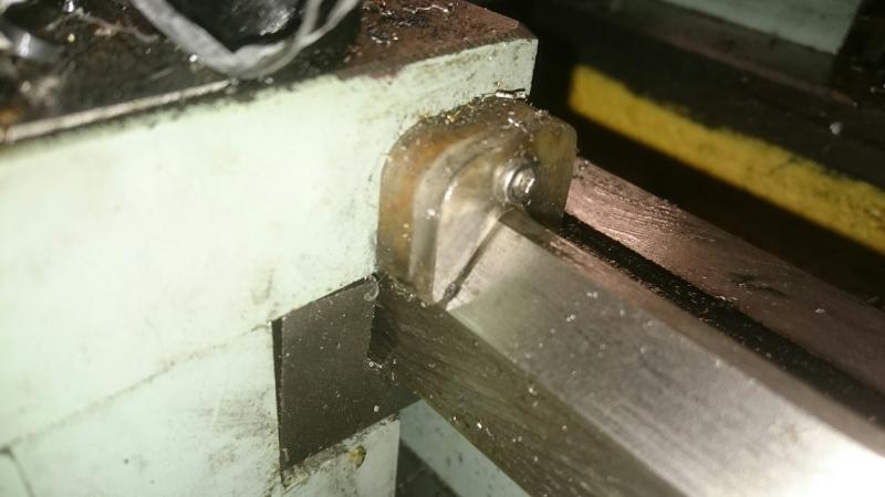

Something a little different, I saw these for other lathes and wondered if they would be any good.  Answer, make my own and try it.
http://i7.photobucket.com/albums/y253/joulesbee/3D%20Prints/IMG_0102_zpsvvkspunk.jpgMyford Bed Wiper 3D Printed
My felt wiper and the metal cover, that took a ding from a chuck jaw are in a pretty sorry state.  I printed it in white so I can see where the gunk is going, took about 40 mins to print.  A lot more friendly if a jaw kisses it, and my warning is white fuzz stuck to my glasses.  It also has slots for the screws so I can adjust as it wears, printed in PLA, of course   :ddb:

If your bed measures around these values ±0.1mm it should be OK.
http://i7.photobucket.com/albums/y253/joulesbee/3D%20Prints/Dimension_zpsuklk5otp.jpgMyford Bed Wiper 3D Printed
The price would be (depends where on the planet you are)   Don't forget this replaces the felt and metal cover and is for the Myford Super 7
The other point, I only just made this tonight it hasn't been properly tested, probably better than no felt, time will tell.

The PLA wiper works, it pushes swarf out the way, it doesn't scrape the oil off the bed and seems to keep a meniscus present.  It was important to press the wiper down and tighten the two central screws first, then the outer ones.  The PLA is OK fastened direct to the saddle, it wouldn't be easy to print as a thin shell and with felt behind it the PLA wouldn't resist bulging, that in turn would deform the wiper and increase its wear and possibility of splitting, so you are back to metal plate over felt.   LOL if only life was so simple, hot swarf pretty quickly cools and a small point contact on the PLA doesn't actually cause enough melt for it to embed.  Lots more testing to see how it holds up though.
