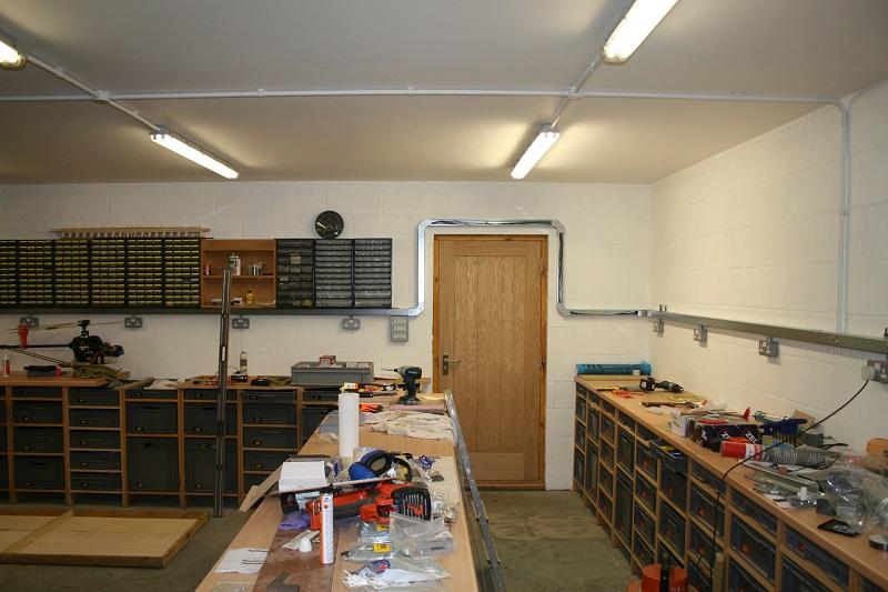

Rob, one of the best decisions I took setting out my workshop was to run 100 x 50 trunking round all the walls - makes wiring installation and later inevitable changes a breeze
Re: Wilson's Workshop Waffle
« Reply #176 on: November 21, 2016, 04:00:01 PM »
I am still pondering how to run the cables  Andrew   , Did you go plastic or steel trunking ?
I have about 70 meters of 2.5mm 4 core SY cable that I will be using ,,,,,,,,,,,,, , Just because I got it free  .

Rob, at the time I couldn't find steel trunking at a sensible price that was rectangular rather than square - and a 4" square is too far off the wall in many cases, so I went with plastic:
https://www.tlc-direct.co.uk/Main_Index/Trunking_Pvc_Index/Maxi_42/index.html

Have to agree with Andrew about the trunking idea. I used 50x50 which is adequate for my smaller needs. Pic shows job half-way through.

Well I have had a ponder on the use of trunking and its not going to happen , I would need way  to many bends :(  . So I may just get a few lengths of cable tray , mmm still pondering  :scratch:
Cheers ,Rob
