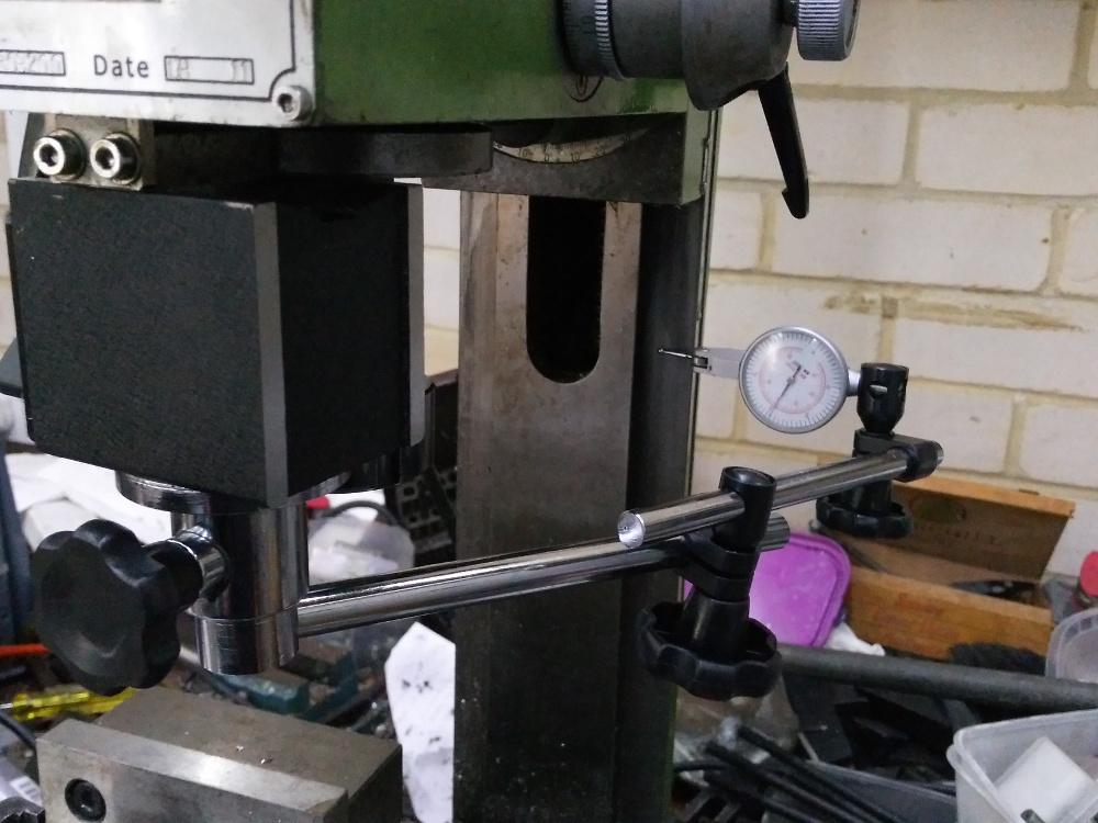

I've had this Warco WM14 mill for some time and it has had this issue from new. The spindle axial rotation is not in alignment with the spindle feed axis, and I really would like it to be  :scratch:
As a better explanation, the spindle is accurately aligned to the bed of the mill, such that if one attaches a dial gauge to the spindle and rotates it such that the gauge reads the table, the spindle is pretty accurate. This remains true regardless of the feed position. However, the centre of rotation changes in the Y plane depending on the vertical spindle feed setting. If a right angle plate is placed on the table and a dial gauge attached to the spindle an offset of 6 thou Y per inch of vertical movement occurs. The error is about 0.35 degrees and equates to approx 0.25mm over the total 50mm of spindle feed. Picture attached to hopefully clarify my poorly worded description.
I am seeking advice on how to disassemble the head if anyone on the forum has one of these mills, and how best to effect adjustments to cure the issue.

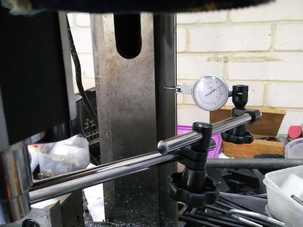

« Reply #9 on: August 03, 2016, 02:34:21 AM »
@Pete
The way I figure it, and it has taken some time for me to work it out. The spindle bearings are good, but the whole spindle assembly is moved vertically by the handle on the side. From the measurements the spindle is not concentric with the part that holds it. I have checked it with a dti against the column before and I think it shows the same error, but I will double check it again today.
Its like the bearing holders of the spindle are not concentric with the part that houses it.
After all this time it will be interesting to see what the problem actually is.
Best Regards
picclock
Edit: added pictures which show ~13thou difference over 50mm quill travel against column.
« Last Edit: August 03, 2016, 04:26:32 AM by picclock »

  • Posts: 537
Re: WM14 Mill spindle issue/adjustment
« Reply #14 on: August 04, 2016, 05:10:00 AM »
Hi Picclock
I was asking about the swivel bolts and gibs because if they were slack then the head could droop and then lowering the quill would tend to move it toward the column.
I assume your shim is in the gap between the swivel faces.  That does explain this a bit.  I couldn't understand how the axis of rotation could be right.
If it were mine, I would take the shim out and see what the quill did then.  I would first want to get the quill moving vertically and then tackle the axis of rotation which I think will need the spindle stripping.
