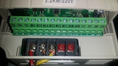

hello fellow members have a few question for you new to the form .
i have the ddcsv1.1 and a vfd my vfd is a kinda 320 series 2.2kw i will attach the pdf for anyone to give me a hand ( thanks in advance) first question how do i hook this thing up ..IM so lost was told i have a pretty good vfd from other groups but no help with this..
also pulse per mm i know its steps my motors do 200 steps per rev my driver are set at 1600. my ball screws are 1616 ..16mm per rotation(360)degrees   whats the math for this again? or the answer lol
