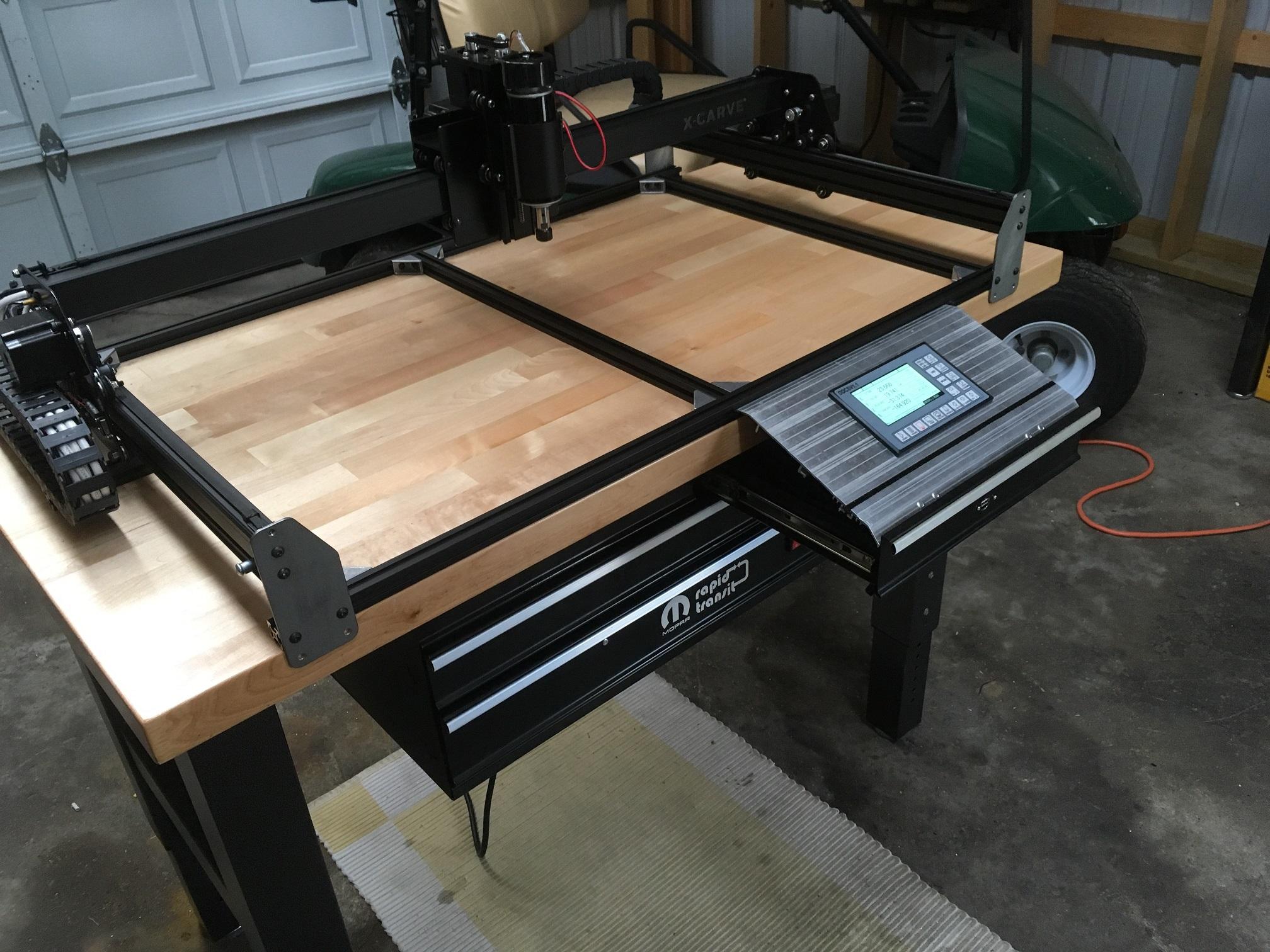

Hey Mark,
I built a CNC router (X-carve). It's working pretty well for that, although I would like a more robust CNC controller. The DDCSV is great, but I do wish they'd release an updated, improved model of it.
- No best but better

« Reply #729 on: November 09, 2017, 11:32:20 AM »
Nice router Bill.
Mark
