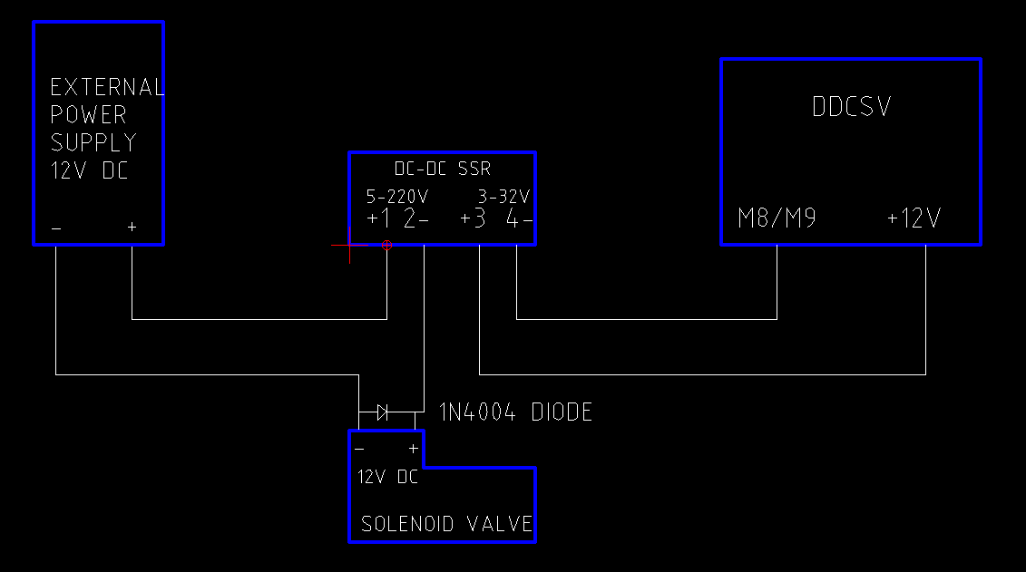

Hello do you know how to connect electrovanne 12v ?i need relay ? Or i can connect the electrovanne on 12v and m08?
Offline old Zozo
  • Posts: 34
« Reply #707 on: November 06, 2017, 09:05:29 AM »
Yes, you need relay (SSR).  M8 could switch only 20mA.  See  Pages 13.

Offline ugv
  • Posts: 26
« Reply #708 on: November 06, 2017, 10:39:57 AM »
I cant tale the 12v on ddcsv? Or i must have a external power 12v 20 mah ?
Offline ugv
  • Posts: 26
« Reply #709 on: November 06, 2017, 11:10:04 AM »
i have buy this it's good ?
Offline old Zozo
  • Posts: 34
« Reply #710 on: November 06, 2017, 02:43:29 PM »
No.  This relay needs more than 100mA, but M8/M9 output of controller has only 20mA.
SSR relay can be controlled with less than 20mA.
For example this one:
https://www.ebay.com/itm/PCB-Mount-Type-4A-SSR-Solid-State-Relay-DC-DC-DC3-32V-Control-DC5-110V-4-Pin/111379031094?hash=item19eeb52436:g:~8IAAOSwnHZYVAjL
DDCSV can control it, and you can use it for cooling motor under 5-110V 4A.
Only motor needs  external power.  What is the voltage and current of the motor?
I'm not an electronics expert, but someone fixes it if necessary :scratch:
Offline ugv
  • Posts: 26
« Reply #711 on: November 06, 2017, 03:12:55 PM »
12v 3w
Offline old Zozo
  • Posts: 34
« Reply #712 on: November 06, 2017, 03:21:15 PM »
OK, I'm looking for a matching relay.  DC motor, or AC?
Offline ugv
  • Posts: 26
« Reply #713 on: November 06, 2017, 03:27:00 PM »
dc , its a electrovane pneumatique 12v 3w airtac 3/2voies

Offline ugv
  • Posts: 26
« Reply #719 on: November 06, 2017, 04:41:47 PM »
yes if i have a wiring i am very happy. And do you think if i take a 5v ssr can i connect the 5v s for the handle with the M08?
Offline old Zozo
  • Posts: 34
« Reply #720 on: November 06, 2017, 05:05:54 PM »
DDCSV's 5V is isolated from M8/M9 output.
Useable 12V of limit input.
But external 5V useable, of course.
Offline old Zozo
  • Posts: 34
« Reply #722 on: November 07, 2017, 03:17:39 PM »
yes if i have a wiring i am very happy...
for example...

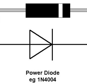

Offline old Zozo
  • Posts: 34
« Reply #724 on: November 07, 2017, 03:59:03 PM »
Watch the diode marking...
Important! This direction is correct only. If you change it, the SSR or power supply is damaged.
