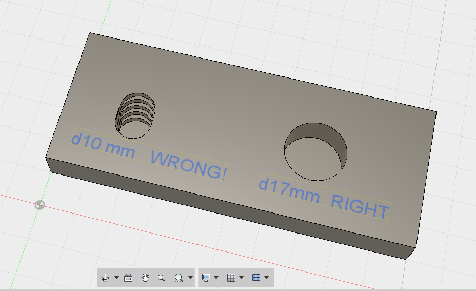

Unfortunately I still have problem with my controller.
If I make a bigger diameter pocket (e.g. diameter 17mm), everything is right.
But when I mill smaller pocket (e.g.  diameter 10mm),  tool steps down on a stairs.
G-codes is right, of course.  (see the photo)
Which parameter need I modify?
- minimum log radius of 4axis mode is 5mm  (I think, it uses only 4th axis)
- time duration between DIR and PULSE  5000 ns ( written by manual of DM556D driver)
- feedrate not to high (X and Y600 mm/min,  Z 50mm/min)
- acceleration 100m/s^2
- interpolation period 0.005 s   - perhaps it is small? I don't know...
Part of G-codes of diameter 10mm pocket is here:
N405 X-31.5 Y13.
N410 G01 Z1. F50.
N415 Z-2.
N420 G03 X-33.5 I-1. F600.
N425 X-29. I2.25
N430 X-36. I-3.5
N435 X-29. I3.5
N440 G01 X-29.5 Z-1.95
N445 G00 Z5.
N450 X-31.5
N455 G01 Z-1. F50.
N460 Z-4.
N465 G03 X-33.5 I-1. F600.
N470 X-29. I2.25
N475 X-36. I-3.5
N480 X-29. I3.5
N485 G01 X-29.5 Z-3.95
N490 G00 Z5.
N495 X-31.5
N500 G01 Z-3. F50.
etc. (same as above, only Z steps down)

Offline PPRINT
  • Posts: 50
« Reply #562 on: May 06, 2017, 09:42:39 PM »
old Zozo....I am using the Leadshine Easy Servos on my rig....which says to use the 5000ns DIR/Pulse like your DM556D.  I tried that setting and it sounded like a freight train crashing.  I do not have the parameters in front of me right now....but I want to say I am closer to 500.
I have not tried interpolating a small bore yet to see if I am having similar problems.  I will be working with the machine in the morning and will give that try.
I just read your code before I was going to hit post.  I noticed you are using I,J,K for your arc moves.  I was not able to get arcs to work predictably with anything other than R's. I hate using R for an arc move...but I will stick with it for now.  Maybe here soon I can adjust my post to try all of the IJK combinations to see if it works for me.
The afternoon knows what the morning never suspected.

  • Posts: 34
« Reply #564 on: May 07, 2017, 11:34:15 AM »
I tested again. Nothing changed. What I tried to change:
-time duration (Dir/Puls)
-interpolation period
-acceleration
I see in the display,
when the tool finished the spiral movement, Y axis steps minus 0.2 mm.
-but why?
This is the 0.2 mm stairs.
Could somebody runs my gcodes? Not machining, only in controller.
When gcodes run out, you need to see last coordinates.
Correct coordinates are :  X-29.5  Y13
My controller has false values,  X-29.5 and Y11.8 !
Thanks, Zoli
(attached file:   D10pocket.txt
Zmin= -10 mm
Zmax=5 mm
Pocket diameter= 10mm
Pocket centre= X-31.5 Y13)
Offline PPRINT
  • Posts: 50
« Reply #565 on: May 08, 2017, 07:14:01 AM »
Zoli, I just ran your code through my machine and it cuts a good bore without the stepping in your picture.
I captured a handful of parameters that I use for you to compare...not that I feel this is the problem.  They are just for reference since we both use Leadshine drivers.
#5

Offline antonio
  • Posts: 31
« Reply #566 on: May 08, 2017, 07:18:20 AM »
-acceleration
-but why?
Thanks, Zoli
Zmin= -10 mm
Zmax=5 mm
Probably you are using the backlashing function on setting of parameters
Inviato dal mio iPhone utilizzando Tapatalk

Offline old Zozo
  • Posts: 34
« Reply #568 on: May 08, 2017, 09:47:41 AM »
Rob,  thanks again for your help.
Antonio, that is good idea, but I have no backlash so its value is 0.
Rob, I  compared  parameters now.

my screw have only 1/4" pitch. Pulse/mm is correct at me, every size of parts is  between  +/-0.01mm.
Bearing fits in the pocket, like eggs in the mouth of a dog :)
Unfortunately controller sends false command to the driver,  and only when is a  smaller diameter of pocket
Perhaps this is a firmware error...
