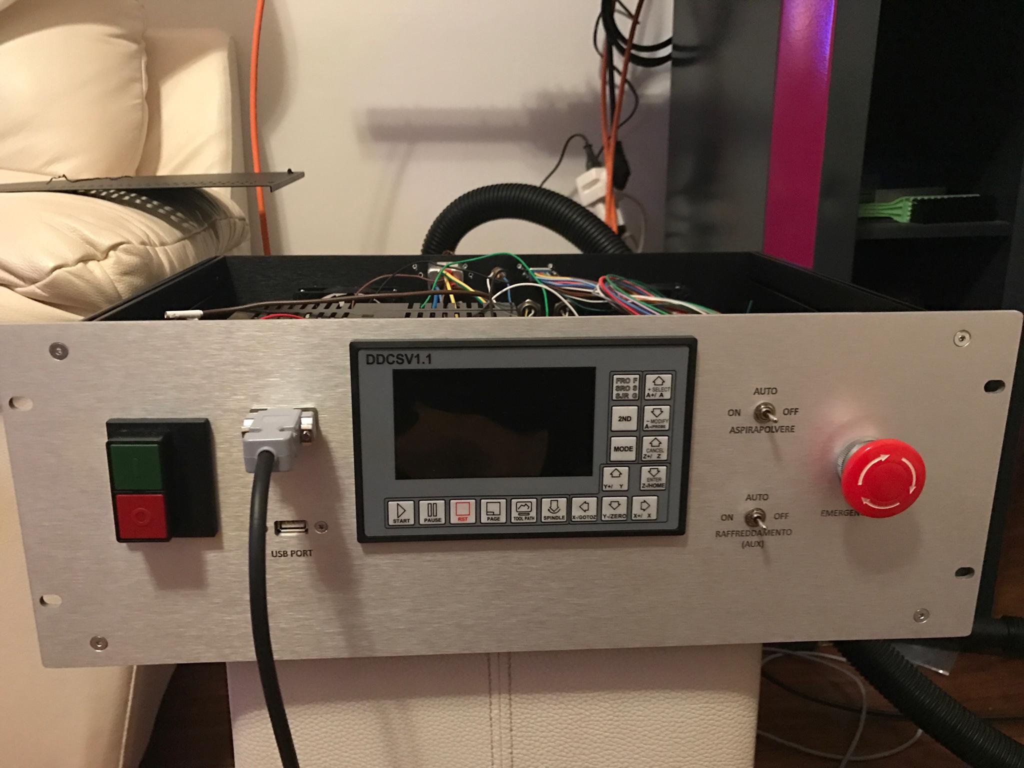

This is my job... the front panel
Inviato dal mio iPhone utilizzando Tapatalk

Btw, your panel looks amazing  :thumbup:
