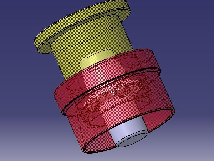

Offline ugv
  • Posts: 26
« Reply #379 on: February 18, 2017, 03:00:20 PM »
Offline ugv
  • Posts: 26
« Reply #380 on: February 18, 2017, 03:04:33 PM »
Hi UGV,
Welcome to MadModder.
Do you have a drawing of how the tools are retained for your ATC? I am interested in doing something similar for an ER32 spindle.
« Reply #381 on: February 18, 2017, 04:27:06 PM »
Thanks UGV,
What diameter balls are you using and what is the force exerted by the spring?
