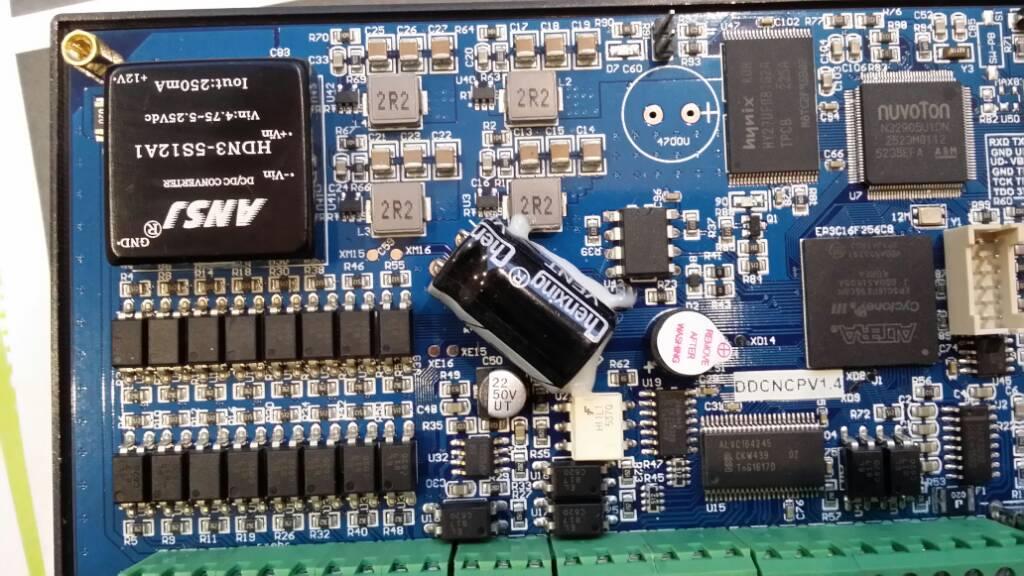

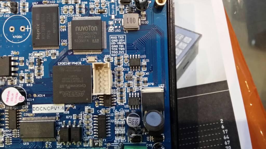

I was wonder if there is any combination in the keyboard to press at the startup than can boot in some programming mode? :med:
If there is a way, then it is through the internal serial console or jtag. The device also always tries to boot from sd card first. I have not inspected the Mainboard too carefully, but maybe there is a header or even an unpopulated sd slot?
Also we can always try fixing the userland stuff. This would fix most problems except for the bootscreen and the axis configuration (i guess at least).
No SD card connections,  just a jumper and 2 touch connectors on the board,  maybe some sort of testing point, nothing on the other side of the board

i'll have a look now and post some pictures, in the meantime my Probe routine is not working anymore, is the 2nd time that happen, any experience in the matter?
It start probing, but it not sense the touch, the connections are good as before
Hmm thanks for checking the SD slot. I am on the train home so I wasn't able to check myself.
Sorry, i am not using probe at all. Instead I manually probe my workpiece.

Also inside on the connector there is a secondary usb port.

I have managed to put it into USB boot mode so it can boot linux from an USB stick.
To do this you have to put a 10KOhm resistor across R91.
CPU datasheet can be found here:
http://www.nuvoton.com/resource-files/N3290xDataSheetrevisionA5.1.pdf (Pinout at 3.4)
Also we have a ridiculus amount of Flash memory: 1 Gigabit (128 MB).
Datasheet here: http://www.hynix.com/product/filedata/fileDownload.do?seq=4176
However it does not seem like the bootloader responds to anything sent over serial, so I fear this is the end of the road (for now from this side).
I have no idea how to get the bootloader to do anything more than to try to boot from USB, there is absolutely no documentation on it and I am not able to get it's source code nor can I actually dump the bootloader. I would not be surprised if it actually resides in a mask rom in the CPU.
I am not going to put uboot on it for a couple of reasons:
   - If I brick the controller I will have to pay another 160€, which I just can't spend atm (or learn to use my JTAG, but then I would still have nothing to copy back)
   - Getting uboot to work will require a lot of work, however somebody else has actually started to work on uboot on this CPU and it might work)
   - Nobody without a JTAG is most likely going to be able to flash uboot. While USB boot is there I have no clue if this would somehow make us able to install uboot from a usb stick. And even then would you have to put a 10KOhm jumper across the two pins.
Now we should focus on finding a way of mounting the flash chip from Linux and getting access to the boot loader configuration from there.
Or we could work on the translations some more.
Any input from you, fellow modders?

This is how the new bootlogo looks like:
And this is the output of the bootloader when bridging the resistor:
I have posted some more pictures in my article over here:
http://bmuessig.eu/posts/ddcsv11-cnc-controller-modding-part-2
