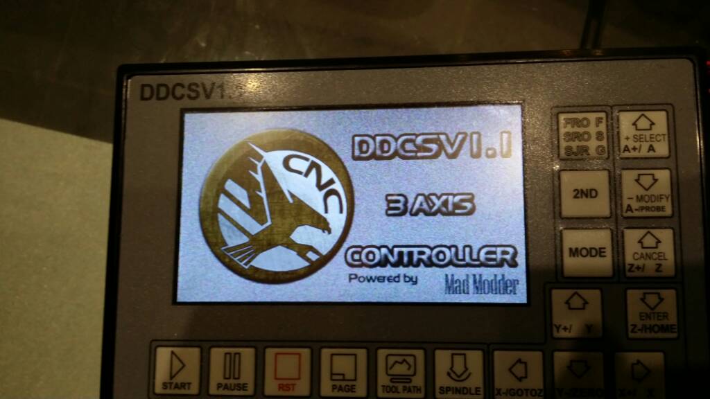

I wonder if the difference is just the label, chinese often do that, they are not expecting normal people opening the control box and change things, but we are not normal people :) !!!!!!
So...... i will open the box and check, but i'm pretty sure i'm right, i will post pictures of what i find out soon.

As you can see in the menu, there is the A axis box. it is simply empty on the 3 axis model. The settings for the A axis are all present on the 3 axis model. I don't know if the 3-axis model still parses the A axis gcode commands. This is yet to be found out. But yes, there is a simply flag. Finding out where it is stored is probably rather easy. I will disassemble the rest of the firmware now and have a closer look. When they manufacture it, they simply use the 4 axis board, set the flag (using either uart or through USB or maybe even with button presses) and then stick the 3 axis label on.

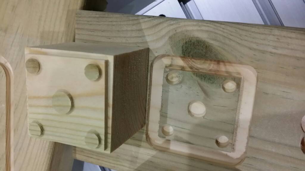

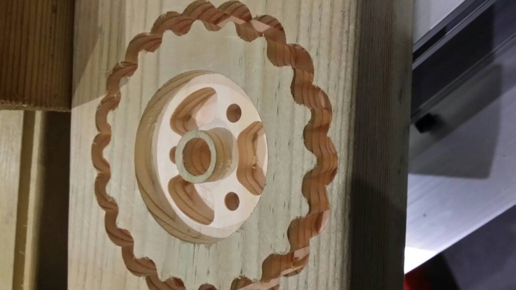

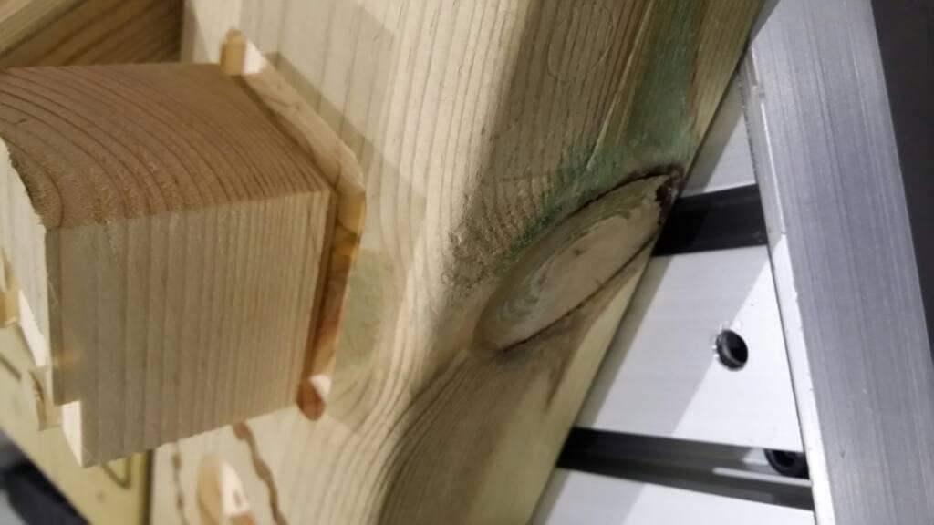

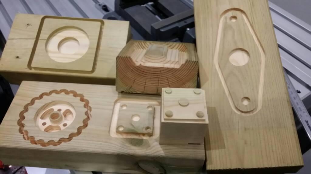

I started milling some 2,5D shapes on wood to try the controller and how accurate is, i have to say that i'm quite happy for what i got ...
I will post some pictures just for share, they are just random shapes done in solidworks in a few minutes, but they give the idea.
Mach post processor it doesen't work, need some changes in the final file to work properly (this controller is generic fanuc G-Code)
Of course i will share pictures of my little router...
The tolerance measured on wood  really surprised me.... let's look at the pictures later! :)

I tried to upload some pictures,  but it says I'm not allowed to do that due to security check failures [emoji33]
Inviato dal mio SM-N9005 utilizzando Tapatalk
Offline Merlin201314
  • Posts: 121
  • London
« Reply #110 on: November 09, 2016, 02:32:47 PM »
2 attempt to upload pictures as promised......
Every comment is fully approved and appreciate

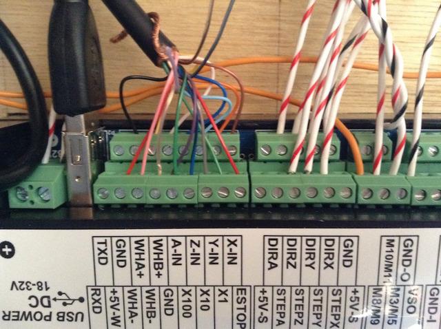

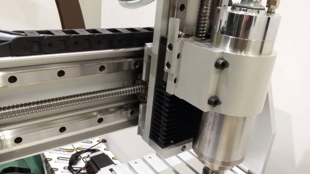

I bought the the X6-1500GT from carving-cnc (now it is called Omiocnc) some 3 years ago, similar to this https://www.omiocnc.com/products/x6-2200l-usb.html but 1.5kW spindle. The machine is well made mechanically for hobby work more than enough. The controller box is ok apart from the usb card / Windows + Mach3. It started to skip steps, the motors would stall, looks like noise or breaks in communication somewhere... I never find out what was the cause, after I got windows update reset the pc in the middle of the job I had enough.
I pull the trigger and got DDCSV1.1. Old Dell PC provided the case, rest I butchered from old CNC controller box.
Here are the pics of the old controller https://goo.gl/photos/Fn9C33iL88yi99XT9
And the new one with DDCSV:
https://goo.gl/photos/qcFnpDHyAJk3gcRn7
So far so good. I think everything is working. I am missing the ATC function from mach 3 with 2 sensor plates setup, one fixed and one mobile. I have yet to figureout the following:
1) Probe mode 1 operation and the tools offset, how to use it. Currently I am using Mode 2 which behaves as I expect, it resets Z to 0 using the mobile probe.
2) My Home (x=0,y=0 machine coord) point is on the left and back of the table. Y axes home switch was convenient to put at the back. In Mach3 I could setup coordinates to Home other than 0 but I do not thin I can do it with DDCSV. As a result The machine travels to Home once at the beginning of the job and twice at the end... It may be the Post-processor I am using. (Aspire, with Fanuc post.)
I cut simple holder for ER16 collets, pics are at the end of the new CNC box album.

So I have made progress on my CNC and sent the machining files to the company who does laser cuts. It will be a 1 mm stainless steel panel.
About the extra buttons, I forgot to add them, but I am fine with a few more button presses.
Also in my new translation I have fixed the meaning of the GotoZ and Zero commands. They now tell you that they are for either setting one axis to a custom value or for going to a custom value. And there are still the options to Goto zero or to set zero. Pretty easy to understand now :)

Yes I have just updated the file.
It still is and will always be available through this link: https://gist.github.com/bmuessig/cac1750c01ababf316678cc7710e3972
EDIT:
I have put the modded firmware on GitHub:
https://github.com/bmuessig/ddcsv11
Also I have started an open source repo that can not be taken down by anyone. It will however rely on parts of the non-free image to work. I will provide programs to patch a distributed copy of the original firmware with the new components.
This version can be found here: https://github.com/bmuessig/mod-ddcv11/

Wooho!
I made it!
Sure, it is not the best or most complicated script, but it works and is tested.
I was able to build firmware that allows running commands as root!!!  :D
Everything placed in commands.sh on the USB disk is run once at boot.

So, this is the screen configuration:
Code: [Select]
mode "480x272-0"
# D: 0.000 MHz, H: 0.000 kHz, V: 0.000 Hz
geometry 480 272 480 272 16
timings 0 125 115 70 36 64 6
accel false
rgba 5/11,6/5,5/0,0/0
endmode
Soon, we will be getting rid of the old bootsplash ;)
EDIT:
I DID IT!

« Reply #121 on: November 14, 2016, 01:17:58 PM »
NIIIIICE!!!!! :proj:

« Reply #123 on: November 14, 2016, 05:42:50 PM »
Here you have the connections colors, and the picture, hope that help
 :worthless:

« Reply #124 on: November 14, 2016, 06:05:39 PM »
Now I like it!!! [emoji6] [emoji6]
