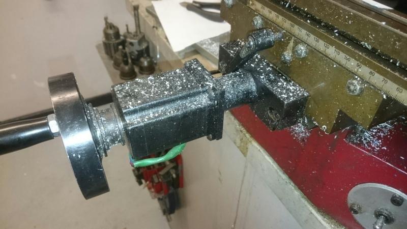

This is how I like to mount motors.
Inside that block are the two bearings and the nut that retains them is the first half of the Oldham couplings. Don't mount the motor on pillars like many do, it's a machine tool not a bloody clock.
No you can't use your scales, none of the hobby controllers like Mach can accept feedback.
John... I am trying to picture how that is setup in mind. Having difficulty seeing it (my mind is already full). Can you describe a little more?

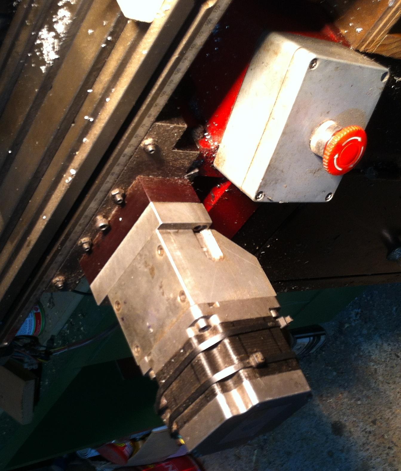

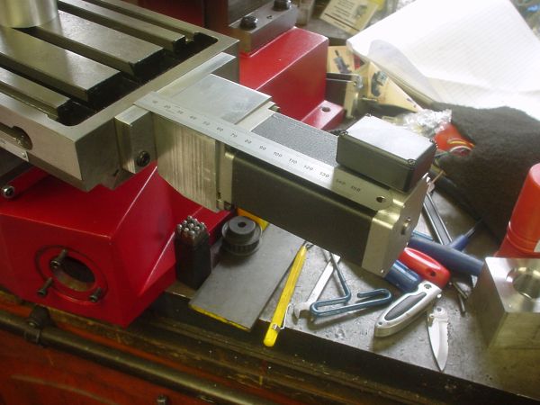

Here's how I did it on my X3
I used double shaft motors which let me keep the hand wheels, albeit with them sticking out a bit more.
The mounts were fabricated and then machined true.
The helical couplings are inside the tubes and you can see the access holes for the clamp bolts..

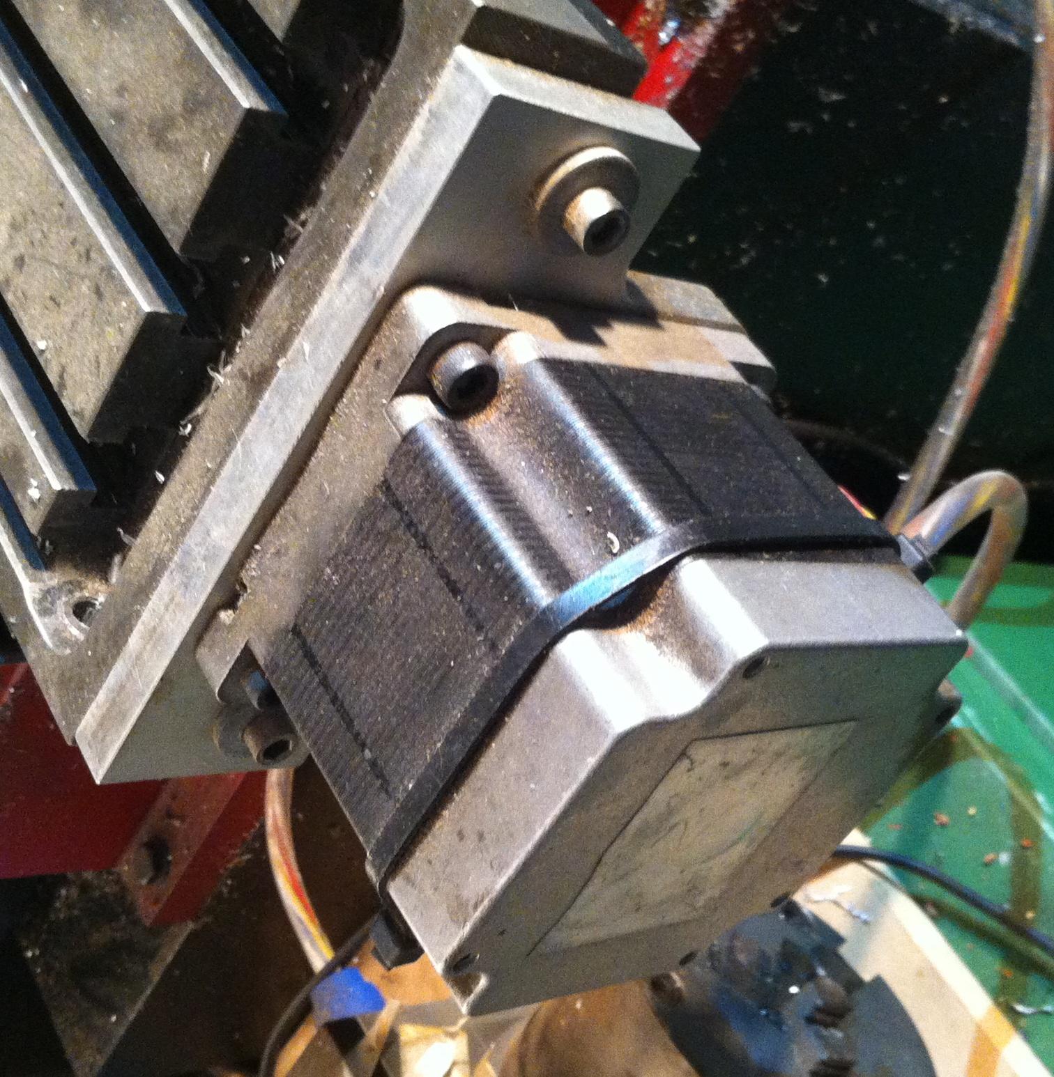

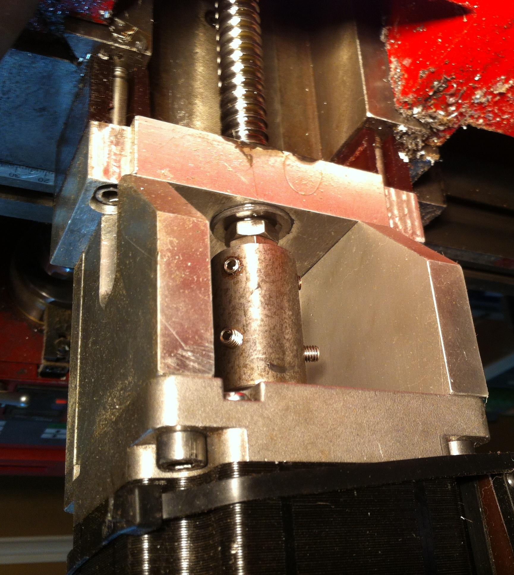

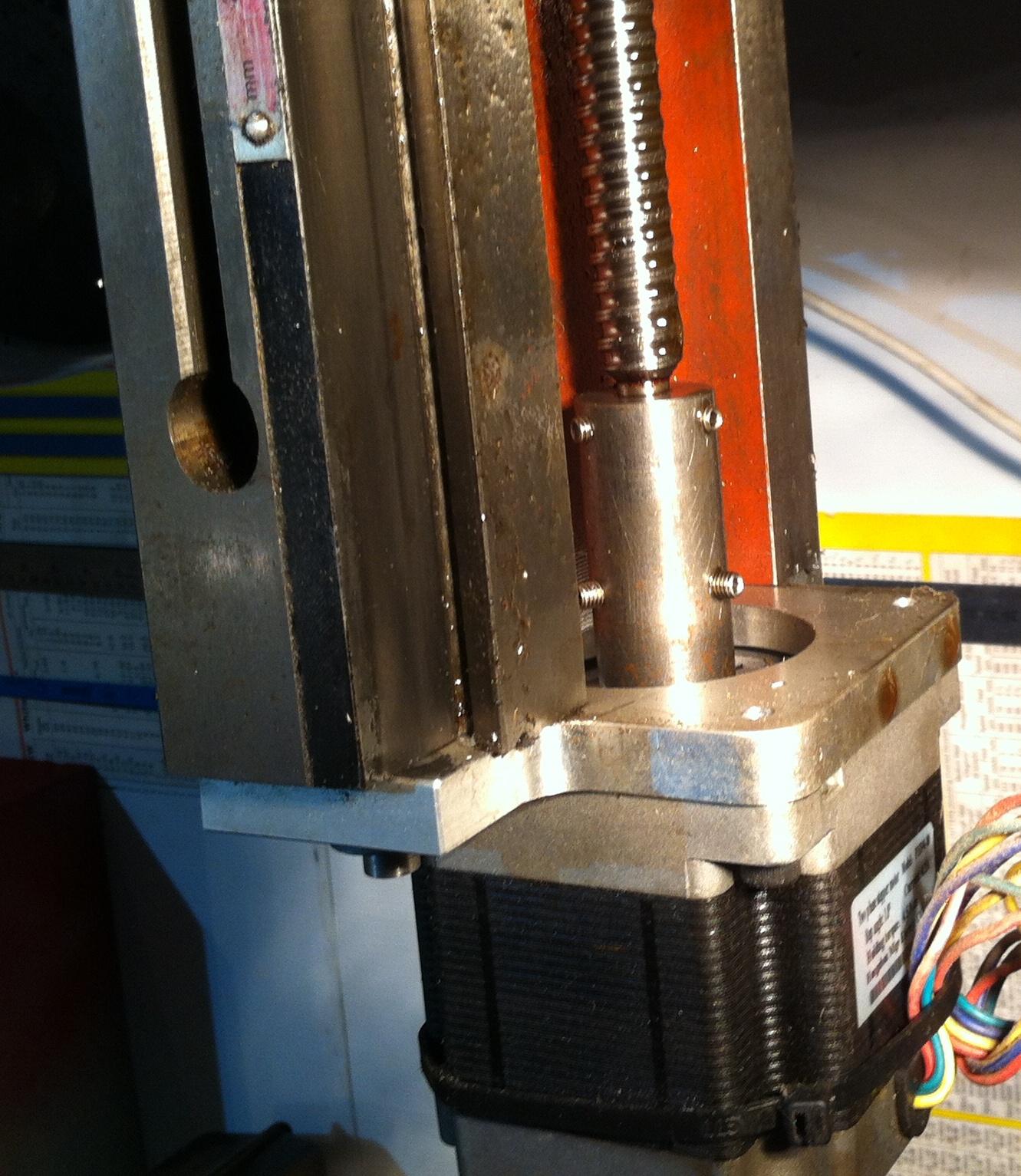

This is how I did my X & Y Axes.
First Photo is the X Axis. Solid Coupled Motor and twin Thrust Bearings at the other end. This setup relies on the Stepper Bearings for thermal compensation. No issues in 6 Years of operation, 65micron accuracy.
Second Photo is the X Axis from above.
Third Photo is the Y Axis. Solid Coupled Motor with twin Thrust Bearings. This LeadScrew is so short it didn't require a Bearing at the far end.
Fourth Photo is the Y Axis from above.
