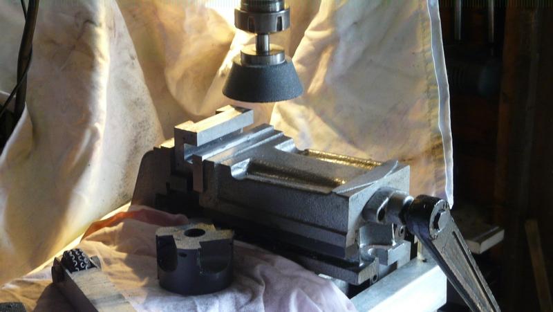

I use a 80mm cone grinding wheel in a home made arbor , gets a good finnish needs a realy fine down feed is needed  to mutch and the stone cloges up , cover up well and vacume at the end of the job no problems so far .

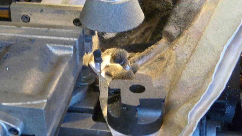

I will be using my gringing wheel later today ,  to finish 4 tool holders made from fork lift tines , this is tough stuff and hard to get a finnish on will take some photoes .

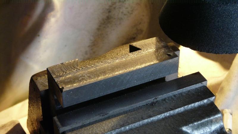

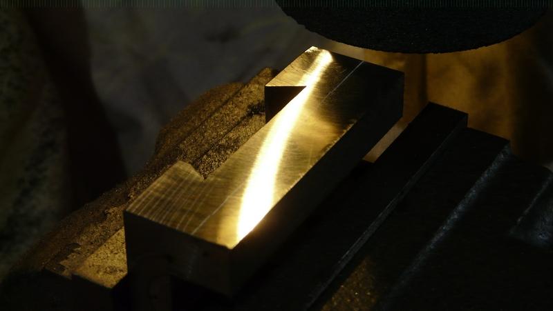

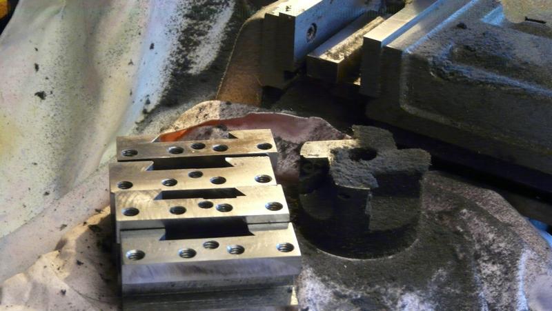

Set up for grinding today pillow cases held on with magnets , before and after shots oil blacking will get rid of the shine , these bits of fork lift tines must be different to yours Rob drilling and tapping 8mm was a pain brand new taps to .

Many thanks for the pictures  :beer:. That was exactly the sort of thing I had in mind. The machinability of the steel obviously plays a major part in the initial finish.  Its quite amazing the quantity of dust kicked up by the process. What sort of depth of cut were you setting - 1-2 thou? It looks from your picture that you are using a grey wheel - Aluminium oxide ??
