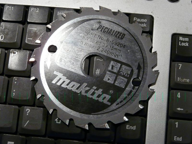

This is an almost got it project.  I damaged some clip on magnifiers I use and figured I should probably make a spare pair.  As I bought some Poundland magnifier glasses a while back for the pads, I threw the frame but hung onto the lenses.  I figured I would have a go at making some half frame clip ons.  First job work out how to cut the lens in two, or rather how to grip it without marking or damaging it.
This setup seemed to work, IKEA coffee stirrer stick snapped in half using the universal vice with handle removed clamped on the mill.  The cutting blade is carbide tipped from Aldi for one of their small saws.  They are great for cutting Perspex.
It took quite a while doing the cutting as the setup isn't that rigid so gentle cuts, it also left a crystal clear finish on the cut parts.

Those carbide tiped saws are great for hard stuff to , but they can make a lot of noise .
