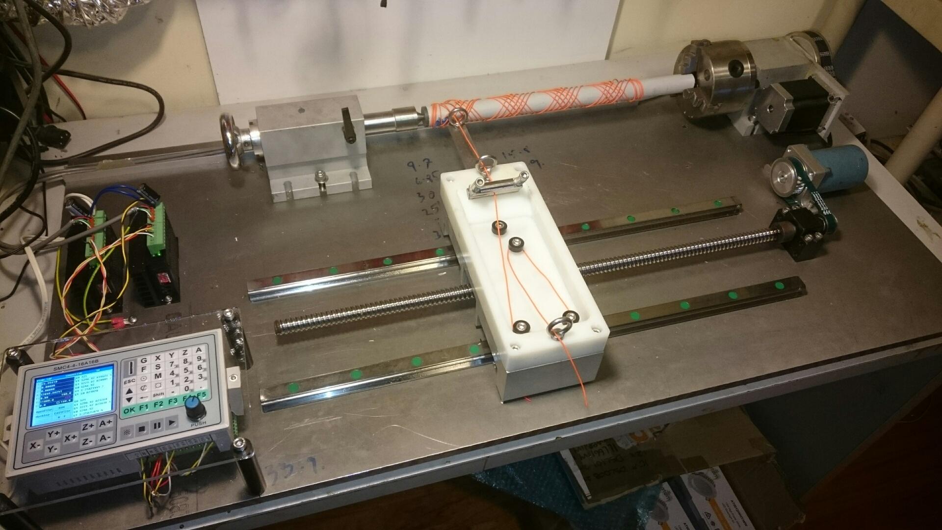

So this thing's just about ready for action.
The little CNC controller is great. I initially experimented with reprogrammed 3D printer electronics. Don't do this...

« Reply #2 on: July 08, 2016, 08:21:57 AM »
I am disappointed to see you have gone with such a basic controller.   :lol:
'Overkill' is my middle name!
I cant recall the price, but it was something like AU$250 landed. Which is only slightly more than I would have spent on a smooth stepper + isolation. That being the way I've been controlling machines for the last few years..
This one will do 4 axii, the other two of which I may well add as this rig evolves...

« Reply #3 on: July 08, 2016, 09:27:48 AM »
That controller is actually pretty nifty...  I thought it was something much more expensive till I did a search for them.
Turned up an interesting video review with a link to further documentation for it.   I should maybe consider one of these for my old CNC router, and other potential toys.  I do like the D25's on the back for direct interfacing with equipment, so the head can be quickly swapped to other machines.

« Reply #6 on: July 09, 2016, 01:40:29 PM »
So as a complete novice in the realms of CNC:
Any hints/tips/suggestions please ??
I made one mod to the box.
As shipped, the unit runs from 12VDC. This isn't so bad as most CNC driver boxes and up with a few different supply voltages in them.
Because I wanted to be able to just plug this into a bench supply and run the drives and controller from 24V, I made a small change to the units power supply.
The switch mode regulator used will happily handle 40V input, but, for reasons unknown to science, the designers elected to put a 16V electrolytic cap on it's input.
I swapped this for a 35V 220uF and now everything runs fine at 24V.
PK

Sorry for the delay gents, just got back from an unexpected trip to hospital..  On the mend now..
Rob, build quality is pretty good. The membrane switch panel is as good as anything I've seen out of china. The display is a little small for my eyes, but I suspect I won't be looking at it that much...
If you've ever seen a Schumatech DRO that someone has done a really good job on... Well it's better than that..
Internally it's fairly well designed, aside from that input cap. There's lots of isolation and the PWM VFD output swings pretty much rail to rail.

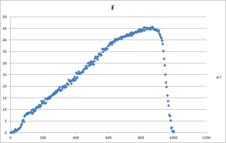

Pekka, The press I featured in another thread is the clue to what it's used for....

« Reply #14 on: July 15, 2016, 06:12:03 PM »
Found short piece of the press, I'll be watching more glues....
Here's another clue
