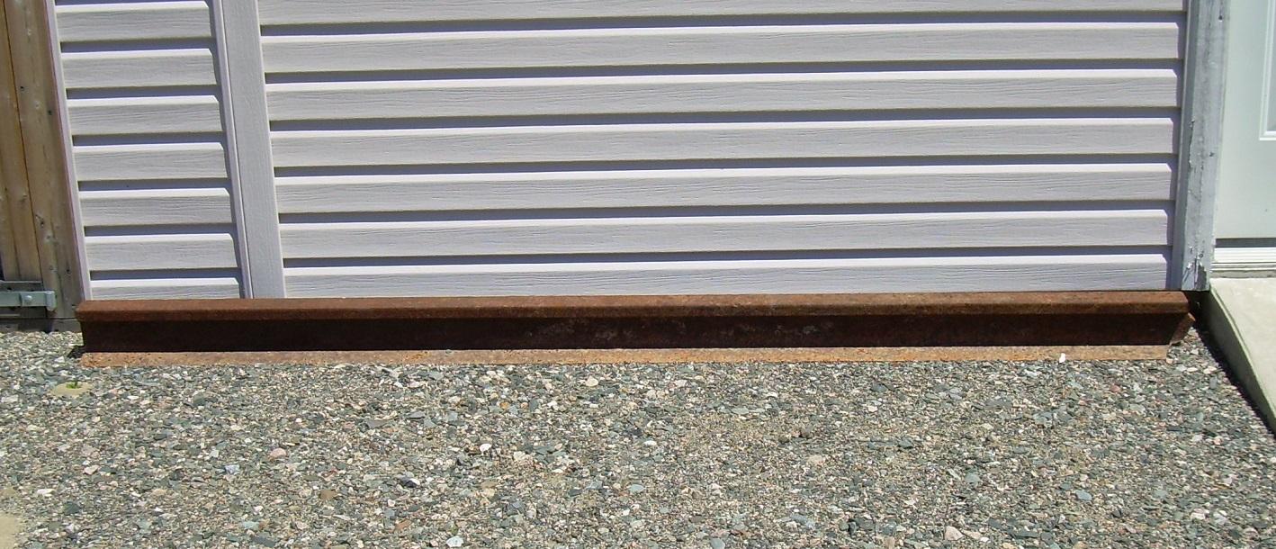

I have a section of RR Track here set aside for the eventual conversion to an anvil for the missus. This gives me some ideas.

Very interesting Rob. Like you Eric I've had a section of rail set aside for just this purpose. One of these days, too many projects too little time.

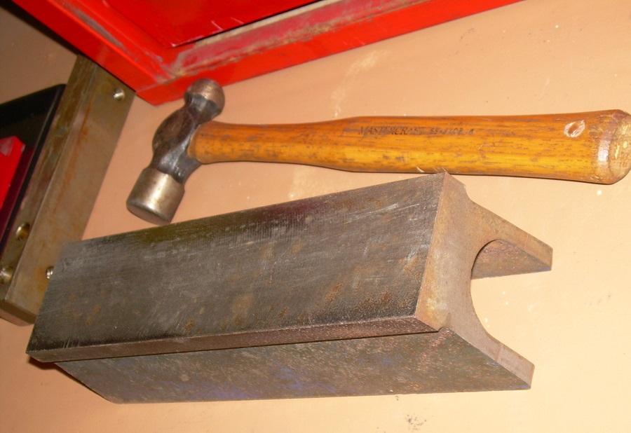

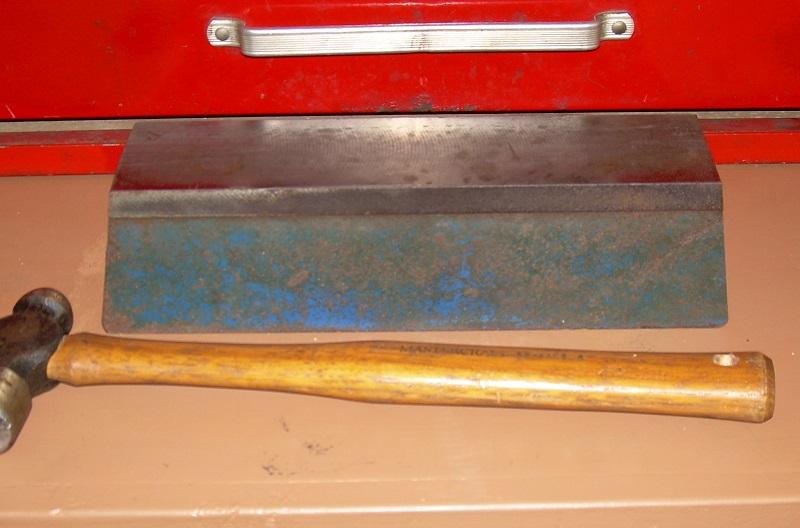

Not really an anvil but works like one on some jobs. Use it for straightening and bending small stuff. Came from a large vise, part of a broken jaw still attached, when I found it in a scrap yard. Holding up real well.

« Reply #7 on: July 02, 2016, 11:24:57 AM »
CB
That's a neat idea. I've got a broken vise that i've just had sitting in a damp corner. I was thinking of taking it to the skip next time I tidy the garage too.

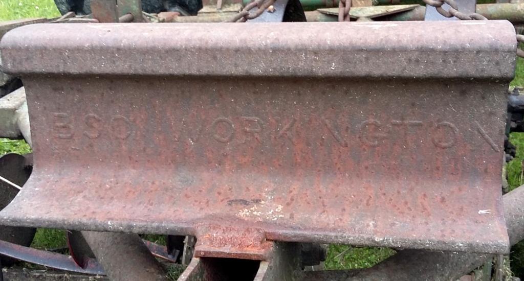

In advance of this thread I had already decided to source some railway track.
Living in Ireland I knew we had a bigger gauge than the standard (British) gauge so I managed to "aquire"  a length from Irish rail.
It arrived and it was such a speciment piece I could hardly take the gas axe/plasma cutters to it:
It was clearly a specimen of rail cut out for a purpose: "BSC WORKINTON"
Such pieces are often mounted up as retirement gifts.
Naturally I couldn't cut this up!

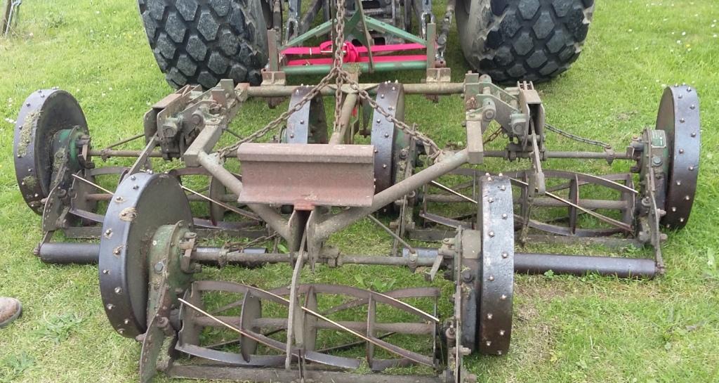

However MadModder 2 decided this was just what we needed to act as a counter weight on our gang mower!
So its back to Irish rail to blag another piece

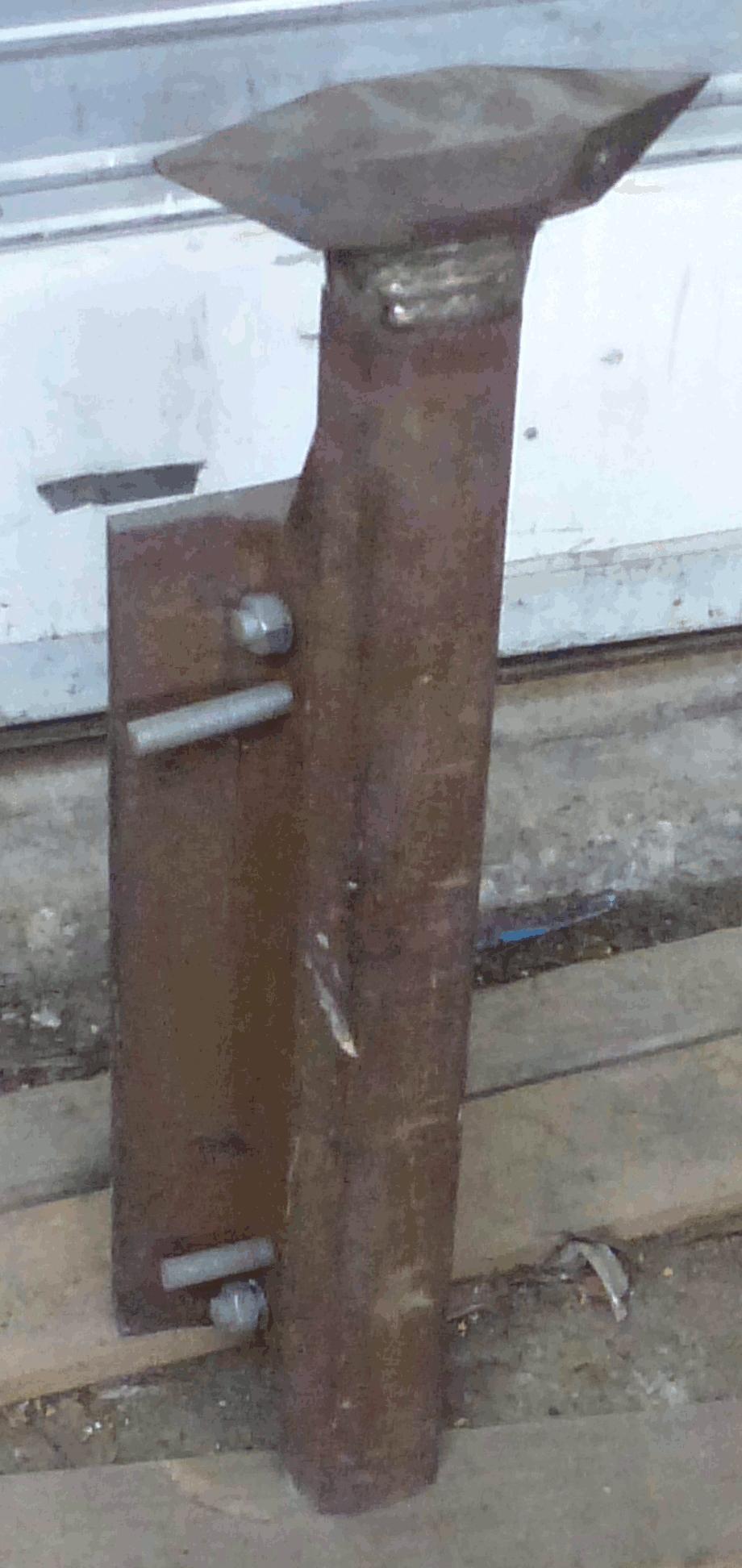

This is my take on using Railway track to make an anvil. As the important thing in an anvil is the mass of metal under the striking point, using the rail vertically works much better than the usual way. This is an on going project, it needs one of the "Spikes" rounding off and hardening and tempering.
