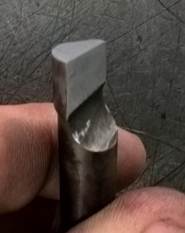

I need to make 3 collars, with 11mm bores. The material is stainless. I predrilled the bore to 10.2mm. Made a D bit out of silver steel (drill rod, 1.2210, 115CrV3). The bore end is 10.98mm, and the half thickness 5.48mm. Hardened and tempered back to deep straw colour.
The front cutting edge as ground on the Clarkson to 10° front cutting angle, and 7 front relief. Then honed on the top and front faces.

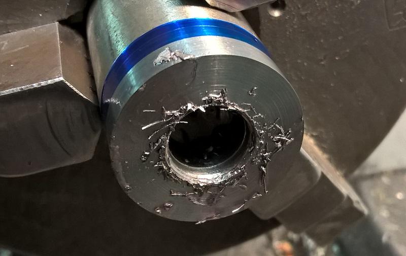

When I tried it on a collar, it deflected and made a mess.
Any suggestion for correcting the geometry would be appreciated.

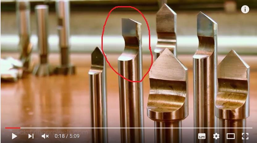

Clicksprings videos are very good. I looked at that video before making mine, otherwise I wouldn't have had the pretty scooped out look :)
His video is for making a 45° milling tool, but I screen shot his collection of bits, and there one similar to mine, so I guess I'll grind a flat on  the nose to see if that helps.

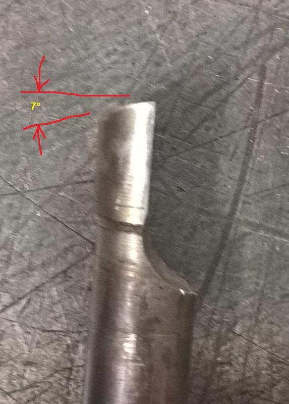

I got the half height nearly perfect. 10.98mm diameter cut and honed to 5.48mm There is 7° of clearance angle below the cutting edge, I was running in Backgear at around 250RPM but it didn't want to cut, just pushed away. The hardening must be okay, as the corner is still sharp.
Mark

Mark, that tool you circled in the picture looks as it it is for forming a flat bottom to a blind hole, or maybe for forming a flat 'ledge', maybe to clean up a counter bore for use with capscrews. Not for reaming. It doesn't appear to have any sloping 'lead' to shave the metal at the diameter.

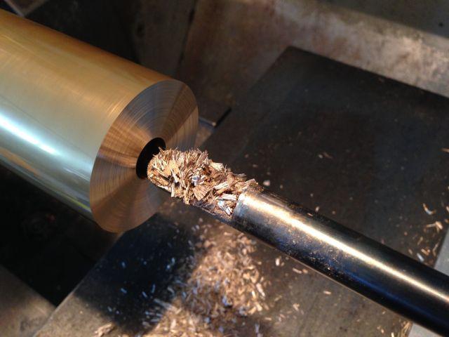

« Reply #13 on: June 16, 2016, 04:08:58 AM »
Mark,
      I agree that you are possibly expecting a bit much of a "D" bit, however, here is one of the type I was thinking of doing much more.
      It is being used to do the bore of a model canon 1/2" and 10" or so in depth. Took my friend ages at 2.5mm per peck, clean and go again - 2.5hr if I recall.
      He gave it a short starting hole of the correct diameter and the D bit did the rest. As you can see from the pic complete with chips it is much as I described with the off side keeping things from wandering. The barrel was brass, the bit of drill rod / silver steel and hardened after grinding and honing appropriate reliefs.
John B
