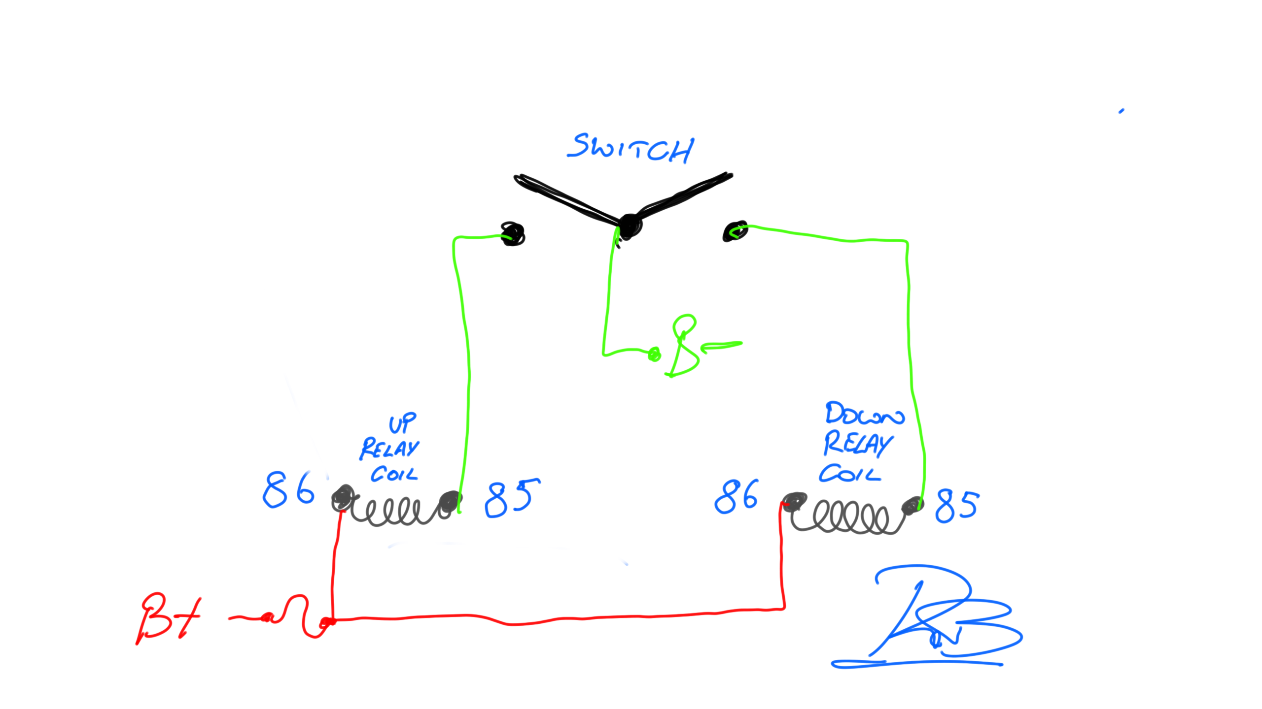

Need Help Wiring DC Motor with PWM
« on: June 13, 2016, 10:04:58 PM »

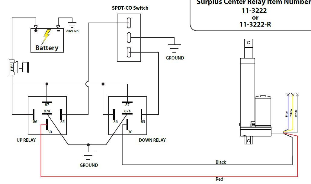

I found an interesting wiring diagram on the interweb showing how to control a DC motor with a SPDT switch and 2 automotive type relays. The motor is the kind where the direction of rotation is changed by reversing the polarity of the 2 input wires. The way it was wired seemed odd to me, grounding through the switch and power was going to 2 terminals on the relay. Anyways, I hooked it up as per the diagram, and it works just fine.
So then I'm thinking I'd like to hook up a Pulse Width Modulator to control the speed and wondering why I can't use a single PWM straight off the power supply. I didn't think it would work and I was right. It doesn't. At least not how I have it wired. I even tried a second PWM from a different manufacturer and same thing. Motor runs at full speed, won't slow down.
I'm wondering why it doesn't work and if there is another way to wire it. First diagram is the one I found at Burden Supply, the second is how I wired in the PWM.

Basically you need to PWM the power going to the motor, but NOT the power going to the relay coils. So wire both 86 terminals of the relays to the +ve terminal of the battery (and only to the + terminal of the battery).

Thanks for the reply PK, but I'm not understanding. Are you saying to supply PWM regulated to the #87 terminals and battery voltage to the #86?

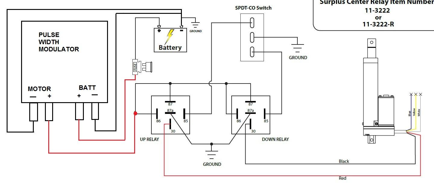

Re: Need Help Wiring DC Motor with PWM
« Reply #3 on: June 14, 2016, 03:10:18 PM »
like so Snub
As PK mentioned the relay coil will  have some issues being supplied with a PWM supply  :zap:

« Reply #4 on: June 14, 2016, 08:48:01 PM »

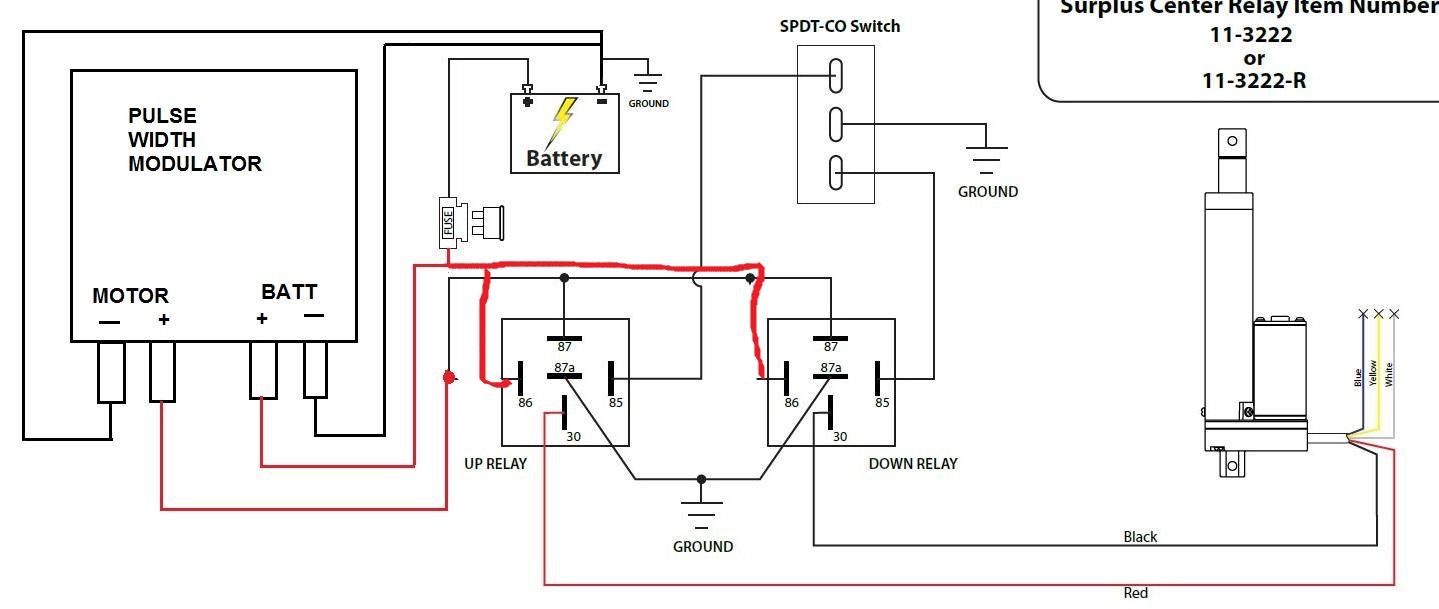

Well, back to the drawing board. I hooked it up as you showed, but still no love. Motor runs at full speed. I tried another PWM with the same result. I even reversed the terminals at 86 and 87 just to be sure.

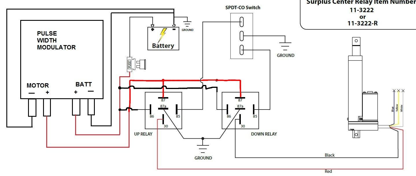

« Reply #5 on: June 14, 2016, 09:27:33 PM »
Are you sure that terminals 87 only connect to the PWM output (ie not to the battery) You should be able to measure the DC volts across the motor change as you vary the PWM.
« Reply #7 on: June 15, 2016, 03:46:06 AM »
Hi snub
Just to clarify make sure the control side of the relays are wired up like so .

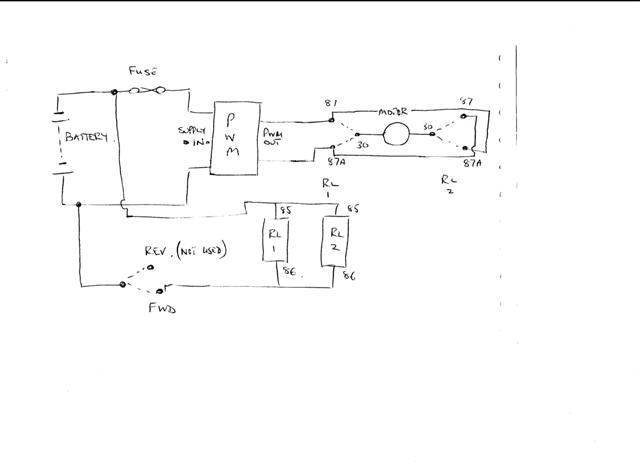

  • Posts: 2552
« Reply #9 on: June 15, 2016, 03:52:30 AM »
The coil is connected to pins 85 and 86, pin 30 is the common connection for the contacts on pins 87 and 87a.
Just wire up the relay contacts to give a double pole changeover arrangement.
The fwd/rev switch then acts to either energise or de-energise the relays giving the fwd or rev action,is another way of doing it.

I've just had a look at the circuit and it occurs to me that you've commoned the battery negative and the motor negative output terminals. Have you metered the these terminals to see if they are electrically common. I've a feeling that they won't be.

  • Posts: 2552
« Reply #13 on: June 15, 2016, 02:44:06 PM »
Snub,
See the attached sketch....
Hope this is simple enough for you..
I used a simple changeover switch to energise/de-energise the relays for FWD and REV

  • Posts: 2552
« Reply #15 on: June 16, 2016, 03:04:45 AM »
Snub,
I cant see how to make the drawing any simpler....
The wire connections are all identified by the numbers that appear on the relays....
The "rev-not used" simoly means that the second connection on my switch is not connected to anything.....in reality the relays are either in or off giving fwd or rev.
Might I suggest you get some books on basic electrics and have a read?
I'm always willing to help out, just ask if you're not sure..

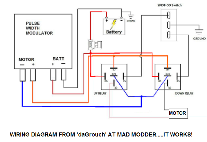

Offline daGrouch
  • Posts: 6
« Reply #16 on: June 16, 2016, 11:19:17 AM »
Separate the BATT- from MOTOR-  ( electronic circuits like to switch or act on the (-) for some reason).
Power the relay coils from BATT+ instead of PWM+.
Yeah, it looks weird at first glance.
With both relay's OFF both motor leads are connected to PWM- so nothing happens.
With UP relay ON the red motor lead goes PWM+ while black motor wires stays PWM- and motor spins.
With DOWN relay ON red motor wire remains PWM- and black motor wire goes PWM+.
CAUTION: I don't know how the PWM will like having the motor load switched or removed while it's on.

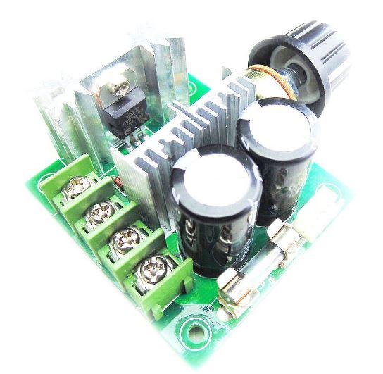

« Reply #29 on: June 16, 2016, 02:25:26 PM »
Thanks again for all your help. The PWM is just a generic brand from China, similar to the one in the picture below. I tested it by directly hooking it up to the motor and it works just fine. Like I mentioned, I also tried a second PWM in the first circuit diagram. Both failed to regulate the speed the way I had it wired. I'm guessing that the battery voltage was overriding the modulated voltage. I'm going to rewire it using the newly supplied diagrams and I'll let you know how it turns out.

« Reply #30 on: June 16, 2016, 08:57:57 PM »
We have a winner!!! First diagram I used was the one from daGrouch and it worked perfectly. Motor direction reverses as needed and speed control is perfect. No hiccups whatsoever. And so simple. Lots of smart people on this forum, I'm so glad I joined.
Just for future reference I have included the diagram from daGrouch.
