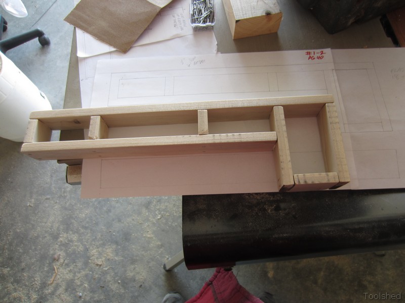

Ahh, the amount of "ooooo,look, another bunny" that goes on in my life is just insane....

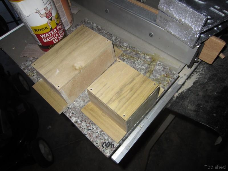

Anyhoo, got myself a couple nights of snuggle time with my shop tolls and got more done on my milling machine patterns.
Here was the first part done earlier this year.
First patterns are for the bed and bases for the machine.

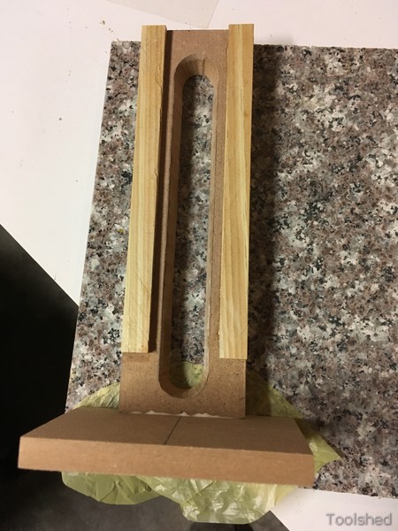

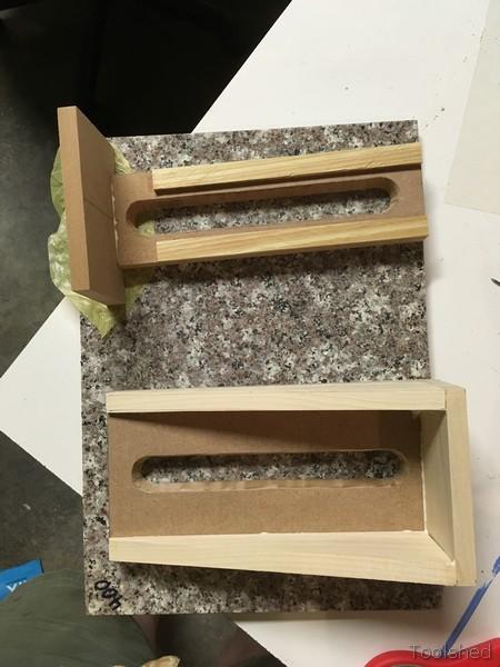

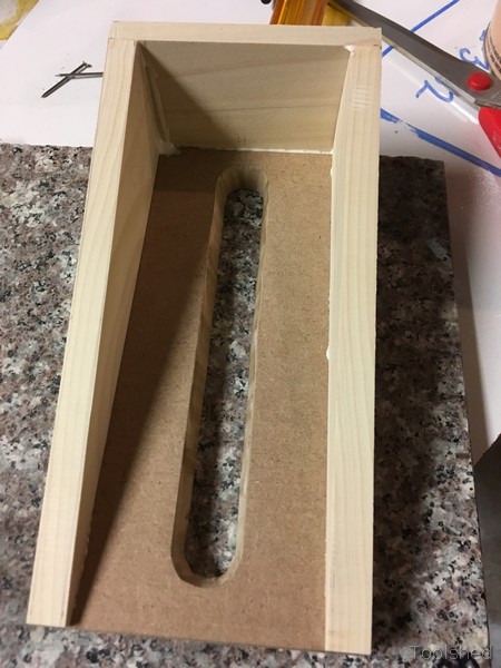

Next few are the headstand.  I wish I could trust MDF more, because the stuff is stupid easy to work and doesn't kill my sander belts!

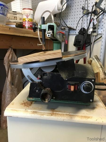

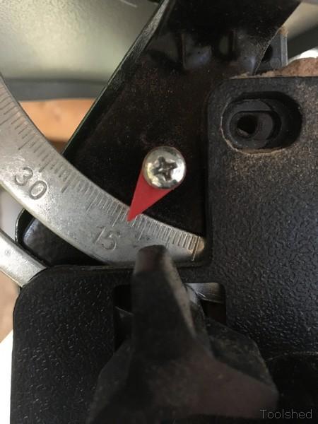

The headstand has a hole the length of the unit which is 7/8" on one side and 5/8" on the other.  I figured out the proper angle to set my scroll saw table at to be able to cut that angle within "spec" for me.   :)

Re: Toolshed's Gingery Milling Machine Build
« Reply #1 on: May 26, 2016, 11:43:25 AM »
I got the book....no T-shirt though.
I liked the idea of it, but found it limiting on fairly small pieces. Horizontal milling has it's benefits, but here it looks like a line boorer or a lathe with adjustable head stock.
I'm not completely sold by it's design. Therefore I'll be very intrested what kind of parts it can produce.
Very nice project though. I'll be following it.
Are you following the design as it is or are there any design changes planned?

« Reply #2 on: May 26, 2016, 02:24:03 PM »
No changes to what is in the book.  At least not at this time.  I have to admit, I am somewhat leery of the horizontal mill as well, but I figure it cannot hurt to have one.
Some might ask WHY I skipped the first three books.
1. I don't need to build the furnace.  I use a modified turkey fryer for the furnace.  Good clean, no fuss burner.
2. I already own a good metal lathe.
3. I made a deal with another person on another board (AlloyAvenue.com) for pattern exchanges.  He has already sent me the patterns for the Gingery shaper he built, in return I ship him the patterns for the miller after I am done with them.

The aluminum parts are rather beefy.  For kicks and giggles, I did a bit of a stress test on some of the flashing of one of my other castings and was able to put well over 30 pounds of pull on it.  That was all my scale would do.  Even at a few thou thick the flashing can hold up to a lot of pounds.
I have zero doubt that these machines are likely better than a lot of store bought.  My current table saw table is about 1/8" thick aluminum, same with the table on my belt sander and band saw....The Gingery tools are 3/4" thick in places.  These machines seem to be brick sh!thouses....'cept shinier and less stinky....
Not sure what you're referring to with expansion rates.  The steel ways are mounted with bolts to the aluminum castings.  They're never heated together....
Got another pattern made over the weekend, no pics yet.  Still have to shellac it.
