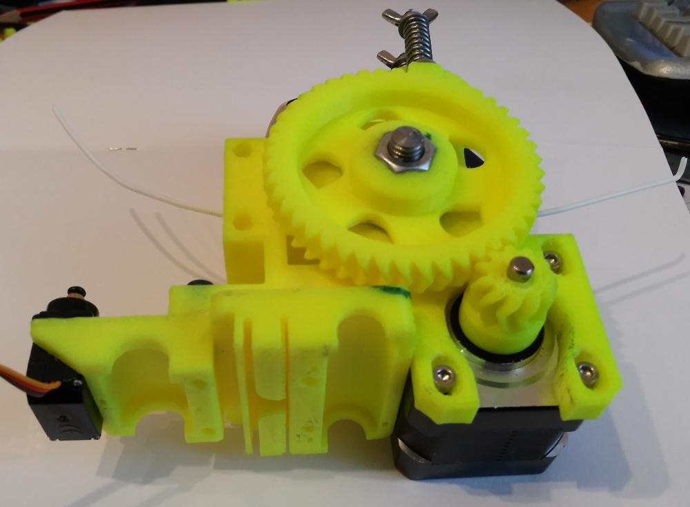

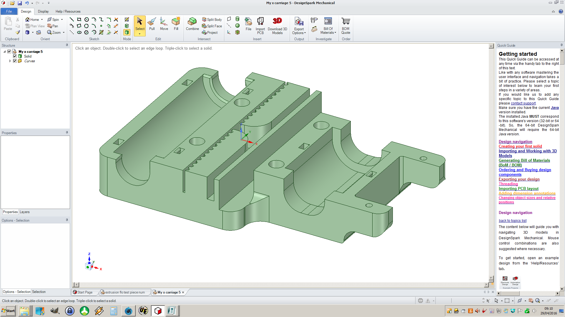

Thanks for your interest. I did get round the issue but it seemed a lot of actions to achieve a simple thing. I sliced the model into 2d mode around the correct place, inserted a 2D circle, removing the line above the surface plane, then changed to 3d mode and pulled it to the correct length. Somehow, this just seems wrong to me. I can create a cylinder and combine it but I don't seems to be able to combine it then subtract it to leave the impression of where it has been.
For the most part its an amazing program, very fast to learn and pretty easy to use. I am only a newbie with this program so a lot of the features I have yet to use. Generating text is a bit of a faff. Write it in sketchup, save as  sketchup version 8, then import into designspark and scale to suit with pull tool. Hardest bit I have found is then to get it to combine with the face the lettering goes on - probably missing a trick or two there.
Most complex part so far is a new x carriage for my 3d printer, piccy attached. Apart from my mistakes it turned out well.

You have several options when combining/subtracting objects with regards to what gets combined/subtracted, and what gets left.  An instruction MANUAL would help, instead of video tutorials in a language that I can't understand.  Play around with the instructions and you'll find the right object selection sequence in order to achieve your desired result.
If you haven't found it yet there's a checkbox, in the Properties section I think, that controls whether or not the objects are automatically merged after an operation.  Un-checking that sucker will make your life a lot simpler.  I believe that you can set that option up as one of your drawing preferences too.

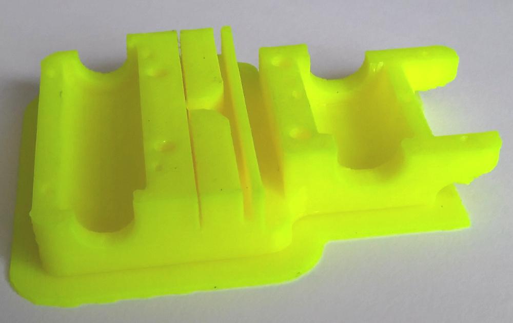

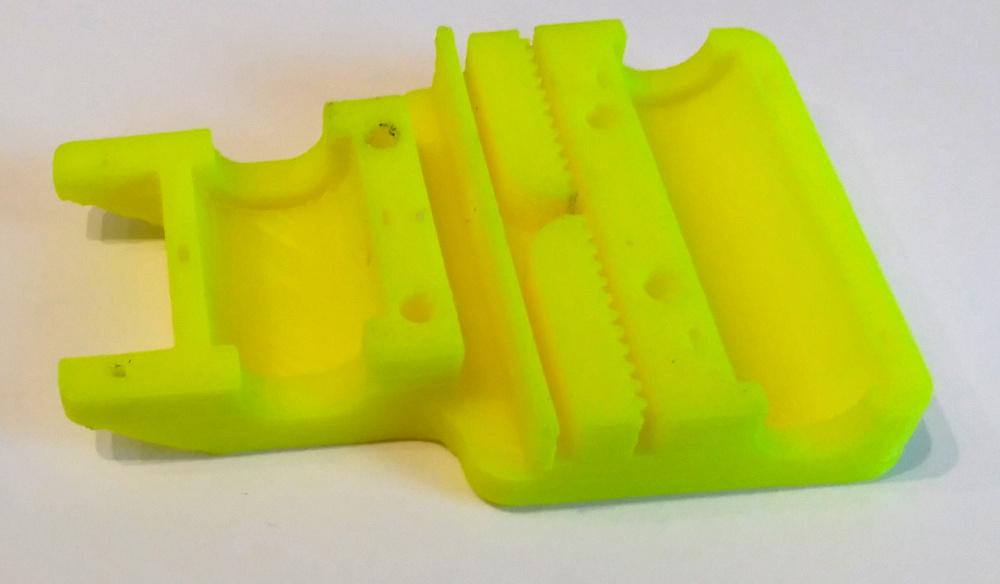

Yes I have printed it, three times in fact. The first time The lower part of the servo mount was a curved overhang with no support, and the slot for the GT2 belt was too small (X carr5 print). Then I discovered Cura 2.1 beta which allows fractional size adjustments. All my print sizes were too large by 0.15mm regardless of the length of the part, so it was a constant offset rather than a scale error. The new slicer allowed me to tune it out as well as providing overhang support which worked well, so that was iteration 2 (Mk2 aok except servo on wrong side). Then I offered it up to the printer and realised I had put the servo on the wrong side of the carriage  :wack:  So I guess that third time lucky (Extruder and servo) seems to have some truth.
