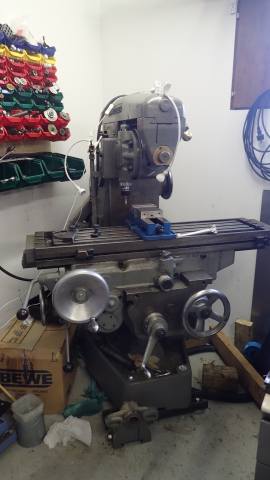

What is the mill Pekka? A knee mill of some variety by your description, but a photo and rough dimensions would help us cogitate your problem a little better.
Re: Portable milling/grinding machine for machine way reconditioning
« Reply #2 on: April 29, 2016, 04:07:56 AM »
Damn. I should take pictures...it is small knee mill, about 1,5 metric tons in weight. Originally horizontal mill, but it has a universal vertical head - no drilling pinion. Maybe 3kW motor, gearbox 8-speeds from 25 to 700 rpm or so...and clutch.
Table is about 1000*250 mm and all parts are heavy :lol: Table and it's mating part are the only dovetail guide, others are flat guides, some 100 mm wide. Table/knee and horizontal flat guide have most wear.
For a German engineering lubrication is funny and and it has seen use, first school, then truck "shed" where they probably forgot to lubricate it.
Coolant tank was shot when I got and cardan shaft for feeds too, but gear and coupling works well. I will not win prizes but will shift some metal even when it is worn out. Someone had spooked the sound of the flat belts (squeeelll- clonk-clonk-clonk) and I got the cheap...delivered. I bought a new endless belt and it behaved well.

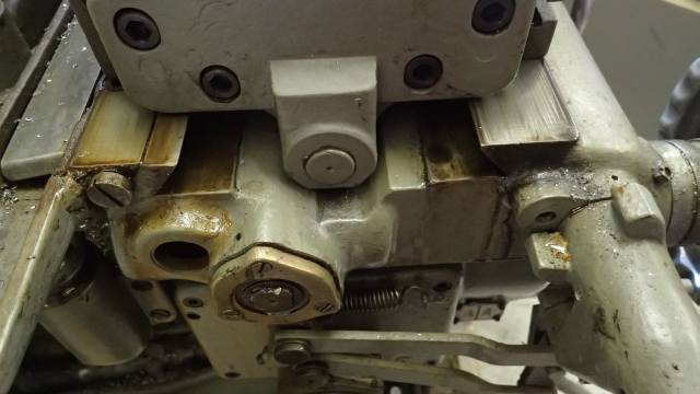

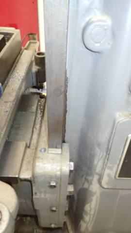

« Reply #3 on: April 29, 2016, 12:28:04 PM »

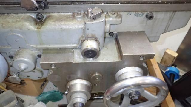

Compulsory pictures.
Biggest and most annoying wear is on X-axle, table/knee axis. Y-axis looks weird, but has little impact. Z-axis has a dip in most used place on back of it, where the knee is hanging.

« Reply #4 on: April 29, 2016, 01:59:50 PM »
Do you have a surface plate and straight edges long enough to quantify the wear? It is extremely unlikely that you can fabricate a temporary mill or grinder able to improve this machine. You are better off downloading the PDF of Connelly's Machine tool reconditioning posted here yesterday, hacking a cheap sabre saw into a DIY Biax, getting access to a surface plate , scraping it back in.

I my biggest surface plate is about 600*400 mm and another 400*400 mm. Then I have three camelbacks 400, 600, and 1000 mm. I have pretty good 600 mm straight edge and 1000 mm straight edge is in order.
Table is easiest and hardest....it has few original surfaces, machined that can't have any wear, because they are no bearing surfaces, but they are on the same plane than bearing surfaces. On the other hand, it has a longitudal dovetail, that is going to need some attention and it is not trivial to measure.
Knee is hardest part....it has Z-axis bearing planes luckily on on plane (or should have) but Y-axis bearing surfaces have offset by design and it is going to complicate measurement. Good news is that it just about fits on my big surface plate - I can verify it and then check it against the knee ways.
I can borrow longer straight edges of varrying (known accuracy).
I will not try to attemp of scraping to shift the most of metal, there is simply too much of it.

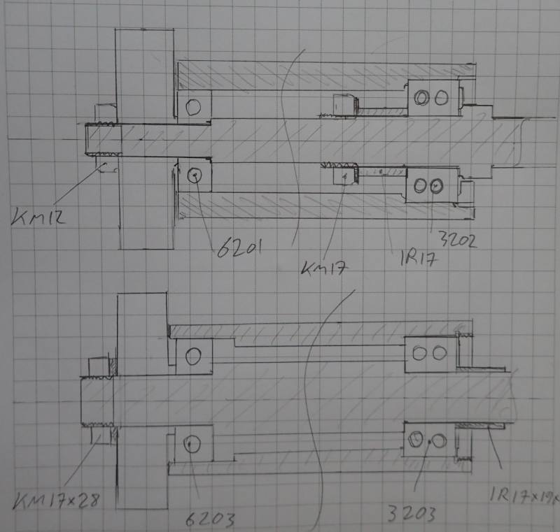

Huh! That is a big plan. Very nice to read on how differently people approach different problems. Hope to hear more from that project progress.
I have been doodeling on paper some spindle designs. Goal is to make a simple spindle that will allow a little of axial and radial grinding.
Basically I need a fixed bearing near grinding stone and free bearing near pulley at the other end of the shaft.
I considered first classical pair of angular contact bearings, but very few are offered with any dust shields. I'm setling on dual angular contact bearing with 2RS shields, this I might just get away with the loading and RPM I need here.
I draw two slightly different basic designs, which one is prefered and why?
Is there better, easy to make design?
* Addition: The square on very left is a polyvee belt pulley - free bearing end - ball bearing. Grinding stone will be on right hand side (not drawn) on locating bearing side.....just to clarify my doodle.
Thank you,

I'm thinking on using fat shaft design....toss of a coin. Grinding stone on right next to double angular contact bearing and poly-vee belt on left to load the free tail bearing.

Does a surface grinder really need the thrust control of paired AC bearings? My Clarkson T&C grinder only has deep groove ball bearings. Since you are grinding a surface, with no precise shoulders, I'd think you only need radial stiffness, and could make the spindle more simple.
Mark
Mark
« Reply #40 on: June 01, 2016, 05:33:36 AM »
Flat surfaces and there would be no problem with deep groove ball bearings. Or even with bench grinder that was suggested before and I did consider it.
However: I have dove tails to grind too and they probably will not be done in  one go. Another sightly problematic surface is back of the vertical. only way I can imagine reasonable size grinding wheel there is a cup/face type wheel in reverse. I.E. I might need radial and axial loading in both ways. I tried to resist the latest one, because othervice I could have got away with two opposing angular contact bearings, tail one spring loaded. Pretty much same than Quorn type grinder, GREAT BOOK BTW.

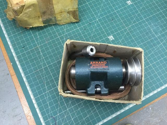

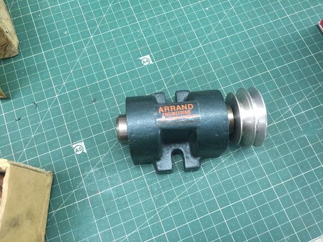

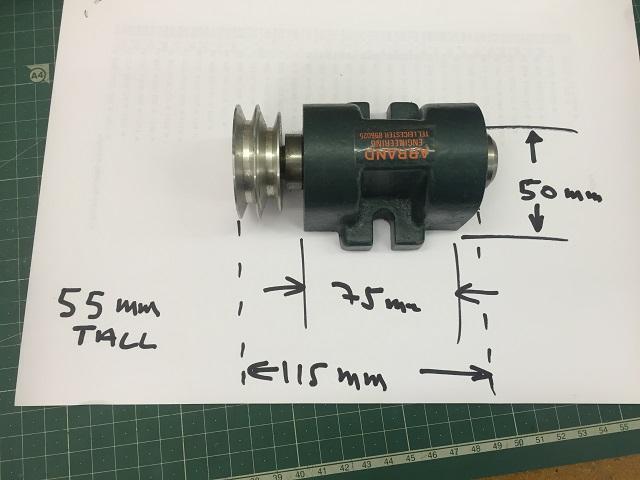

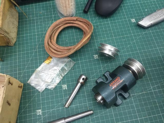

Pekka,
I have been having a clear out and an Arrand spindle has surfaced - I've had it donkeys years but it is brand new in its box complete with two MT adaptors, a drive pulley and even the belt and belt joiner to drive it.
Before I put it on ebay is it any use for your conundrum?
« Reply #48 on: June 08, 2016, 11:42:26 AM »
Andrew, That looks about right size and all (providing that cutting mat has metric graduation, not imperial).  I remmember that brand poping up in UK mags -90s.
Is it made for grinding or does it has other uses? The draw bolt on taper hints for milling. Is that MT taper or something special? Need to device something to clamp the grinding stone and 180 mm dia, 20-25 mm width seems to calculate close to keep all simple.
Bearings might need changing, it's probably imperial?....but bearing boys is as close to me than it is to you.
Looks about right. Care to take aproximate lenght and width, by eyeballing is not calibrated.

« Reply #49 on: June 08, 2016, 12:53:13 PM »
Andrew, That looks about right size and all (providing that cutting mat has metric graduation, not imperial).......Pekka
Pekka,
I think they're 10mm squares on the cutting mat - some pictures show where the corner of an A4 and an A5 page would go; they are a little bit more than 6 squares apart in one direction, and about 8¾ squares in the other direction - so I reckon that's a pretty close match for 10 mm squares as A4 is 210 x 297 mm, A5 is 148 x 210 mm which would be 62mm difference x 87mm
Dave M.

« Reply #50 on: June 08, 2016, 01:09:20 PM »
Pekka, I think Dave is spot on but I'll check absolute size next time I crawl over to the workshop. The bore is 1MT
Just at the moment I'm recovering with a can cans of Old Speckled Hen having been squirting unbelievably expensive vetmeds down lambs throats (£150 for a 1 litre bottle  :bugeye: ) against coccidiosis. They didn't want it to happen and are amazingly agile and fleet of foot.
The later Arrand spindles called themselves 'milling and grinding' spindles. The only difference apparent is a lubrication fitting screwed in the side !

Here's a C o C of the spindle for your delight and delectation

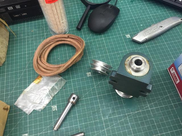

« Reply #53 on: June 20, 2016, 05:21:01 AM »
Holly crap, does word "Myford" 10x price immediately?
Had a quick look at it. Feels like never used and grease is not gummed up. I was prepared to change the bearings first, most of the greases has self life less than 6 years.
The spindle is that small that I got an idea on how to grind the upright body ways on far back, there is very little space for anything but that seems to do it if rigged bit unorthodox and when using small worn grinding stone.

I'm still using the mill, but it prevents me doing anything accurate. I still have some time, this could be my winter project. I don't want to pull the mill apart before I know what to do on and on which order.
Looks like pretty much all lathe DIY regrinds trust that parts of the ways are not worn and can be used as they are for regrinding.
