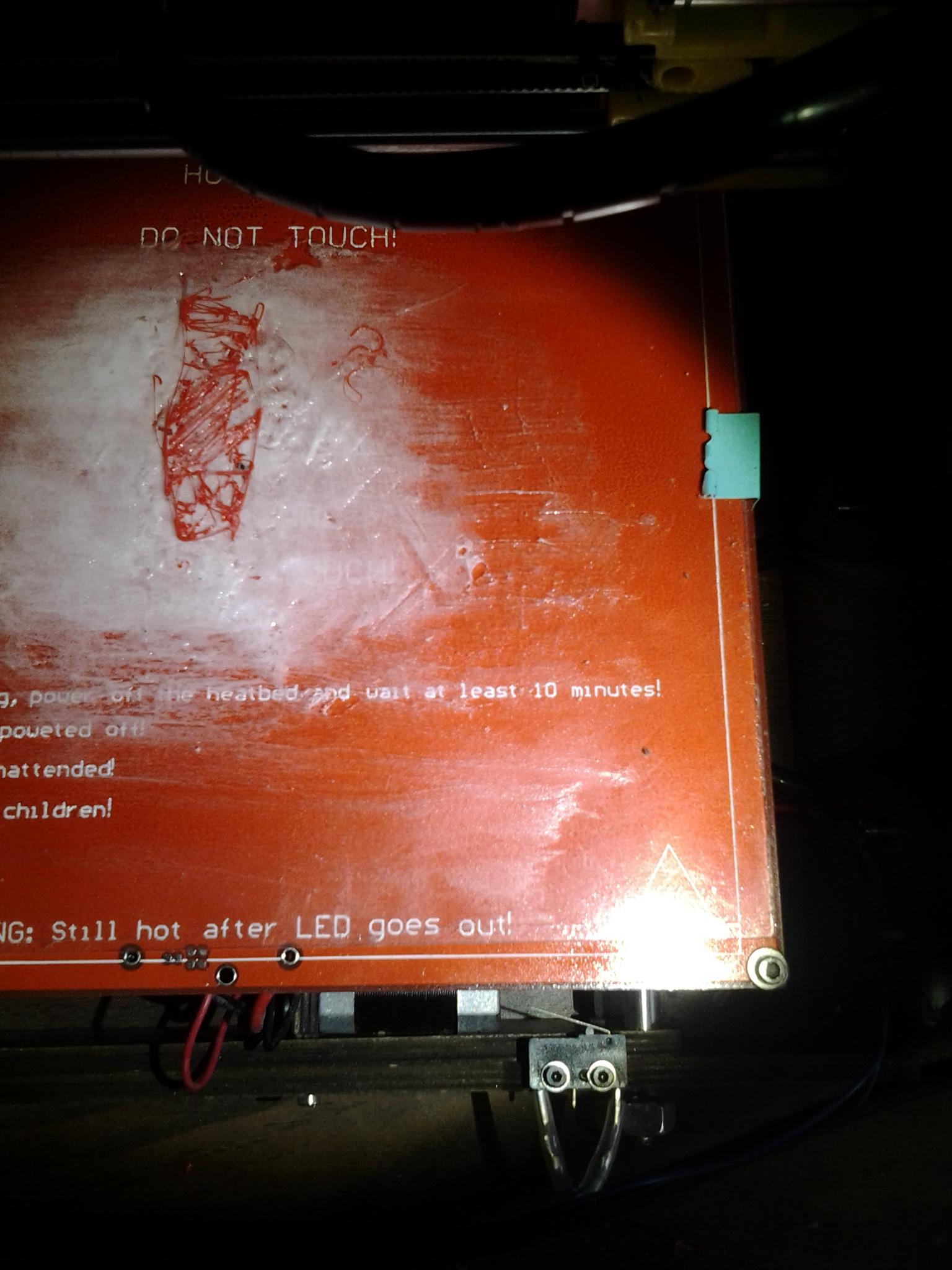

Hi Joules here's a bit more info. Once the bed was levelled I adjusted the nozzle so a piece of paper just drags from under it at all 4 corners and the centre. (this was with a heated bed approx. 68C). The robot sample was average but when I went to print the whistle....well here's the result. It also fails to stick to the bed regardless of the glue method both Uhu or hairspray and even tried without adhesive as suggested by a few others. I stopped it after the first layers as it was not doing the fill in . I added the picture so you can see what it is supposed to be as we can't send stl files. Its using the marlin firmware I believe as it seemed to be the default though there are a couple others 1 of which is Reprap volumetric but not game to make changes as yet, if it helps

First observations....
Pete, way too much glue, you need a film rather than a pool.  Get some genuine 3M blu tape, clean off the bed, apply tape where your going to print and clean tape with isopropanol.  Now set your print head, but to the surface of the tape (paper clearance as before). This is your new datum.  You now want to print a 1-2cm cube, solid or open topped shell.  You will be printing a LOT of them to fine tune the printer.
It doesn't all look bad, your extruder is working and the filament looks fairly even, no really thin or thick extrusions.  Your base layer fails as it hasn't anything to bond too.  The glue you have is too flexible, like printing on foam rubber and it's dragging on the print head.  You maybe under extruding, for the fill, or your step over is too large.  You need an amount of overlap to weld each line to the next and weld to the perimeter.  However till you can lay down a good foundation it's all guess work.
Show me a test print with no glue on the bed.  Let it build up a few layers deep, even if the print slips.  If PLA try using a bed temp of 40 C,  67 C is way over your glass temperature for PLA.
I should also ask what filament you print, ABS or PLA.  Do you print a border on your first layer to prime the print head, this is pretty important especially on small prints from cold.

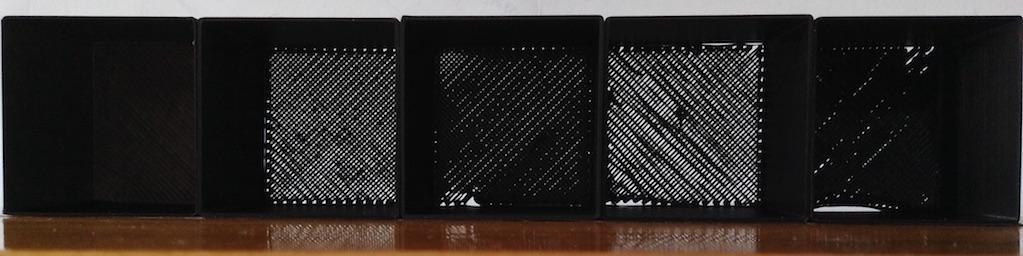

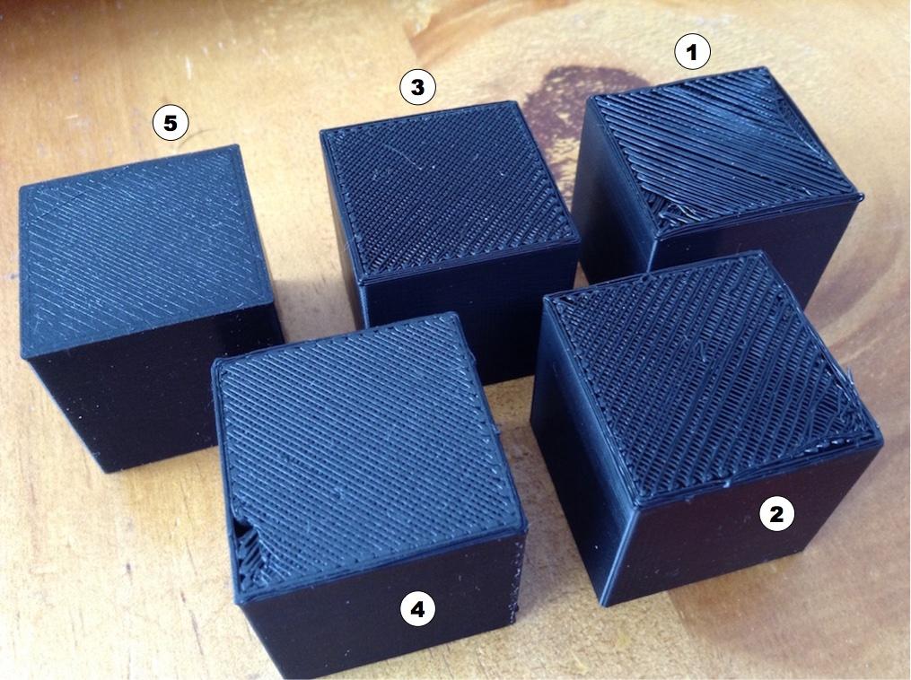

As it's relevant to Pete's issue I post an image of the cubes I used to tune one of the Mini Kossel printers, they are numbered in sequence, the Z issue was resolved by number 2, number 4 had an issue with over extrusion during a hard turn and resulted in some blobs down the edge.  A tweak to slow extrusion on deceleration, or direction change solved that, depends what your software allows to be tweaked.
Second picture looking into the cubes so you can see the bottom layer, they are numbered 5-1 left to right.

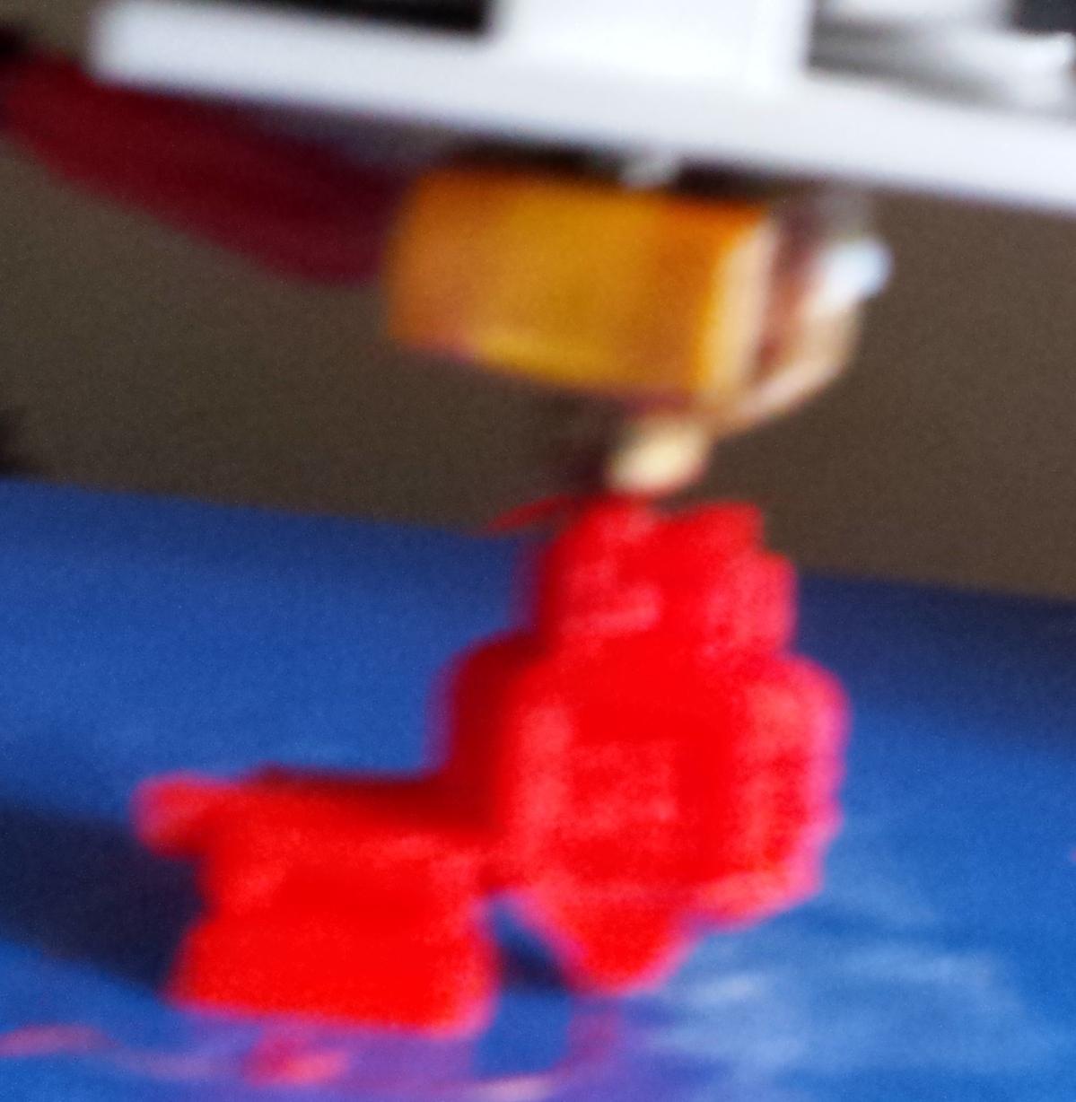

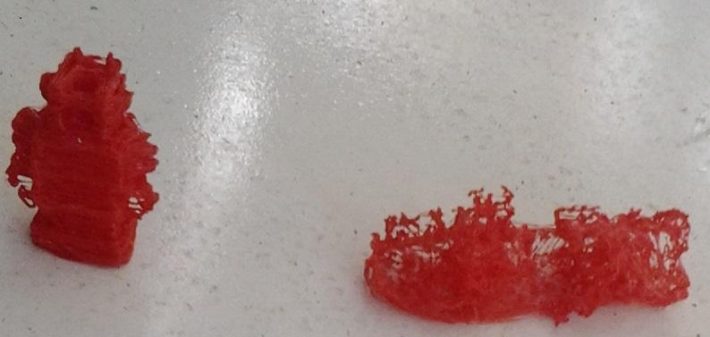

« Reply #9 on: May 01, 2016, 02:04:57 AM »
well here's last nights attempts as requested. I got a reply from the supplier of the kit and suggested floor temps between 60-70C and I found 64C was the temp when it stuck but well the pics explain it all. I'm about to check the feeder in case that is the cause as it seems to be lacking filament output in my view but open to correction.
The glass supplied is borosilicate so handles higher temps no problem....a small win there. Once this is running right I am going to re-engineer the unit and make it less flexible though its not too bad I think I can improve on it a little. I have been given a sink cut out about 1.5 inches thick which I will make my base from and with aluminium angle and Perspex for the enclosure it should be solid enough.

Ouch !!!
        Pete that is just nasty.....   Has your hot end got a blockage ? It looks very much like interrupted feed.  Does the hot end have a ptfe liner, it could be damaged and trapping the filaments free movement.  Can you extrude an uninterrupted filament with the head above the table.
      :bugeye:

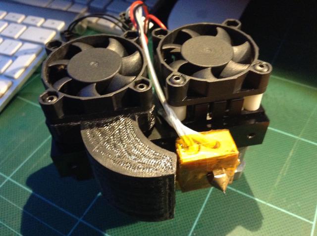

Is the filament extruding straight out or curling back onto the head.  Pictures of your print head would be good. Have you calibrated the extruded for outputting 100mm of filament, it would then be worth extruding 100mm worth out the hot end to confirm the extruded is really pushing the full amount of filament out.

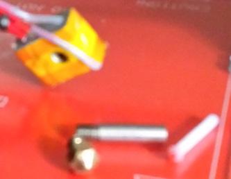

Hi Joules yep the hot end has a ptfe liner. I will check it tonight. I was thinking something is blocked but wanted confirmation before I pull it down. I may try a longer filament run before it starts to print to see if it helps. Just how deep is the liner supposed to go? All the way to the nozzle or just short of it? I replaced the original liner as it was damaged when I got the printer but the supplier sent me a 3 foot piece so I just guestimated it and I think it goes into the nozzle which may be the problem at least now I'm starting to think it may well be.

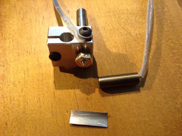

  • Posts: 1319
Re: A kit 3D printer
« Reply #13 on: May 02, 2016, 01:29:22 AM »
Depends on the design of the print head, the ptfe should end at the top of the heat block as you would want the filament in contact with the heat as best you can.  That doesn't mean it couldn't extend to the nozzle, but it's not a good idea.  The ptfe should be cut as square as possible. If you see feathering of the edge, hot or cold end it's likely trapping the filament.
If you can put a drill shank in the ptfe and cut with a razor by rolling the ptfe, this will avoid uneven cut and the chance of picking up the filament.  Cutting with snips or scissors is a bad idea.
Be good to see a picture of your ptfe tube when taken out of the head, and the head components when they are apart.  I had this problem early on with the Rostock Max before changing to an E3D print head.

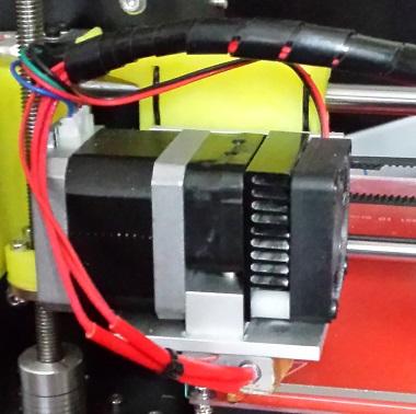

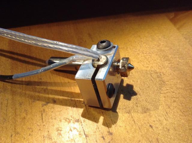

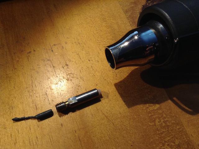

Pete, I had the same hot end and extruder assembly on my Createbot Mini.  Yeah, a loose heat block, nozzle will drop the the nozzle pressure tremendously, leading to under extrusion.  I Changed  out the hot end for E3D components, but tightening what you have will be a good starter.  That internal ptfe tube caused me lots of issues too.
  • Posts: 1319
« Reply #21 on: May 05, 2016, 01:36:46 AM »
The above show an example of blockage I could suffer due to the ptfe failing. All the E3D parts can be machined, they provide the drawings to make them, but I like what they have done, so support them by buying the parts.   I needed some beer tin shim for the existing heater cartridge to work. and sleeve the heat break tube to do away with the ptfe completely.  Look at E3D's design, just leave a little more meat on the heat break tube than they do, as ours is an unknown material (should be stainless) and may not be as strong.
