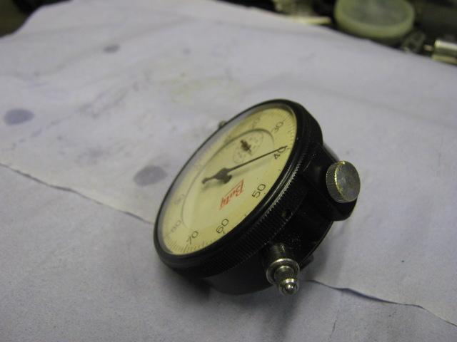

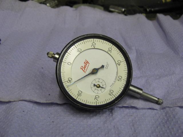

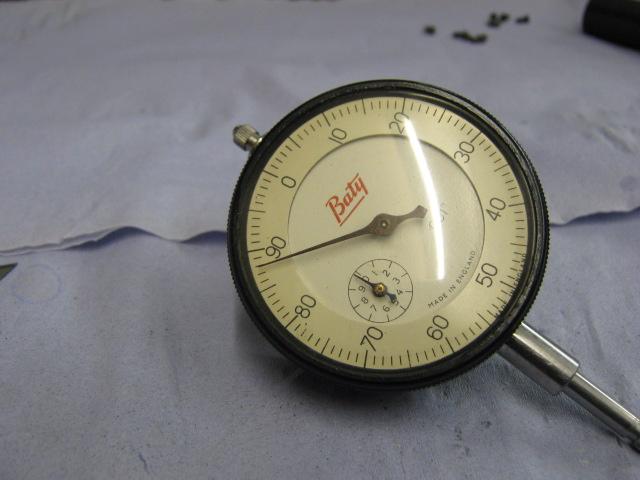

hi all not posted in a wile as I ant had any to do any way this D.T.I belongs to sum one john knows in all the D.T.I is in good order the mane problem was with the lenses as it had shrunk with age and was falling out  the way I fix this problem is to put the lenses in hot water and place a heavy wat on top to flatten it out a bit but I gave the D.T.I the bob's touch to  right pics

Quality work as per usual Bob, it will last many more years now  :thumbup:

Without a doubt, a master of bringing these back...

The lens fix is a new solution to me. I have an old indicator which I got from my dad and the lens keeps falling out. I will try the hot water and weight method, Thanks for the tip.

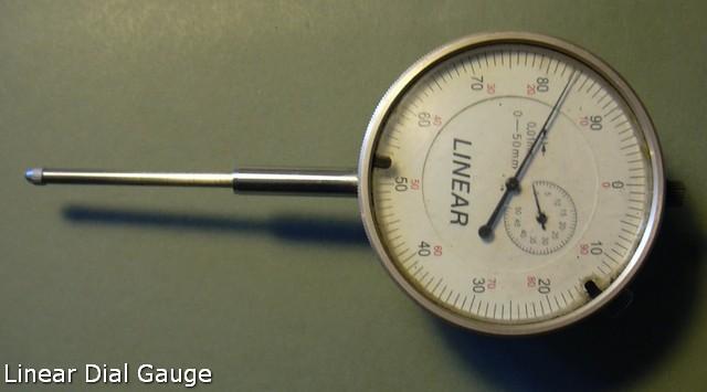

Hi there, Bob,

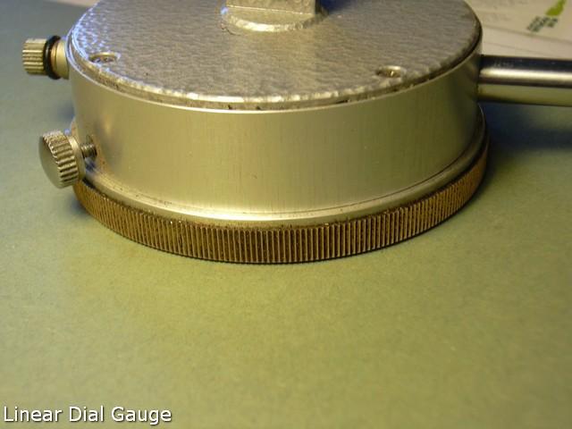

Please can you help me out with a dial gauge problem?
I've recently bought several poorly dial gauges with the intention of renovating them with the benefit of all the hints, tips and examples you've posted in your Mad Modders threads.

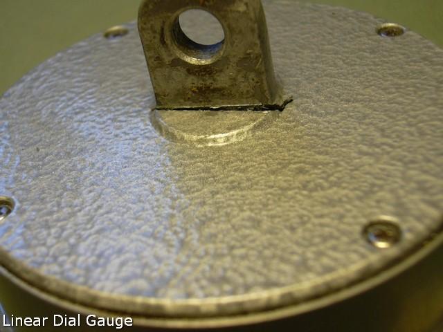

One of them is a long throw gauge made by Linear.  I'll try to attach a few photos:
Well, I tried but failed!!!   :bang:   :bang:   :bang:

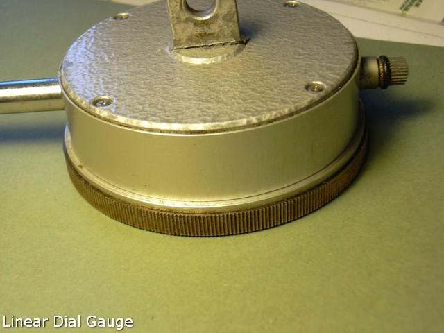

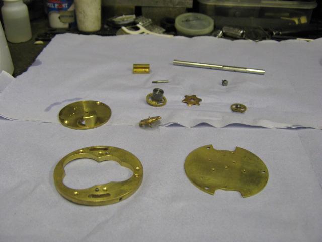

So, back to my problem.  The outer dial of the dial gauge (inside the crystal) isn't revolving when the bezel is turned.  I figure I need to remove the bezel and crystal but I can't see how to do that.  Should I get brave and try levering it off with a kitchen knife?
I have another gauge that has a hole in the side of the bezel that allows access to four grub-screws when the bezel is turned to the right positions but there's no such feature on this Linear gauge.  (That gauge has a loose crystal - Bob's already told us how to tackle that problem. )
The second photo also shows that the lug on the back-plate is damaged - that doesn't bother me as I intend to hold the gauge by the stem behind the moving probe.  I could remove the lug altogether and fill the crack with epoxy.

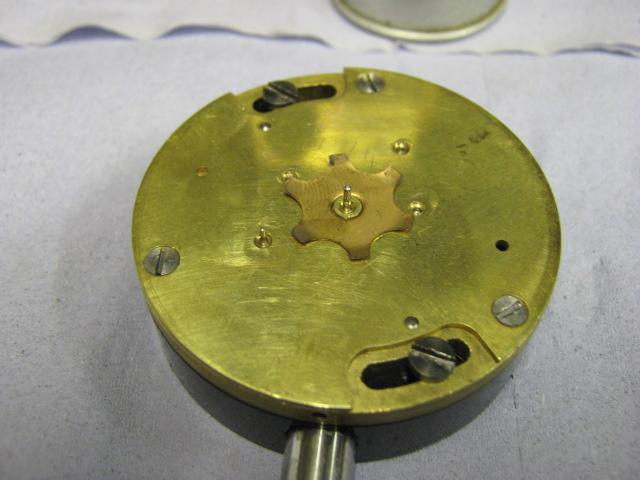

hi no you don't need the kitchen knife if you look at the diel you will see two indicators i.e. them two black pointers that you adjust to set the maximum and minimal needle travel in pic 1   remove them and the lens will drop out on the inside of the bezel their shod be a bit sticking out  and on the diel face their shod be a notch for it to locate it thus when the bezel is rotated the face will move with it if you still have problems you can all ways post it to me and pay for the post back   its best to fill any holes i.e. if their is a screw missing put one in  and in your case remove the lug and fill as you say with epoxy the best meth herd  I yous is on the inside put a piece of  masking tape  over the hole and then fill from the front as sum backs are resest  on the inside and this makes it hard to sand dawn the filler

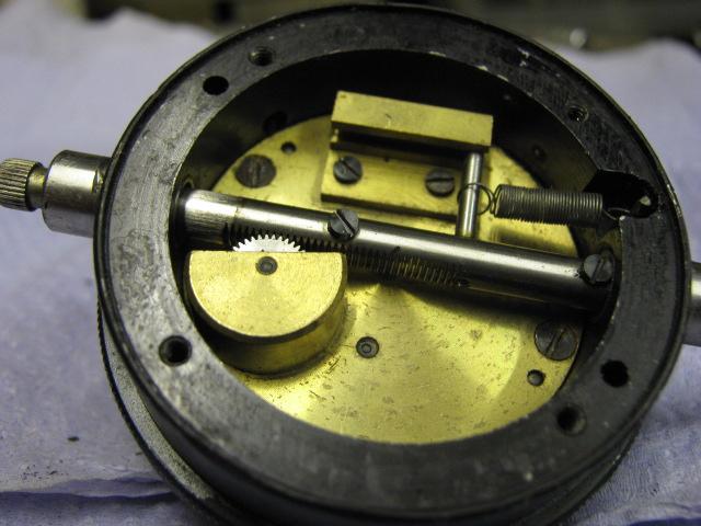

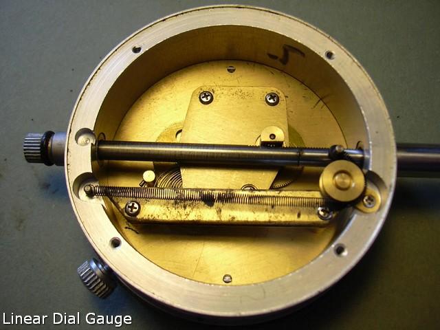

The linear gauge isn't cooperating!!  I've tried to pull out the tolerance tabs but they aren't shifting.  They started in close contact with the crystal and I gently eased them up with a Swann-Morton knife just enough to let me get a hold with a small pair of needle-nosed pliers.  I then tried to pull them out from the groove, as one would remove an internal circlip - no joy.  I'd assumed that each tolerance tab would be on its own part ring but when I looked with my loup I can only detect one ring.  So I've left that one for now.
While I was at it, I removed the back and inspected the interior.  There was a ring of light oil around the seating face of the back cover which I removed with blue paper towel.

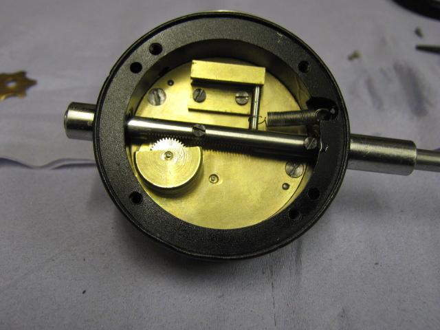

For interest, I've attached a photo of the innards - well, actually I've attached it because, now, I can!   :lol:   :lol:   :lol:

« Reply #14 on: April 07, 2016, 05:46:37 PM »
hi one indicator ring sits on top of the other one they don't sit in septet grooves you have to remove the top one first to remove the bezel completely if you look at your last pic you will see two holes one at the top the other at the bottom if you look you will see a silver like pin its not a pin its a spring you need to move it inwards this pulls the spring out of the groove in the bezel as for the lens you mist a bit   it just needs to be hot not boiling put the lens in and wile in the hot water put the wate on top  and level it in till its gone cold the wate I youse is a 1/2 pawnd of a set of kitchen scales don't panic a bawt scratches  T cut polishes them out
