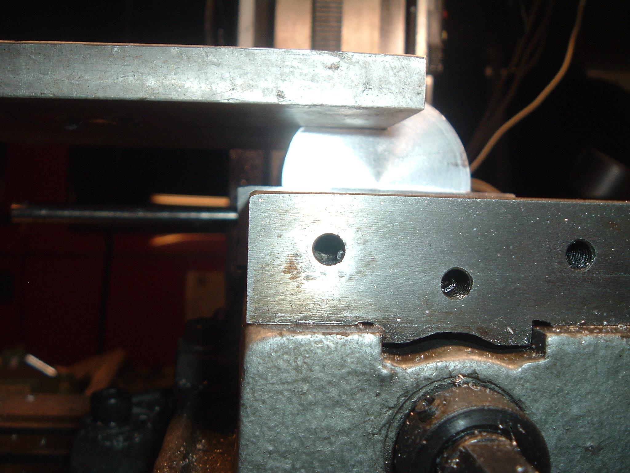

« Reply #7 on: April 08, 2016, 02:37:53 PM »

Quick and dirty, eh? How about a piece of aluminum plate bolted to a piece of 2" round aluminum bar? Can be held in the vice on your mill, and set at any angle with a protractor. The table was set into the bar so I could rotate it 90 deg. I was still working on it when I took the pics, so surface is a bit rough. I was experimenting with flycutters. I have since smoothed the table and drilled a pattern of holes for clamp screws. I don't use it every day, but it works when I need it.

Well, if you only wanted 0 deg and 90 deg... You have the mill table and a standard angle plate to accomplish those positions. What about 30, 45, or 60? Or anywhere in between?
The round bar has a step milled in it equal to the thickness of the plate and aligned with the center axis. You set the round bar in your vice and the plate rotates like a hinge. Tighten the vise at the angle you want... Capish?

Maybe the pictures I posted are confusing. The one of the tool in the vise was the setup I was using to flycut the plate. I posted that picture to show the inset of the plate into the round stock. It could be used in that orientation, but the true 'angle plate' use would be with the round stock held 90 deg to that shown. HTH!
