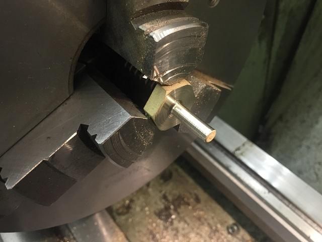

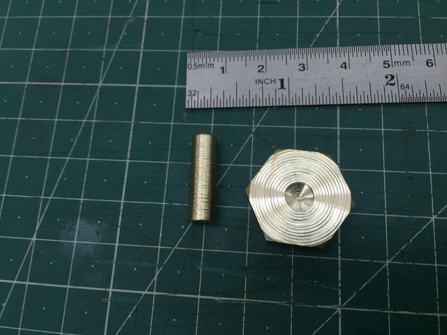

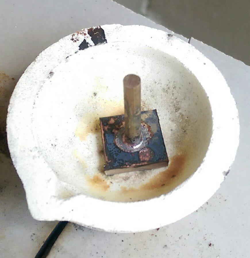

The 'Heating and Ventilating' chaps when installing air conditioning use a phosphorous copper alloy that needs no flux. I got some years ago when I was making up fittings for my 100 kW induction furnace that needed water cooling pipes plumbing in.
I was sure that I still had some, so as I had a break between lambs arriving this morning I thought I'd do an experiment with it before I recommended it to you - so here are the results.
The stuff I have is 'Harris Phoson', but there are many brands of the same thing:
http://eu.harrisproductsgroup.com/en/Products/Alloys/Brazing/Phos-Copper/Phoson.aspx
Not having 1" brass stock nor 4 mm bar I sliced a bit off a 20mm hexagonal bar, and also turned a 1/4" hex brass bar down to 1/4" round and cut an inch off the end. Then I drilled a small recess in the 20mm hex for the 1/4" round to sit in to give it a location.

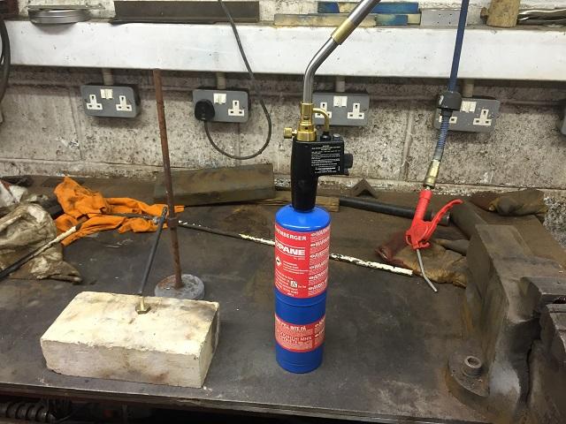

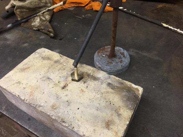

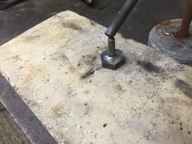

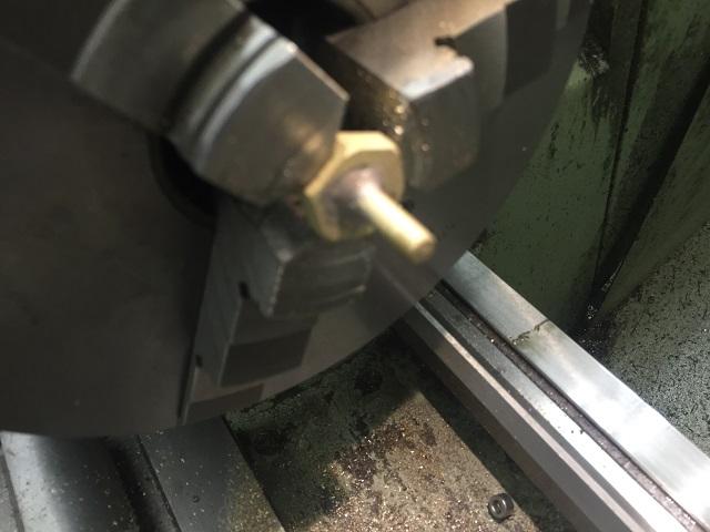

Then with it sitting on a fire brick, with a carbon rod balanced on top to stop it blowing away, I heated it with my Rothenburger propane torch and applied the Phoson strip to the joint on the far side away from the flame. It flowed nicely but I put far too much on!

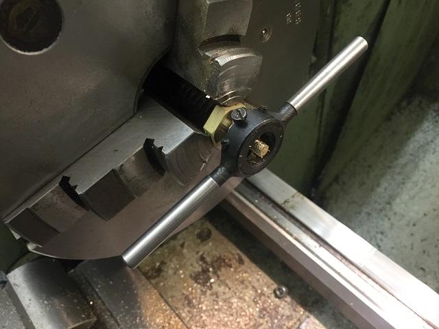

Then I cleaned it up, and to prove that it was a sound joint, mounted it in the lathe, skimmed the rod down to 6 mm and ran an M6 die down it.
Re: First time brass brazing
« Reply #13 on: April 03, 2016, 06:27:12 AM »

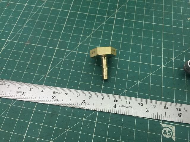

Now the point of the exercise was to show if only a slight location dimple was going to give enough surface area for a sound joint. And it was. The forces on the 6 mm bar when turning would have broken off an unsound joint, and then running a die down it would have been the last straw.
But the fact is it is a very sound joint - so yes I recommend this Phoson stuff as very easy to use. However I do vaguely remember a caveat from years ago not to use it in steam boilers  - can't remember why.

Probably worth noting that I deliberately did NO cleaning of the brass before brazing - it was straight off the lathe. So although it was fairly clean it would have had some oil on the surface

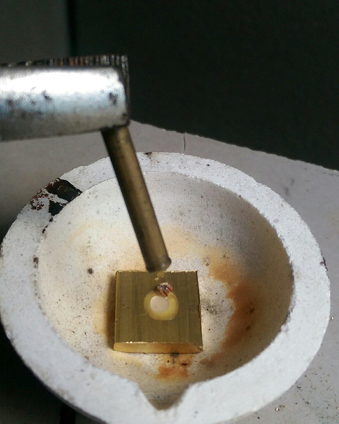

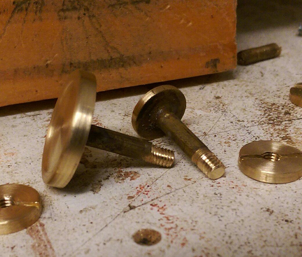

Had some time to try again on the weekend, and it worked much better this time.  I used the original flux (with a good stir to make sure nothing important was settled out.  Drilled a location hole in the 'head' of the bolt, and also ground the end of the rod to roughly match the shape of the hole.  I brushed in a drop of flux to the hole and to the end of the brass rod, and cut off a small piece of brazing rod and threw it into the hole from the start (you can see it in the first photo).  I also managed to find some 15% silver rod at bunnings, so I used that instead of the 5% silver.  From there, I heated the whole think in a small crucible.
Last time it was taking several minutes to heat up, but this time it was much quicker.  I think using the crucible really helped to reduce heat loss, and cutting off a piece of the flux was a huge improvement, compared with trying to bring the rod in with my third hand.  It meant that I could hold the brass rod in place with one hand, and hold the torch with the other hand.  After about 15-20 seconds, it was up to temp, the rod melted, and pow, beautiful joint! I made a few crooked bolts on the first try, but a quick reheat allowed me to move them straight again.
Thanks for all the help and recommendations, and a special big thanks to awemawson for the photos of the whole procedure and great tips!  You guys rock!
