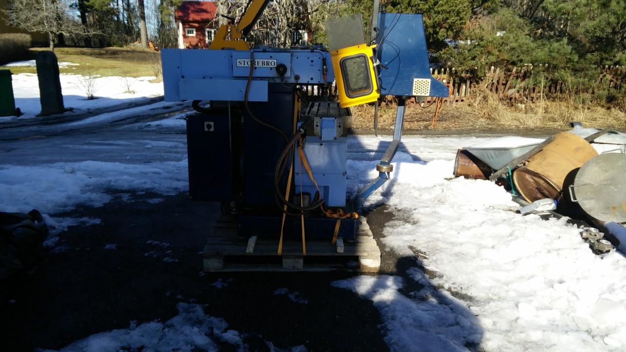

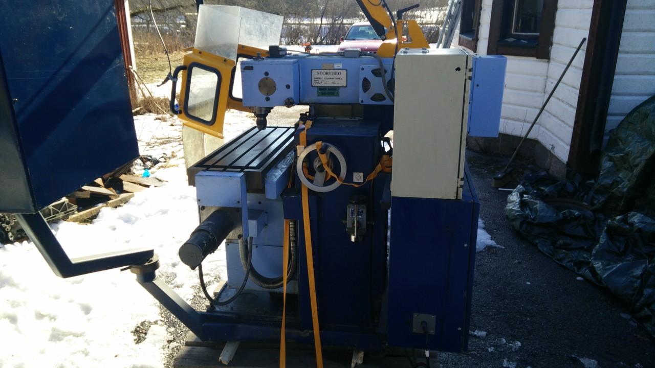

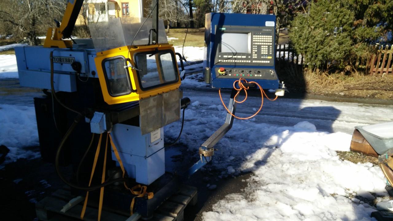

So i have went out of my way to get my dirty hands on a CNC machine. This piece of kit ended up outside my house today. It's a 1991 , Storebro Combi-Mill, that is running Siemens Sinumerik 810M GA2 - its not the newest system, and i will need to find me someone that can help me get going. I was first thinking of converting this to LinuxCNC, but this control system is new enough so i think it can handle some intricate 2.5D at least.
It can do 3 axis interpolation and have ridgid tapping built in.. so its promising. I fi would wanna go 4 axis tho, i would need to change it out to a LinuxCNC - this mean tho my gear for the polymerconcrete machine is still intact. and this will help me build the parts for that bigger machine. (yeah i like machines).
I anyone have experience with this control system or know how to dripfeed it from a PC.. please post here or send me a message.  =)

Yeah the Aciera will be up for sale. There is alot of stuff to it tho. And the biggest hassle will be getting it out with a 1500kg cnc in the way :D
I shall get back with photos of my shop that has become a bit.. crowded.. just a bit...
I got it started yesterday as welll tho, and i'm a bit confused now. The machines saids -91, the manual says one system, the screen saids a system from a -95-98 machine (GA3 version) and some damned overheating circuit is kicking in directly when it starts.. so something is up..

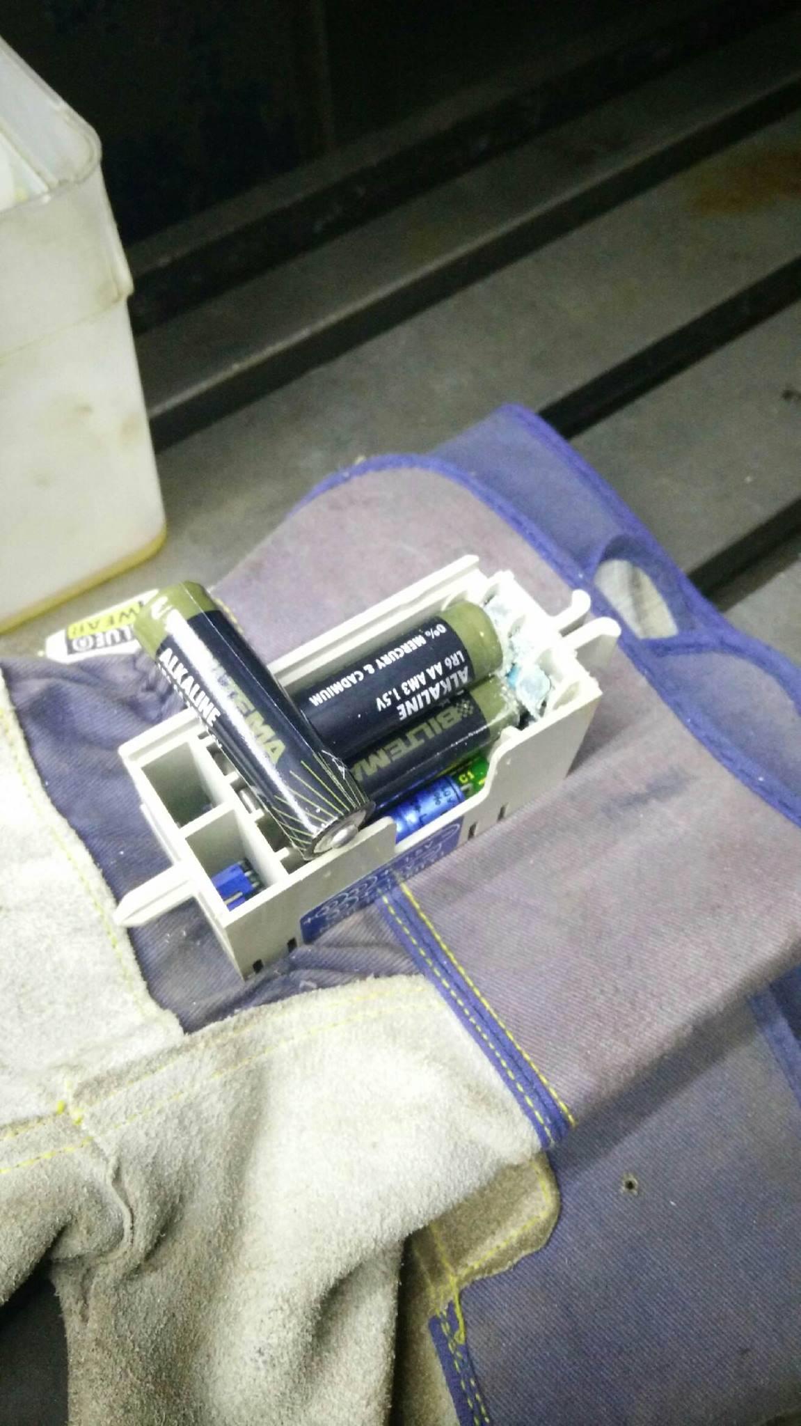

« Reply #5 on: March 14, 2016, 01:57:57 PM »
So i found the.. ehm.. battery holder..
I don't think the battery has been changed in.. well say 8 years.. holy hell..
So well that took care of the overheating error.. but well. the buttons still don't work as intended.. all the settings for the machine is gone.. And well the manual is not the correct one for the machine. The manufacturer has gone under so many times it's just stupid. No documentation can be found basicly..
Well.. and buttons don't do what they are supposed too..
So.. ripping the sinumerik out of it and do a linuxcnc ??

Ah yeah i'm a avid user and member of elektronikforumet. There is several of us having combi mills. thats why i choose it.
But some history. The Combi Mill is actually a manual mill that was bought in bulk from a small company that made CNC machines out of them from readily available control systems for the market at the time they were ordered. So every machine that rolled out is numbered. Because every machine is different. And i have had contact with the elder gentleman that originally made my machine back in -95. And he have told me that without the original manual (that i dont have, i have a manual from a different machine). There would be no way to reproduce the settings for my specific machine.
The company that made the base machine has gone belly up like 6 times over the last 40 years and so has the cnc converter business. =)
Because everything needs to be entered, down to the parameters for the servo drives and motors. And they differ from machine to machine.
I'm actually considering stripping the machine from this control system and sell the parts off. And get something else or just the easiest route would be LinuxCNC. =)

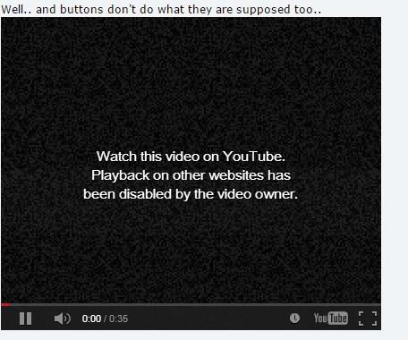

Well if you see my video clip, there you will see that the MPG panel isnt working properly. Buttons isnt conjuring up what it should. So step 1, find and replace the MPG module so it doesnt change ascii output on every reboot. So one could actually enter something into it. =)
  • Posts: 9050
Re: Storebro Combi-Mill CNC.
« Reply #11 on: March 14, 2016, 05:46:41 PM »
We CAN'T watch your video as it says watching has been blocked by the video owner - which is presumably YOU  :bang:
« Reply #12 on: March 14, 2016, 06:00:47 PM »
Andrew,
Just click on YouTube at the bottom and it will open the video in a YouTube window.
  • Posts: 9050
Offline NeoTech
  • Posts: 826
    • Roughedge Hobbyworks
« Reply #14 on: March 15, 2016, 03:56:46 AM »
Oh sorry its by default no embedding on my profile.  *clicked* so fixed. =)

Yeah i have found, and printed most of those. The biggest issue is to get hold of the DC motor driver and servo parameters. And being able to punch the data back into the system atm. If i can get around that the panel has gone awol - it should be fixable. =)

Before you changed the batteries it was saying it had an over heat issue. This went away when you changed them.
Did you leave the power ON as you changed the batteries? They are retaining RAM memory, and even if down to a few hundred millivolts probably were just clinging on. Usually the batteries have a diode between them and the power rail that they are backing up, so if flat shouldn't affect what is happening. Always change such batteries with the power on.
Obviously the cpu in the controller (80186 I think?) is running, as it goes through a test sequence and is displaying sensible text. There is probably some form of boot loader to allow you to re-enter basic parameters, but it may need switches setting on the CPU card
Offline NeoTech
  • Posts: 826
« Reply #17 on: March 16, 2016, 01:46:27 PM »
yeah they went away after swapping batteries, and yes i let it run while i swapped em out.. but they looked, horrible and grimey.. they were long long dead. =)

Iiiits alive.. well i found the original builder of the machine and he has the backups of every machine he ever built.. Because its aretrofit, the "standard" settings for a 820M system will not work.
But well he went bonkers on it and flashed it back to original, and unlocked extra buffer space, so now i have 128kb internal memory where 10kb is dedicated to dripfeed. Now i just need to find a post processor for 810/820M that works with hsmworks (whats included in Fusion 360).
And make me a communication cable.. And i still have the option to run it on LinuxCNC if it comes down to it, but im gonna give the origianl stuff a go at least.

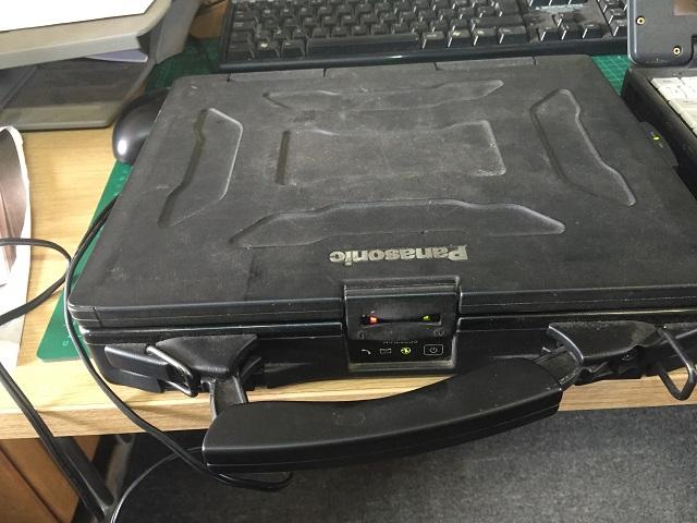

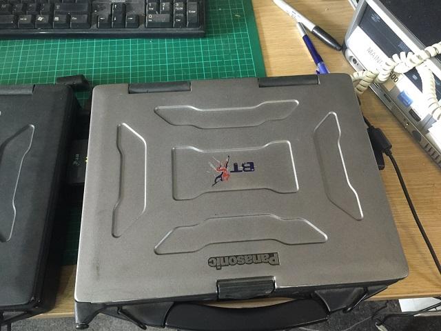

Would an old Panasonic Toughbook be any use to you? It has RS232. I retired one a while back - I used to use it to drip feed the CNC machines but now I have all the cables hard wired back to the workshop desk top. It's the rugged variety used by the various utiites for testing and field logging. I think it's running Vista
Yours for the postage.

That could actually work pretty well. Running vista means it can run something newer as well.
I will PM you an adress, and you could check shipping? =)

It won't run anything newer than Vista as it hasn't enough memory. I just had it on the network and used it to carry data to the machine.
... read your PM's - I've replied to yours

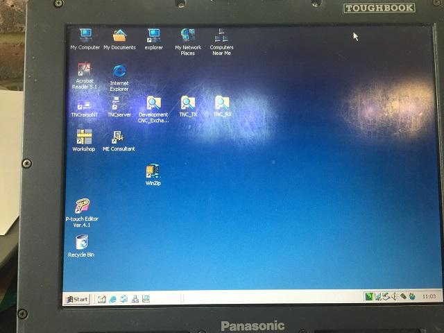

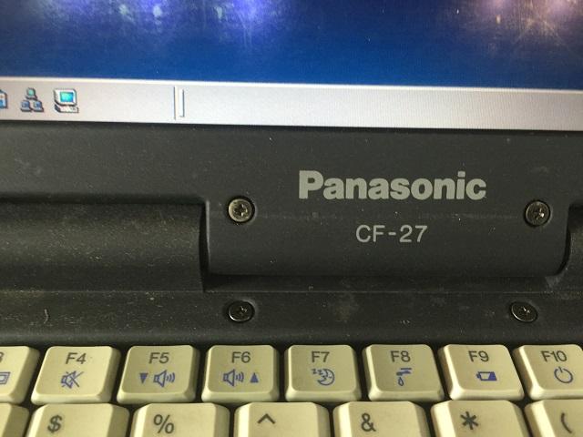

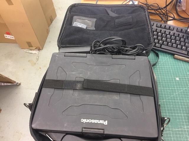

OK a few details for you to work out what your postage will cost:
It weighs 5kGs in it's carry case without further packing
It measures 380x340x120 mm, again without further packing
It's running Windows 2000 Professional, and has a DVD drive. There is a WiFi plug in and also a Cat5e 10/100 plug in. I've steamed it up and checked it connects ok to my network.
(I do also have a second one that you are welcome to for spares. but having had it's power off for years it's reverted to wanting a BIOS password - I got round that somehow years ago but cannot remember how)

Offline NeoTech
  • Posts: 826
« Reply #30 on: March 30, 2016, 12:57:28 PM »
Wiiih first cut.. not much but something on a piece of scrap.. Still amazeballs for me. =)  :med:
https://www.youtube.com/watch?v=o31X1UvdHNc

Offline NeoTech
  • Posts: 826
« Reply #33 on: March 31, 2016, 07:20:22 AM »
Well its as userfriendly as a piece of lump coal. But it works.
And adding onto it like a 4th axis would be a nightmare i'm guessing. =)

So here is a dry run of the DNC Dripfeed over a serial connection. i Got CTS/RTS working over 9600 baud and its really stable.
For communication i used a UC232R-10 from FTDI, i tried like 7 of these usb to serial dongles, but this one was really stable.
I had one of the "same" but it was apparently a chinese knock off, but the real deal. is really good.
Warning the volume is kinda high..
