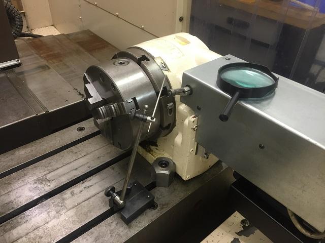

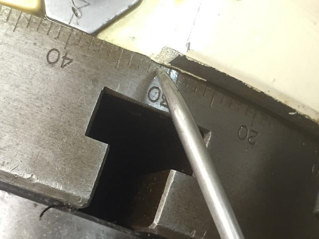

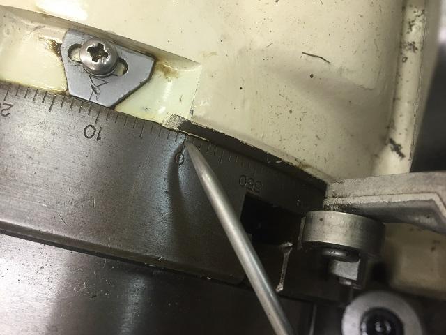

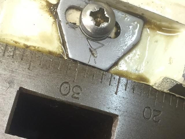

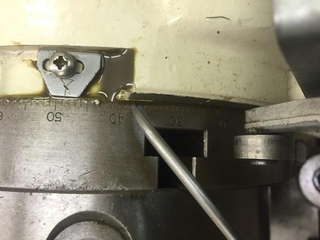

I wanted to prove if the error was actually consistent, and measure it more accurately. So I set up a 'zero pointer' (*) and wrote a diddy program to turn the 4th axis 20 turns or 7200 degrees so that the error would be magnified and more easily measured.
Odd results: first two runs at 2000 degrees per minute gave errors of 37 and 38 degrees added to where we should be - so close that I thought that I'd perhaps bumped the scriber holder when taking the picture.
But I then repeated the test of 7200 degrees but halved the speed to 1000 degrees per minute, and got a result of 31 degrees  :bugeye:
... so it's NOT consistent and could well be a dim bulb in the encoder (I think that they use an under run pea bulb) or it could conceivably be a pulley or shaft slipping.
A bit of dismantling tomorrow if I can find time

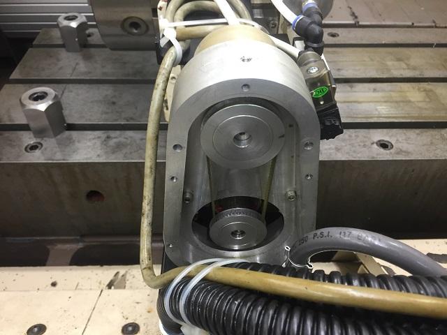

so bright and early this morning I set it going at a crawling 100 degrees a minute for the 7200 degree test, then went and cleared out the pigs, cooked my porridge, ate it, and returning to the workshop it was ALMOST there  :ddb: (an hour and 12 mins of course)
... how did it do, well it still over travelled but by less at 29 degrees.
So no choice but to start pulling the thing apart, a diversion I could well do without. Swarf cover off, and even so getting the end cover off the belt drive was a pain ... who designed this ....  :scratch:  (me!)
Eventually got the bits obscuring the belt cover off to reveal a toothed pulley on the end of the servo motor with a grub screw only finger tight  :bang: I was tempted to put the pulleys back with Loctite as well as grub screws, but future dismantling would be almost impossible without destroying the alloy pulleys.
So I decided to drill and tap them both for a second grub screw at 90 degrees to the first - this is where things started to go awry  :( Trying to undo the (hard of access) grub screw on the encoder, the ball end of my (cheap and nasty Chinese) ball ended allen key decided this was the time to break off inside the grub and jam there forever  :bang:
However I managed to gently tap the pulley off the shaft, then as the grub screw / broken ball end proved too hard to drill out, put two new grubs in and ignored the old one. I put a reamer through to take the slight protrusion of the old grub screw which would have stopped the pulley going back on.
(These are tiny M3 grubs with 1.5 mm hex sockets so a bit delicate.)
So having jumped through those hoops it was just a case of putting it back together making sure the pulleys were aligned and the belt tensioned and trying it out.
..did it work ..... :scratch: ...you bet  :ddb:
SORTED
Now perhaps I can get back to making that bally dial that revealed this issue  :lol:

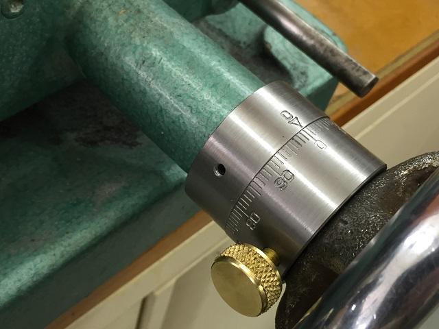

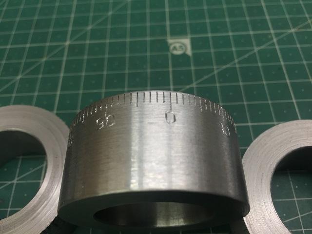

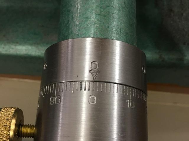

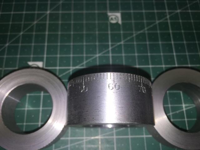

So with no more ado I skimmed that doughnut down yet again (48 mm now!), set the mandrel in the 4th Axis and had yet another go.
... hoo blooming ray ... it worked perfectly. The scale wraps around the part seamlessly (the join is between the  95 and 96 lines, and I suspect that the characters are better formed - one side of the zero's previously looked a little straight.
 :ddb:
So now I can go ahead and make the real thing complete with recesses for O rings to add friction in place on the drill grinder

Re: Experiment Engraving Machine Dials
« Reply #38 on: February 26, 2016, 10:21:43 AM »
Nope, 96 is greater than 97.
[ Should have gone to specsavers ]  :drool:
« Reply #44 on: March 04, 2016, 07:02:56 PM »
It's not sorted though.
Seriously 96 is greater than 97, look at the picture.
 :poke:
  • Posts: 9050
« Reply #45 on: March 07, 2016, 10:37:24 AM »

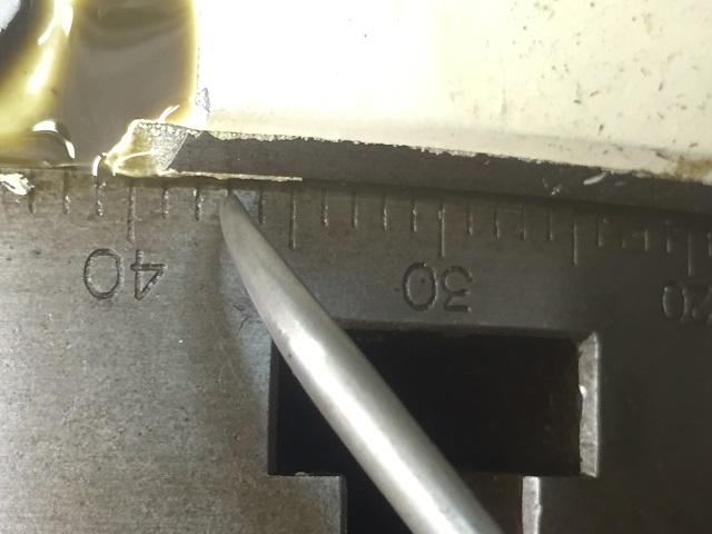

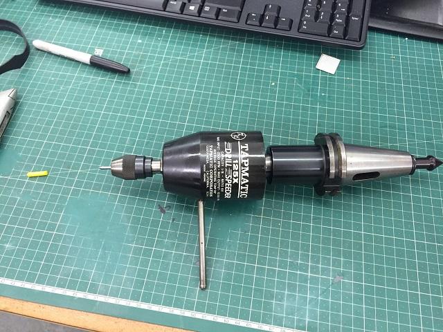

John I agree that that version looks slightly unequal. Not sure why  :scratch: May be that the drag engraver, which is used non-rotating, turned a bit  - it won't be exactly concentric due to the screw holding the bit, and 97 was the first line engraved, and 96 the last.
I gave up with drag engraving as the depth and definition wasn't sufficient, so I dug out my 'Tapmatic Speeder' that gives a 6:1 speed increase on normal spindle speed, and engraved the dials using a conventional carbide 'Vee bit'. I've been putting off using it, as it requires a 'reaction bar' to stop it's body rotating, which was a bit of a pain to arrange.
So here they are temporarily mounted on the drill grinder - I'll clean them up and nickel plate them when I've enough bits waiting for plating for it to be worth setting the tank up.

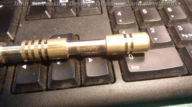

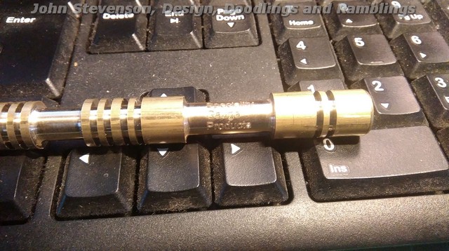

I have been doing some rotary engraving using a diamond drag over the weekend.
Quite tiny letters in brass for something the Delectable Debs ™ ® © sells, This is new though as up until now she just stamped the model on with 1/8" stamps which was all she had, but now she has her own CNC, once perfected I can pass the job over.
Sooner than hi-jack Andrews post ' again ' I'll start a new one tonight after work.
« Reply #49 on: March 21, 2016, 11:54:57 AM »
OK quick teaser.
Quite hard to photograph being shiny brass and so small.
The brass bar where the letters are is 8mm in diameter and the capital letters are 2.3 mm high.
