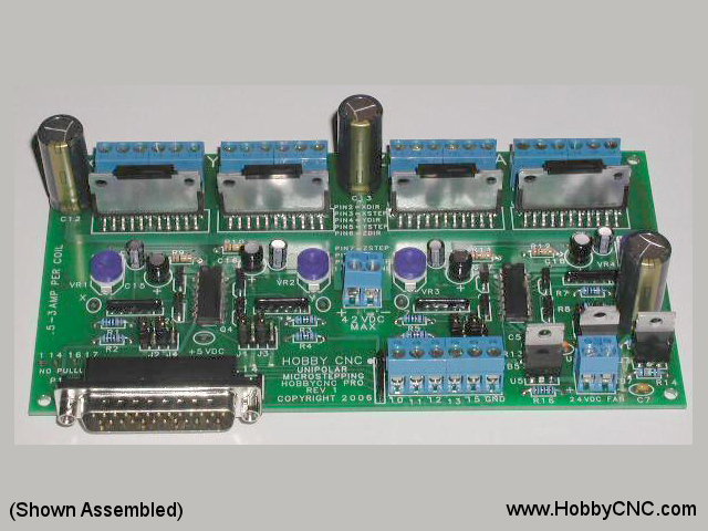

So the controller board kit, timing gears and belts showed up yesterday. I am going to get some pictures of it all soon and do a step by step of the assembly of the controller. On another front, I got a benefactor for this conversion... A friend who has a vested interest of getting some parts made, has made a loan to get some more things for the build  :headbang:
Hopefully tomorrow, I will build the controller.

Well, I spent most of Saturday cleaning and organizing the shop. I am still not anywhere near done that but who is?
I got a little time on Sunday to start building the CNC controller:
Here is the board and most of the parts. Ignore the blurries... cell phone camera!
Added a few resistors:
Then some caps:
OFC, this was done at my mother in-laws. I forgot my multimeter at home and didn't want to continue until I had tested the stuff I had already done.
Ordering some more stuff today or tomorrow!
