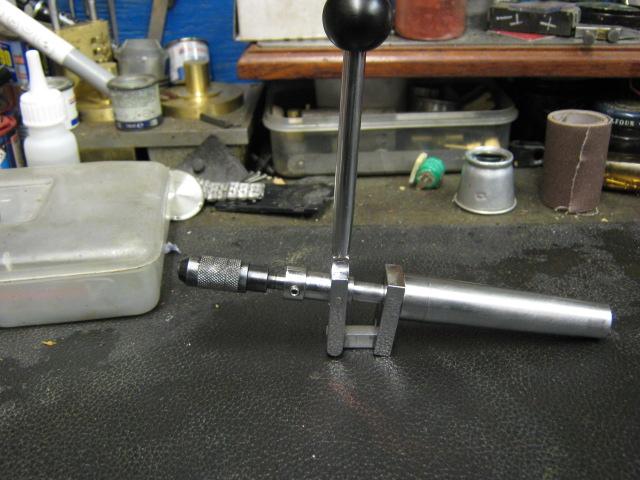

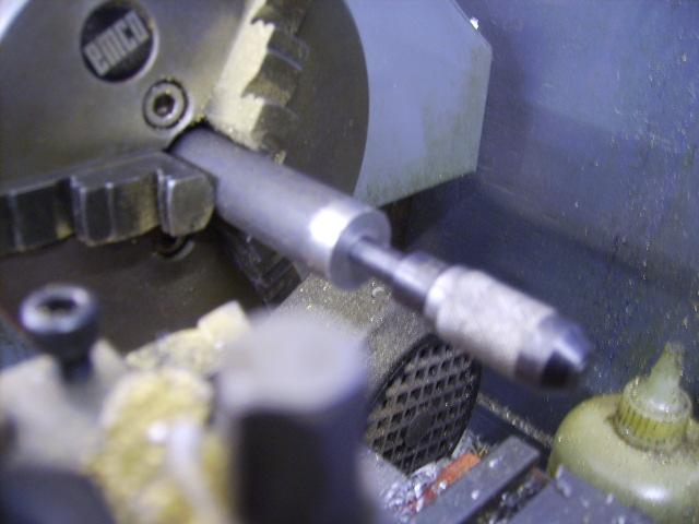

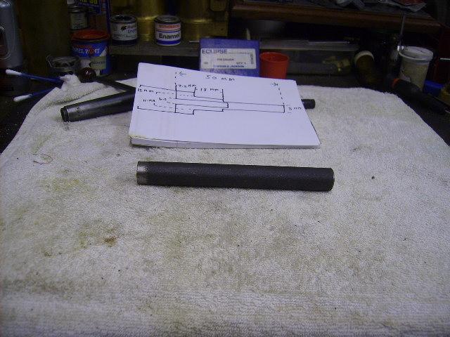

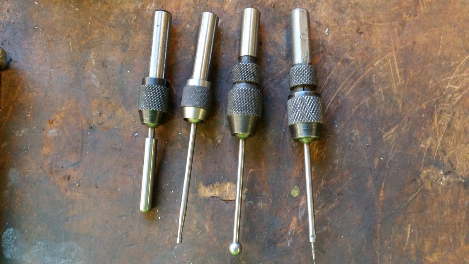

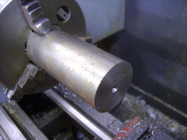

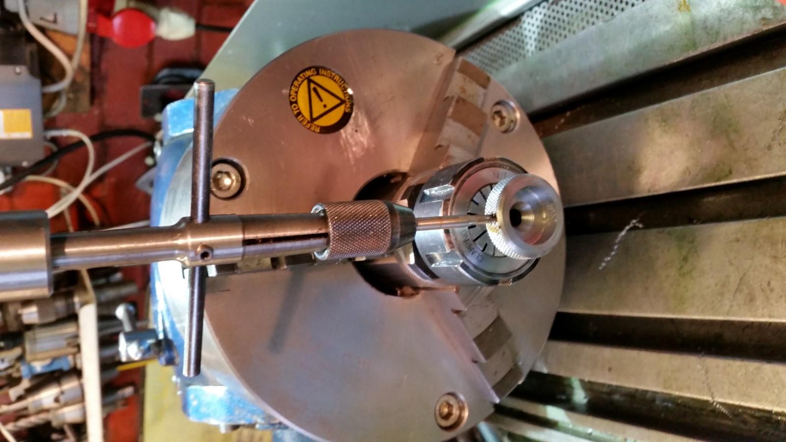

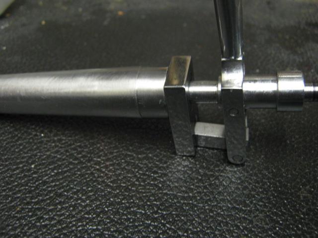

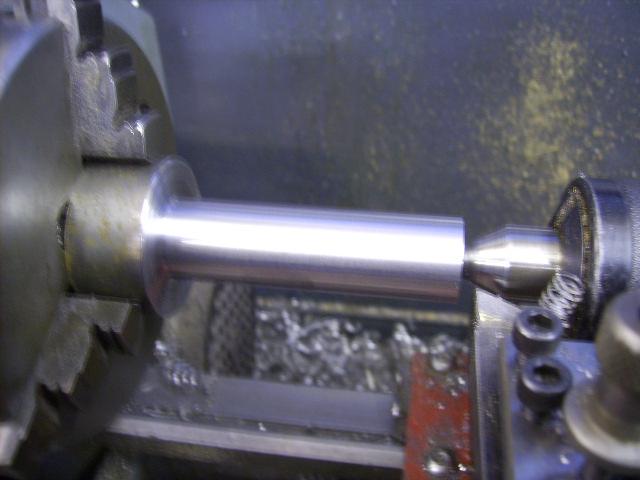

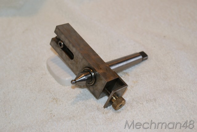

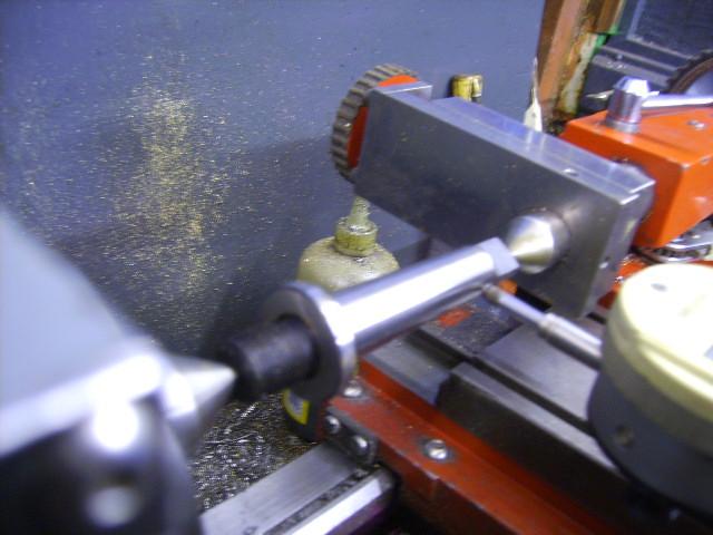

hi all a friend of mine peter has this for his myford so I have borrowed it off him so I can make one see pic 1 so the first thing was to make the centre parte this was made out of sum 13mm bare the over all length is 90mm so the first thing to drill and ream 6.3 to fit the shaft on the eclipse pin chuck  then turn up the rest to the same as the original one the mane shaft was turned dawn to be just bigger than 8mm once that bit was dun the next bit turn up the No2 morce taper to fit my tale stock the only bit of steel large inuf  for the job was 40mm in di so I drilled centres at both ends then this got turned dawn to 20mm once dawn to 20mm I drilled all the way threw then reemd out to 8mm   I took plenty of pics but as I shake not many of them turned out good any way I have a No2 taper that I youse for setting up my tale stock off centre turning tool  put the taper between the head stock canter and the one on the  tale stock and adjust it till the d.t.i stays the same then your set to start turning once all the turning had bin dun I then went back to the centre shaft and polish this to be a spot on fit in the m8 reemd hole right pics
o and I had to stop for me tee see last pic

That's a interesting tailstock adapter does Myford makes those?
Re: a eclipse pin chuck sensertive drill atachment
« Reply #2 on: January 10, 2016, 06:40:14 PM »
hi tom I have seen a similar one that myford  is selling on ebay  but it ant hard to make one the one I have is home made

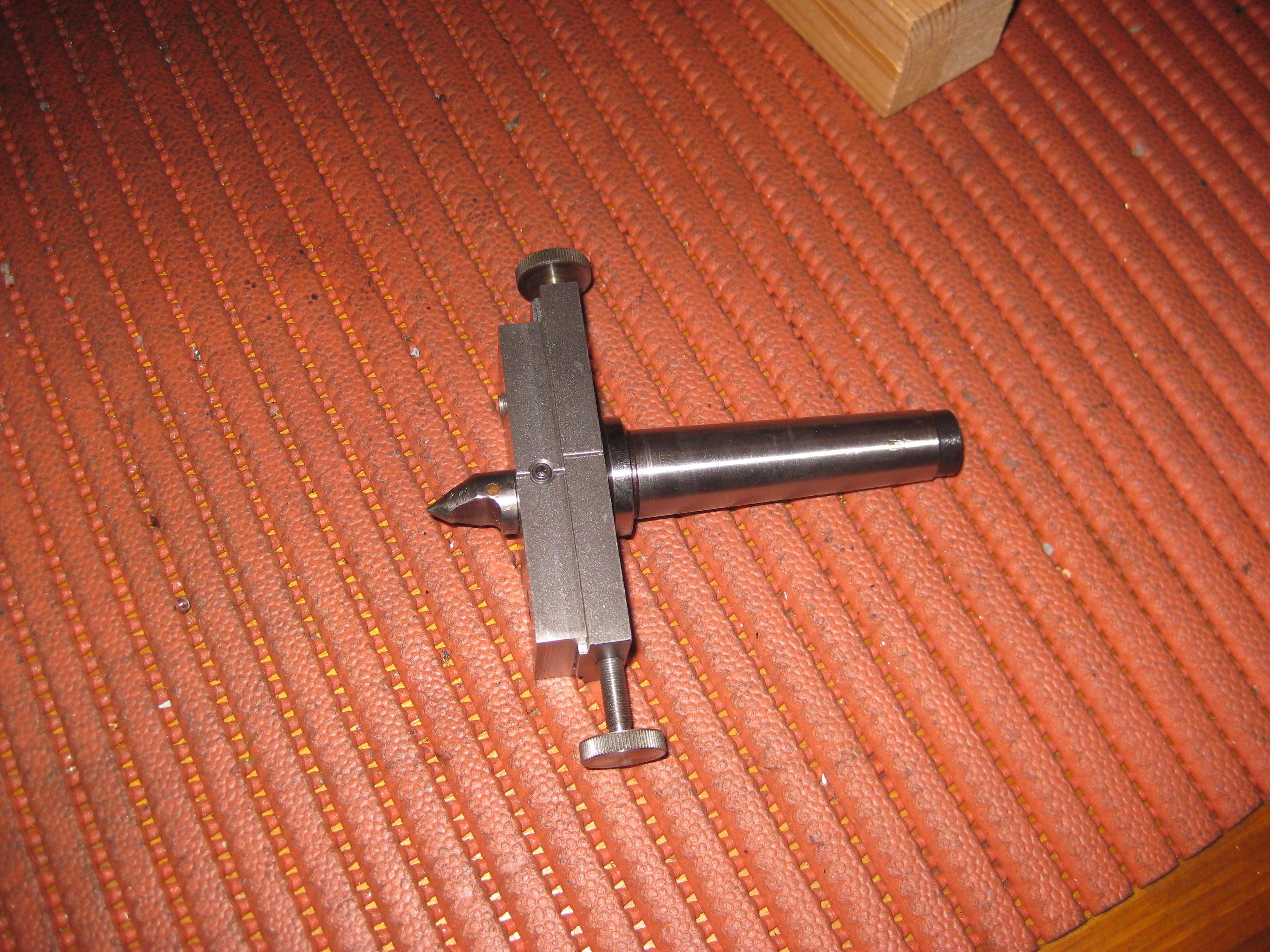

« Reply #3 on: January 11, 2016, 03:42:51 AM »

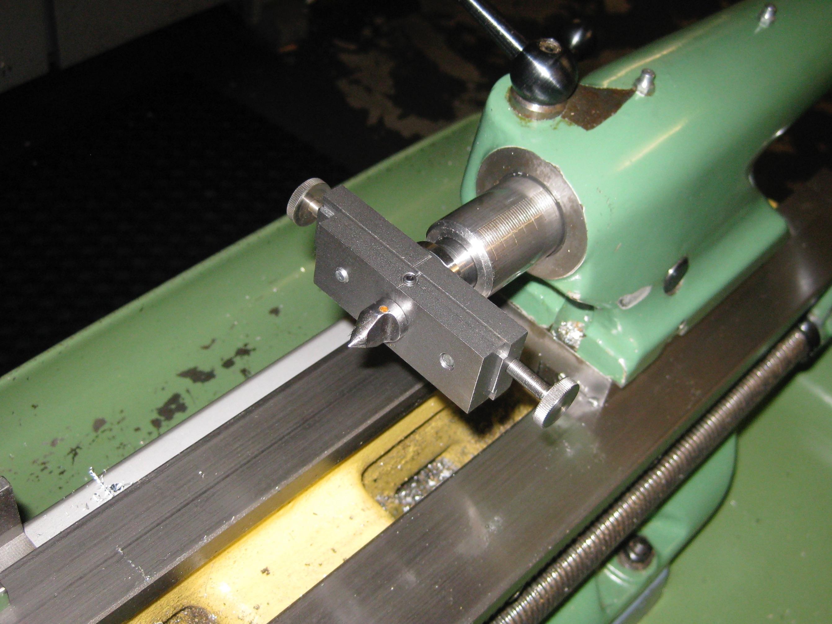

A handy tool nicely made and illustrated Bob. I like the set over tail stock adaptor, did you make it?

hi all thanks for the comments was going to do a bit more tonight but its freezing as for the set up tool no I did not make it I got it given but it needed my loving touch if and when I get a mill I plan on remaking it

Nicely made little tool' they sell them on e bay & other suppler sites but are silly money. Talking about offset taper turning, I made something similar some years ago, have only used it once in anger since...

Yesterday, went out on the spending spree for a local Myford ME10 which was described as 'An ideal Starter lathe' and I found both the tailstock stock thing and the set over one in the box of goodies.
Made something similar ,using Hemingway-Kits set.
http://www.hemingwaykits.com/acatalog/Set_over_Centre.html
I use it when ever I need a taper.
Very handy tool,IMHO.

Mine is calibrated to show offsets for 1 to 3 Morse Taper.  Came in the boxes of goodies with the ME10.  Complete in its own box and looking rather superior to my usual selection of what I laughing regard as tooling.

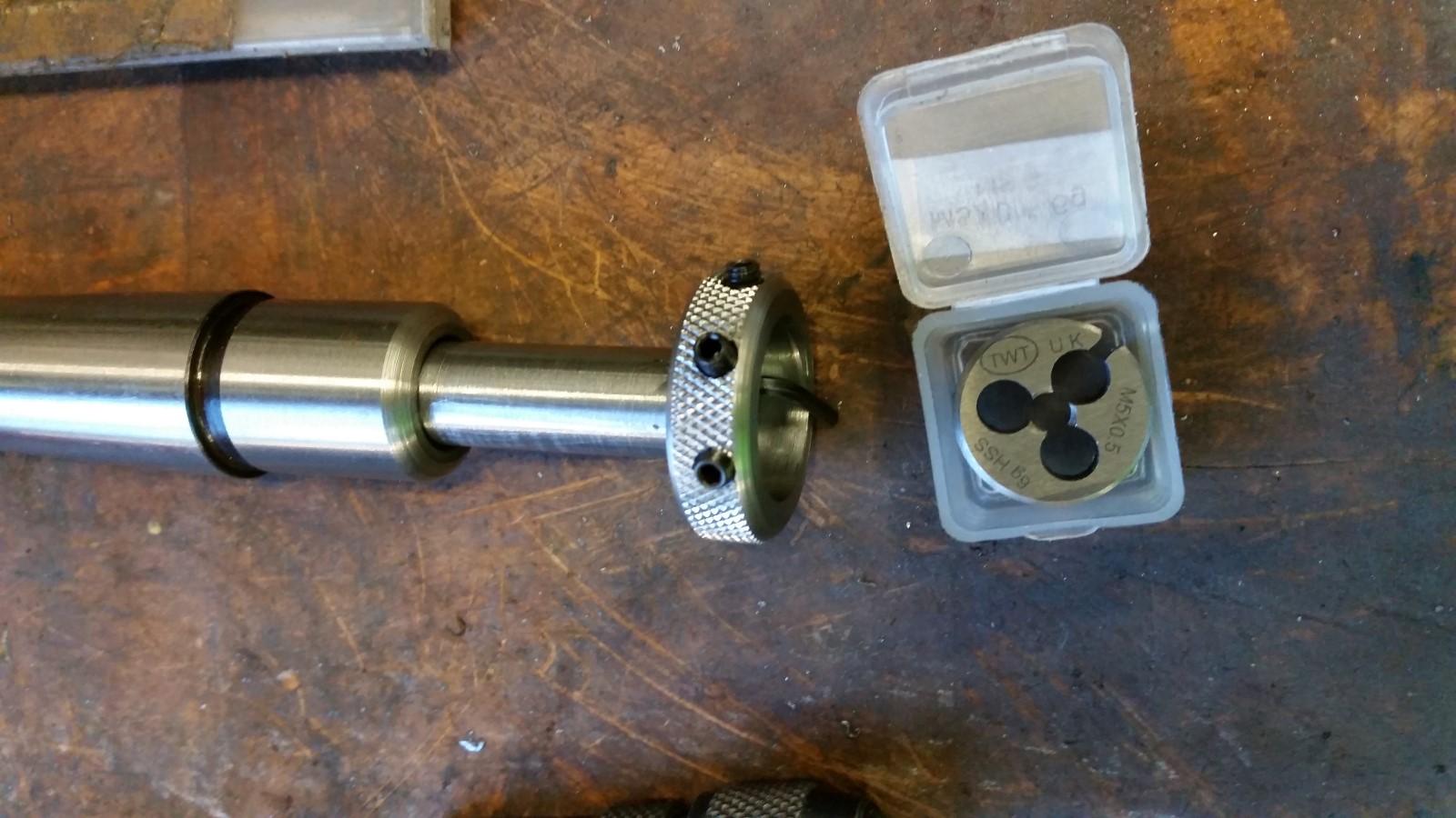

Good to see the project you've been busy with, I like the sensitive drilling spindle idea, I'll have to incorporate it into my sensitive die/tap holder musings...
I want to thread male & female M5 x 0.5, for that dial gauge needle puller I promised, sorry it's taking so long...

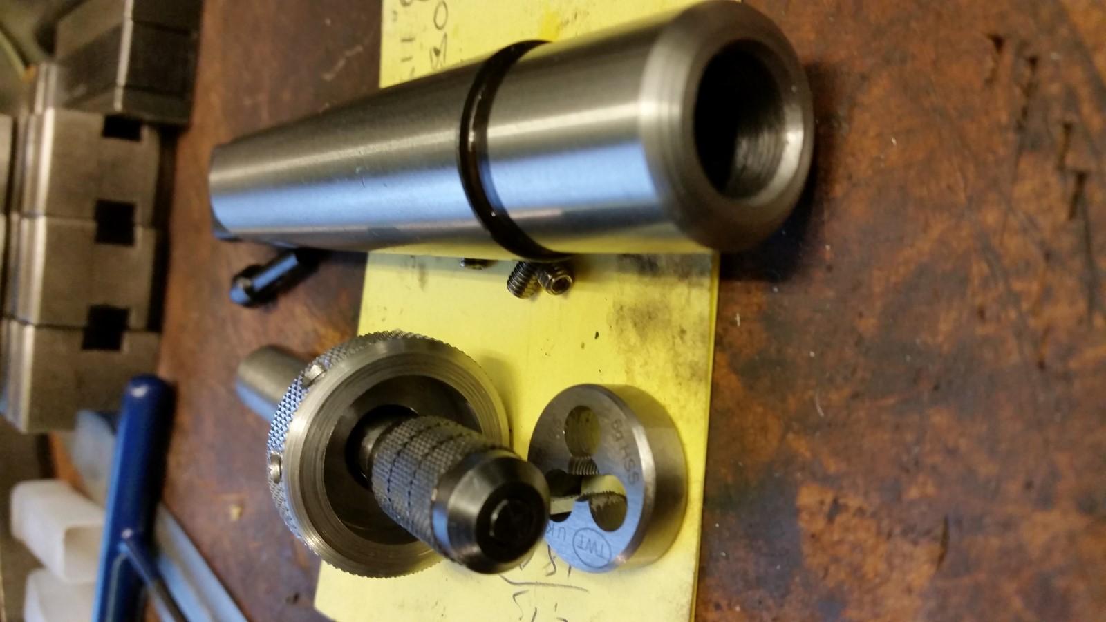

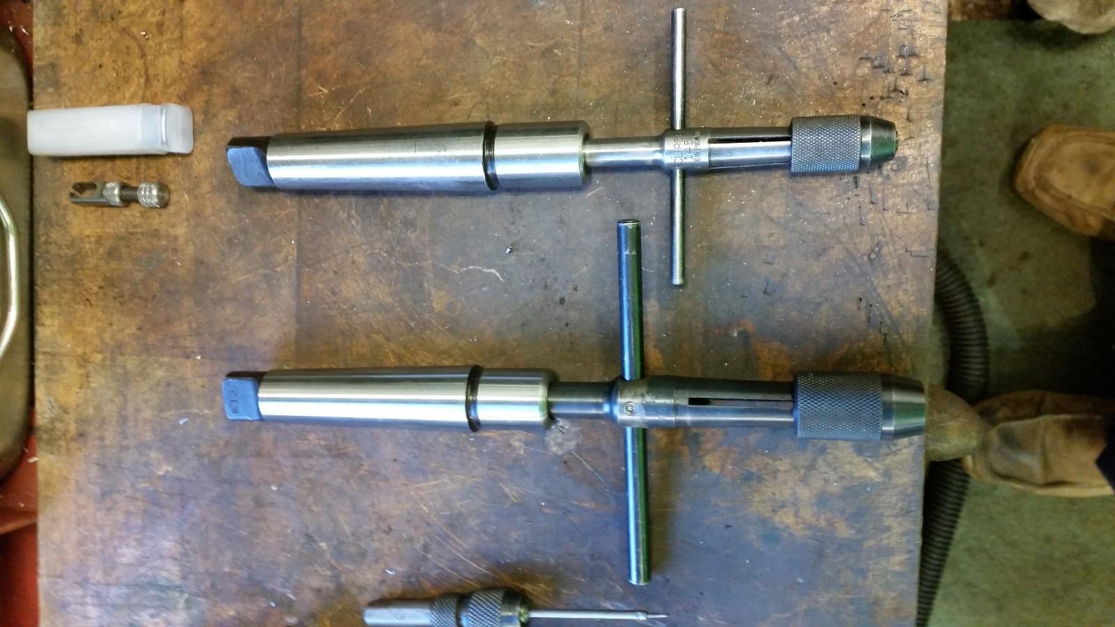

Thought I'd post a few pics of my version of a sensitive Drill chuck/Die Holder/Tap Guide, I haven't used a lever though.
I've also modified one of the pointers of my Wiggler set, I turned up an accurate 0.25" cylinder to sleeve an 1/8" needle pointer.
This allows for setting up round bars in my dividing head, without the need to ensure the 0.25" ball is on the bar centre height.
Chris

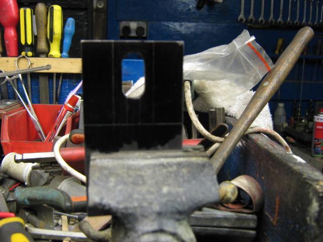

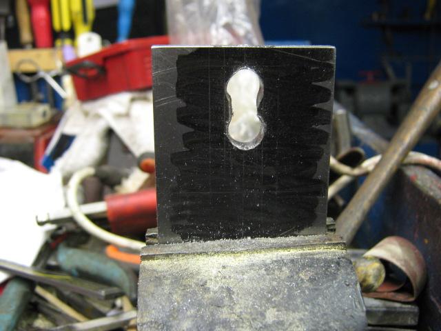

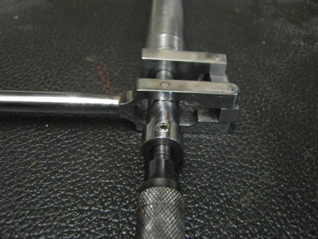

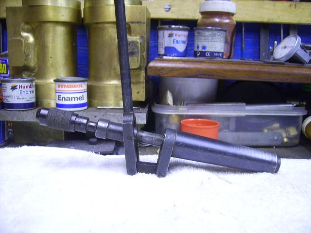

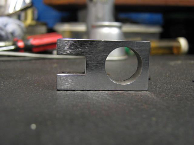

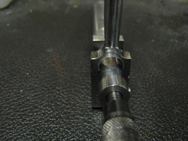

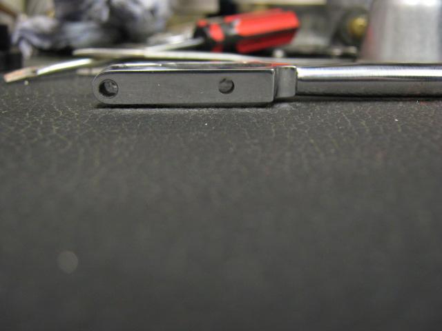

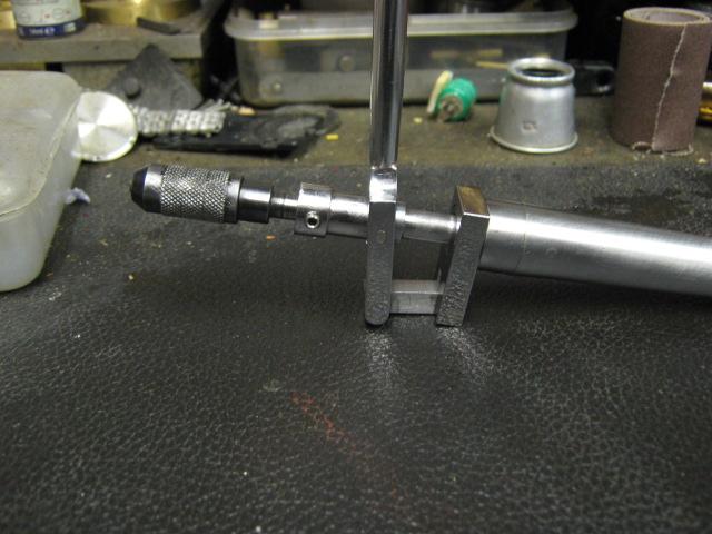

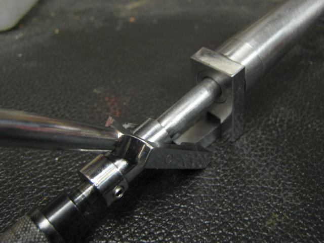

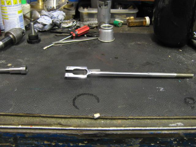

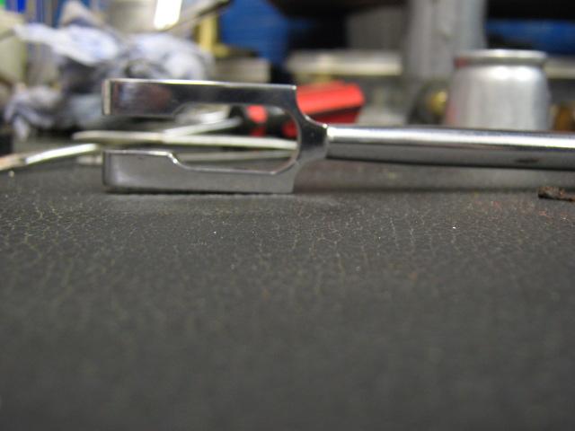

hi good job rotorhead right I have bin biz with other things but when time allowed I managed to get most of the metal work dun sos not that many pics I got sum 6mm thick gage plate and marked it out then drilled two 10mm hols then cut the middle out  with a hacksaw then driest it up with a file sos no pics of the next bit cut the mane part out then drilled and reemd m3 two pivot points then cut out the bottom slot then file it to 6mm then with a nuther peace drilled 9.8 then reemd to 10mm this is to go on to the front of the taper then drilled 2.8 then reemd 3mm for the pivot then made the link 6mm by 6mm did not have any bar the same diameter for the handle so mad it out of a long m8 bolt with the front tapered then silver soldered it to the front fork right pics

                  That is a very nice little job, well done.
                                                                               Cheers David

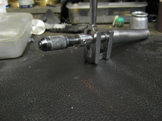

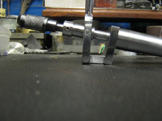

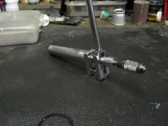

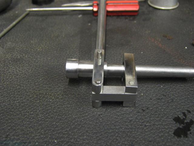

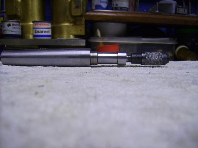

hi all last bit got it all together today last bits to do was make a ball for the handle I had one but it was a bit on the big side so I just put it in the lathe on sum m6 studding and with a file worked it dawn to a nice size sos ant mesherd it  just dun it till it looks right then made up sum 3mm pins for the pivots I had 3mm dowels just cut them dawn to fit  and that's it right pics
