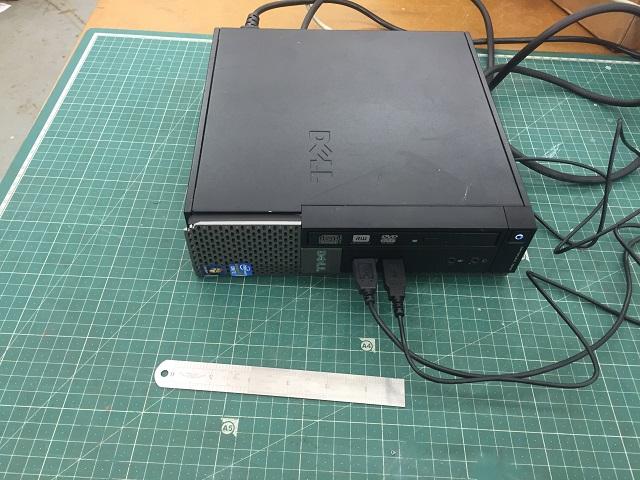

Shouldn't be difficult should it - done it many times before, but this time it's driving me bonkers  :bang:
It's a Dell 7010 Ultra Small Form Factor Intel Core i3 3220 3.30Ghz, 4GB Ram, 320Gb Hdd with (OEM)Win 7 pre-loaded. HDD and CD are both SATA

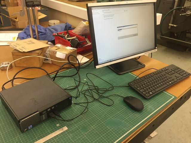

What I'm trying to do is replace the disc with an SSD one. So, create a system image, create a system restore CD, physically replace the HDD with the SSD one, boot off the system restore CD, and load up the image to the new drive. How hard can it be  :scratch:
Well the first issue is this PC has only two SATA ports, one dedicated to the hard disc, the other to the CD - so nowhere to put the system image except on a network drive.
So I've generated a system image successfully across the network, swapped the drives, booted off the system restore CD , poined it at the image (which it sees) but it refuses to use it for restore  :bang:
So I've attached a 1 TB USB drive to the system,  generated another system image, but again it refuses to use it to restore  :bang:
So I've installed the new disc in another PC that has more SATA ports, booted off the restore CD, but it won't load the image  :bang:

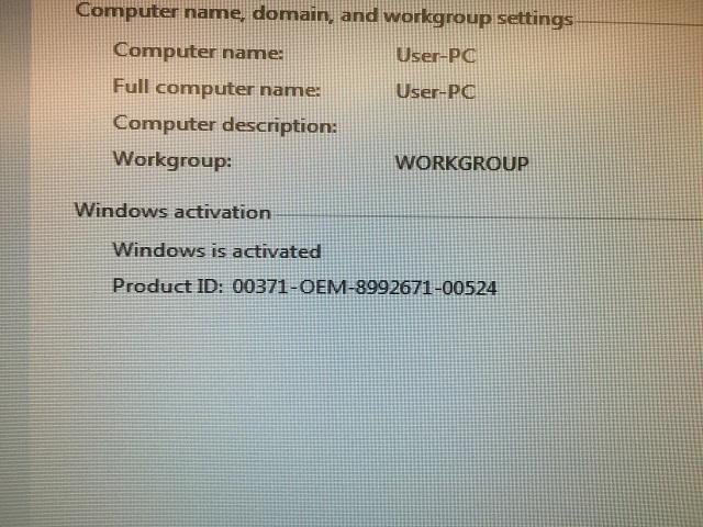

Now there's nothing particularly important on the original drive except the operating system, so I thought if I did a clean install using one of my genuine Win7 professional 64 bit distribution CDs and use the Certificate of Authenticity number off the PC as it's definitely genuine I should end up good to go. Loads up fine, runs, but the COA won't authenticate - presumably it needs to be loaded from a Dell OEM version of Win 7 professional  :bang:

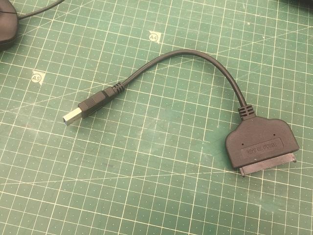

Today at long last I have finally cloned my original hard drive onto the Samsung SSD and it works - but oh what a a palaver - and many thanks to those who offered helpful suggestions.
The critical thing was the arrival today of the ordered "USB 3 to 2.5" SATA" cable - now the software that Samsung supply with the drive expects to access the new SSD this way - BUT IT COULDN'T  :bang:

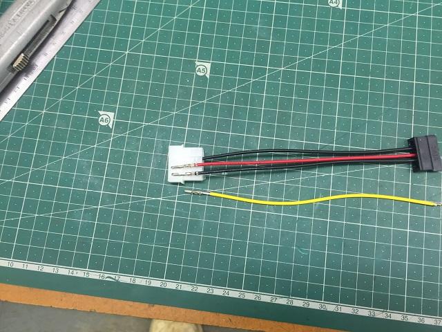

As I didn't have the cable, initially I'd tried a 'back up and restore' using the Windows 7 inbuilt facility, but it hadn't worked, but had written something to the SSD drive.  Then I'd tried a 'universal SATA transfer kit' but the connectors were of such appallingly poor quality, they literally fell apart on first use so I wasn't prepared to trust my data and disk to this rubbish hence buying the dedicated cable.
The Samsung cloning software claimed that it couldn't see the SSD drive - I could see and identify it under 'Device Manager' on the control panel, and also in 'Disk Management but it was inactive. Eventually I found that Windows 7 was refusing to mount the drive due to "Drive Signature Collision".
The only way I could get past this error was to use the Windows 7 command level to run 'DISKPART', and with my heart in my mouth delete the two partitions that Restore had created on this drive. Then returning to Disk Management in Control Panel, I could create a new volume and format it NTFS.
